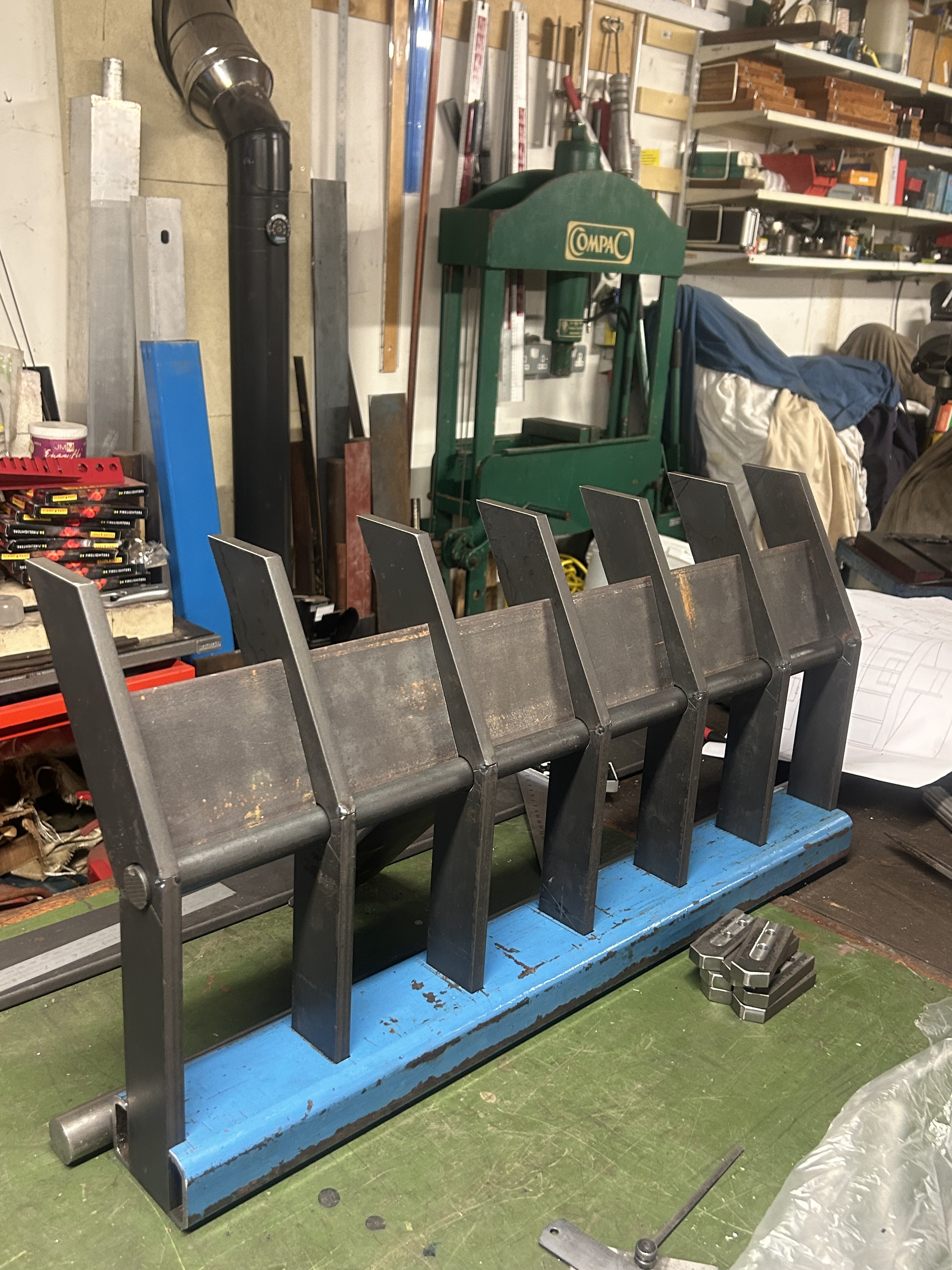

    Mini digger land rake-img_8660.jpegThe 90mm x 50mm rectangle section (painted blue) was from a skip dive a few months back all other materials purchased.

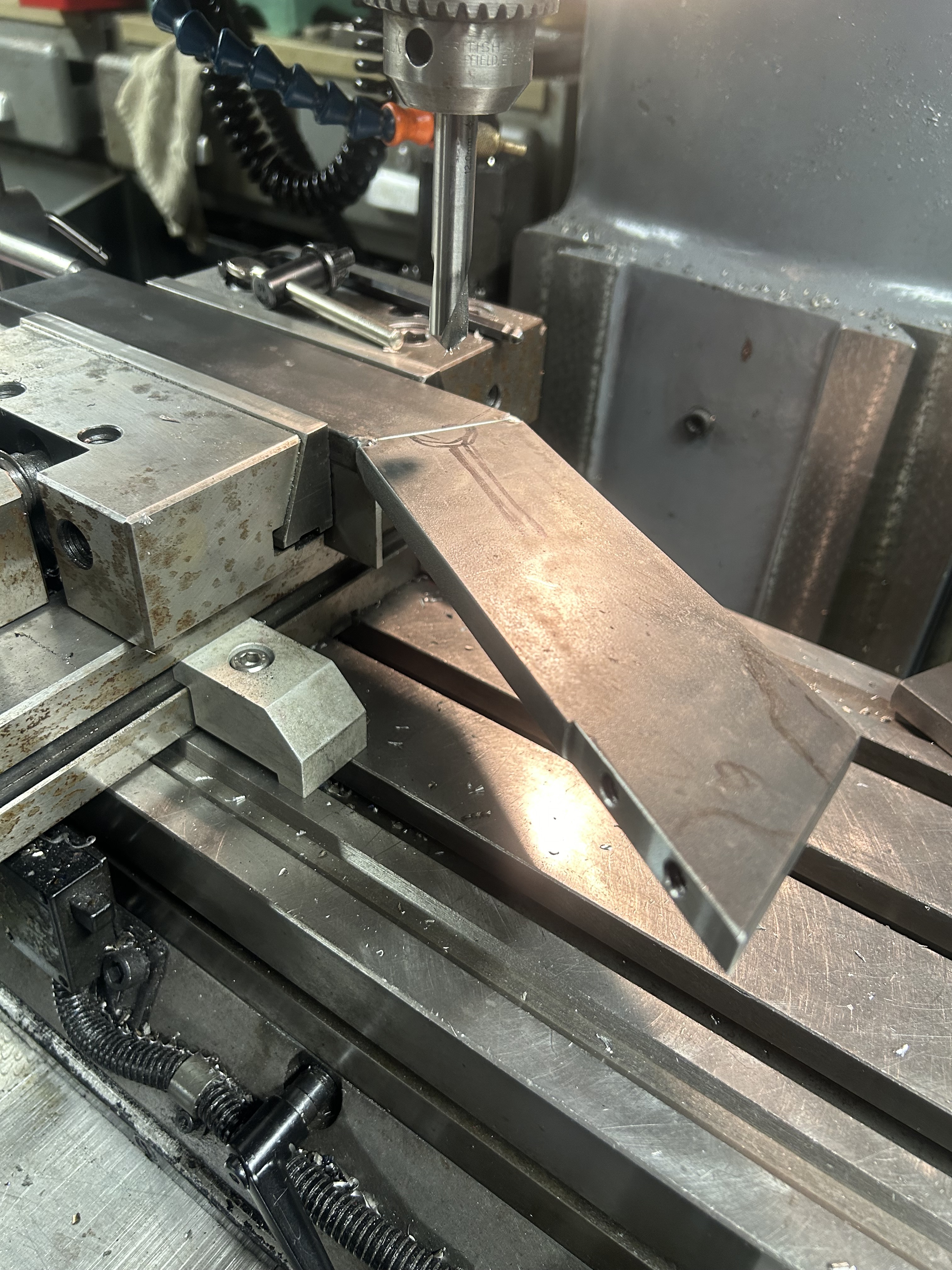

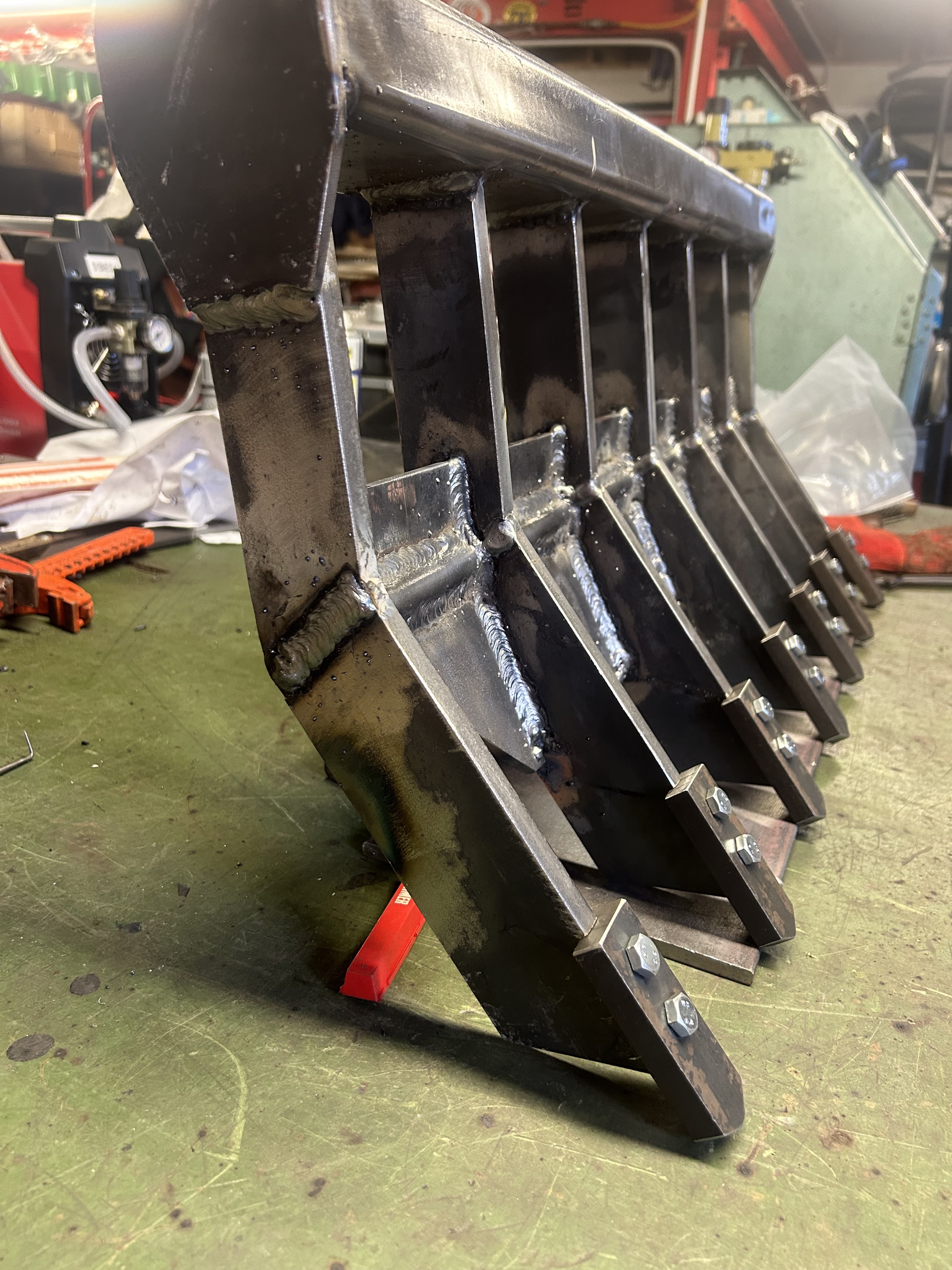

    Mini digger land rake-img_8658.jpegThe tines were cut from 12mm thick material and tack welded then drilled to accept the 25mm diameter steel spine.

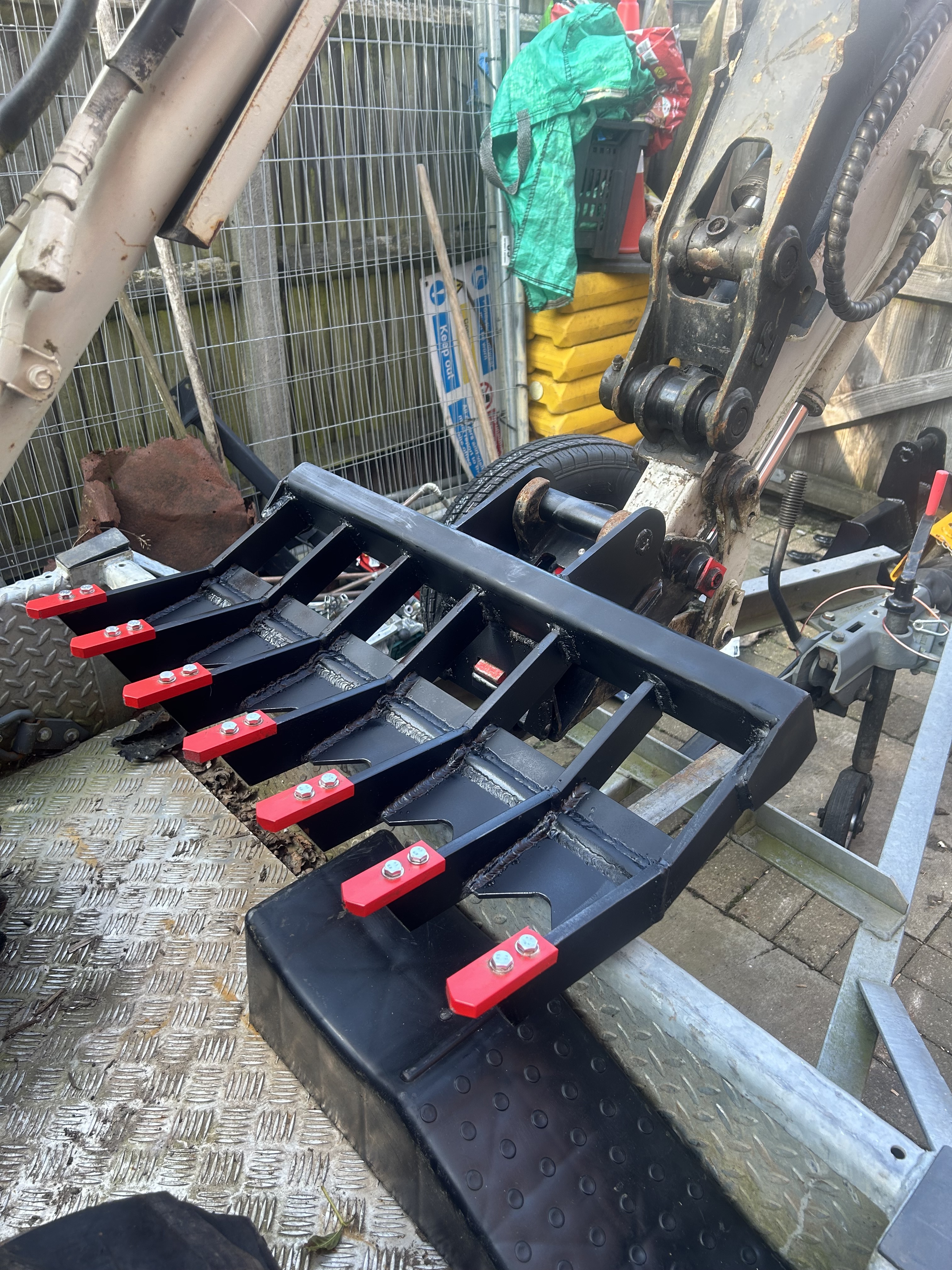

    Mini digger land rake-img_8672.jpegRake fully welded and replaceable teeth bolted in position to check fit. The webs are made from 6mm thick material.

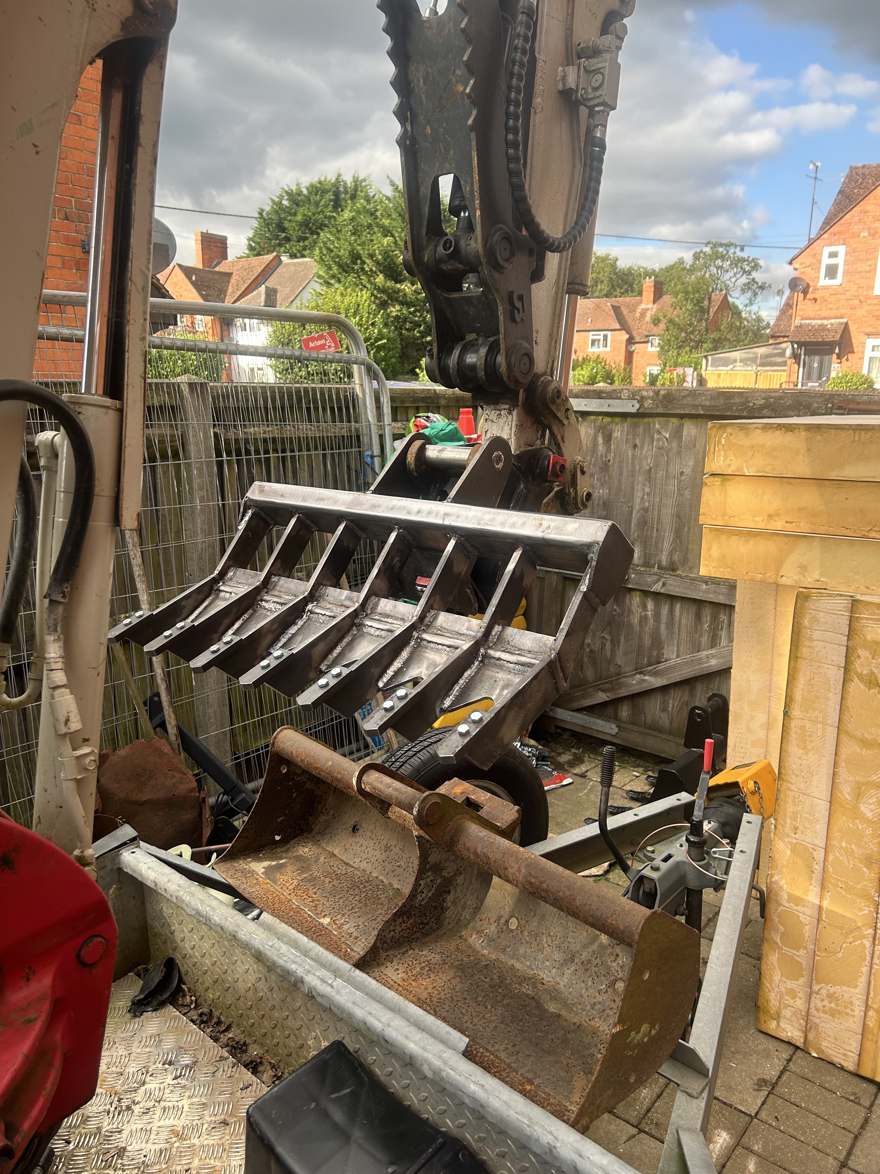

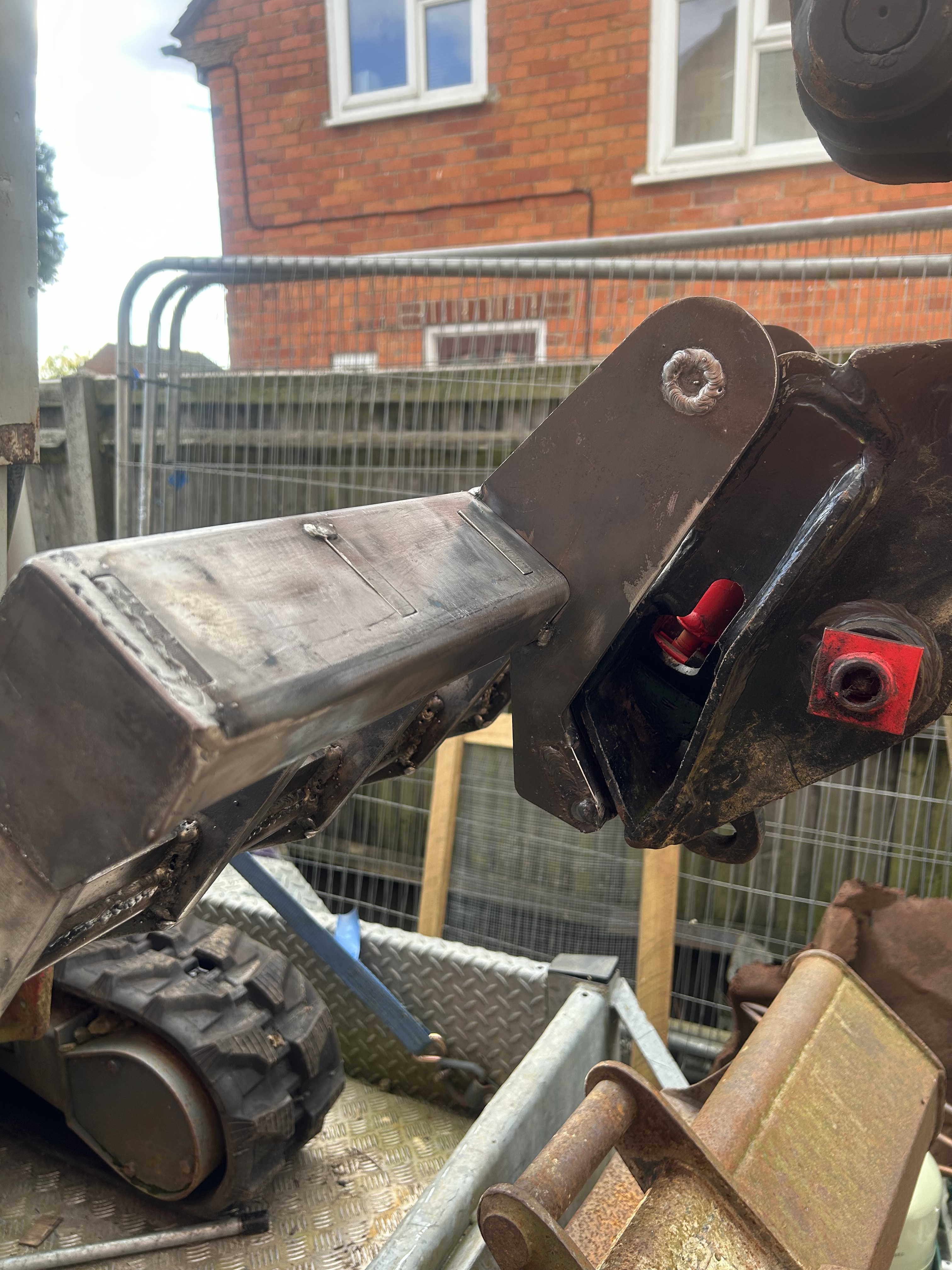

    Mini digger land rake-img_8698.jpegHarford hitch tack welded to check fit on digger.
    Mini digger land rake-img_8697.jpegRake locked in position on hitch.

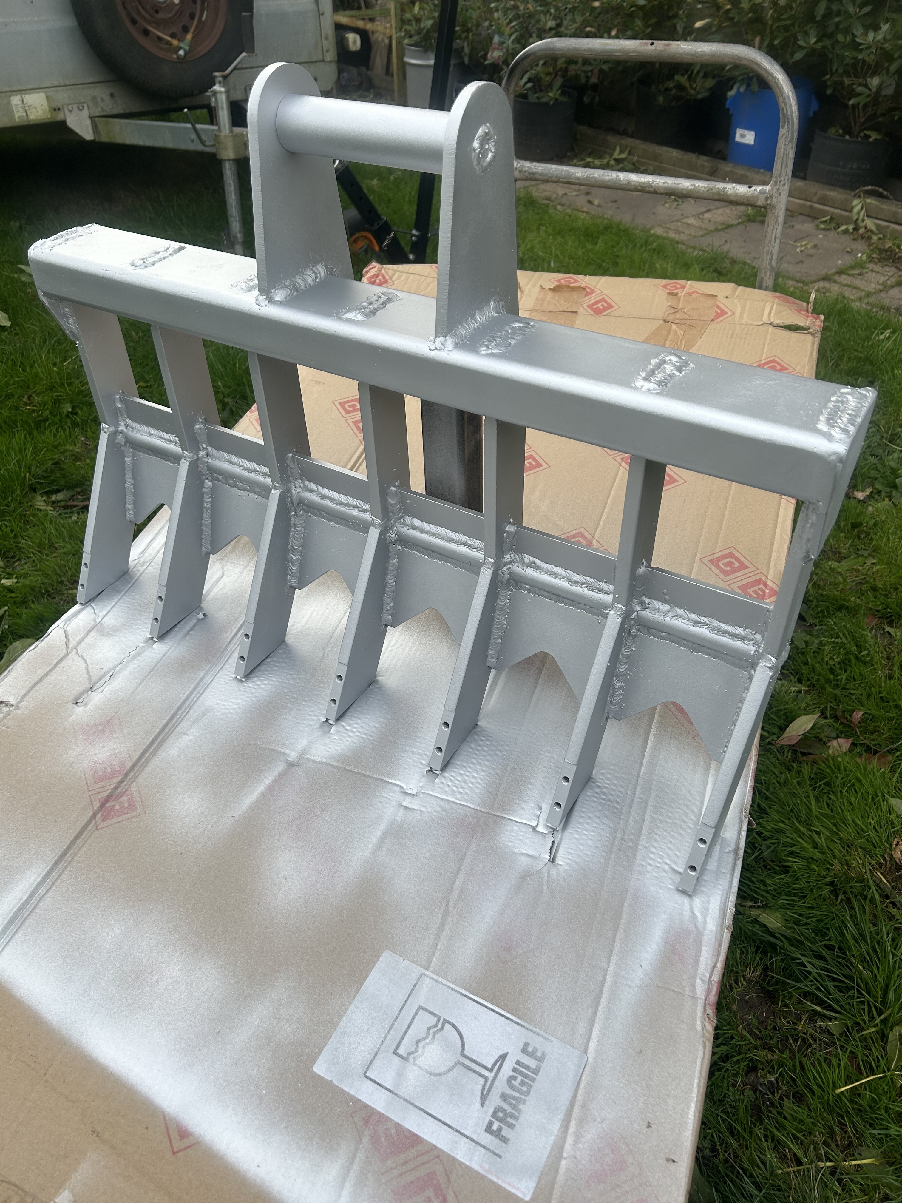

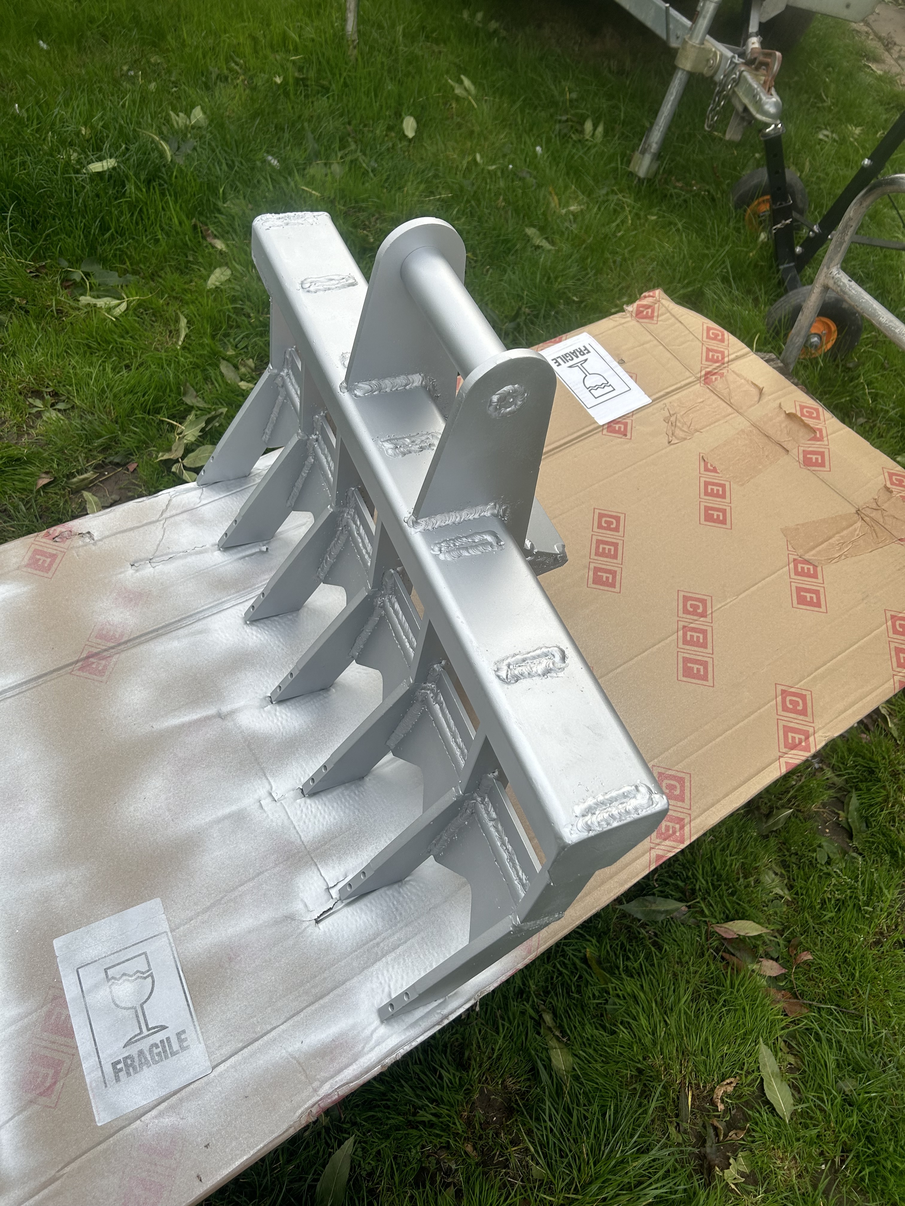

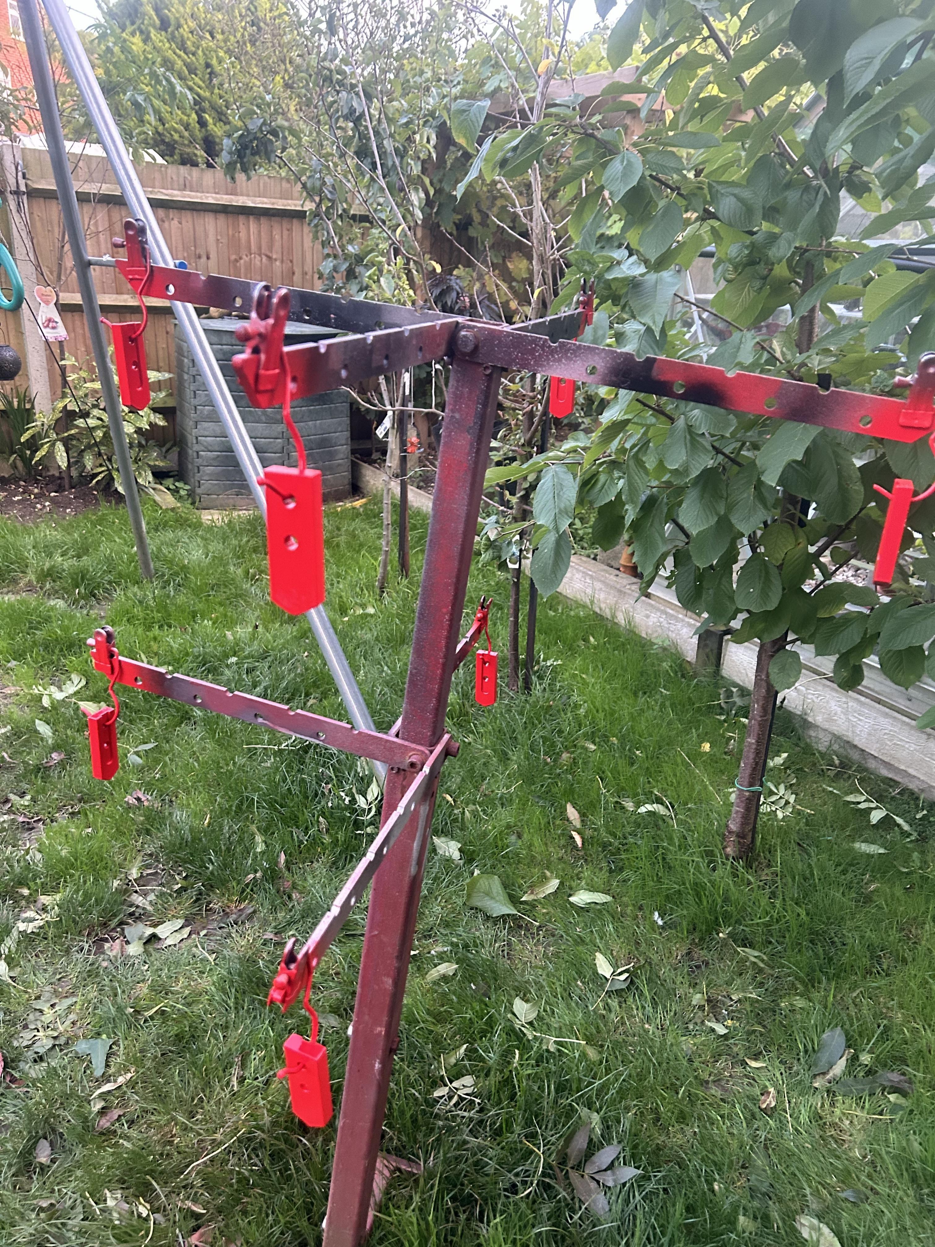

    Mini digger land rake-img_8700.jpeg Mini digger land rake-img_8699.jpegCoat of cold galvanised spray to add a bit of protection.

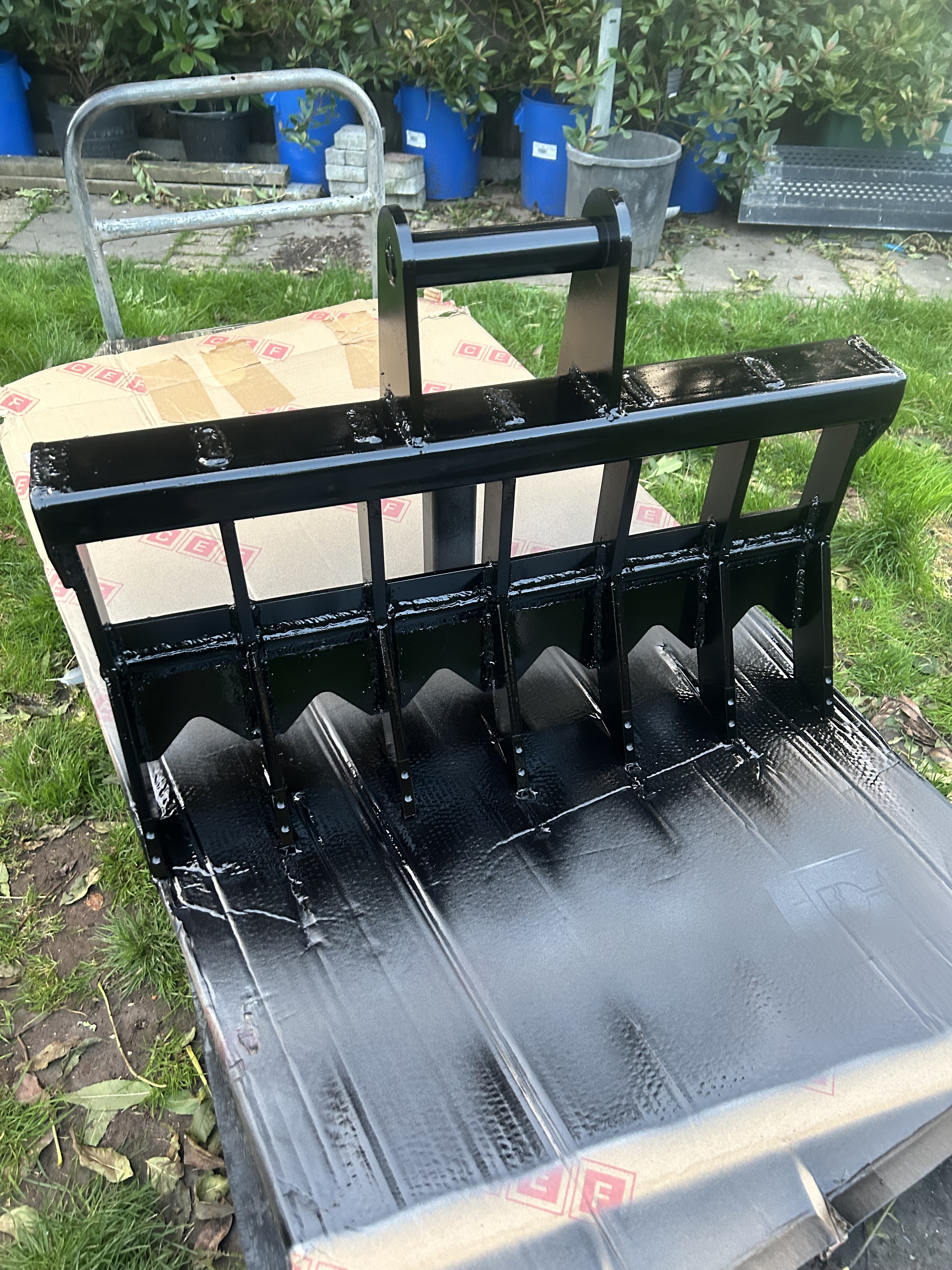

    Mini digger land rake-img_8703.jpeg Mini digger land rake-img_8702.jpegA coat of black spray.

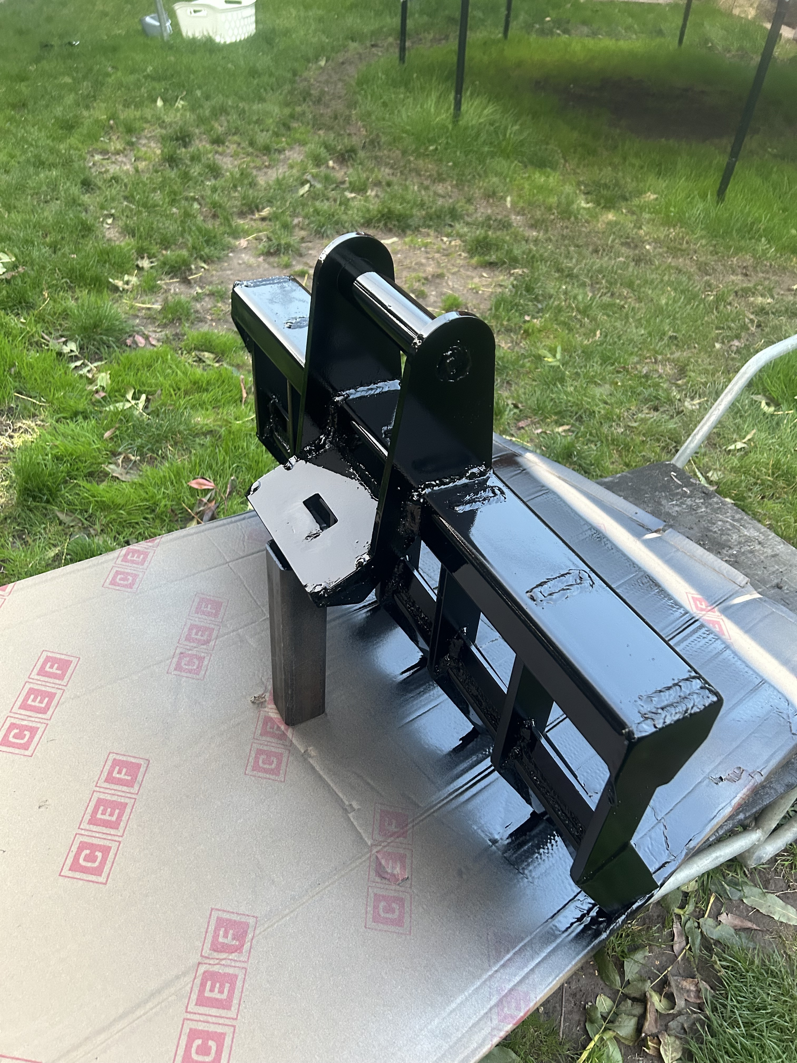

    Mini digger land rake-img_8707.jpegCompleted and ready to rough up the paint job.
