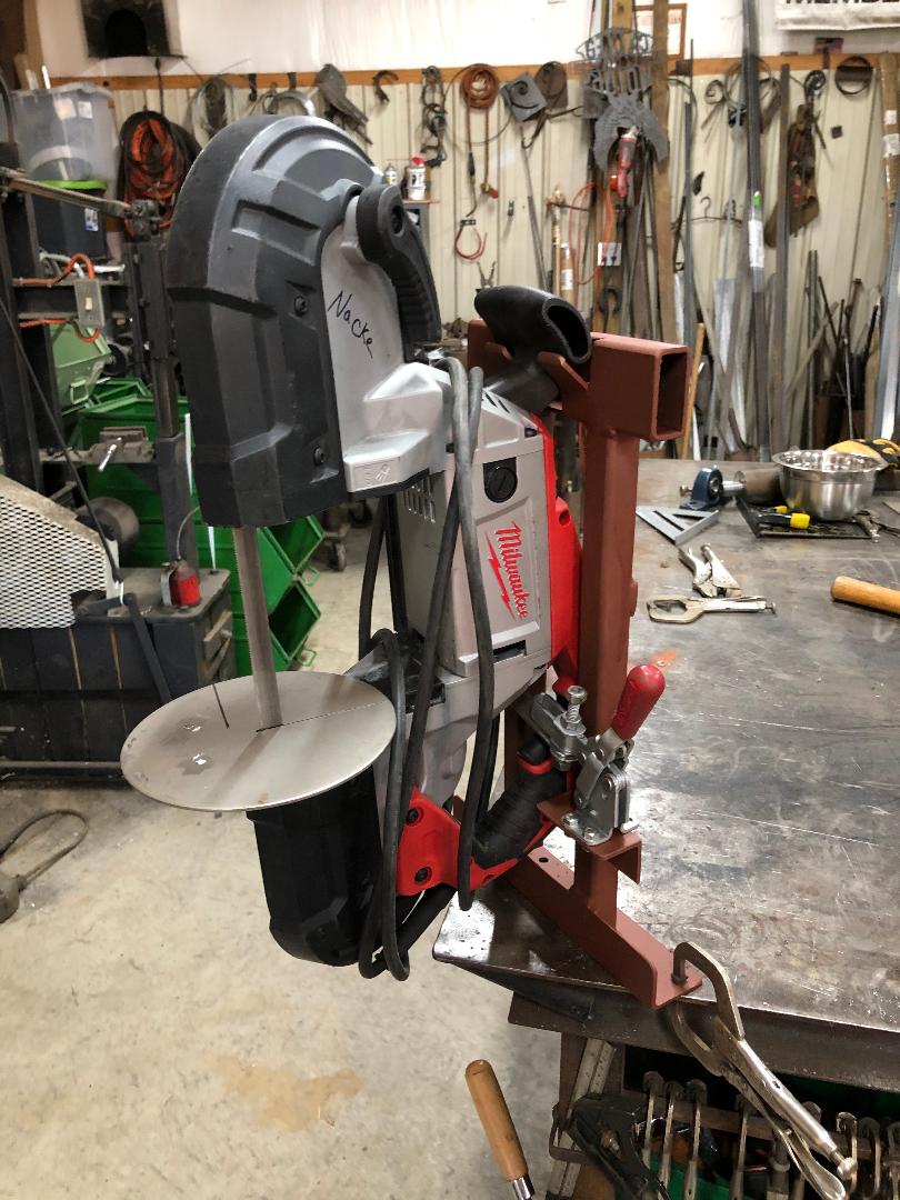

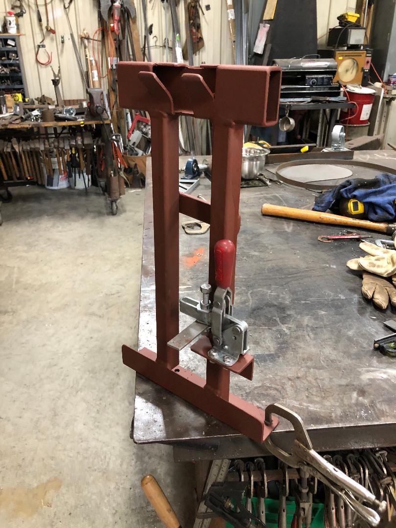

    Milwaukee Porta Band Stand
    A quick stand for my porta band!! Used a toggle clamp to work the trigger!! I was going to make a hitch style mount for it, then decided the flat would be better because I can just clamp it to any flat surface!!!
    Milwaukee Porta Band Stand-pb-stand.jpgMilwaukee Porta Band Stand-pb-stand-2.jpg
