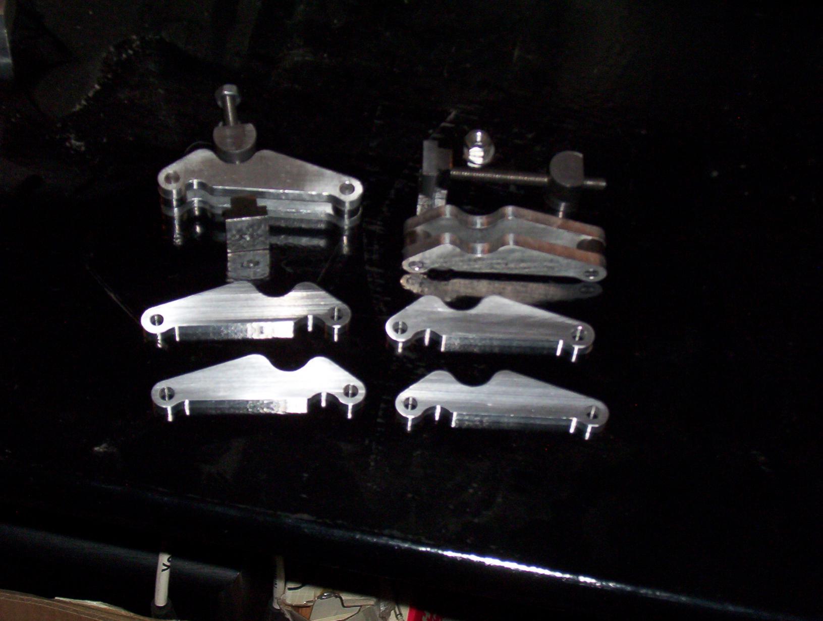

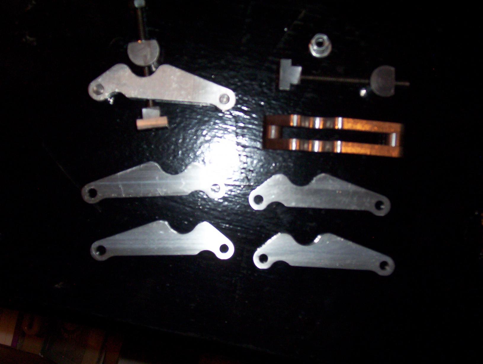

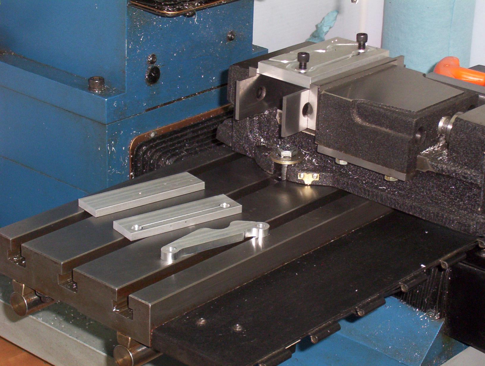

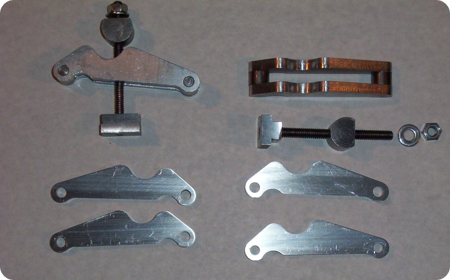

    I have made a number of these neat little clamps for my various projects over the years. I cannot take credit for the design as I copied it from an internet source but I no longer have a link for the original. Apart from the side profiles which are CNC cut on my milling machine all other parts are produced on manual machines. Making a few sets in a relaxing afternoon in the workshop! Review the pics and maybe view my short youtube video on cnc'ing the sides.

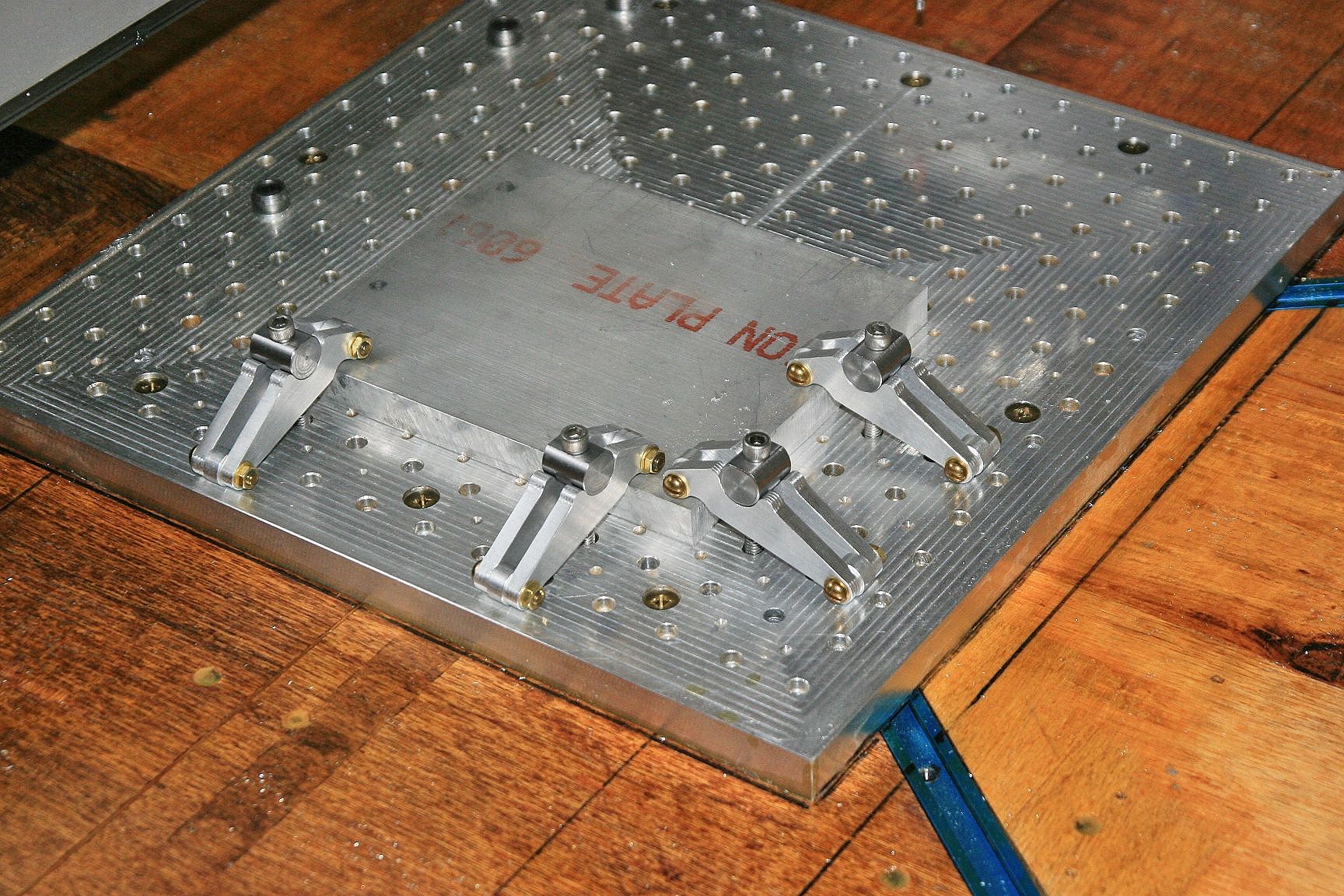

    I didn't mean any offense... I was only meaning that these types of rocker-clamp, or self-adjusting clamp has been used in the industry for a long time. The OP probably assumed those that can appreciate making them would know what types of jobs they would be used for. The clamps are fairly expensive to buy. A quick search right here on this forum shows user jjr2001 made similar style clamps, and shows them in use on his post. http://www.homemadetools.net/forum/m...n-clamps-66046
    I have the CAD files to make similar clamps. I scale them up or down according to what is needed. If anyone is interested in the files I can share them.
