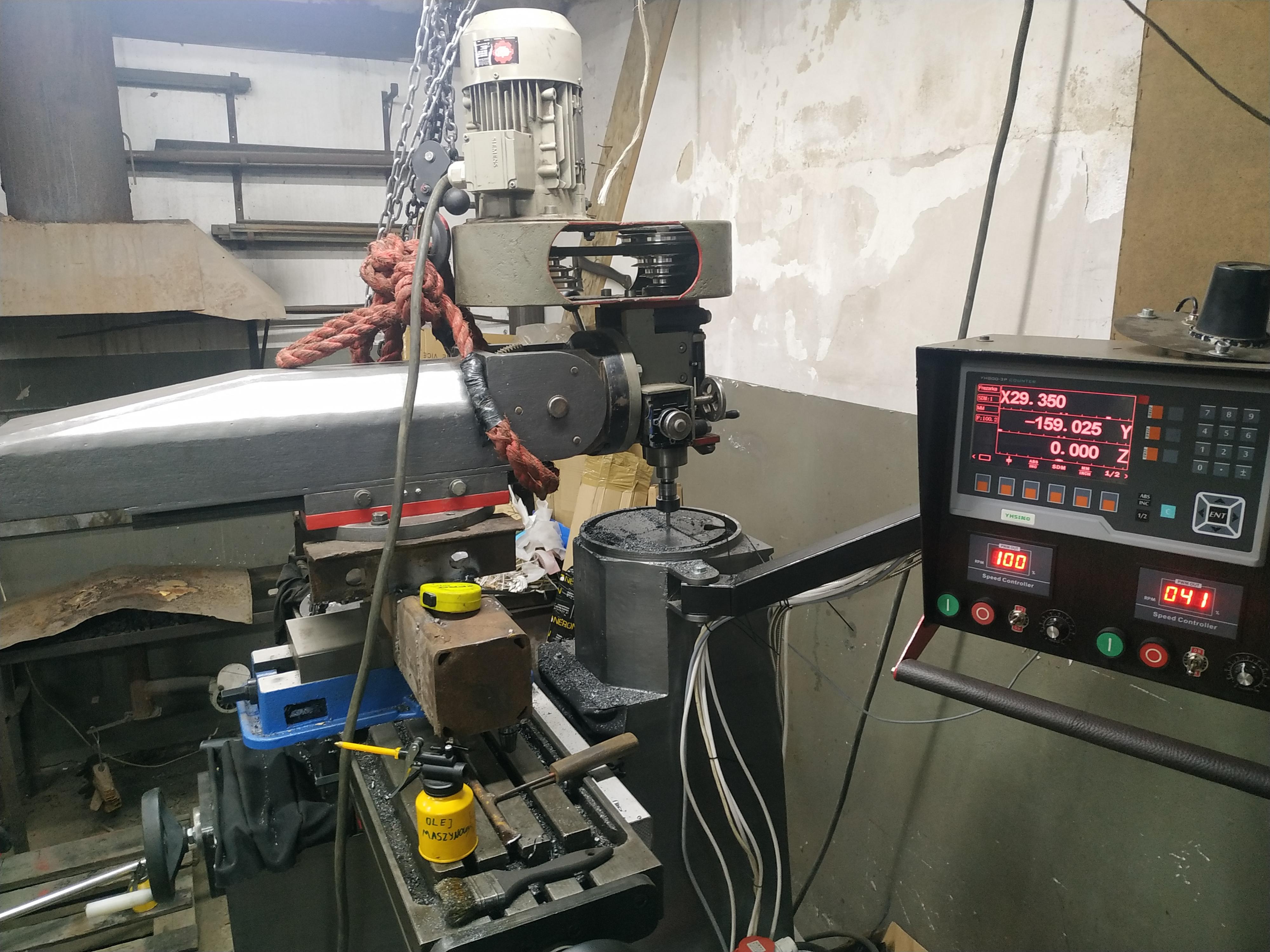

    I started fixing issues. One of them was warped surface under turret. I decided to mount turret on table and face it with endmill. Doing it in this way also makes plane of the turret parallel to XY plane.

    Quote Originally Posted by SteelCraft View Post
    I think it is time that you make a fly cutter. So much nicer surface finish for a sliding surface. This is a great way to make you machine better. Greater rigidity.

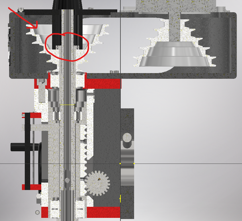

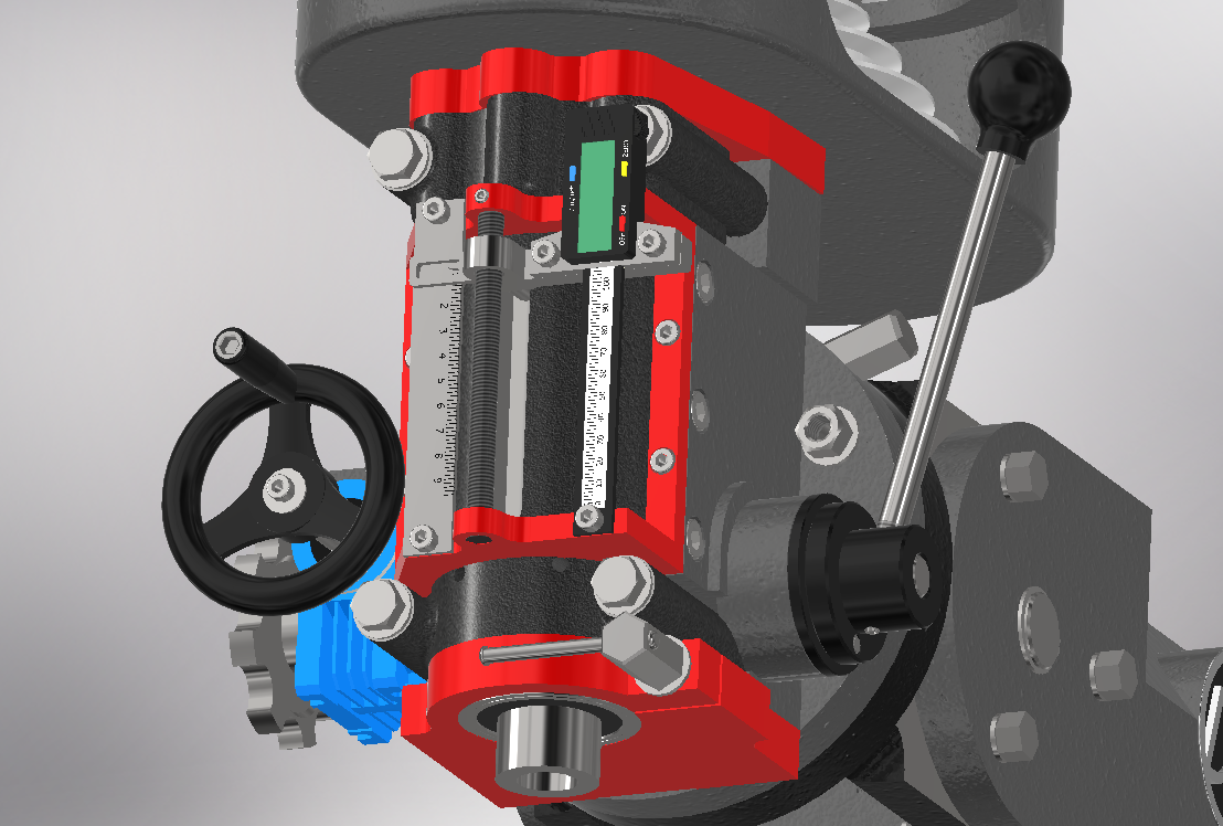

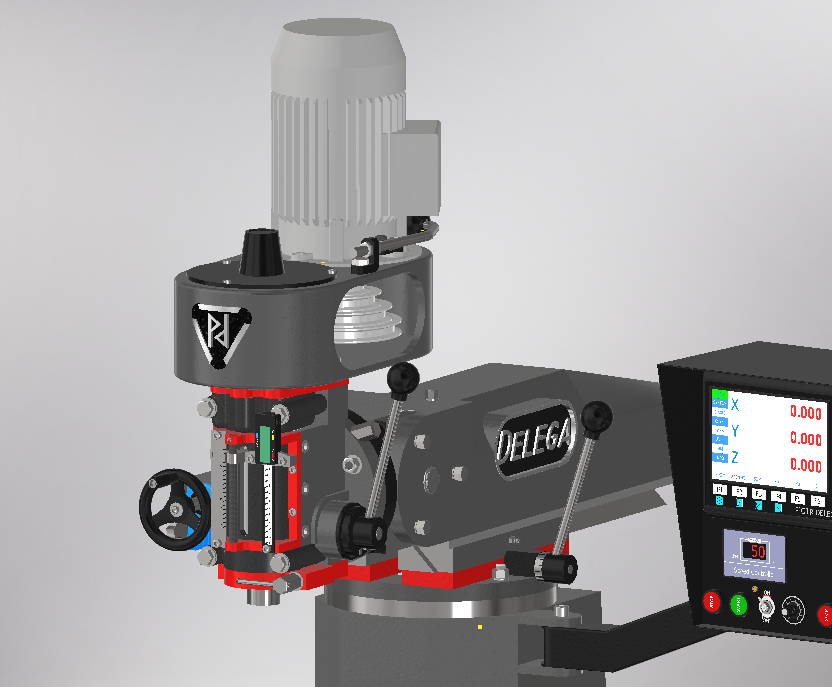

    As a final batch of improvements I'm going to build a new machine head and do some tweaks in Z axis guides.
    This is how new machine head will look like:
    Most important changes are:
    Thicker quill gear shaft,
    New quill lock,
    Better and more convenient placement of measuring instruments and manipulators,
    Added worm gear for head tilting like in real Bridgeport machine,
    Improved estheticks,
    Added supporting bearing above spindle pulley ( in red circle on screenshoot):
