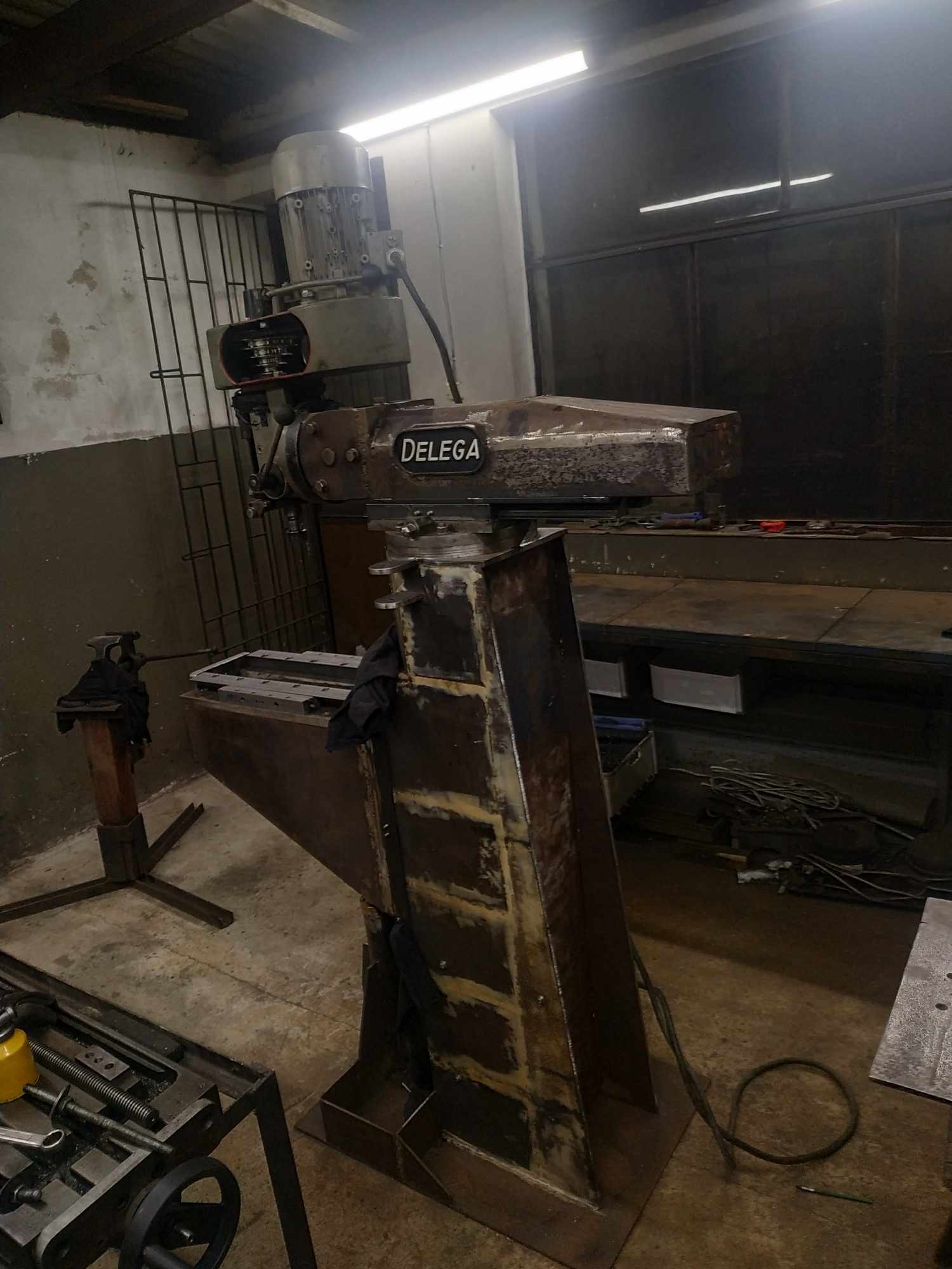

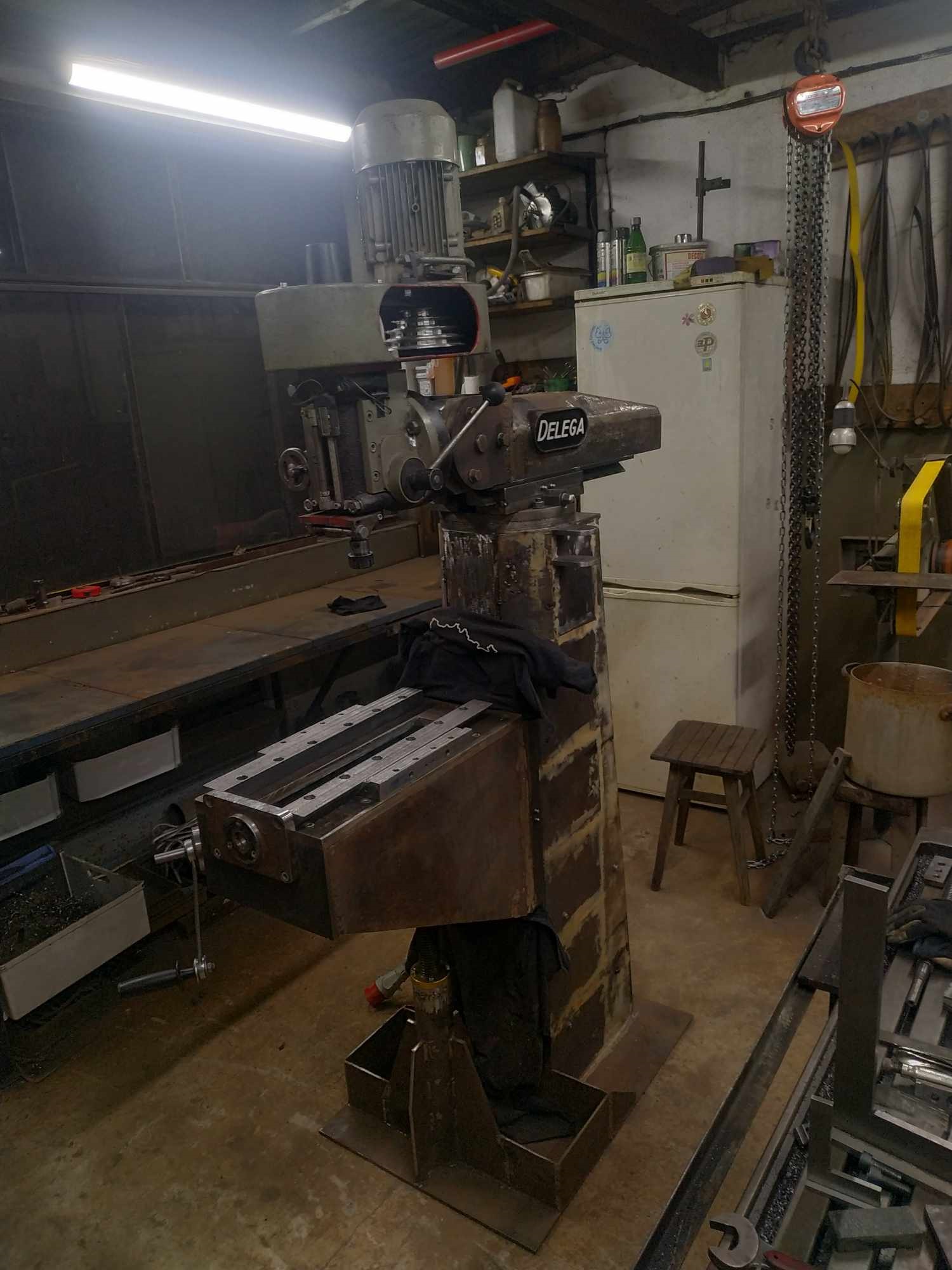

    Probably the most spectacular update so far :P It starts to look like milling machine
    Video soon!

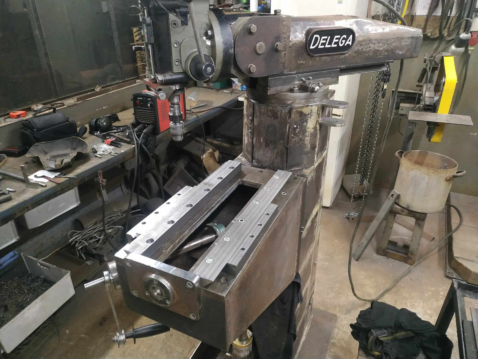

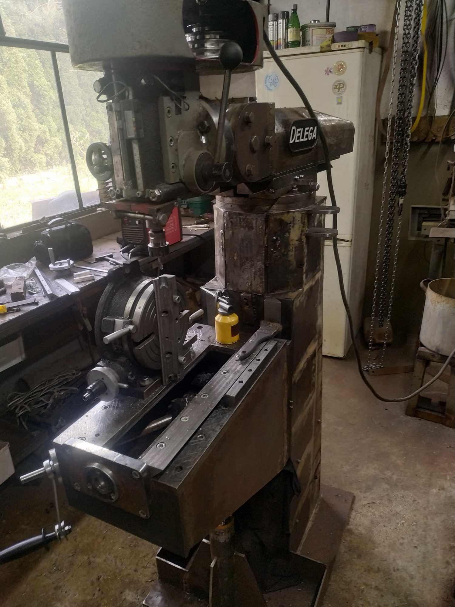

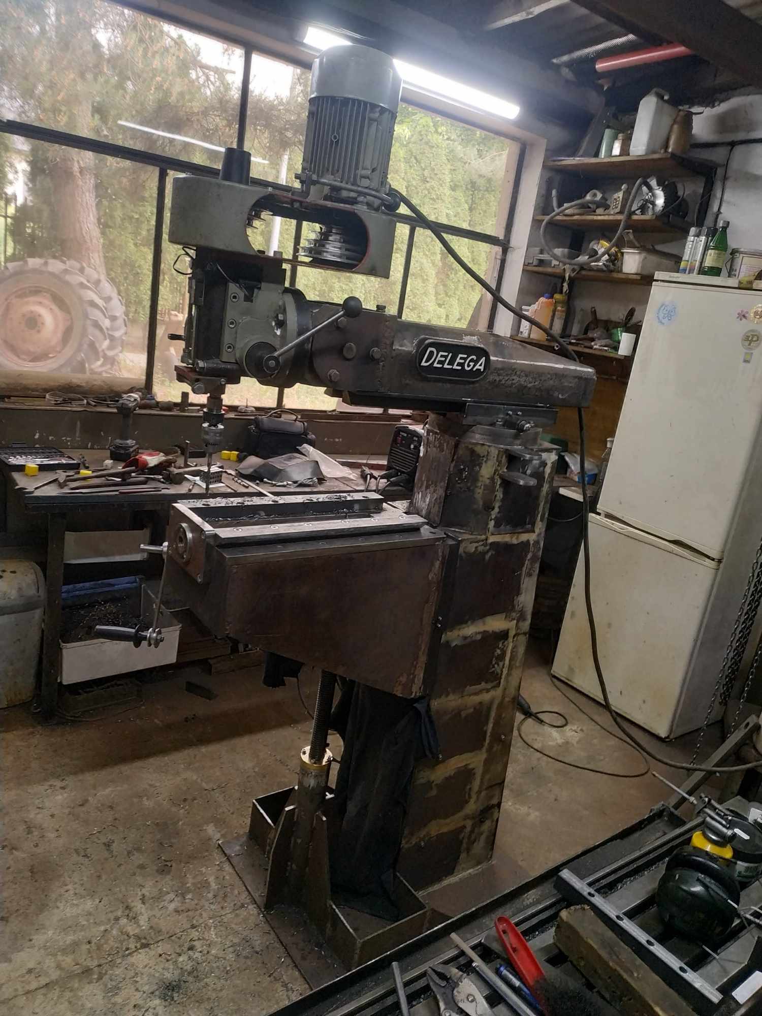

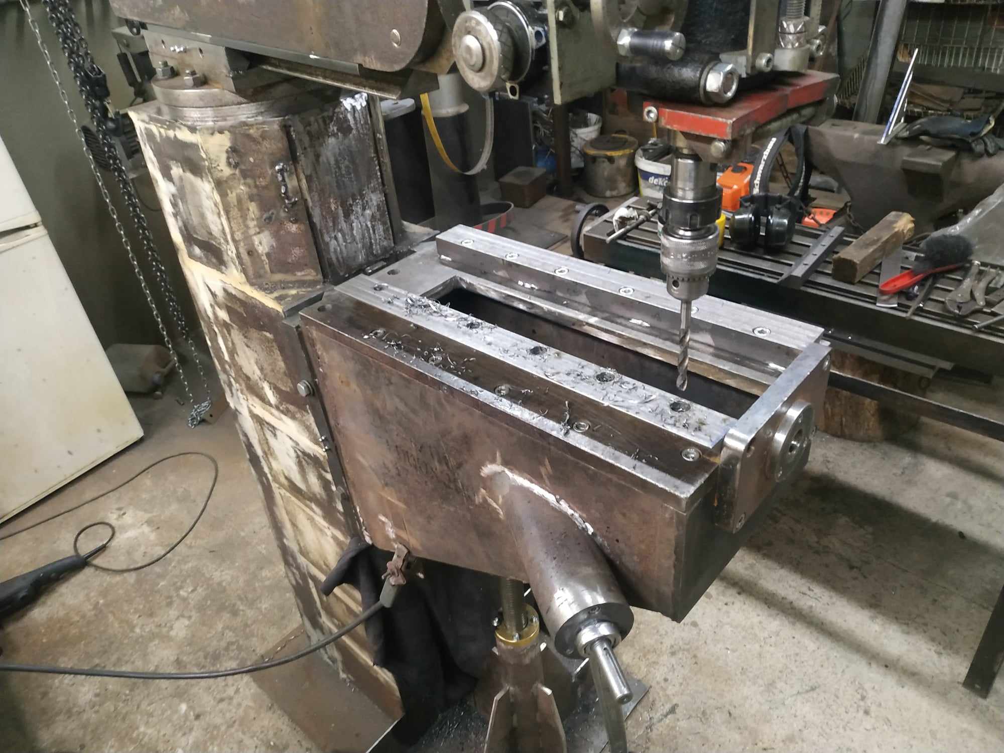

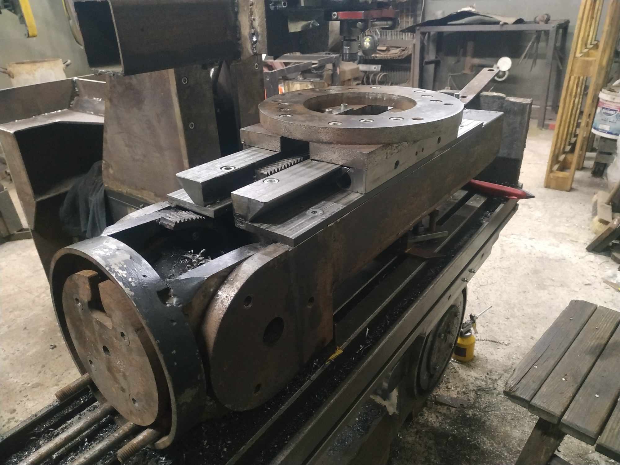

    Since last video, I drilled holes for Y axis guides. Drilling with rotary turret was fun. I was like radial drilling machine. Squarness was set to Z axis flat guides using 1-2-3 blocks and machinist square - it's the best I could do.
    Milling machine - video-436514984_1137769084107801_7884399088817499230_n.jpg
    Milling machine - video-442444048_1510379856558241_8610688499718574400_n.jpg
    I made flat bottom countersunks for gib setscrews by plunge milling.

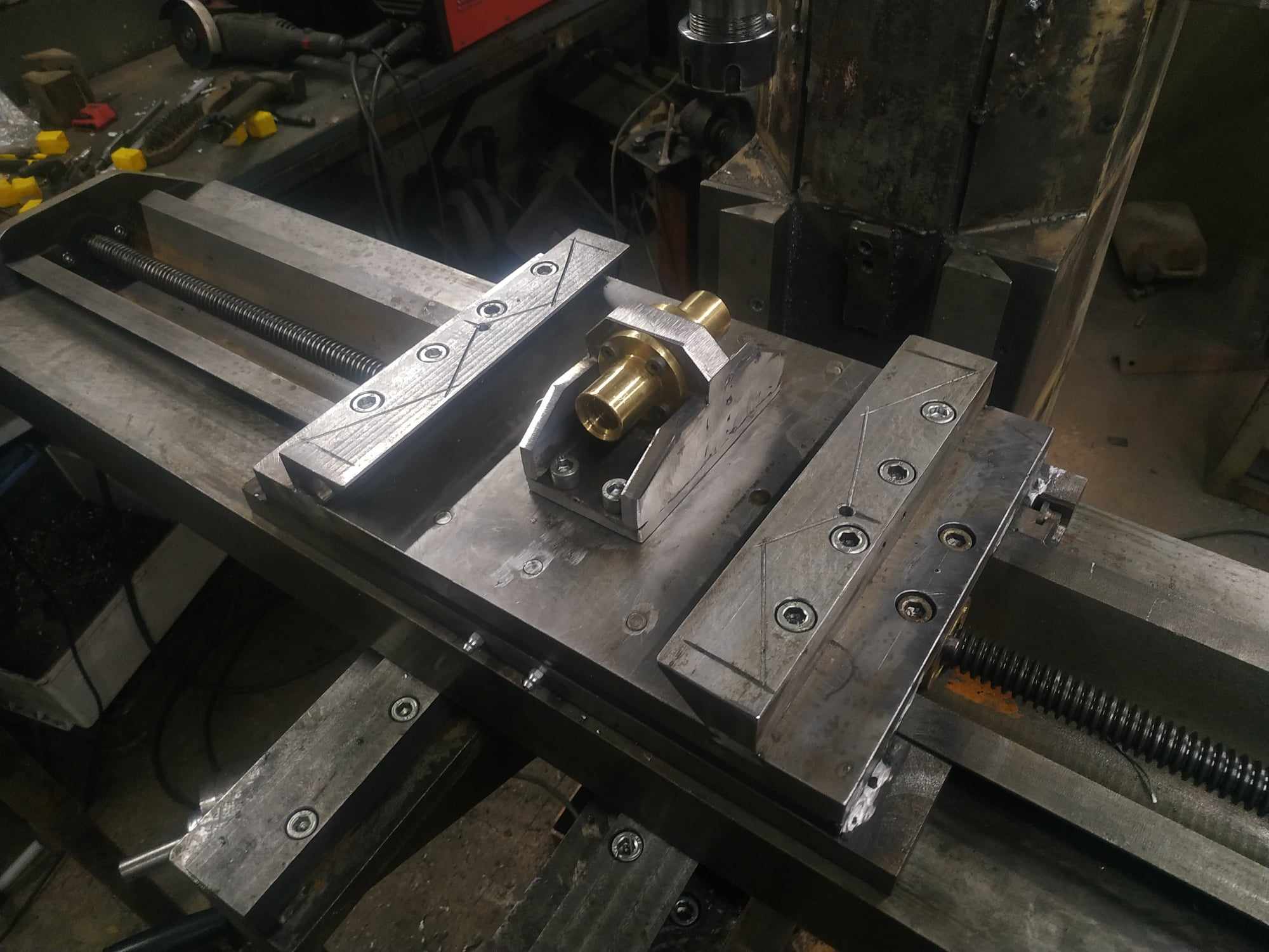

    This is bracket with leadscrew nuts

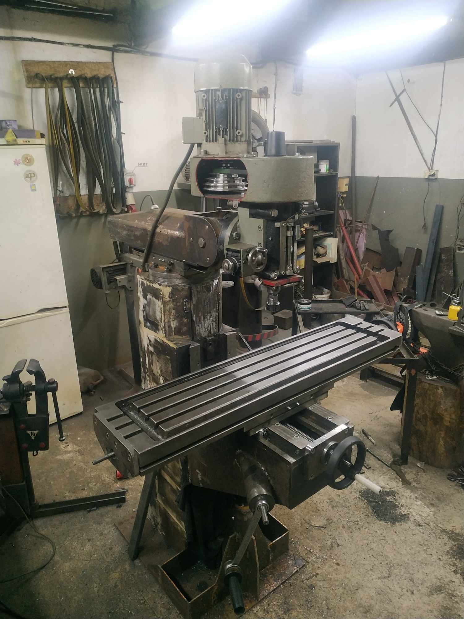

    Assembled milling machine.
    Milling machine - video-436528124_1404828210221987_6097361949047539532_n.jpg
    There is still a lot of things to do so stay tuned

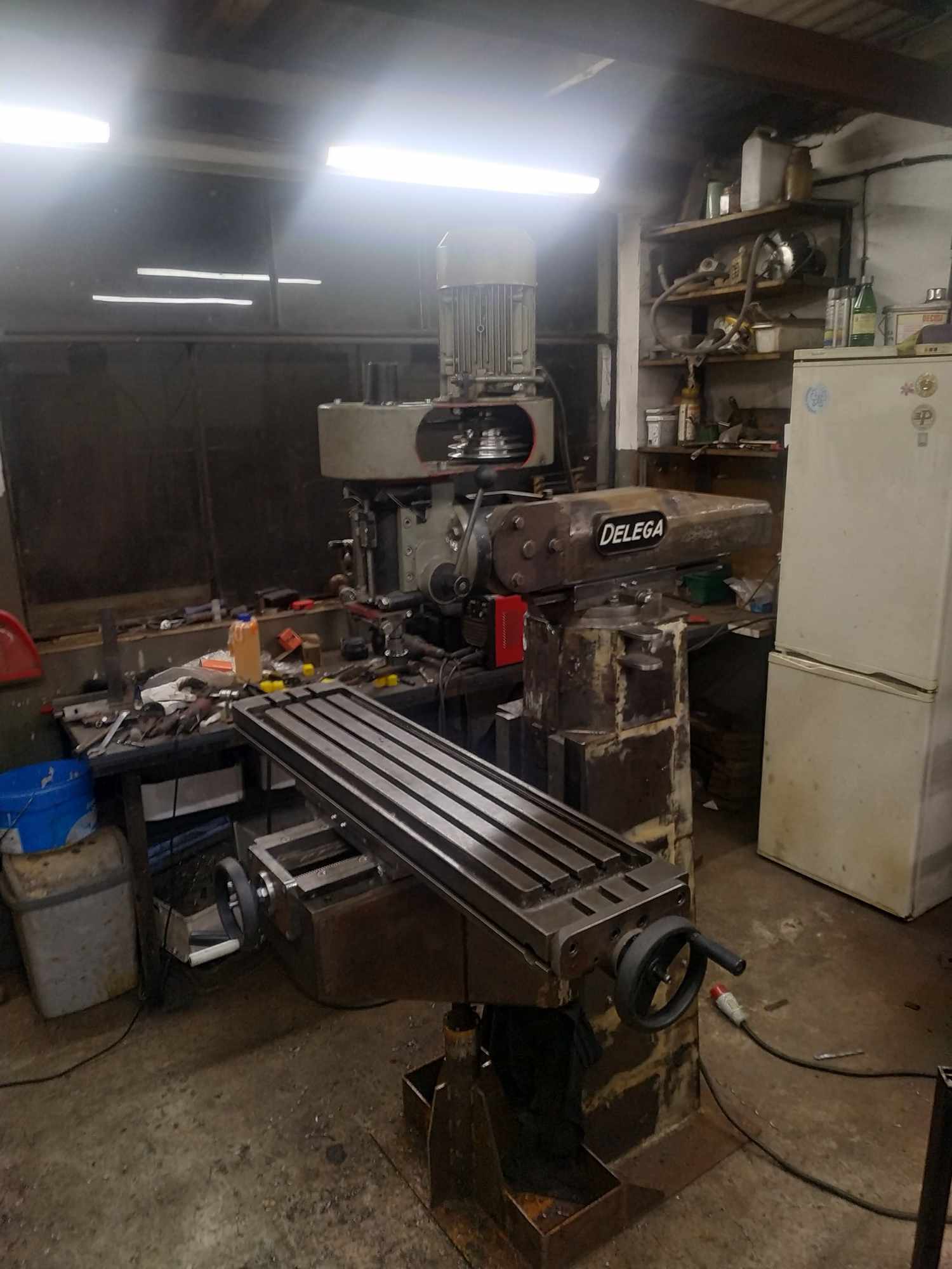

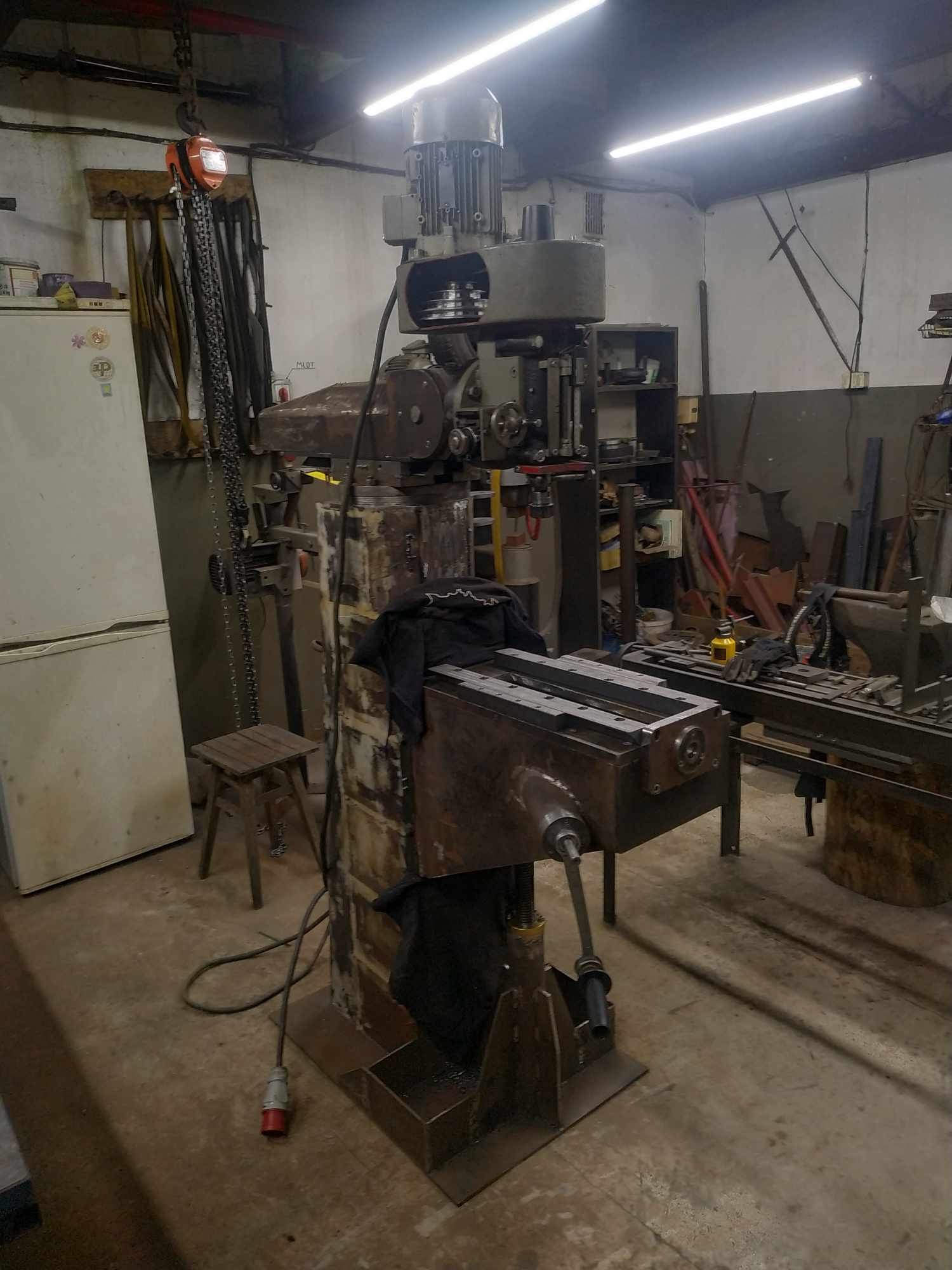

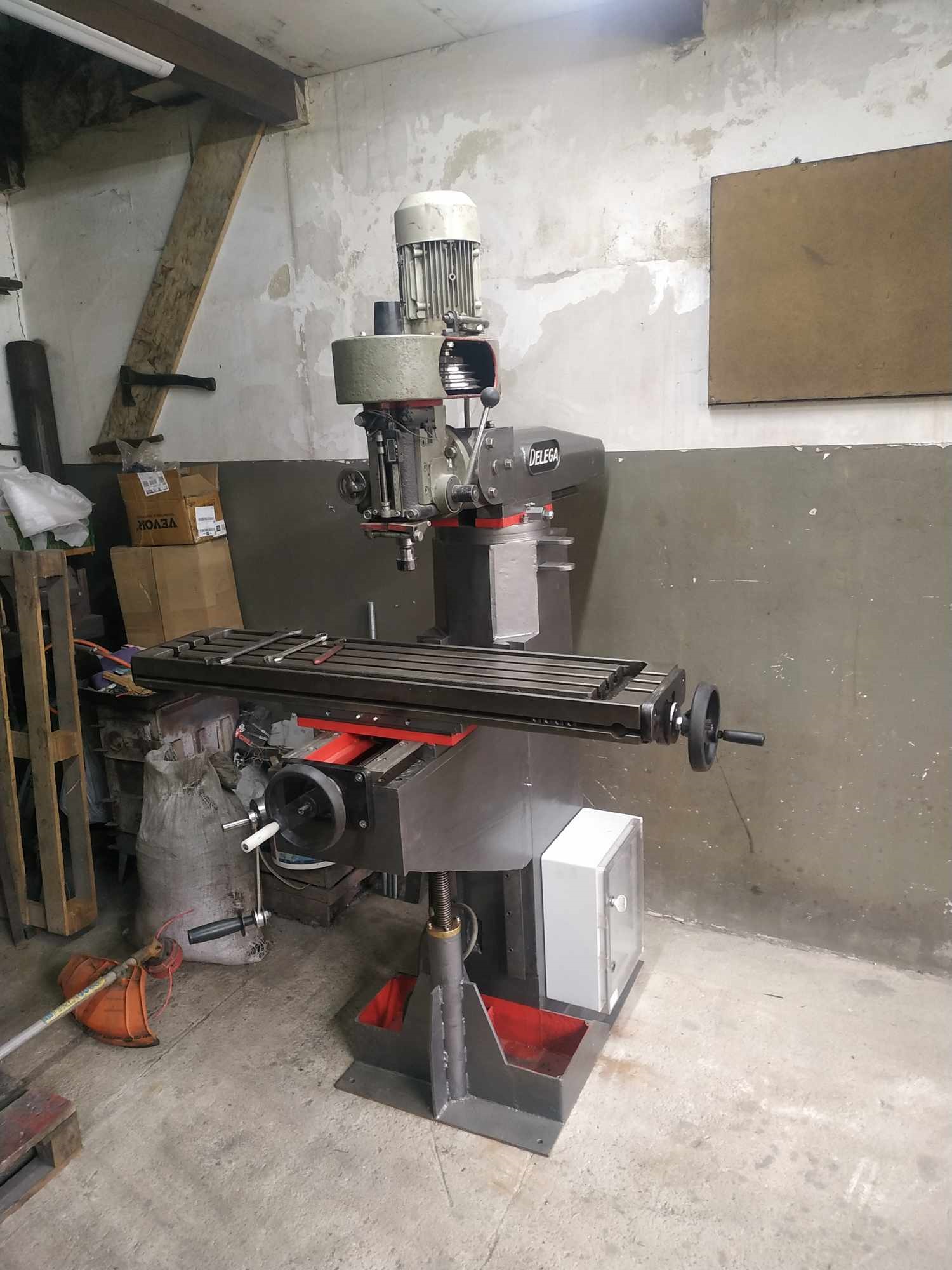

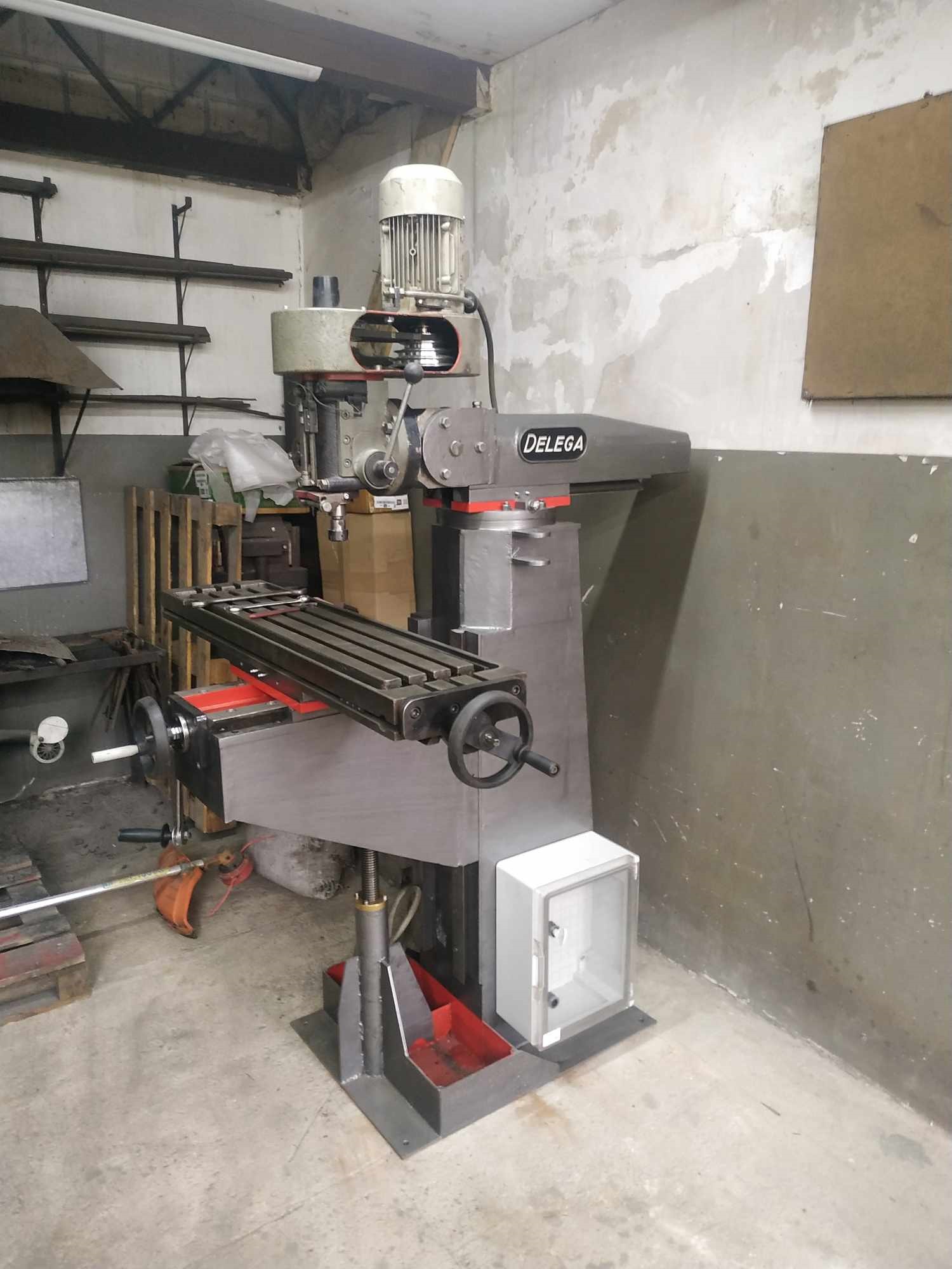

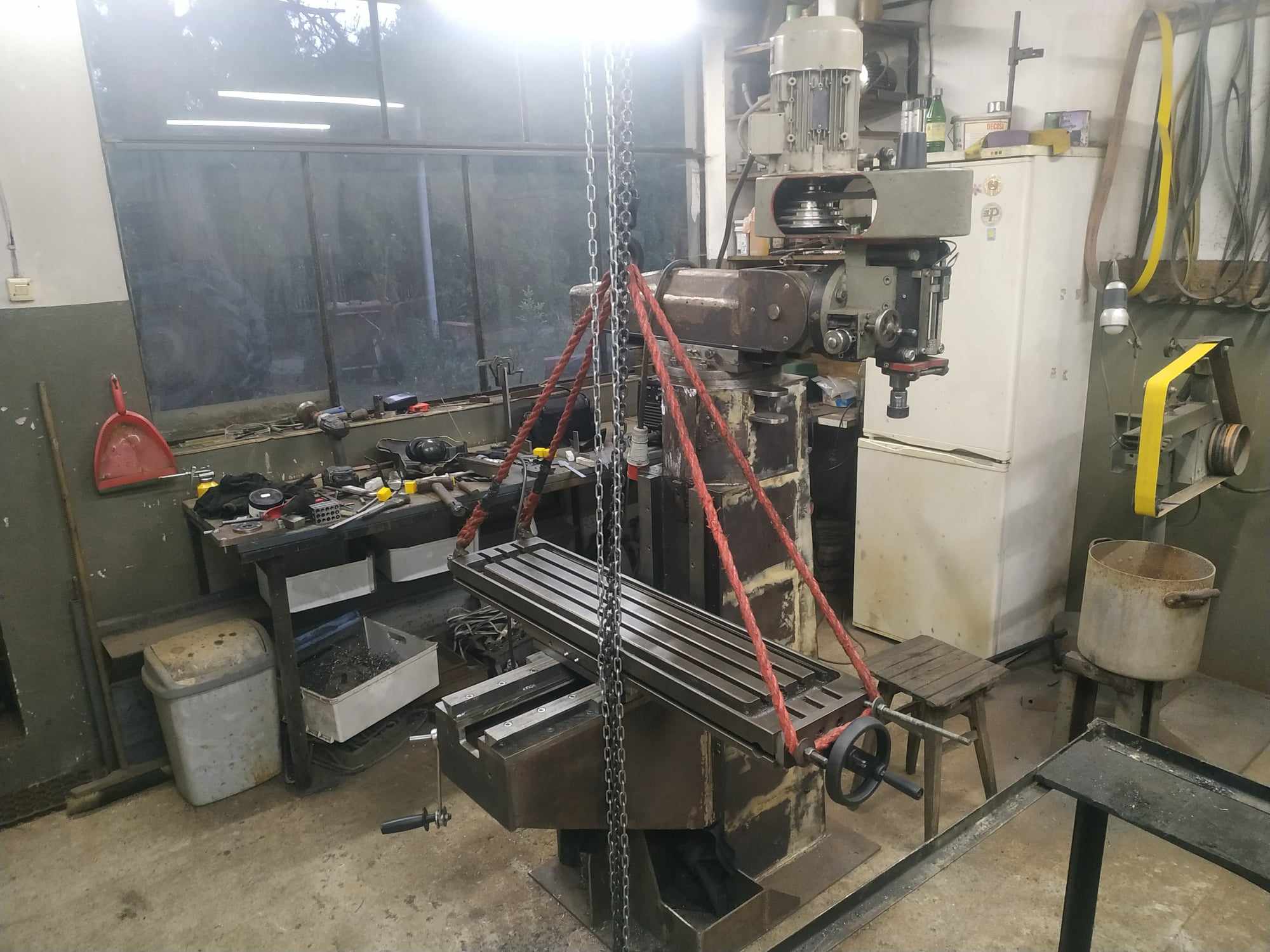

    Painted. On final position.
    Milling head will be improved and painted later.

    I paid about $500 for my 49x9, I couldnot of built it for 3x that. good work. if it has a harmonic you may be able to fill some portions of it to dampen it.

    Whole column is filled with compacted sand. Should work fine. New video soon.

    sounds good.just dont let it absorb moisture and start rust growing...
