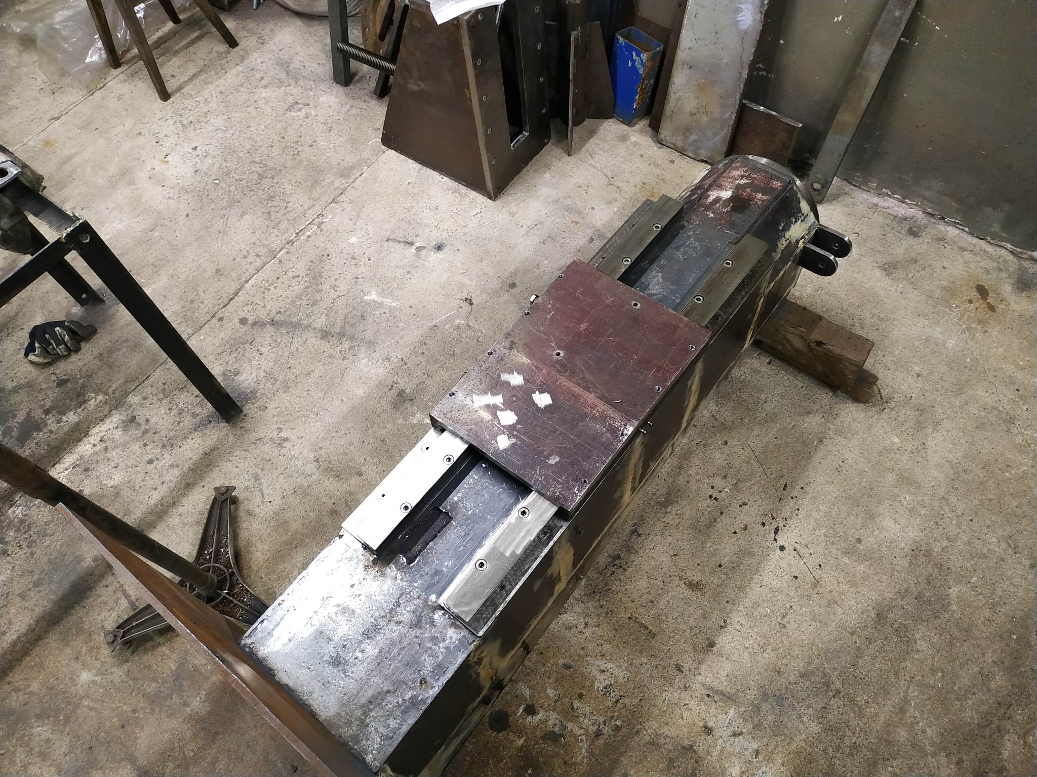

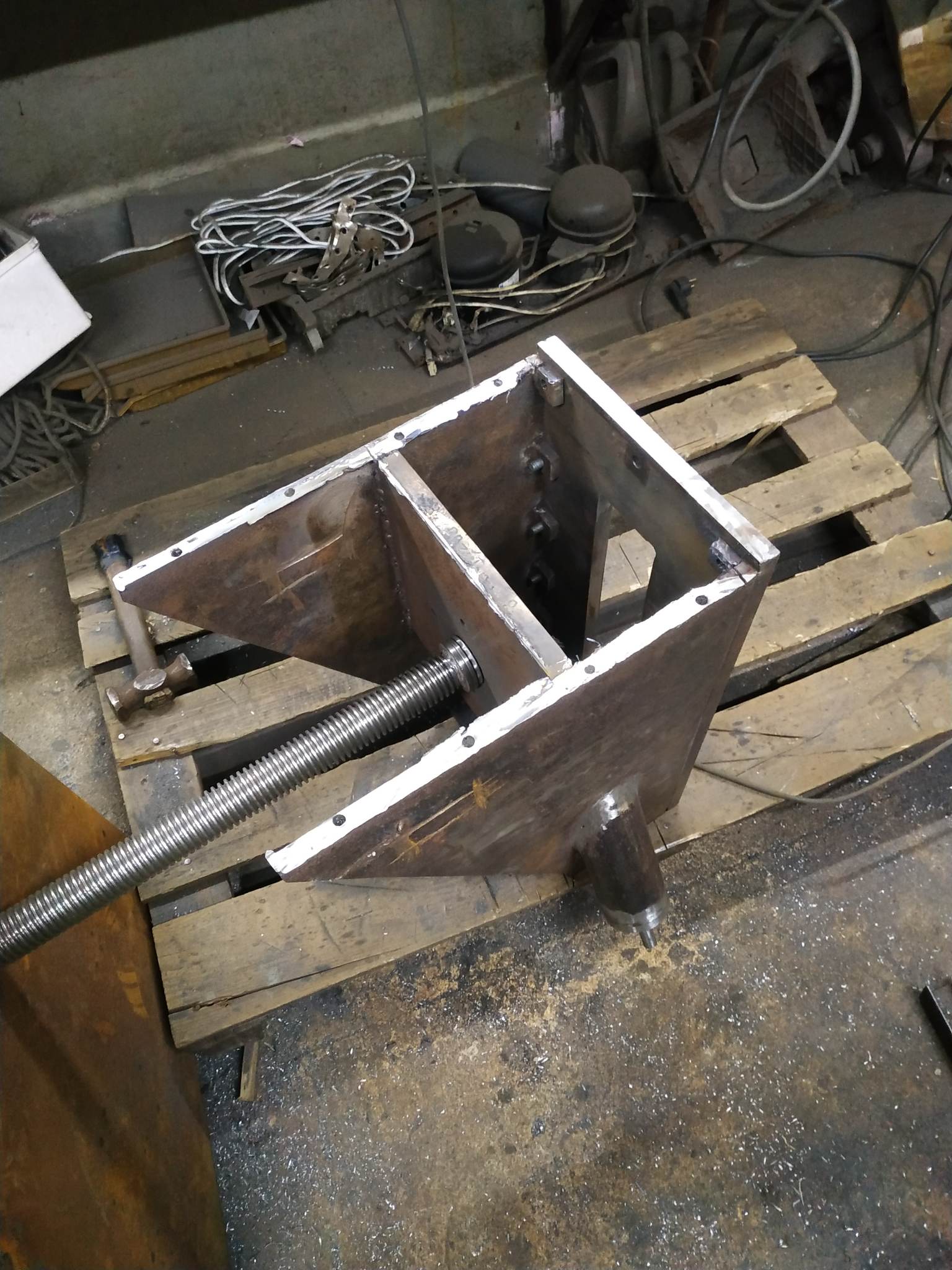

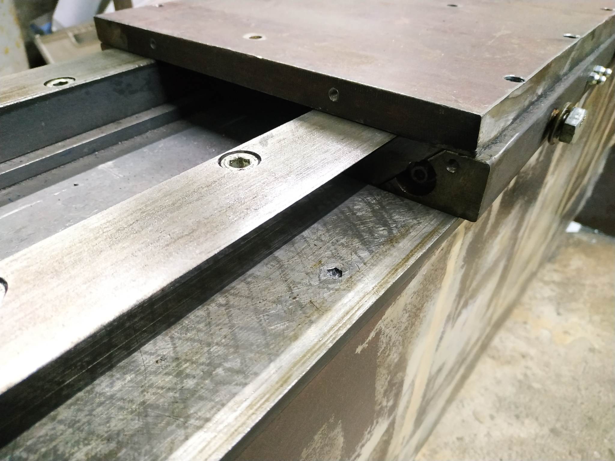

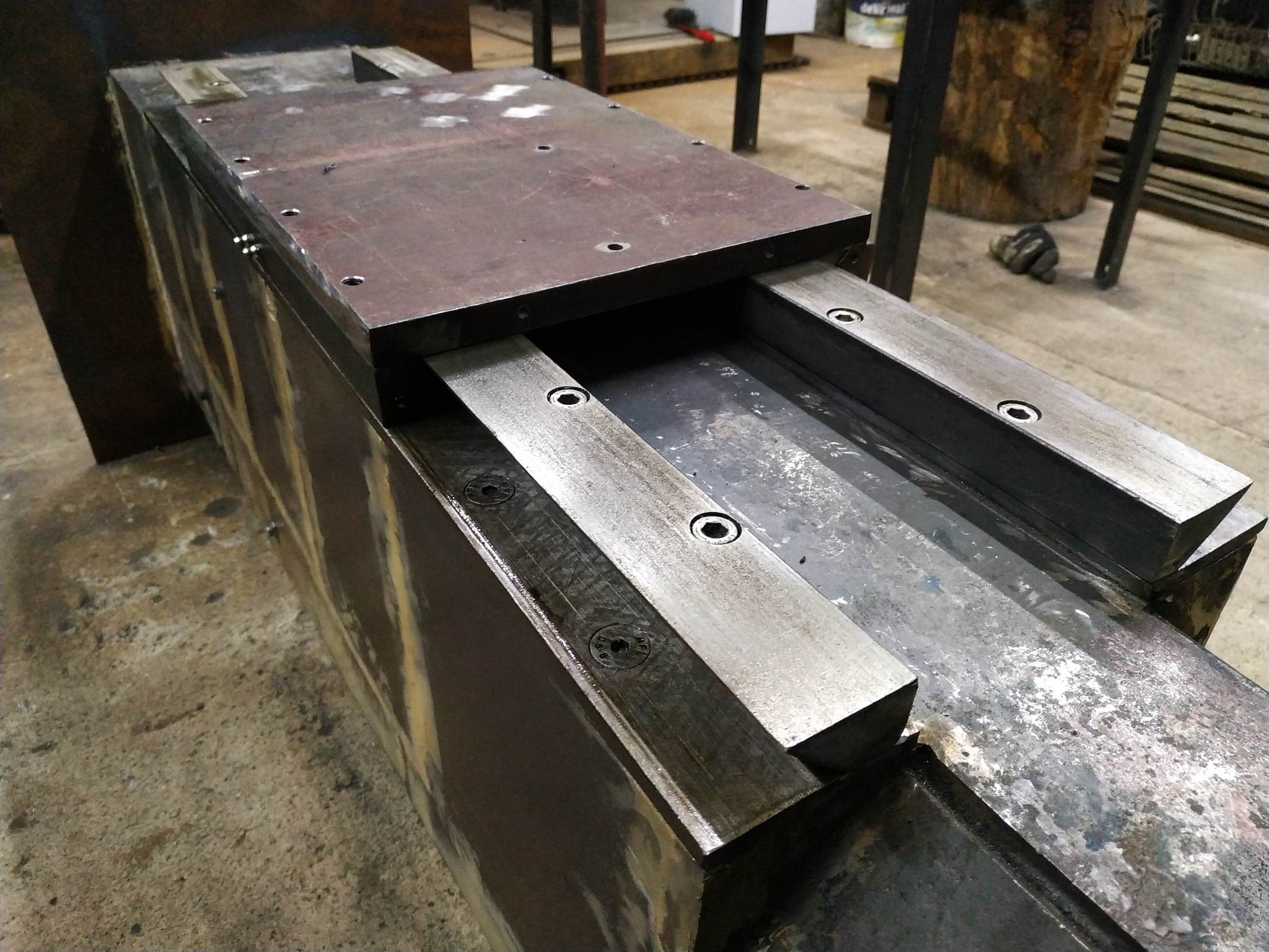

    Hello
    Some newest photos. Ton of hand scraping done in those photos and still one of the guides (right one) is 0,2 mm wider on last 15 cm on the bottom. I found this defect after putting everything together, rest 70cm works perfectly. So more hand scraping is waiting...
    Milling machine - video-384501923_335207272253983_734781195618313958_n.jpgMilling machine - video-384505819_1049184536106313_8536135045503301513_n.jpgMilling machine - video-384506077_305541062112784_3491760648884839590_n.jpg
    Oh and I screw up a backplate of the knee. It turned out that Y axis would not be square to Z axis of the machine. It was like 2mm of difference on distance of 530 mm. I tried to grind the backplate but I made it worse. I mean It was square vertically but got twisted. I had to cut off this piece and make, a new one (you can see it on photos above).

    You are getting an education that few people will ever have. Not good you need to do work two times. But you certainly are learning a great amount about how to make better setup and better welding.

    Repairing knee is not that bad, it's like 2 extra hours of work. The worst is extra scraping. It will wait to christmas break. I'm back on university now.
