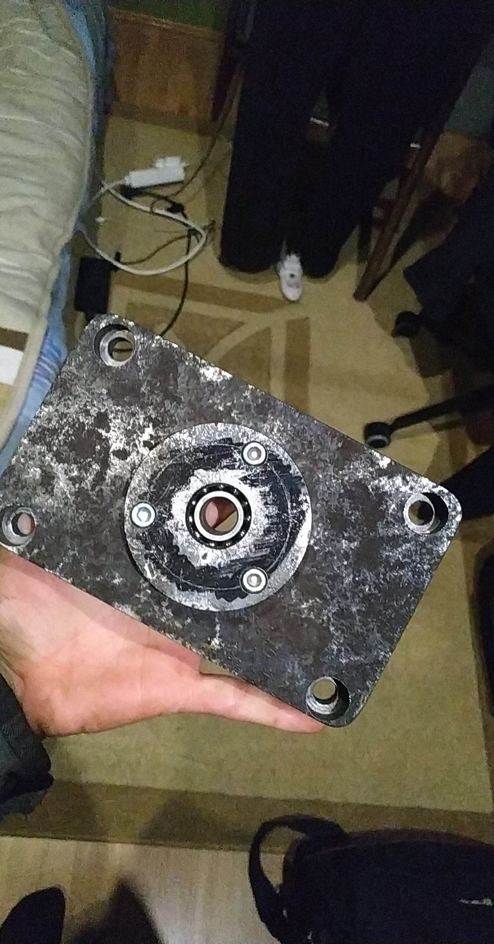

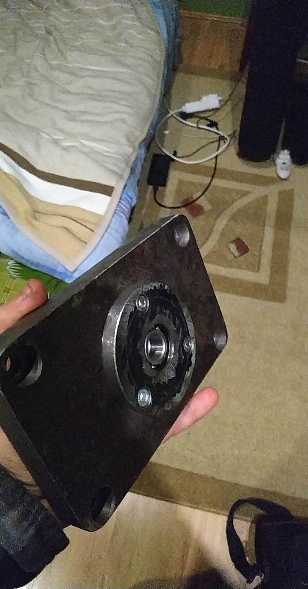

    Assembled bearing block. I used two angular contact bearing.
    New video will be uploaded in the end of this week.

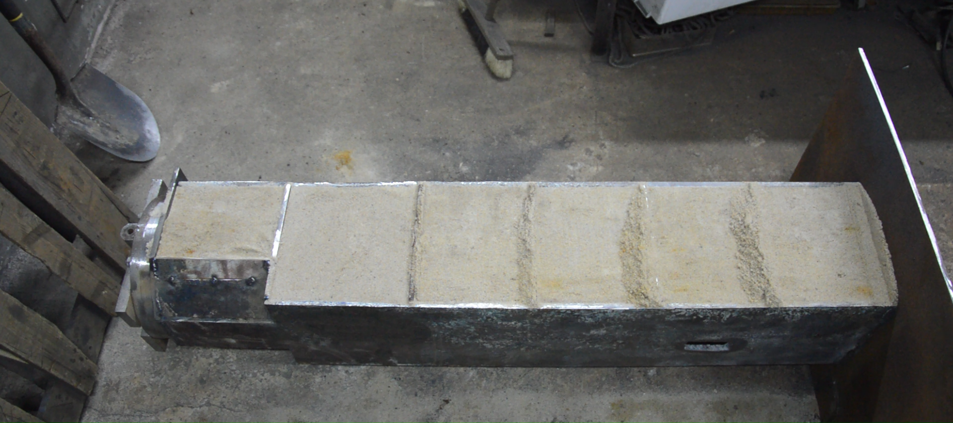

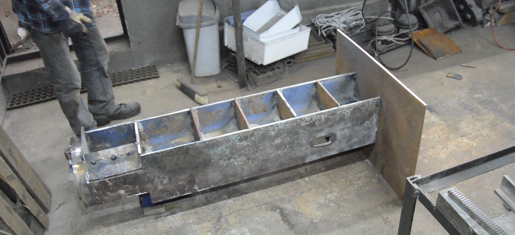

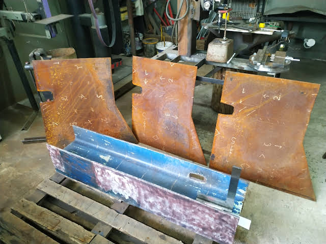

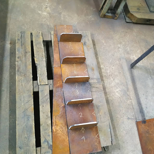

    Update
    Currently building a column of my milling machine.
    Next video coming soon

    Very nice! Sand filled or concrete filled?
    I think that this will be a great column for your mill.

    It's sand filled. I think compacted sand will be better for damping than concrete which can shrink. Sand always self adjust to walls of column.
