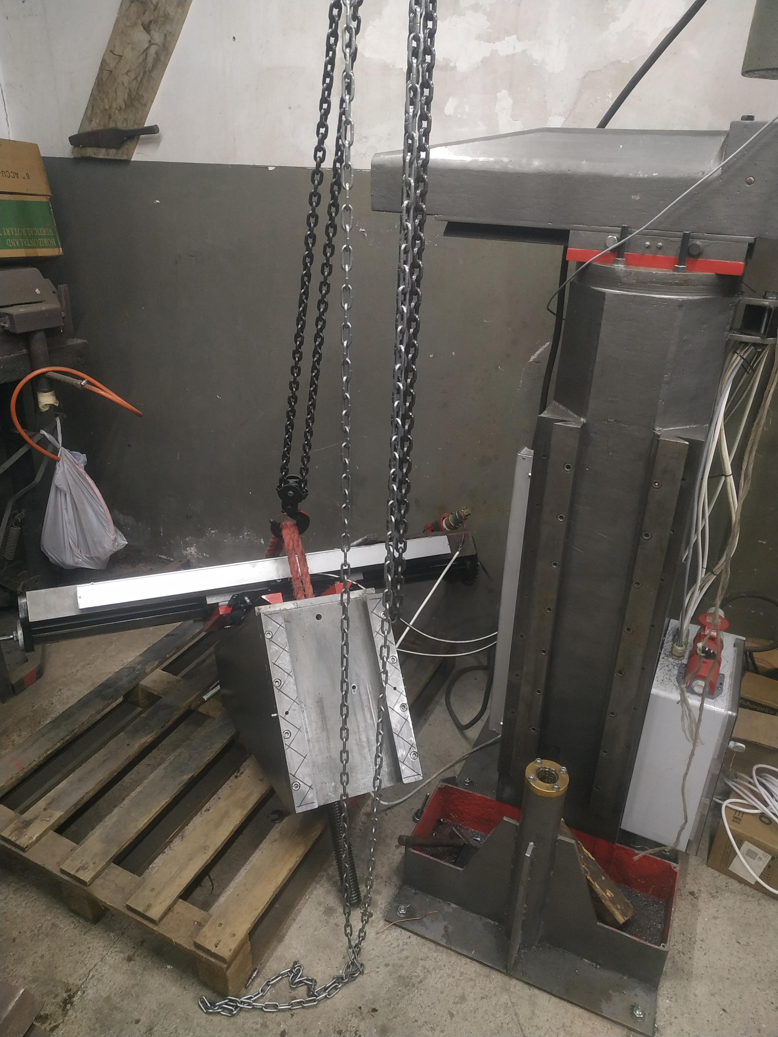

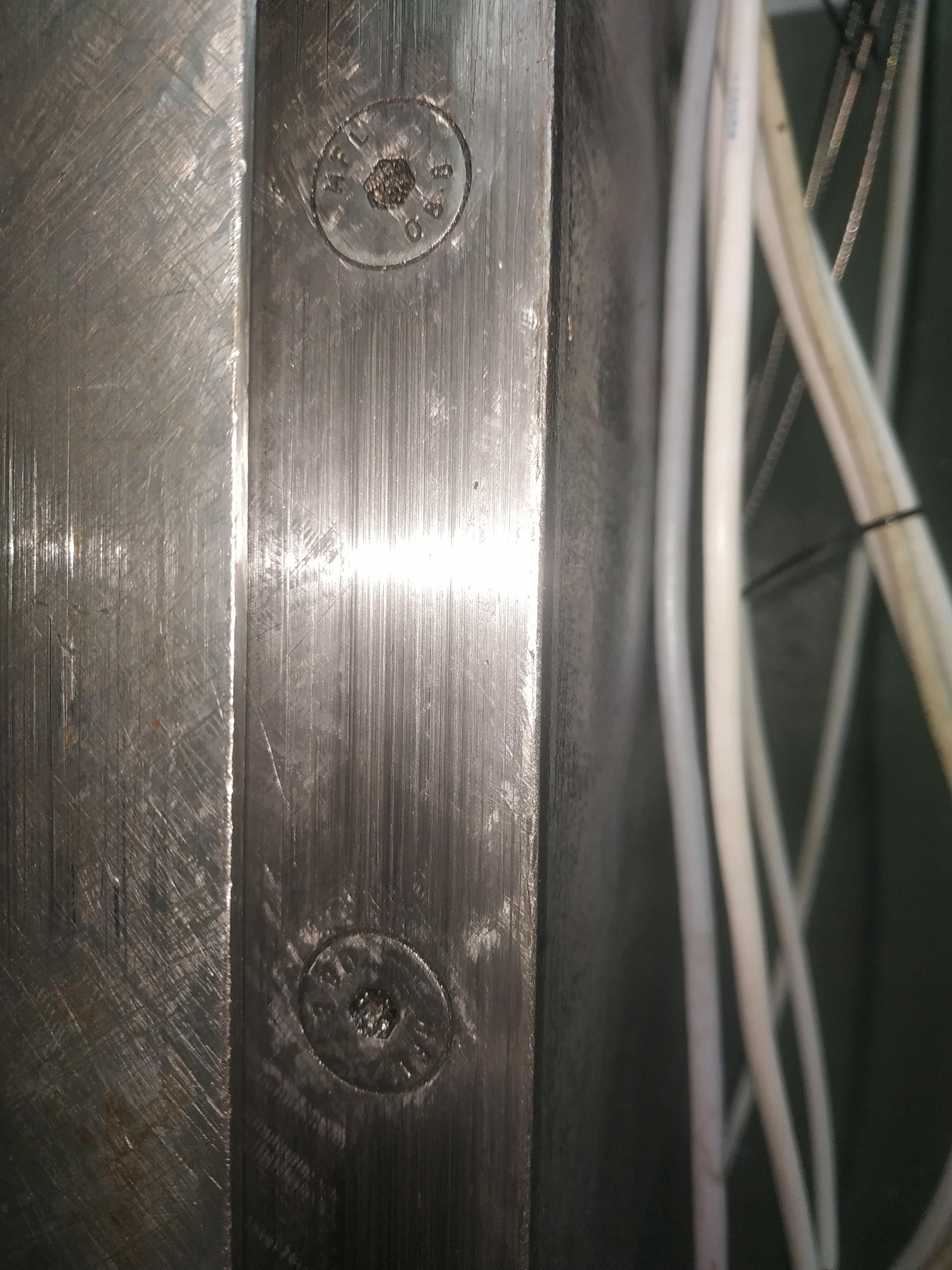

    Today I noticed that wiggle in knee got worse, I thought it's time to tighten the Z axis gib and it went to the end of its motion range. Absolutely catastrophe. I was fully aware that steel on steel guides will not last very long but I wasn't expected that happen that quickly.
    X and Y axis guides looks still very good. Only Z axis got literally plowed. I don't know what to do. Buying HGR linear guide sounds like only reasonable option because even after remachining all this will probably repeat quickly.
    I did some calculation in HIWIN linear guide configurator software and HGR 20 should be enough.

    Quote Originally Posted by SteelCraft View Post
    Several months back I changed the X axis dovetails on my lathe to linear ball rails. I would highly recommend it. I wish my BP mill had them.

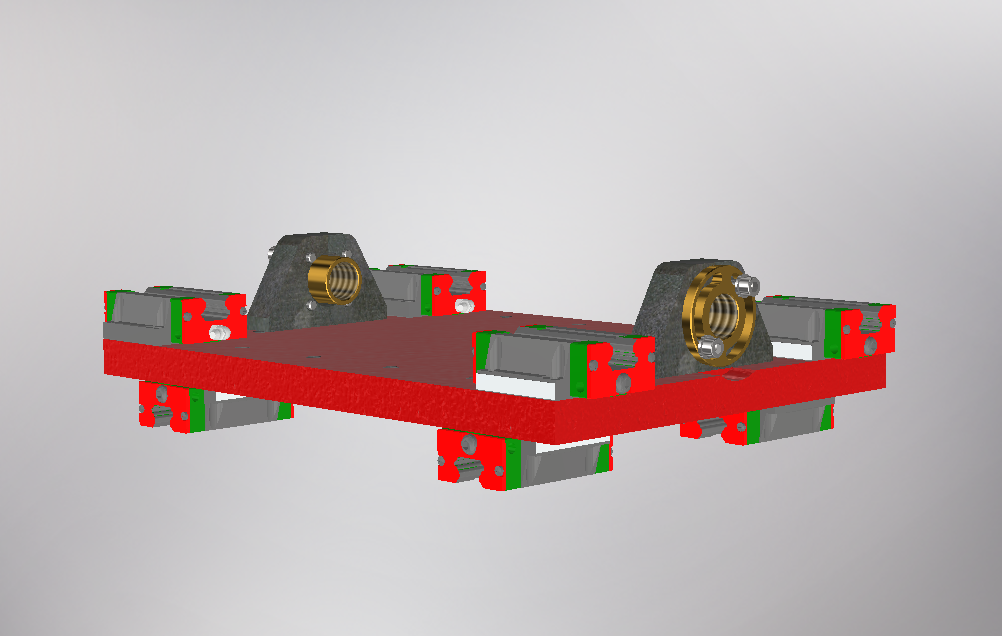

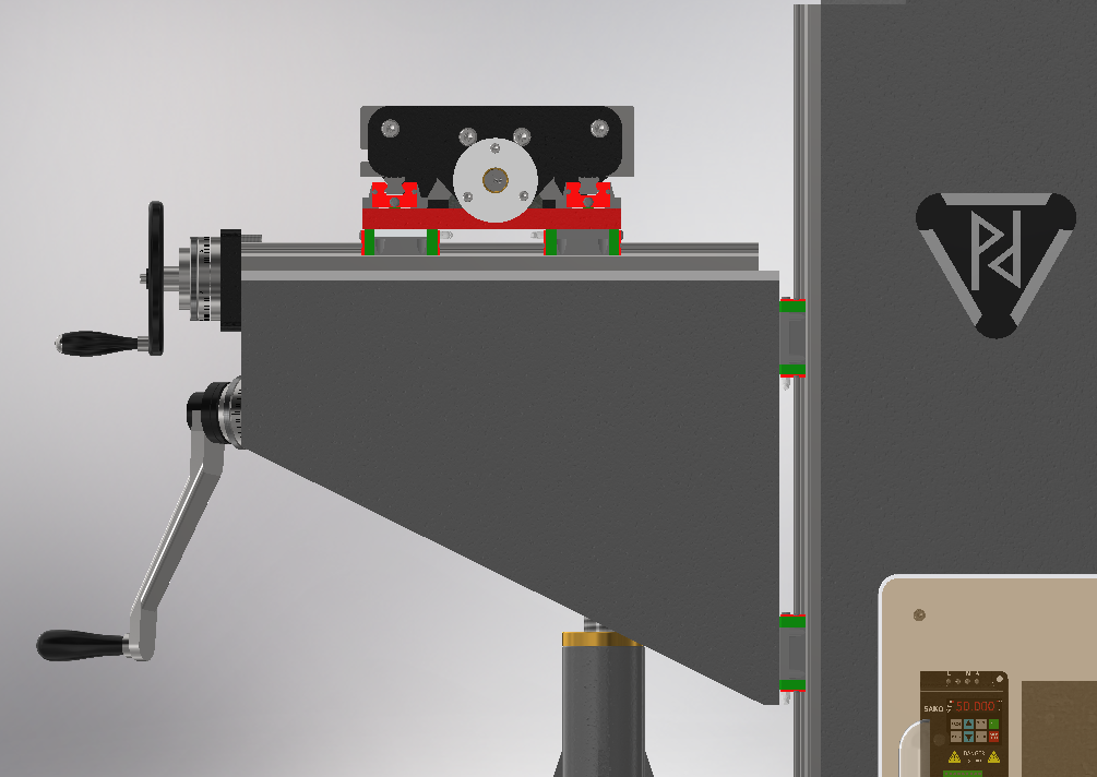

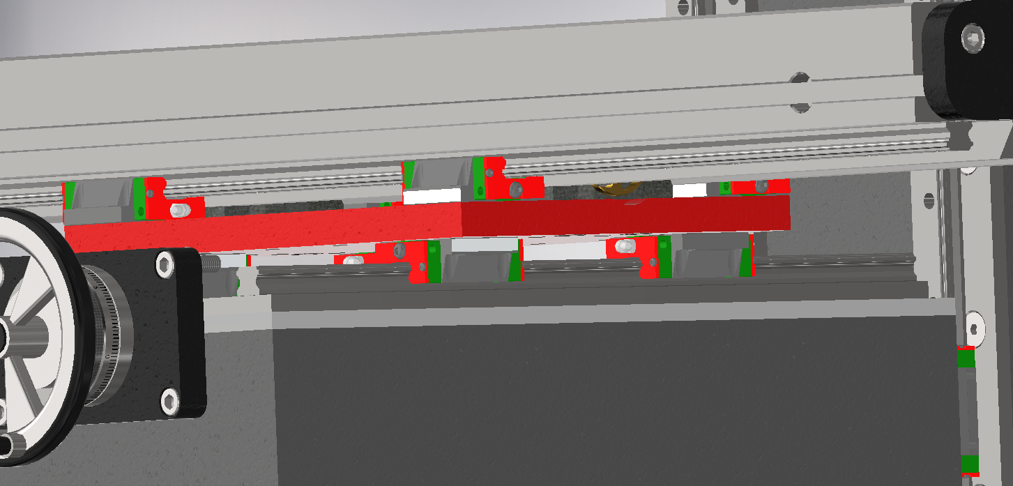

    I converted my 3D model to new guides. Only one probleam appeared. Dove tails of table collide with carts.

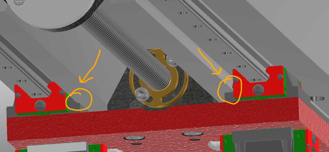

    This is where it collides:
    Cut them off?
  8. The Following 2 Users Say Thank You to SteelCraft For This Useful Post:

    "Cut them off" Yes if they are in the way then get rid of them. I think that if you make your proposed changes then your mill will be at least 1 or 2 levels higher. Good luck. I shall follow with interest and great anticipation. One day I would love to visit Poland.
    One thing to remember is that if your lift screw for the knee is under the centre of gravity of the knee/table assembly then there will be very little load on the Knee rails and even with the table at the extremes of movement the load on the knee slides is never very high.
    One thing to consider is that to get the best from linear ball slides you also need to use ball screws for the motion as well. When I converted my lathe that was even more important than the linear ball slides.
    One tricky aspect to using linear ball rails, unless you have CNC or electronic control, is how to lock the different axis.
  10. The Following 2 Users Say Thank You to tonyfoale For This Useful Post:
