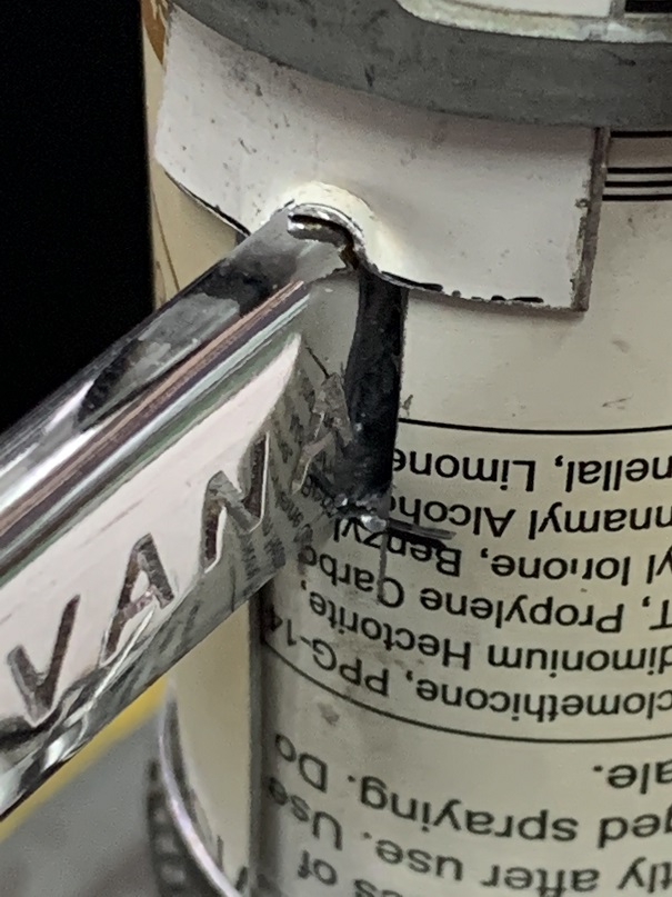

    I wanted to make a mold that if I do not get it to release from the lead hammer it would not be a problem. So a mild steel or stainless steel mold would not work.
    Then I saw my wife's deodorant tin. That was substantially thicker than a beer tin and not too far off the perfect size.

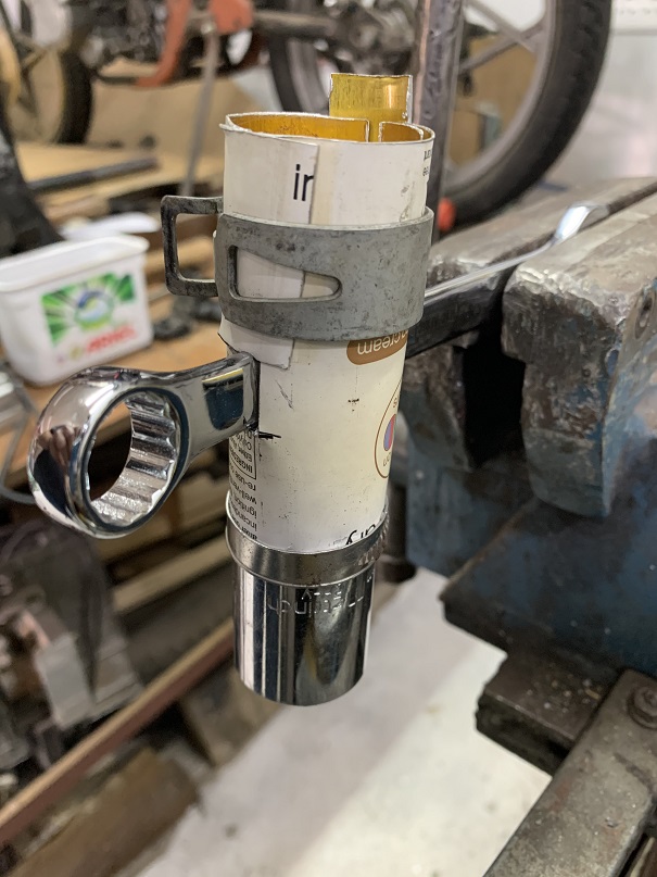

    So with a bit of fetling, a few hose clamps, a socket with the square drive fitted to be used as the base of the mold I was ready to pour. I did roughen up the spanner where the lead would be in contact with it.
    What I did to minimize the gaps around the spanner shaft was to give the "filer" pieces a slight tap from the top to deform around the shaft.

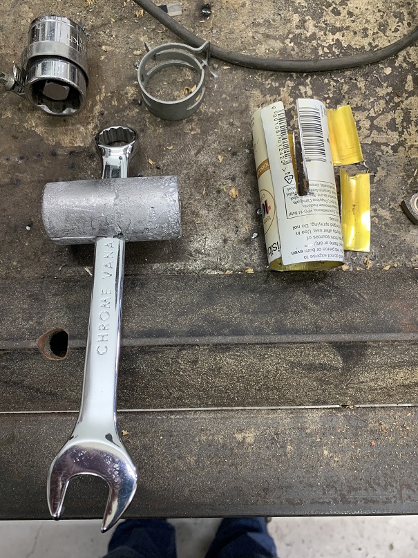

    It actually released no problem.

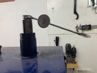

    The weight seems OK , perhaps I should have casted it a little bit closer to the spanner end, but will use it for a while before I decide to either remove it and re-cast it closer to the spanner or cut the open spanner off and fit something a bit more like a hammer handle.
    But for now this is my "SANMER"
