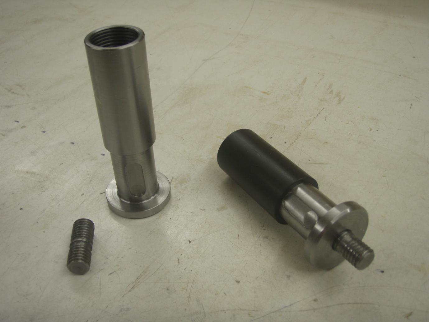

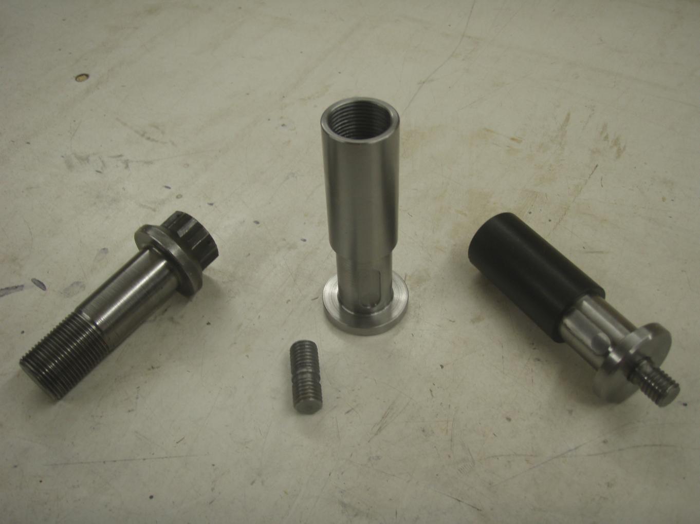

    Milling Jacks, Another great project made from S-64 Skycrane Landing Gear bolts. Small stud for mounting a 'T' nut
    and firm attachment to milling table if desired. Delrin and steel adjustable sleeve only threaded 1/2 way so you can flip over for a wider range of adjustment.
