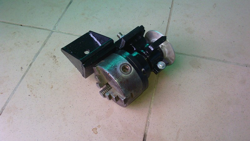

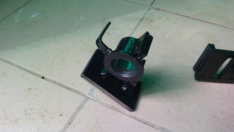

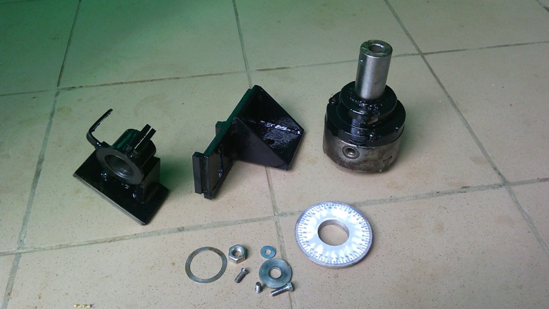

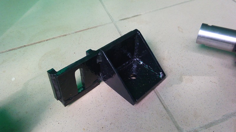

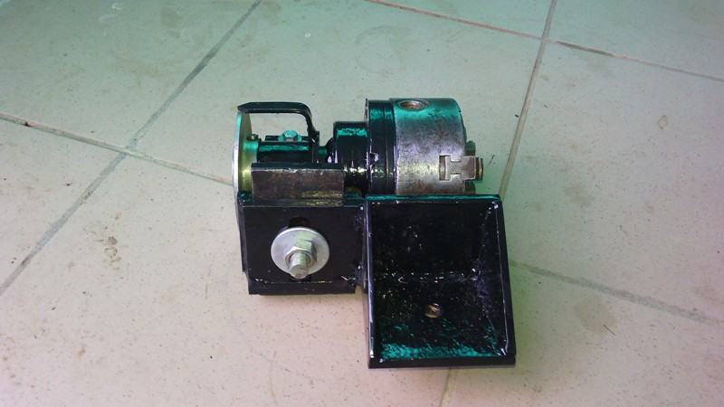

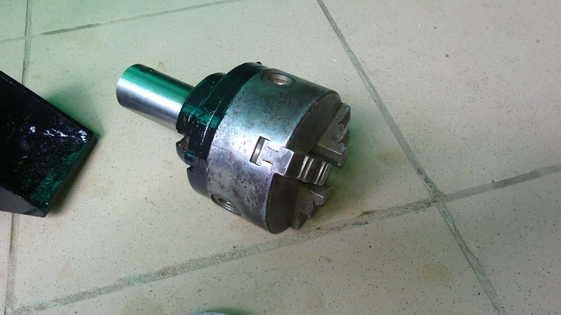

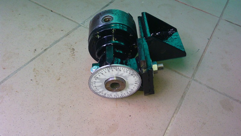

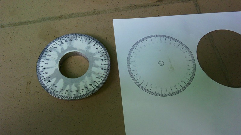

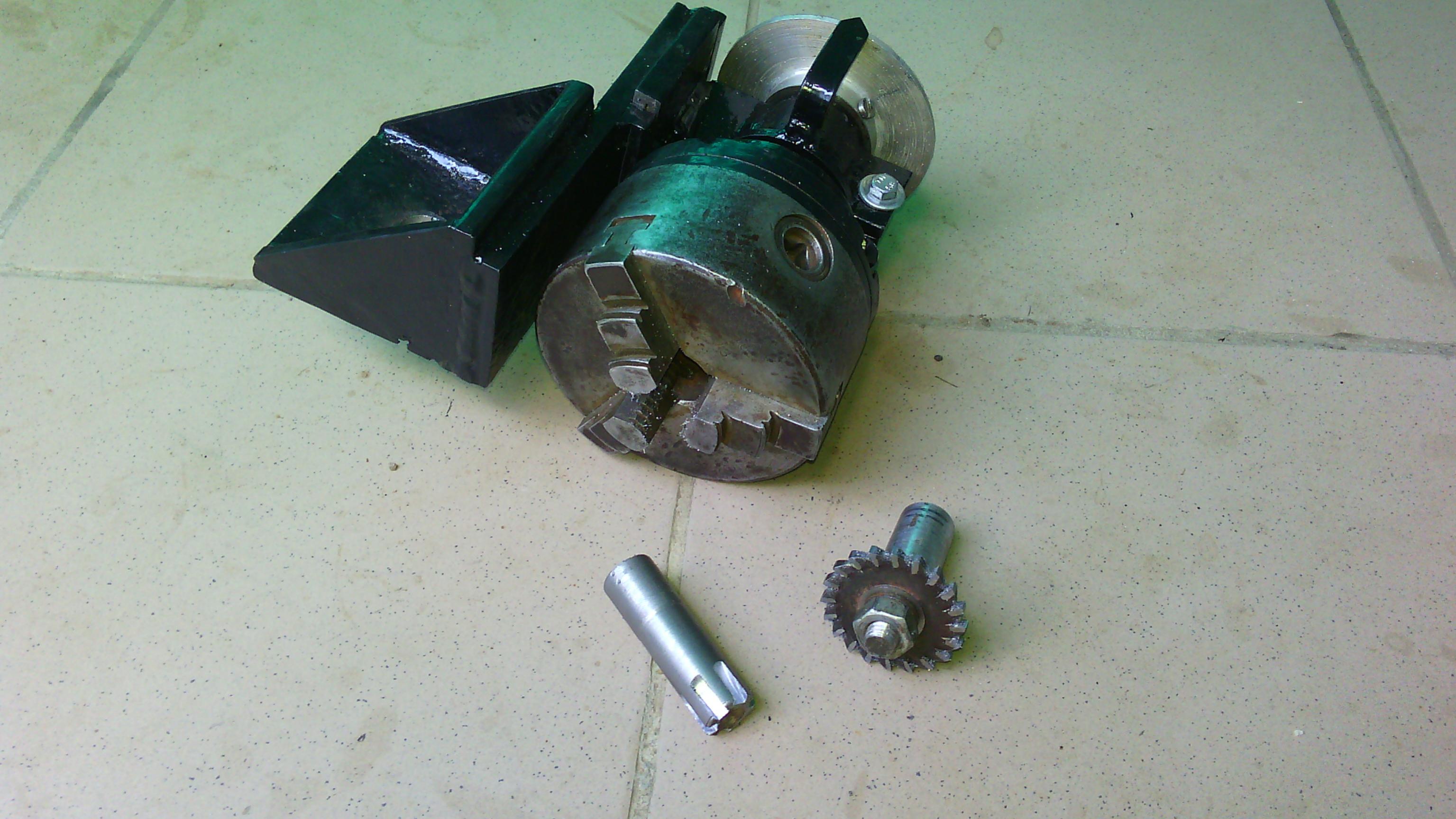

    Hello. My homemade milling equipment for lathes. This indexing head. It has a disk with a scale of 360 degrees.

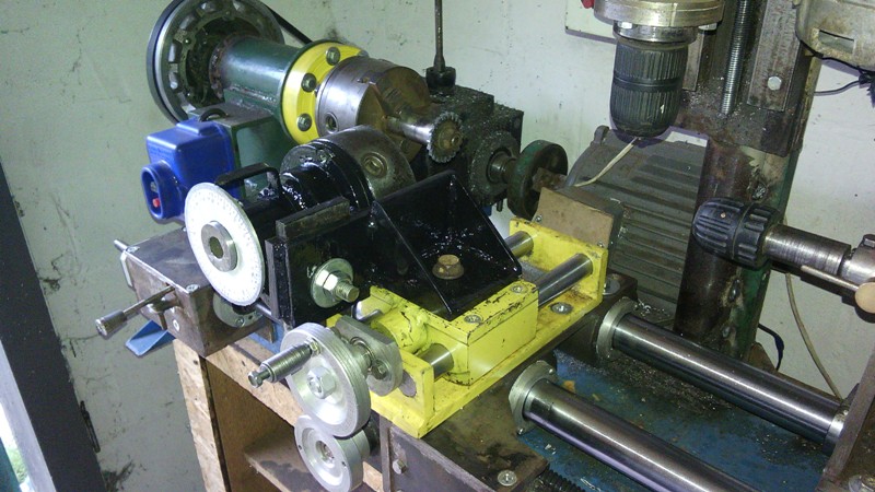

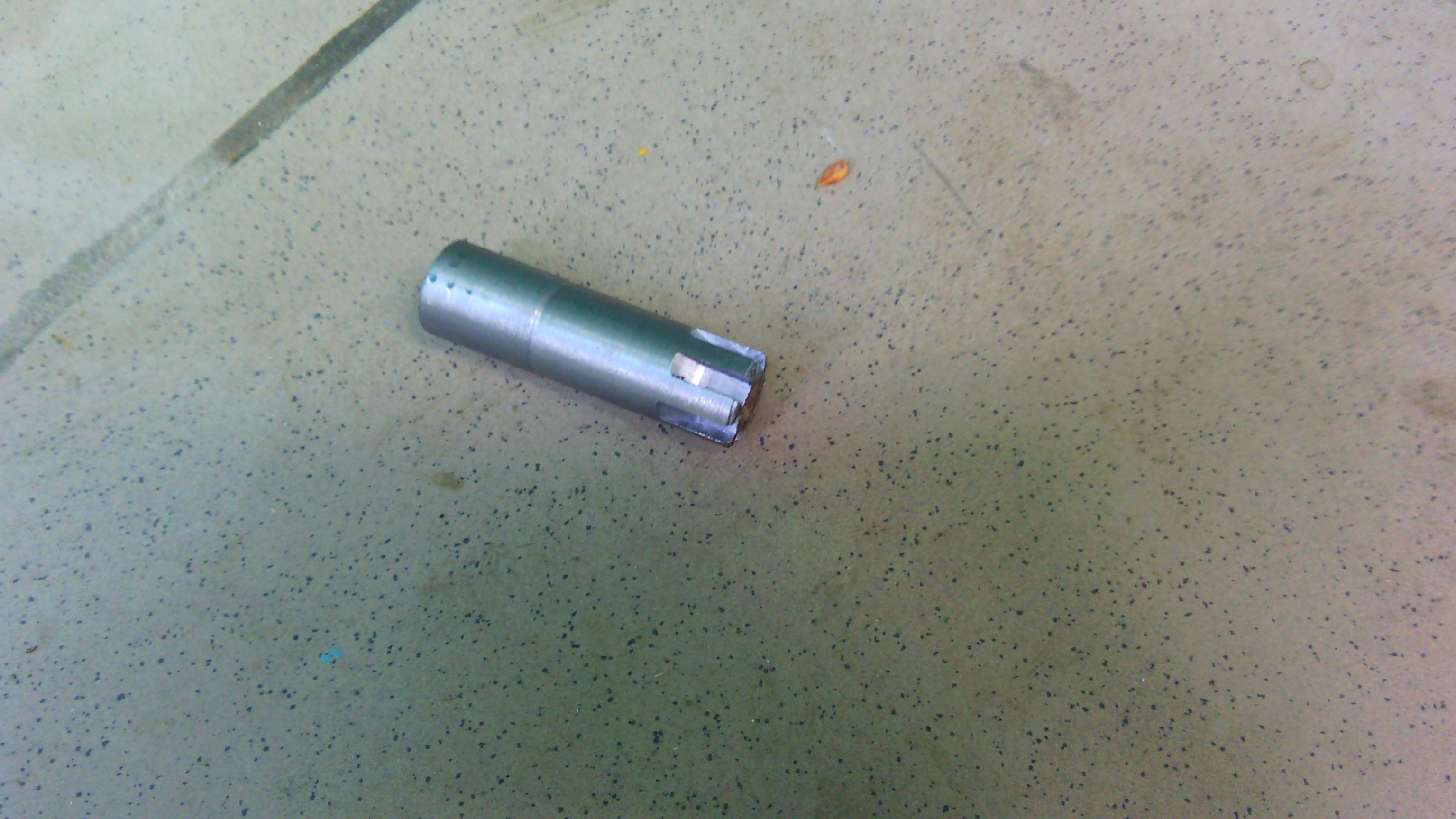

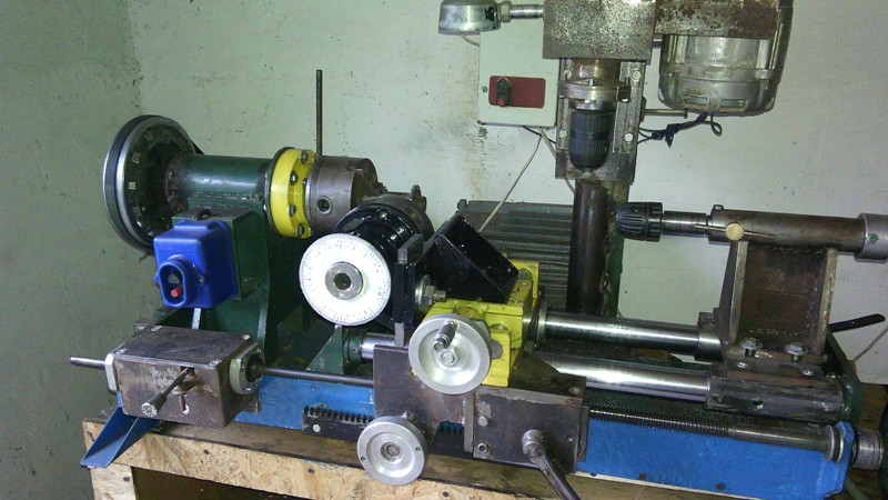

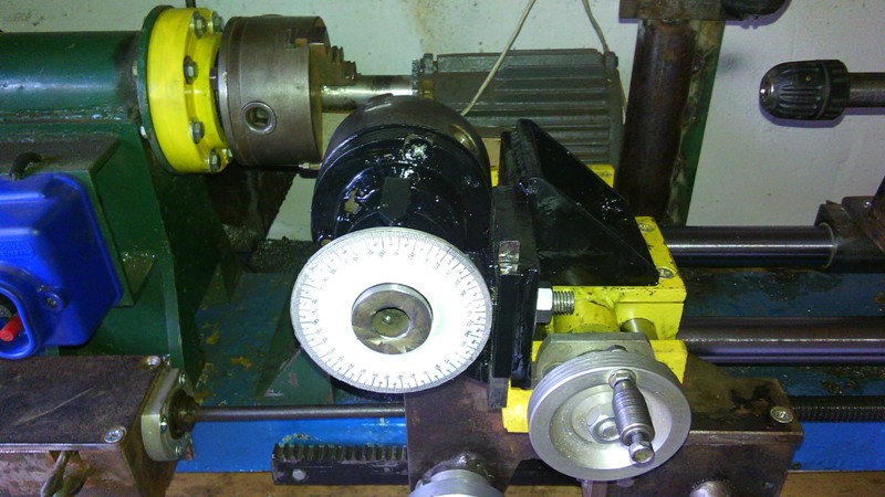

    Lathe chuck diameter of 100mm. With this equipment I can cut spline grooves or slots on the shaft. Later I will show video how it works.

    The first milling work
    After 1:50 minutes

    I like your lathe. How did you get everything aligned when you weld?
    I would like to make similar milling spindle and indexer. Thanks

    Quote Originally Posted by Mark240 View Post
    If the metal is cut evenly, then welding it does not deform.
