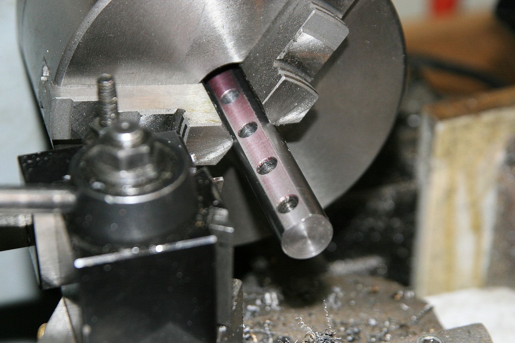

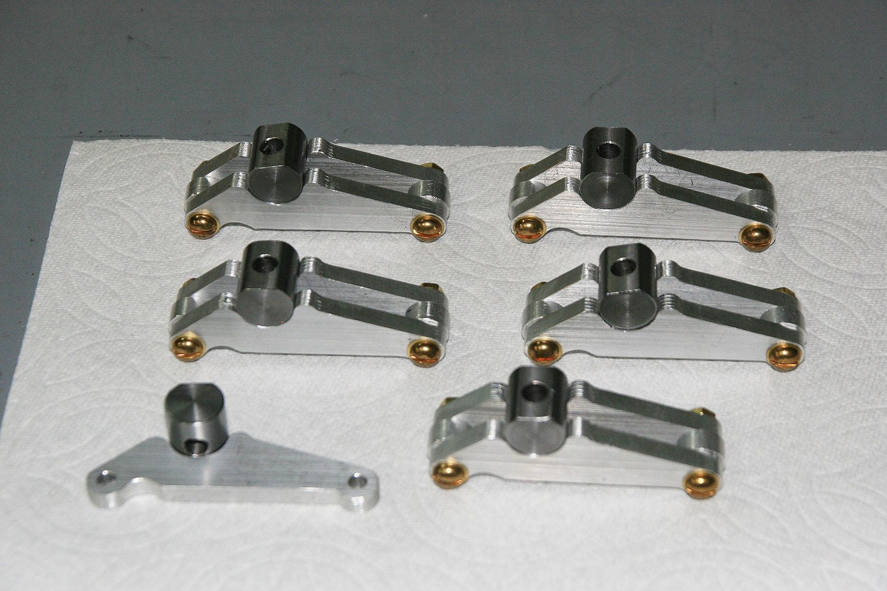

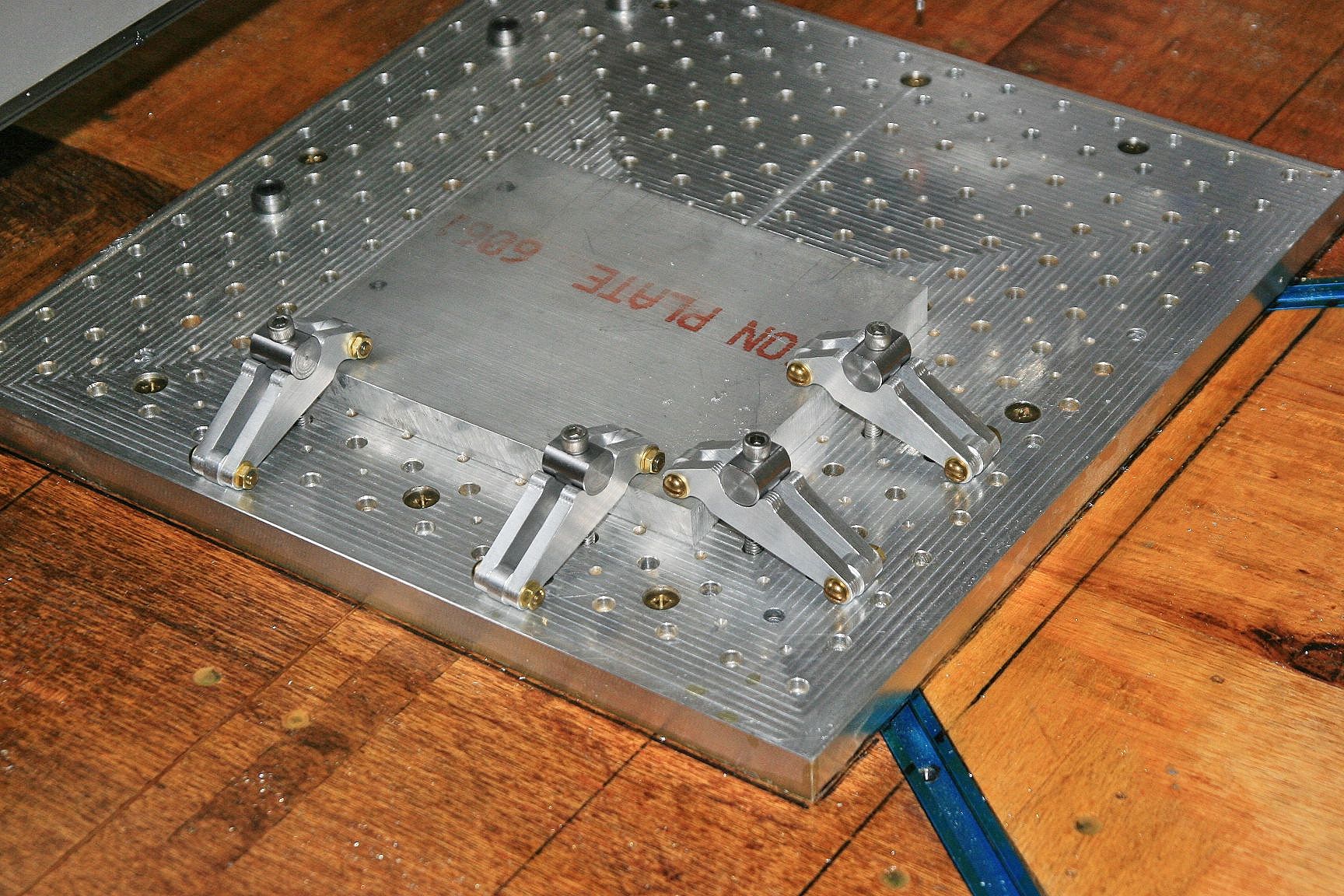

    I needed a few good clamps. Saw this type in several places including LMS and I think KBC as well as MSC.
    They don't require packing and can be used with the pallets or T-Slots. Mine are designed for 1/4" bolts.
    I use cap screws for my pallets so I stuck with them for these clamps.

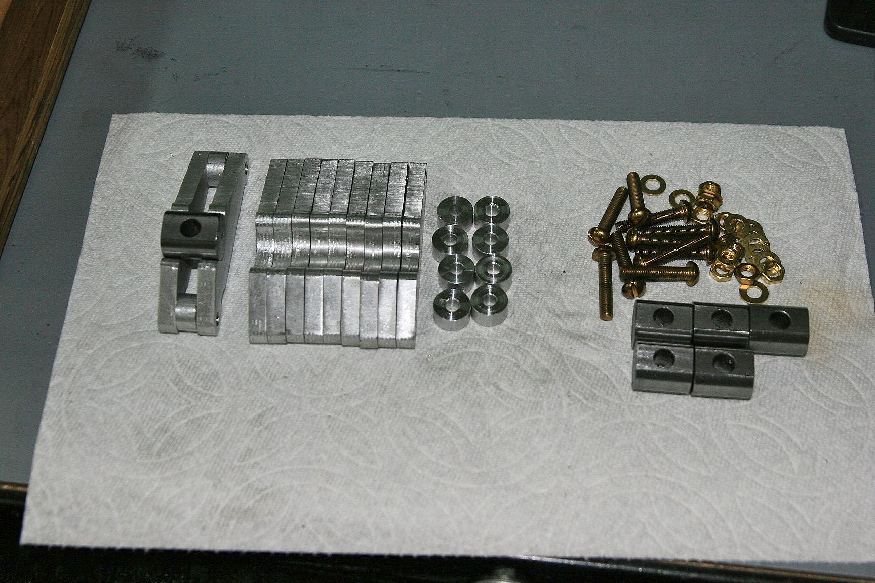

    Normally riveted but I had these brass screws and nuts in the shop so I thought that I could use them
    and have the ability to change out the spacers for other types like brass or steel depending on the job.
    The aluminum ones may have a flat face cut on them if desired. Aluminum sides were all cut on my CNC machine
    after I made the new router mount. The new mount is a total success and makes the machine more rigid than with
    the maple one that broke. The spacers were made on the lathe. The steel cross bolt was made using the mill and the lathe.
    Porter Cable Router Mount thread:
    http://www.homemadetools.net/forum/c...le-mount-66003
    So here they are..Kinda look like little race cars!

    Hi very nice. makes life so much easier when you have the correct tooling for the job. I really like the design and I know you said they don’t need packing but I guess if needed you could increase the height, you just place a block under the toe of the clamp and use a long piece of studding. Neat design and nicely made.
    thank you for sharing

    Hi JR: I wonder if you tried to use your clamps for a dual purpose, as regular clamps applying downward pressure on the part being held and also as an edge or low clearance clamp for thin work pieces. Given the pivoting hold down bolt, if set against the side of a plate it would apply downward pressure on the piece to be machined. The bearings at the end allow easy rolling of the clamp while tightening, it should work. I've seen similarly designed clamps used that way.

    Thanks for the idea Jorge, I have not tried that since my bolts are in a vertical plane when used on the
    pallet or with T-nuts on the mill. I have been using my own mite-bite type clamps for the edges.
    My clamping on the CNC finds the bite type clamps great for the edges. I then use some rather block
    style clamps for the opposite sides where the bite clamps can press on. Then the new hold downs on top.
    Works to a treat as they say.
