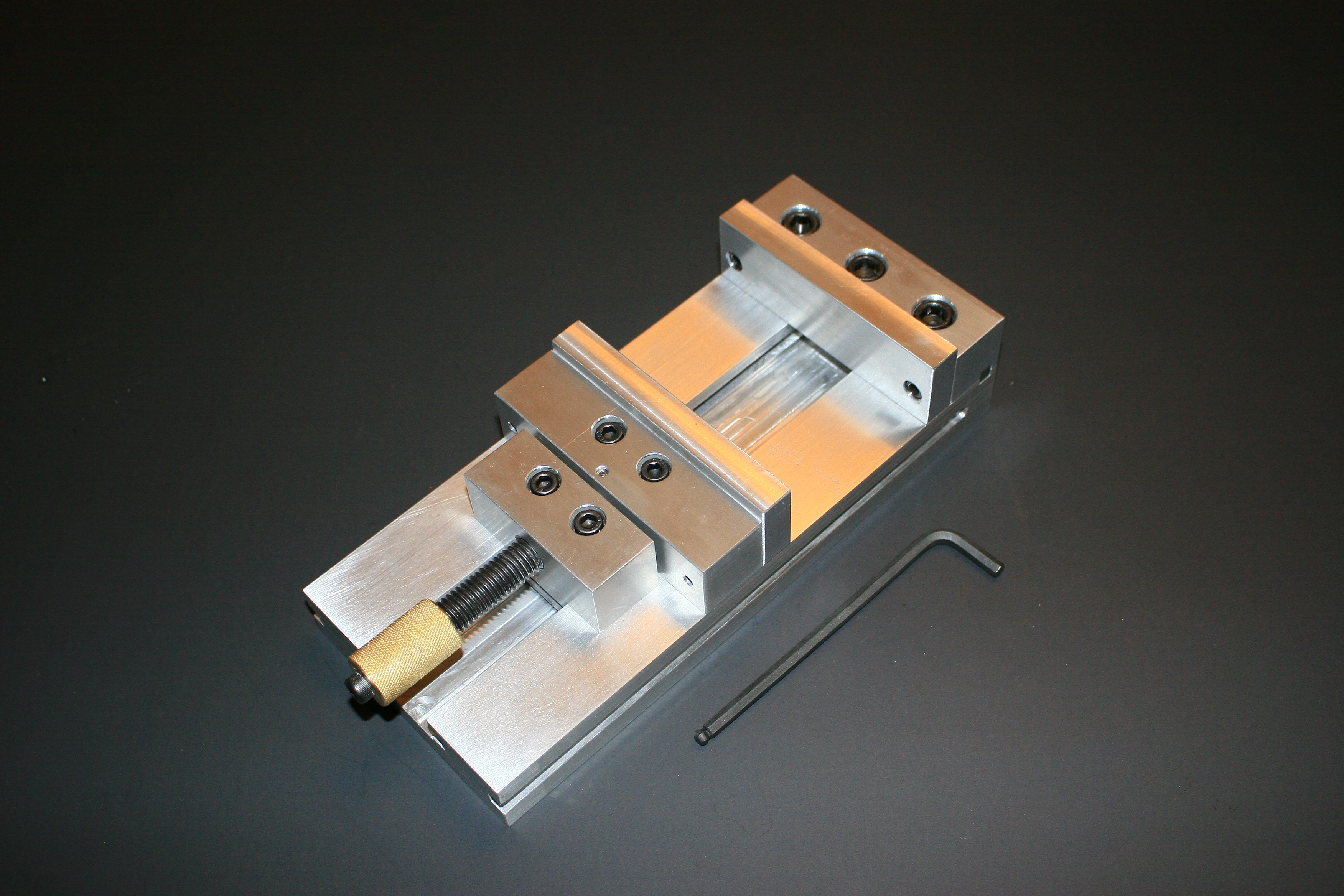

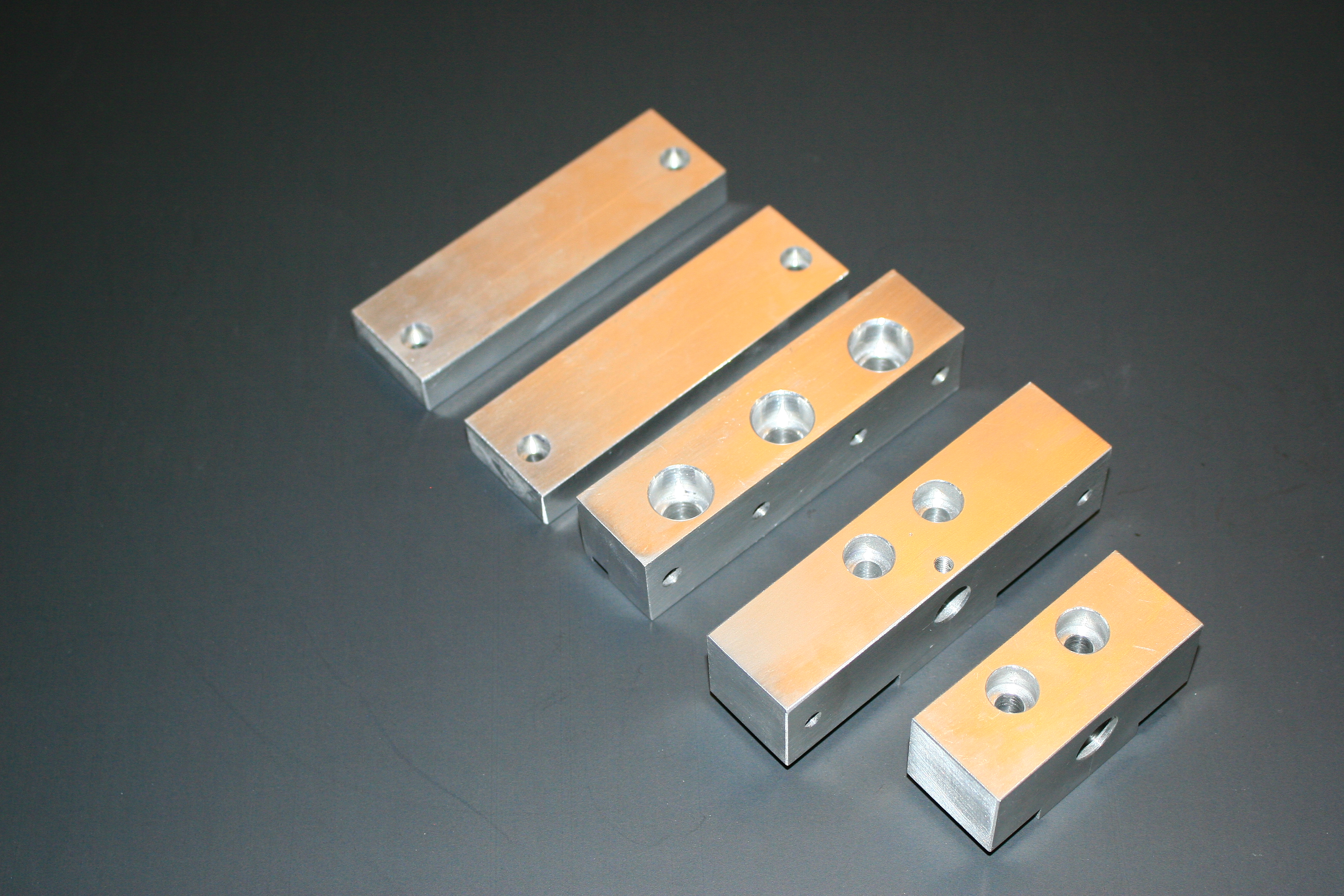

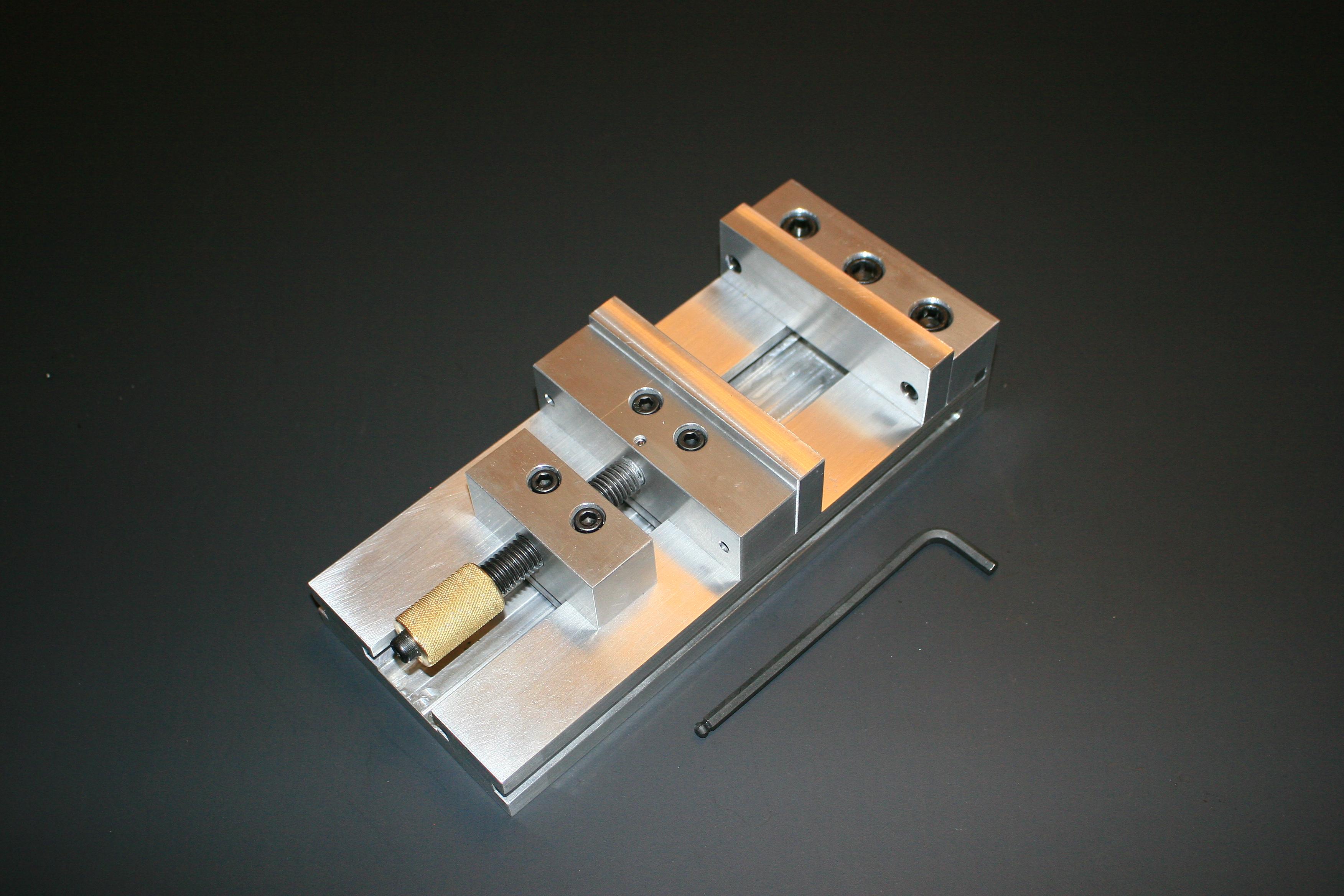

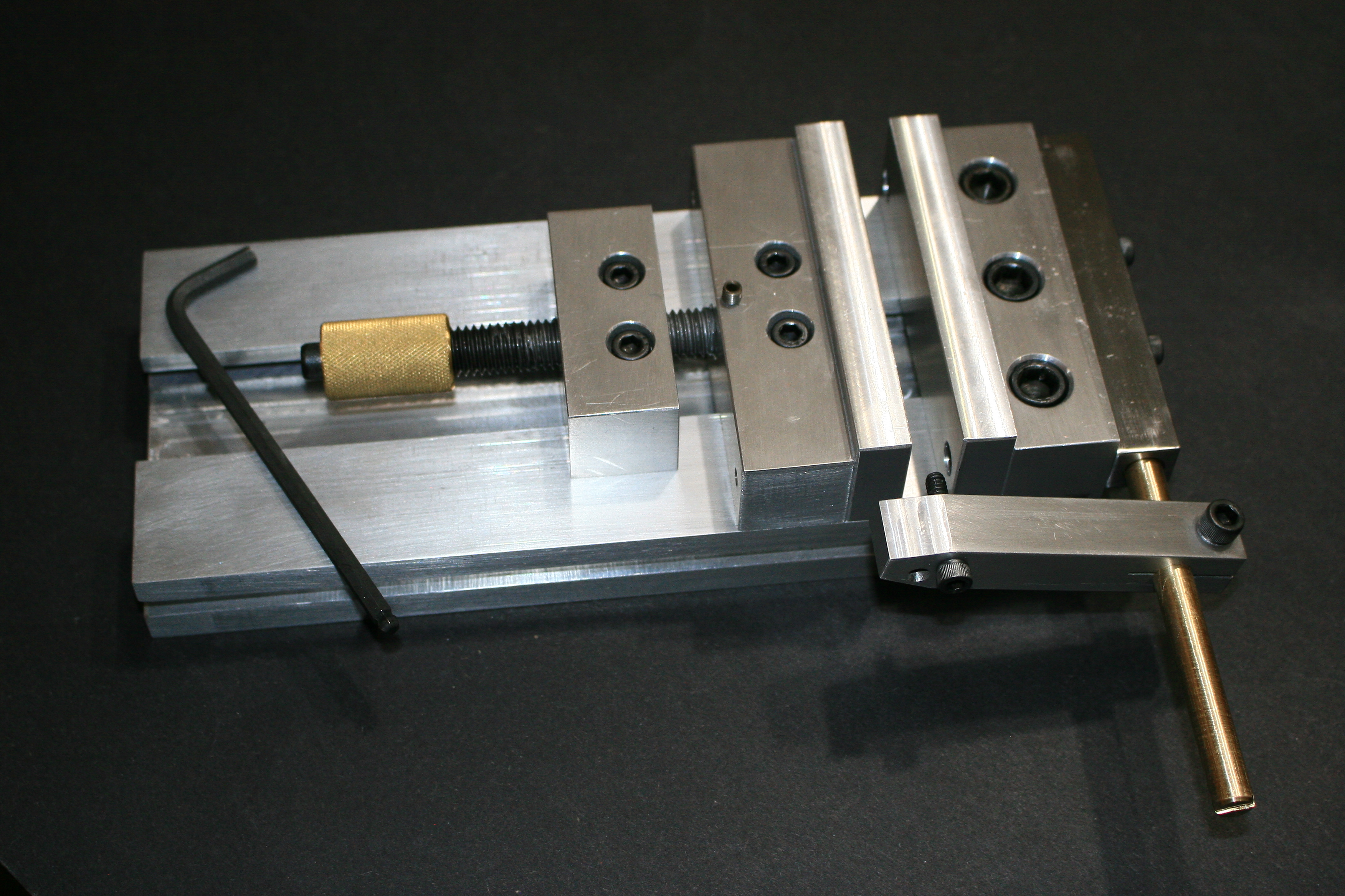

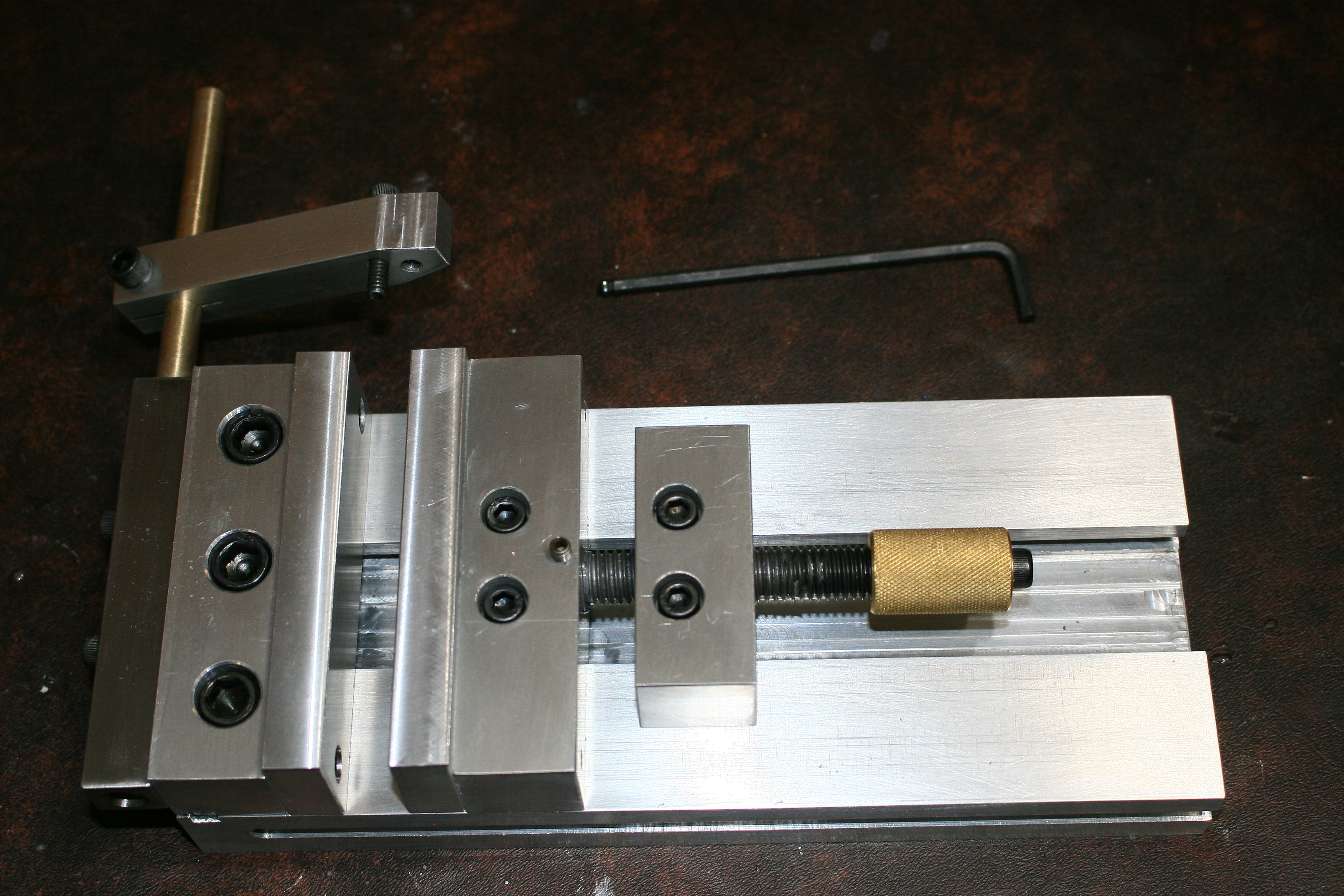

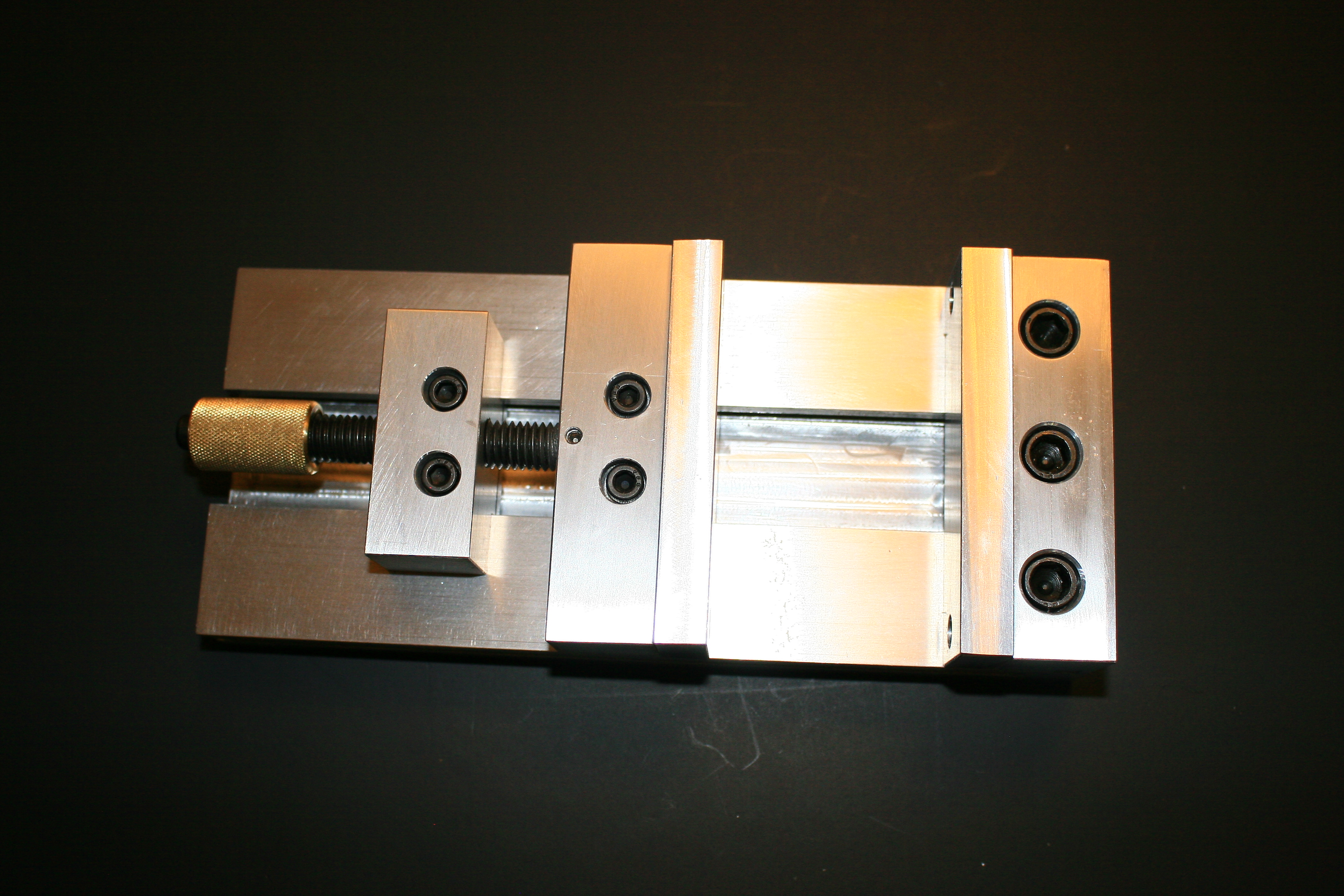

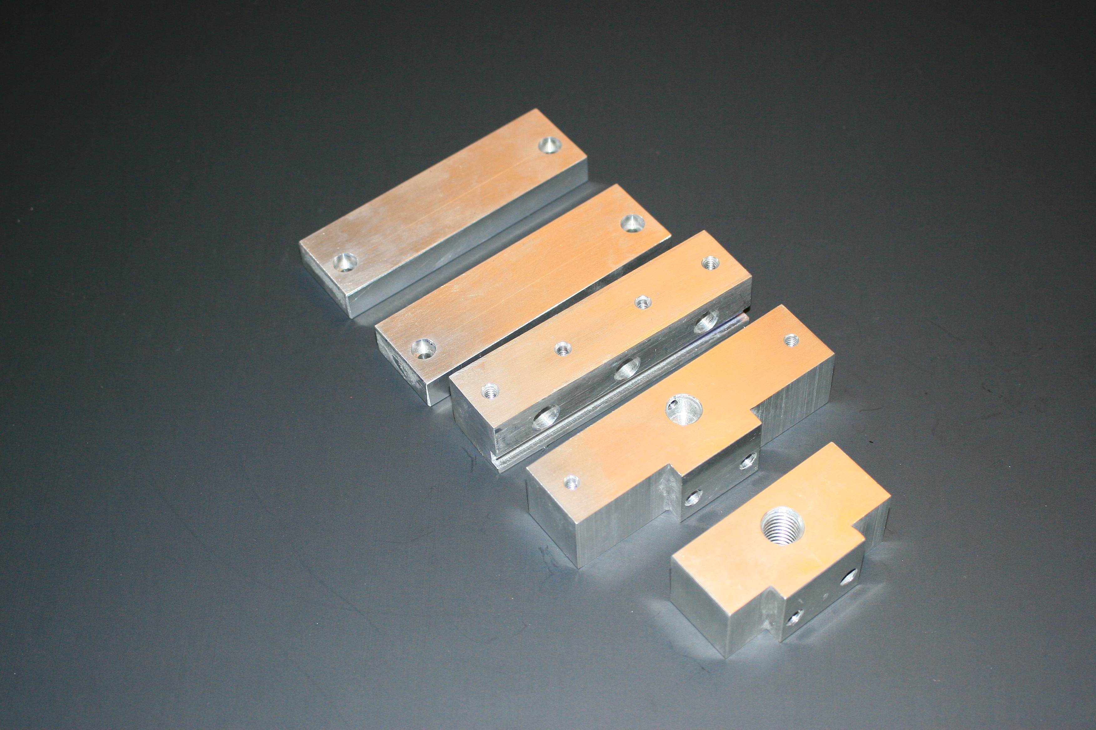

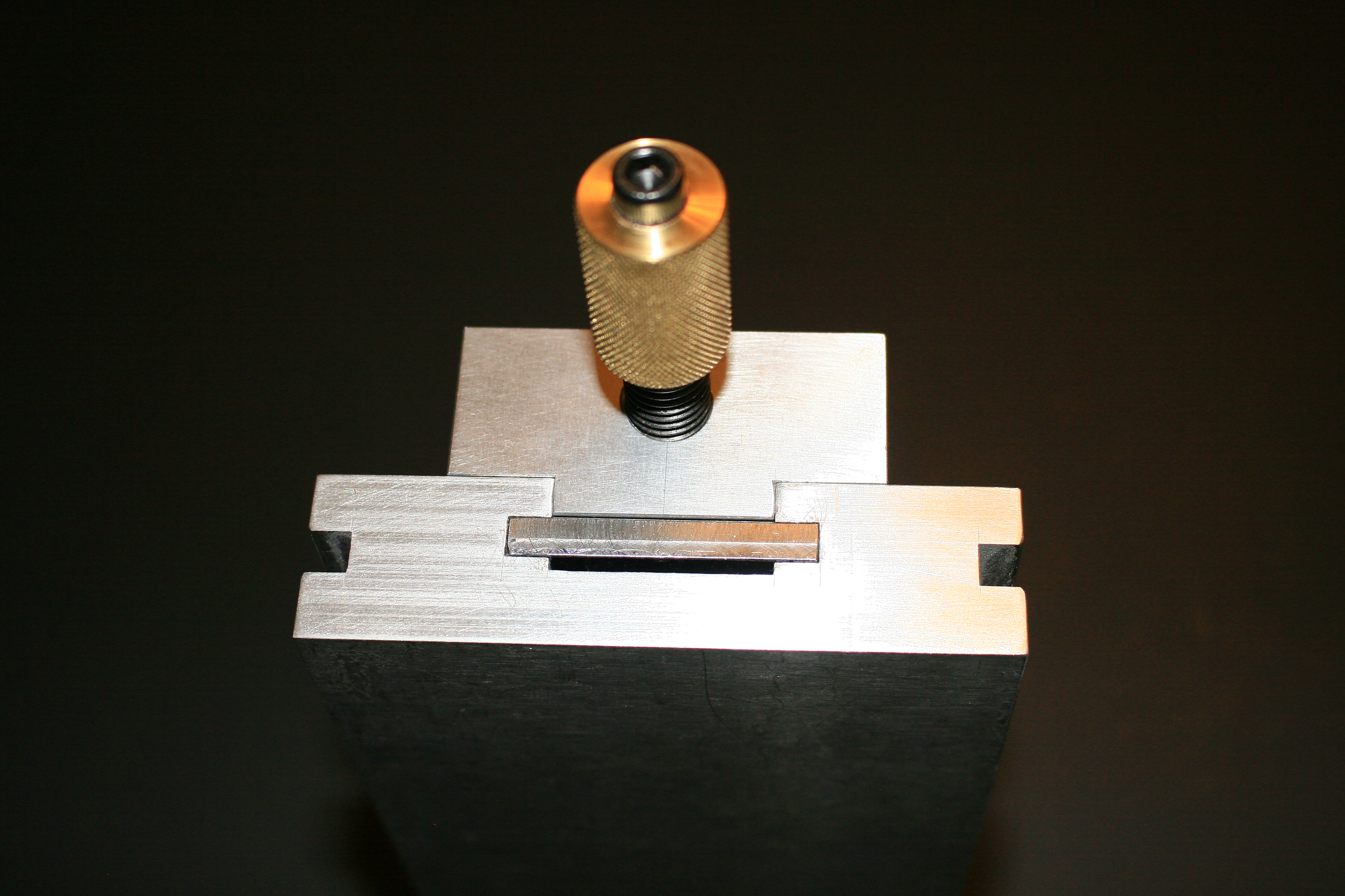

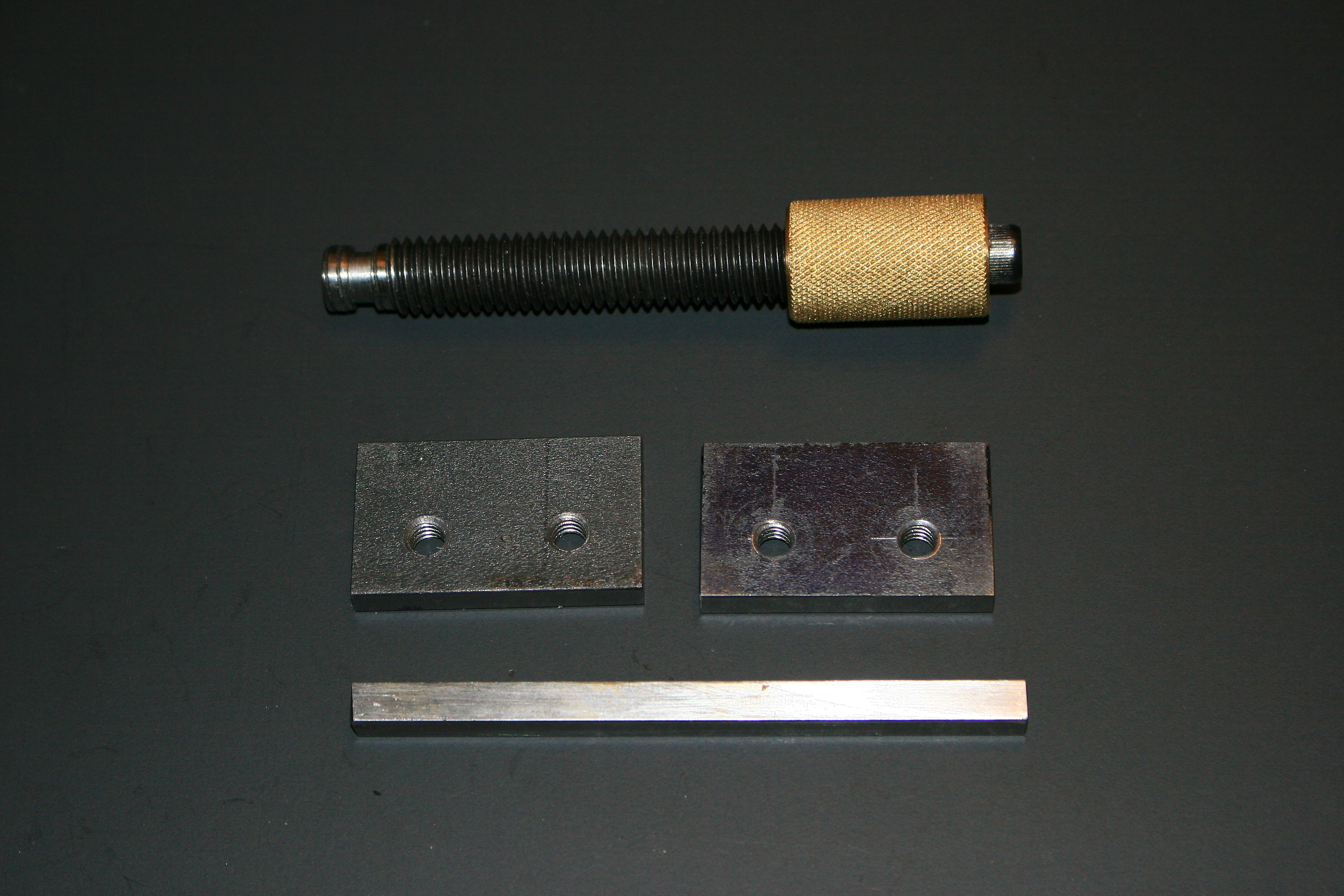

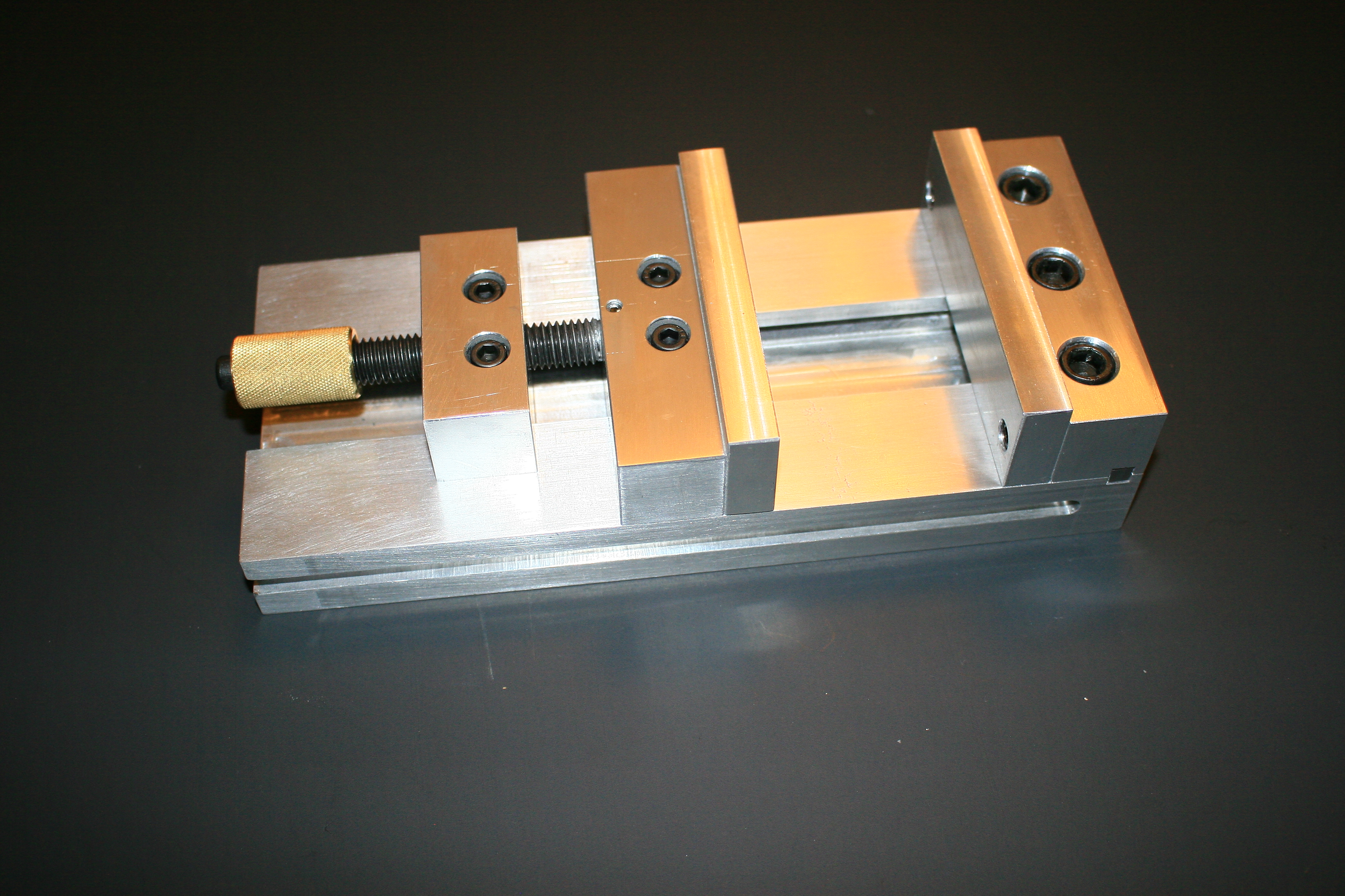

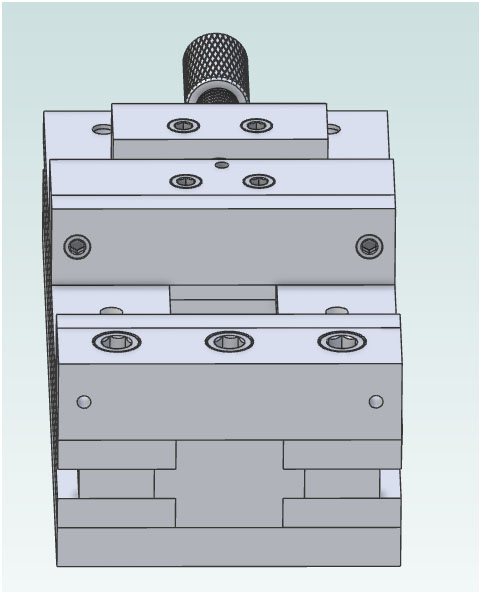

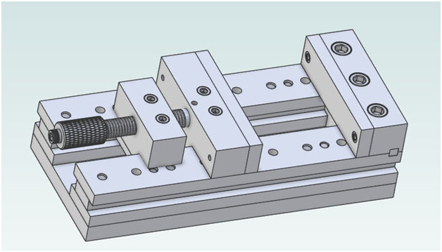

    This is a precision low profile Milling and CNC vise. It is 2.37 inches high and has a capacity
    of 4 inches wide and 5 inches long. It is a lock down vise and can be operated with a single
    3/16 inch allen wrench. Lead screw is a standard 1/2"-13 tpi screw with the end modified
    to fit the moveable jaw assembly. While it does require milling for the large base I will also
    have a set of plans for one that has the base made from bar stock without milling.
    My Kurt style lock down vise is over 3.6" tall so I gain 1.2" of head room with this model.
    It will fit equally on my CNC machine, Sherline Mill, or Mini Mill. It also gains 1" in length
    capacity over my Kurt Style vise.

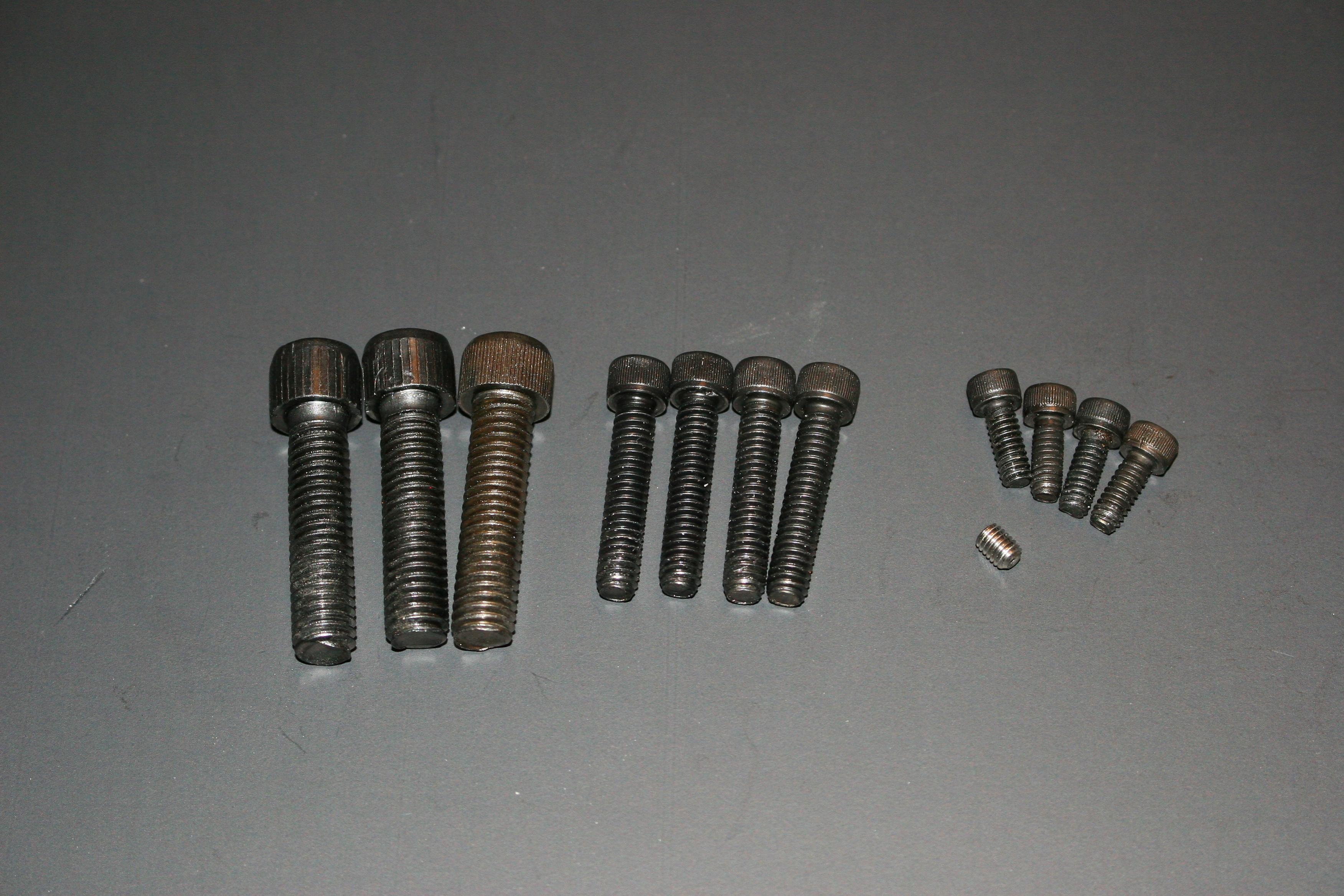

    Operation does require use of one allen wrench to both pull the jaws tight and lock
    them down to the base. Once setup for a dimension it can be reset and adjusted for
    parts that are within 1.5" wide with only three allen adjustments since the lead screw
    provides 1.5" of travel. Any size part that can fit between the jaws can be adjusted
    using 5 of the 1/4" allen cap screws on the jaws and lead screw. It is not as bad as it
    sounds, we are talking about 1/8 th of a turn on the lock down screws and maybe 1/4
    turn of the lead screw to secure any part. The lead screw does have a knurled knob
    for fast adjustments.
    Version 2 is a bar stock version for the base that does not require milling.
    There is also the optional custom work stop shown in another post in this thread.

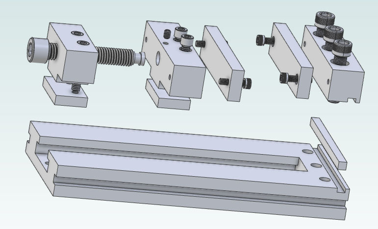

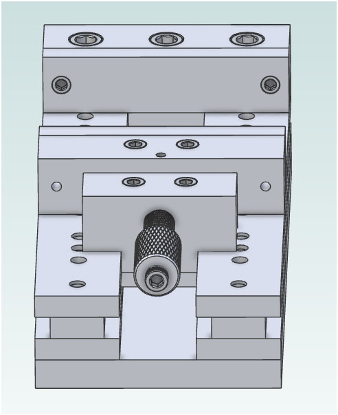

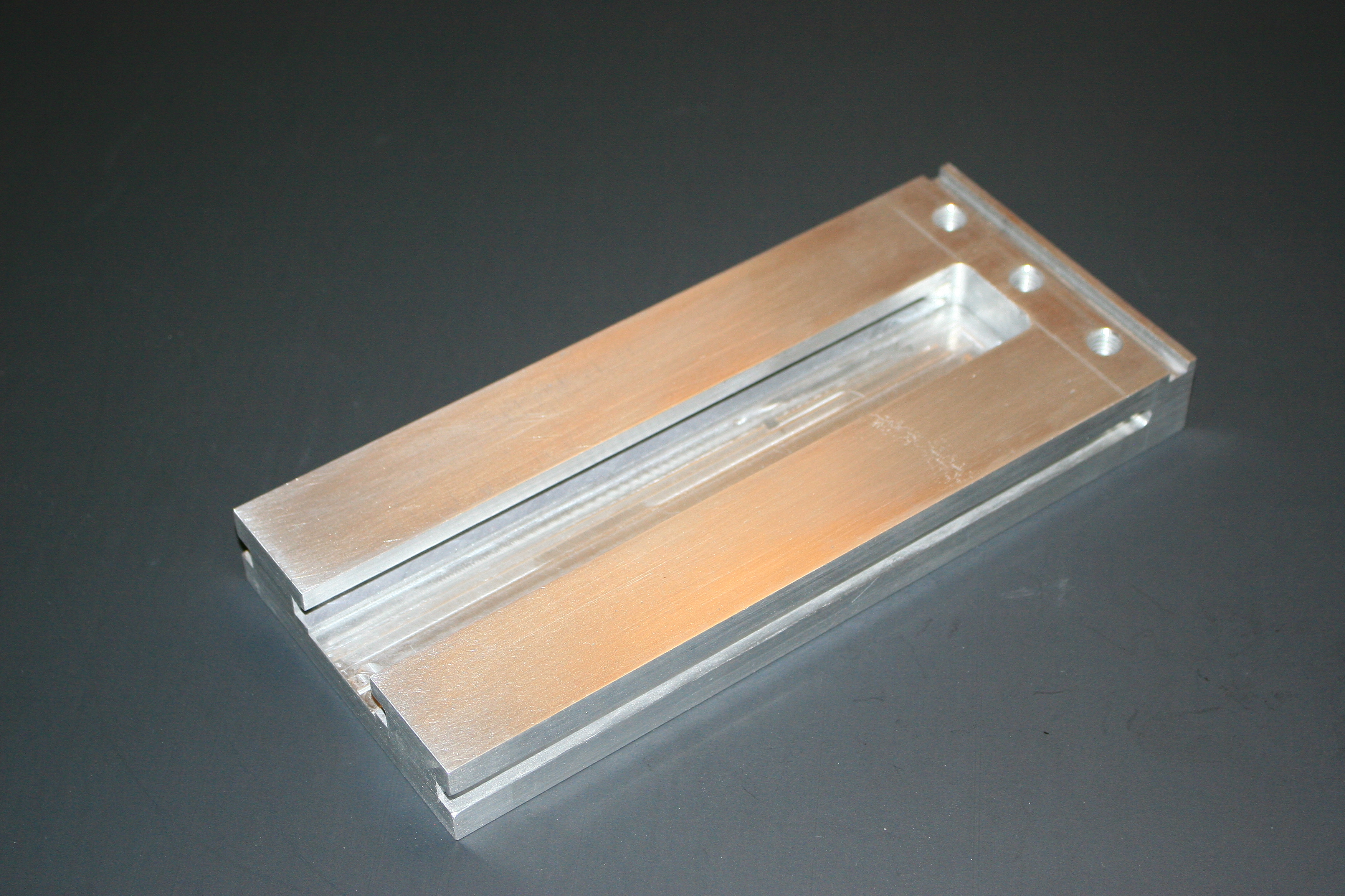

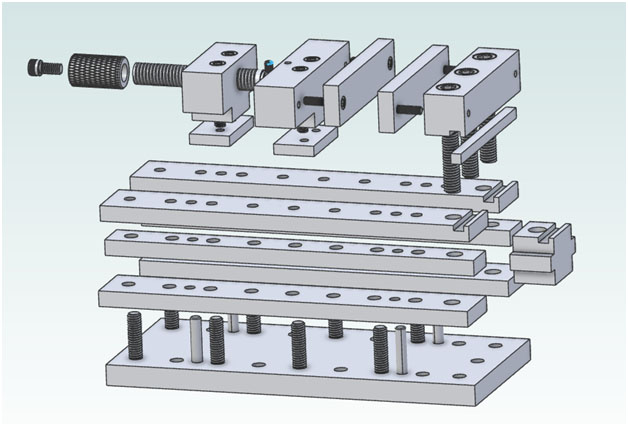

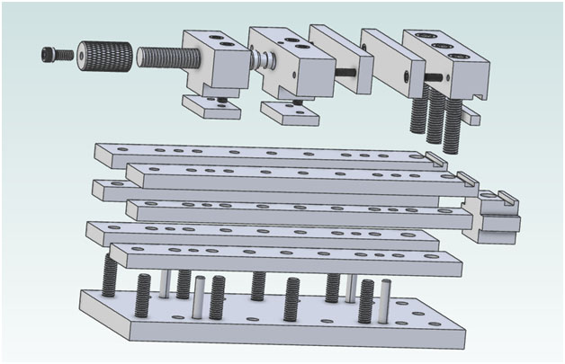

    Part 2 Bar Stock Base
    This is the Bar Stock Version of the vise. Most of the parts are similar to the Milled base version.
    The Base is not milled and made of Bar Stock Pinned and screwed together.
    I built the Milled version but have not built the Bar Stock Version.

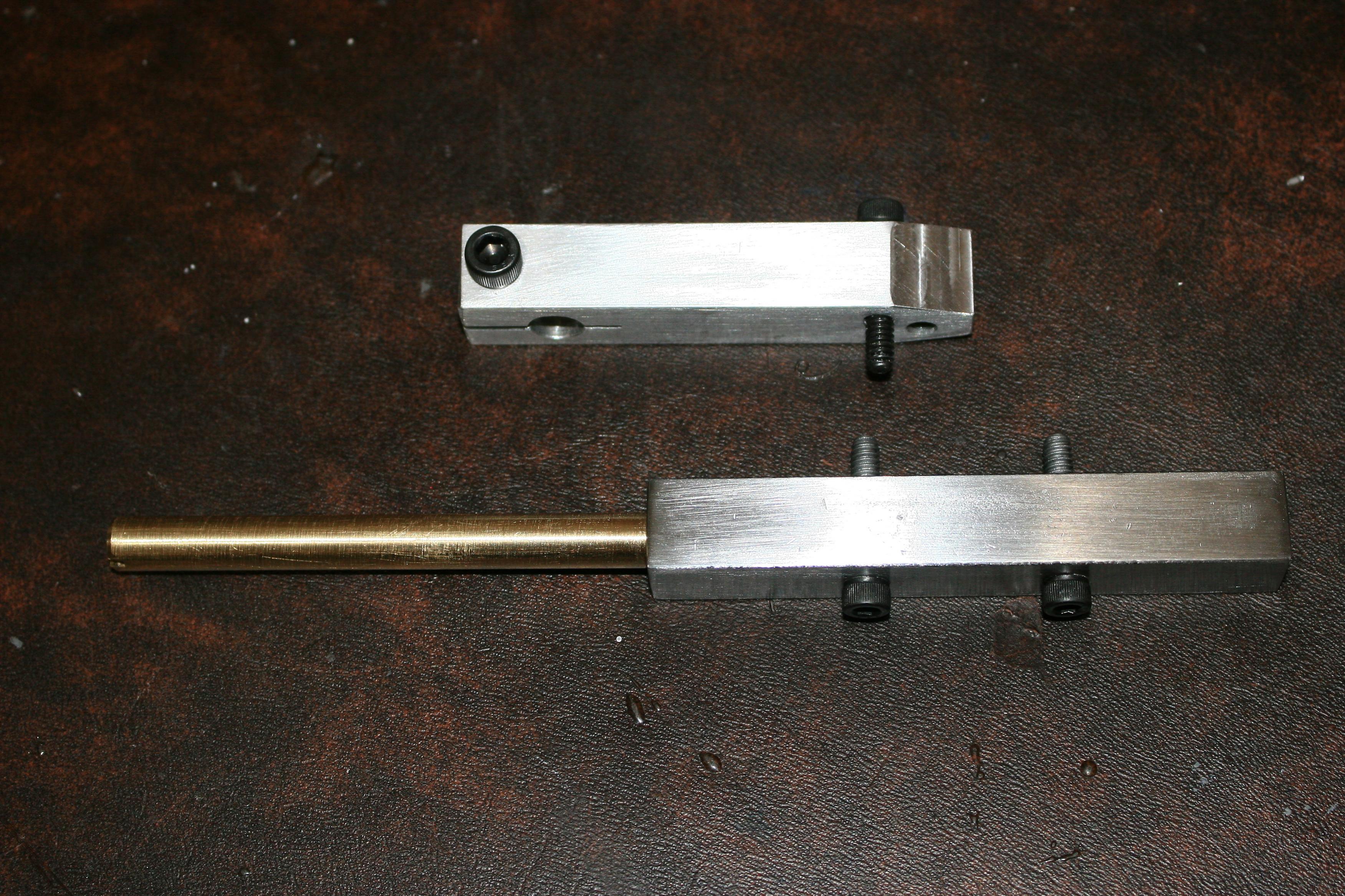

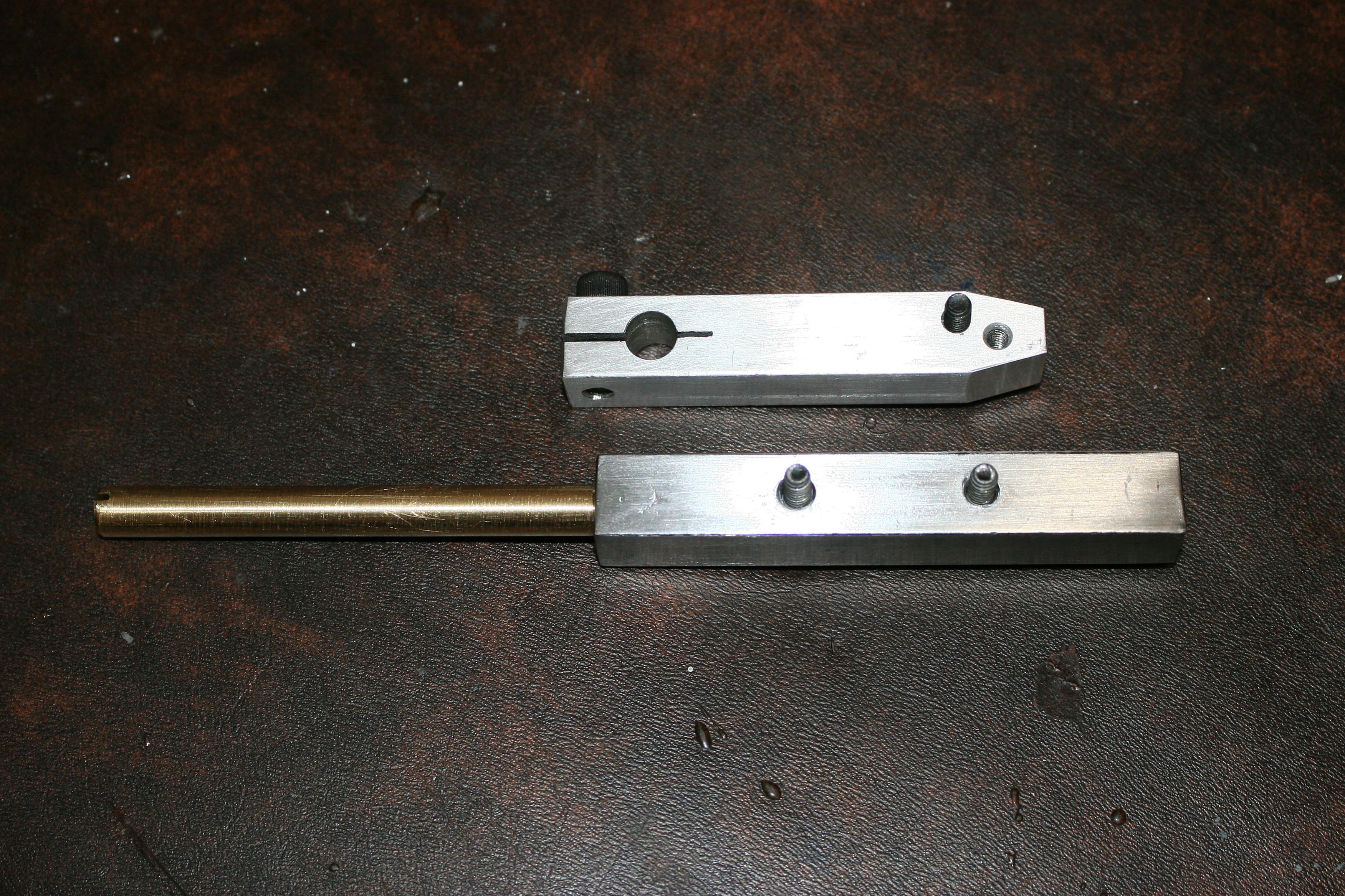

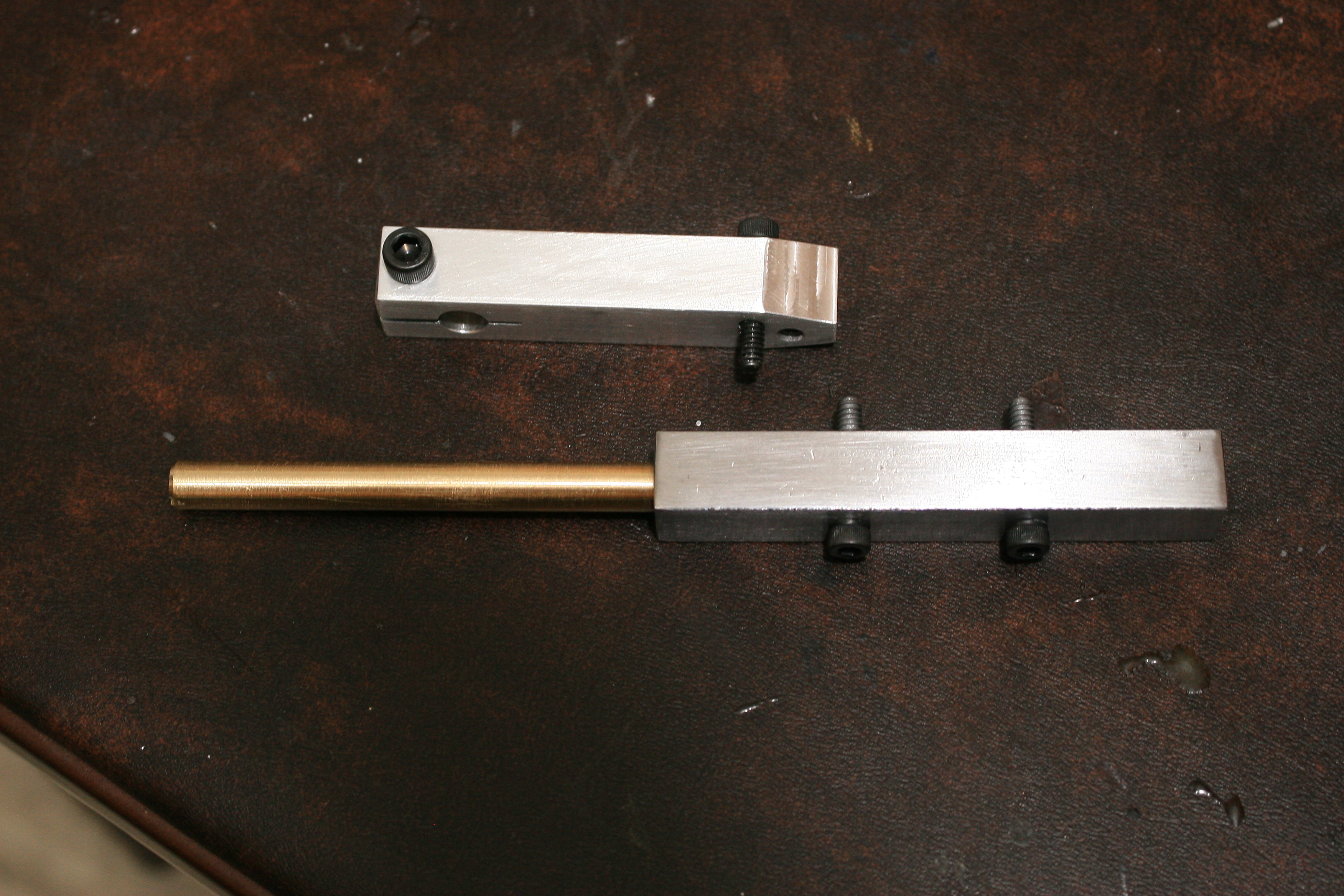

    Part 3 Work Stop
    This is typical of the general arrangement of work stops for a Kurt Type Vise.
    Attached Thumbnails Attached Thumbnails Milling and CNC Lock Down Vise-img_3372.jpg   Milling and CNC Lock Down Vise-img_3371.jpg   Milling and CNC Lock Down Vise-img_3370.jpg   Milling and CNC Lock Down Vise-img_3369.jpg   Milling and CNC Lock Down Vise-img_3368.jpg
