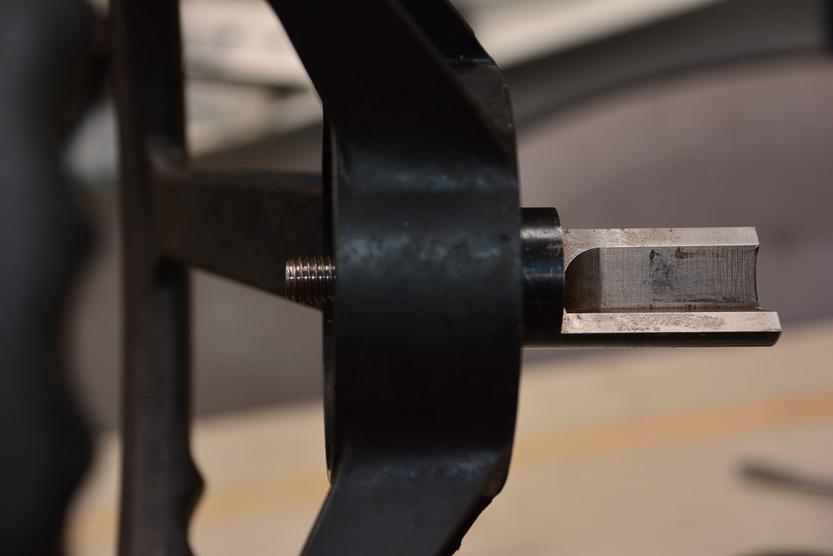

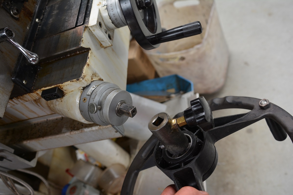

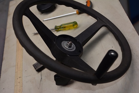

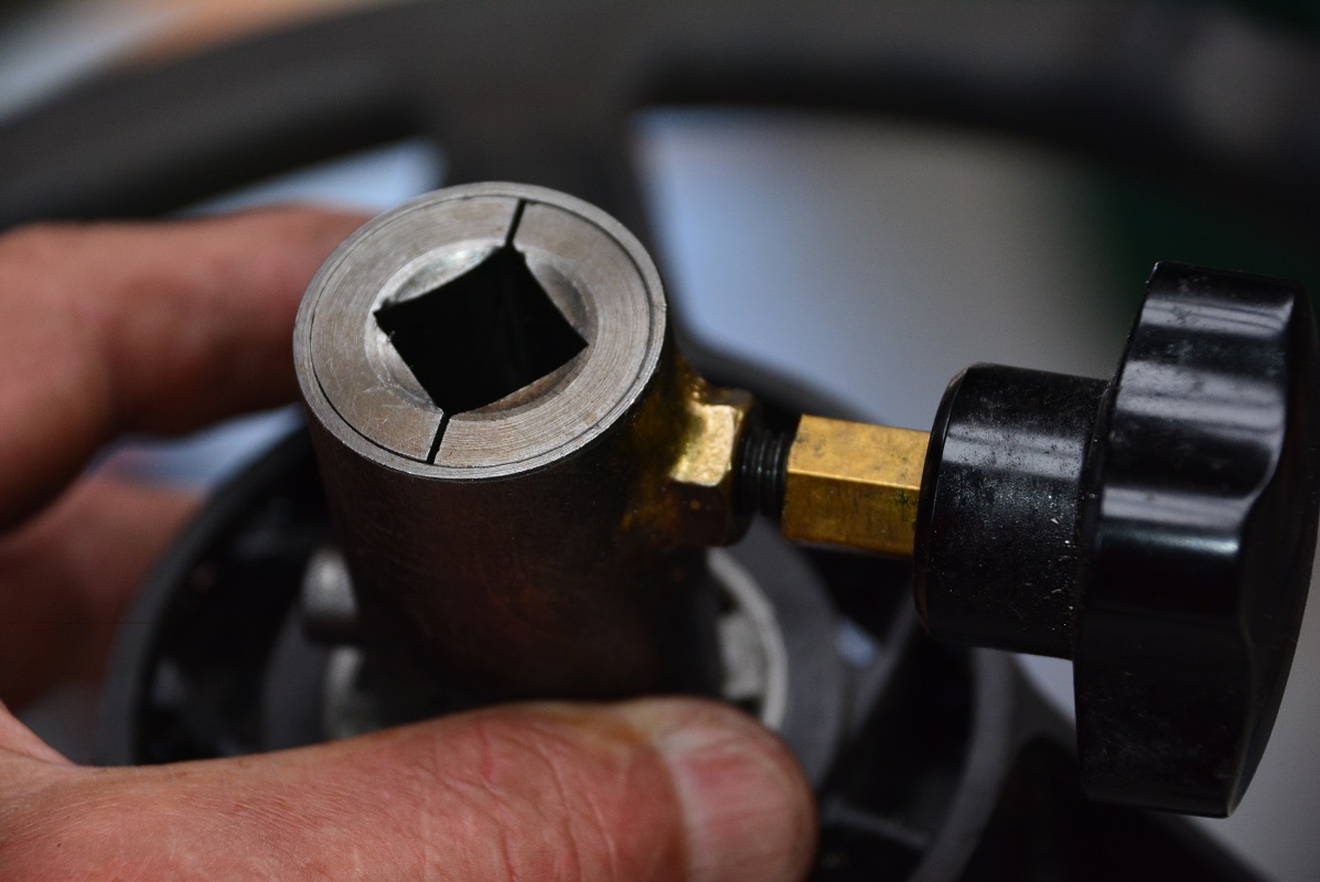

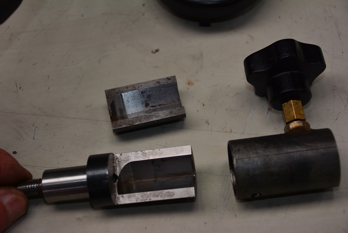

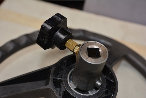

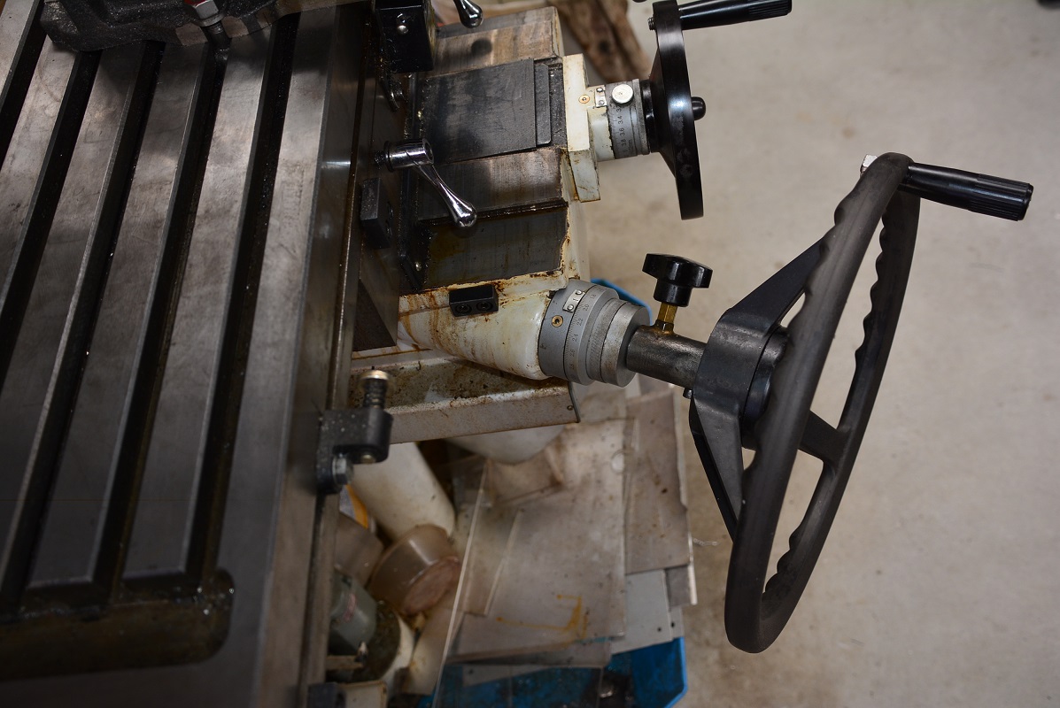

    This idea came to me when I had to make repeated small increments to the depth of milling a part. The wheel is an inexpensive steering wheel from a power boat, found in any boating/marine/ship chandlers shop. The rim of the wheel is always just at hand, rather than fumbling for the crank and if you chose a steering wheel of larger radius than the crank handle (normally supplied with a small mill) very small height adjustments to the mill table are much easier to make. In addition it's also easier to lift the table with minimum effort when its loaded up.
    The solution for attaching the wheel to the square shaft on the mill is to made the female part in two halves, and to fasten it with a simple knob which forces the halves together onto the shaft.
    I hope the photos show all that you'll need to make one for yourself.
    Mill Z axis crank wheel-wheel1.jpgMill Z axis crank wheel-wheel2.jpgMill Z axis crank wheel-wheel4.jpgMill Z axis crank wheel-wheel5.jpgMill Z axis crank wheel-wheel6.jpgMill Z axis crank wheel-wheel7.jpgMill Z axis crank wheel-wheel8.jpg
    Feel free to email me if you need further explanation. All the dimensions and way you proceed will depend on the materials you have at hand and the size of your mill, and sorry I don't have any drawings.

    Very cool idea!
    I put a Go Kart stearing wheel on my 23" arbor press for the left side. Helped me out a ton too.

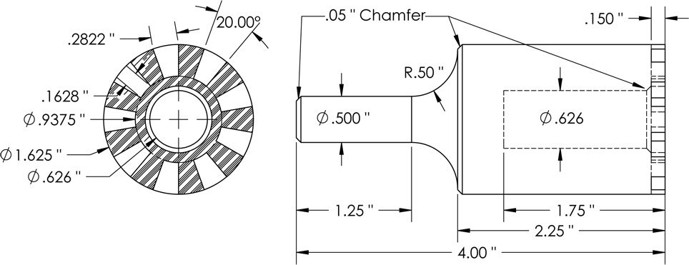

    For anyone who wants to attach an alternative winding device to a Bridgeport here are the important dimensions for making a mating thingy.
    I did the ultimate in geriatric aids, I added a motor, so the extent on my effort has reduced to setting a direction switch and pressing a button. No good for precision adjustment but the Bridgeport has the quill for that, and I did it to be able to still use the handle. Always seeking the easy way I also added some helper springs as in my previous post at http://www.homemadetools.net/forum/k...5951#post82823 which really makes the effort minimal.

    Actually, the adaptor drawing is not mine, I found it on the net and it was designed to be used with a cordless drill. For me it was just a nice reference for the dimensions of the Bridgeport dogs.
    I intended to make the motor drive through the dogs but then I saw how I could fix a pulley behind them and still retain the ability to use the original handle if I needed to make a fine adjustment. Perhaps I should take some photos and make a post
