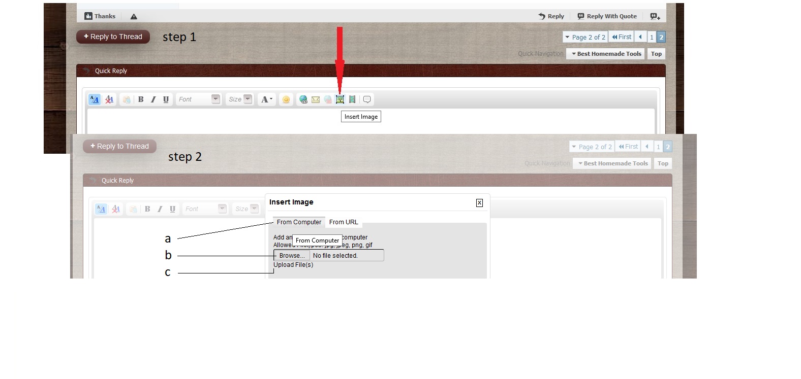

    Like old over the counter indigestion relief ads, "Try It, You'll Like It!" A staple in every household, but that's another story. Just click on the pic.
