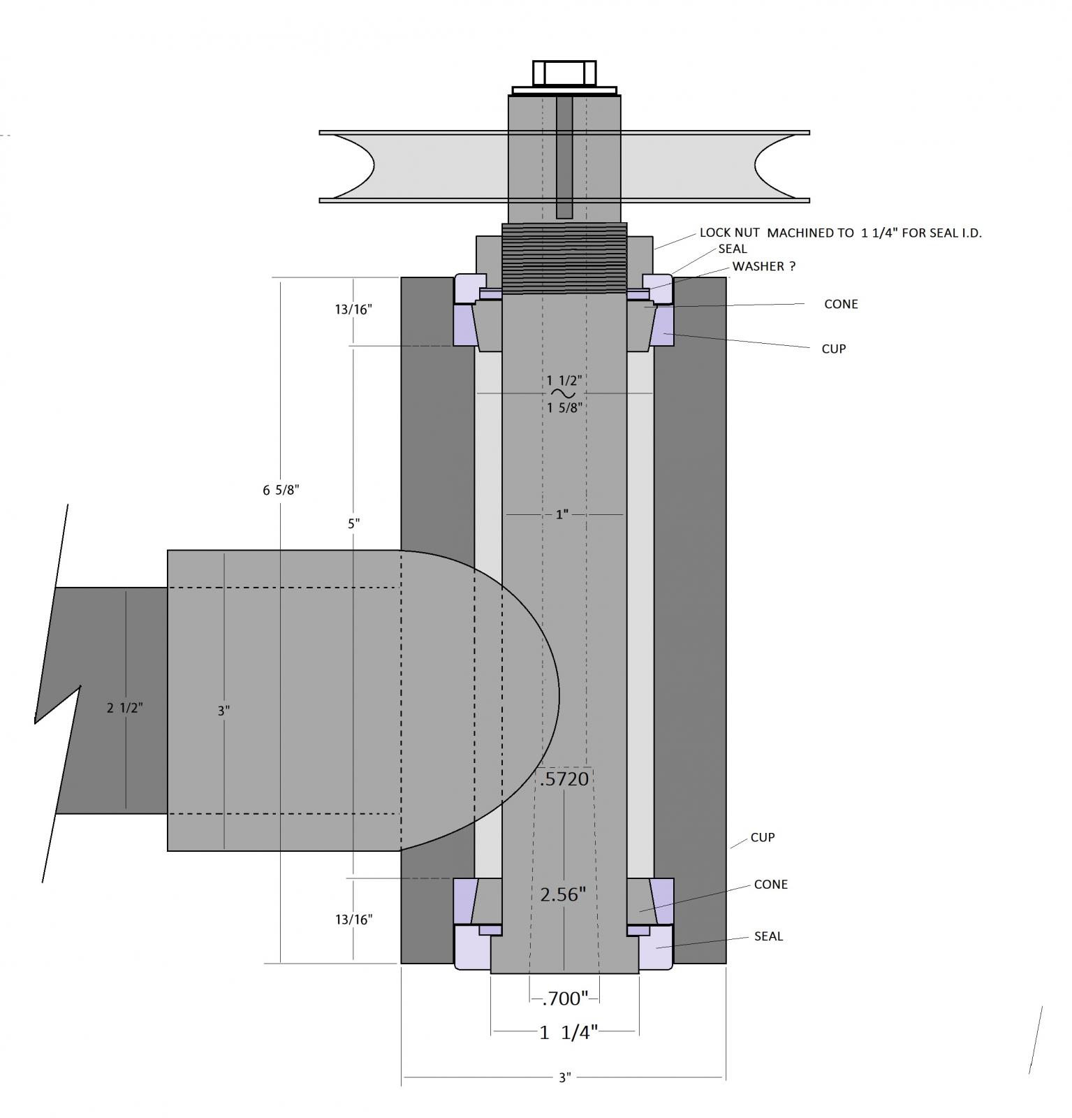

    The over arm support is 2 1/2" for the for the horizontal spindle support so I turned the vertical attachment from 3" cold rolled steel.
    The bearings are tapered roller bearings, L44643. I turned an extra fine thread on the top of the spindle for adjusting the end play and run out to zero with a special machined castle nut with a round collar that projects through the top seal.
    I wasn't able to turn the bearing cup seats with the two sections welded together and was concerned about the weld pulling but with the wall of the housing close to 1" thick there didn't appear to be any distortion. Peening the short alternate welds may have helped too.
    Interference fits for the spindle bearings as well as the bearings in the idler pulleys.
    MT2 taper with a draw bar. MT3 would have been preferred but would have been too large.
