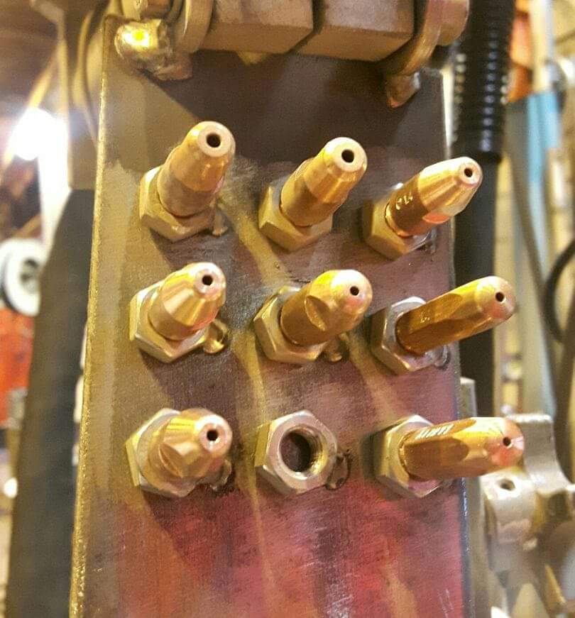

    Made a simple storage for mig nozzles.
    Easy to find right sized nozzle.
    M8 nuts weld to steel plate. Placed to mig caddy.
    M8 nut works with Kemppi, Abicor and Binzel nozzles. ( those i use )
