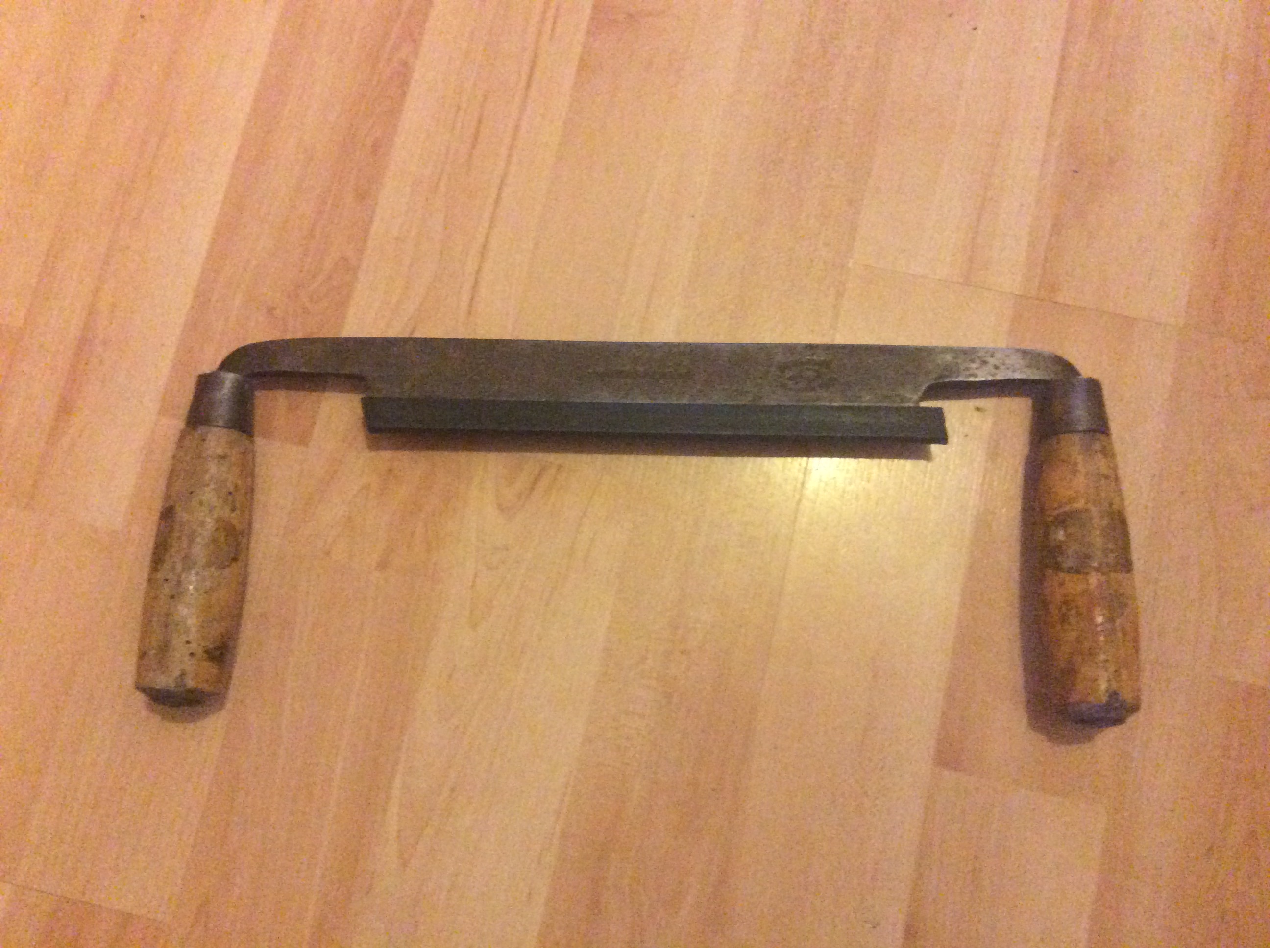

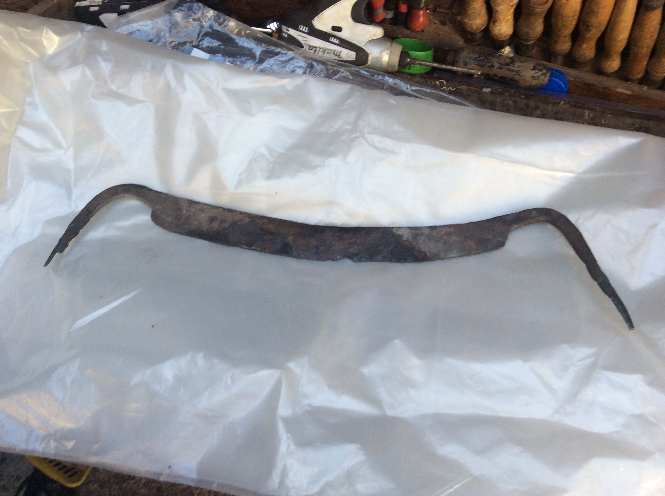

    I wanted to make a drawknife.
    One of these,
    Mezzaluna/pizza cutter-8ebf2b2b-88b7-4ccc-96eb-aaa97f959ed7.jpeg
    With an 8” blade will set you back £172 (from Axminster tools) I wanted a drawknife with a 12” blade, or longer.
    I had a tyre lever long enough.
    It was a bugger to bend. (Consider, that as you pene out the bevel, it will cause the material to bend, so you have to bend it first in the opposite direction.)
    This took quite a long time, but eventually I had bevelled the blade, with a slight concave, and drawn out tangs at each end, oriented as I wanted. I took a final heat, just to check the line.

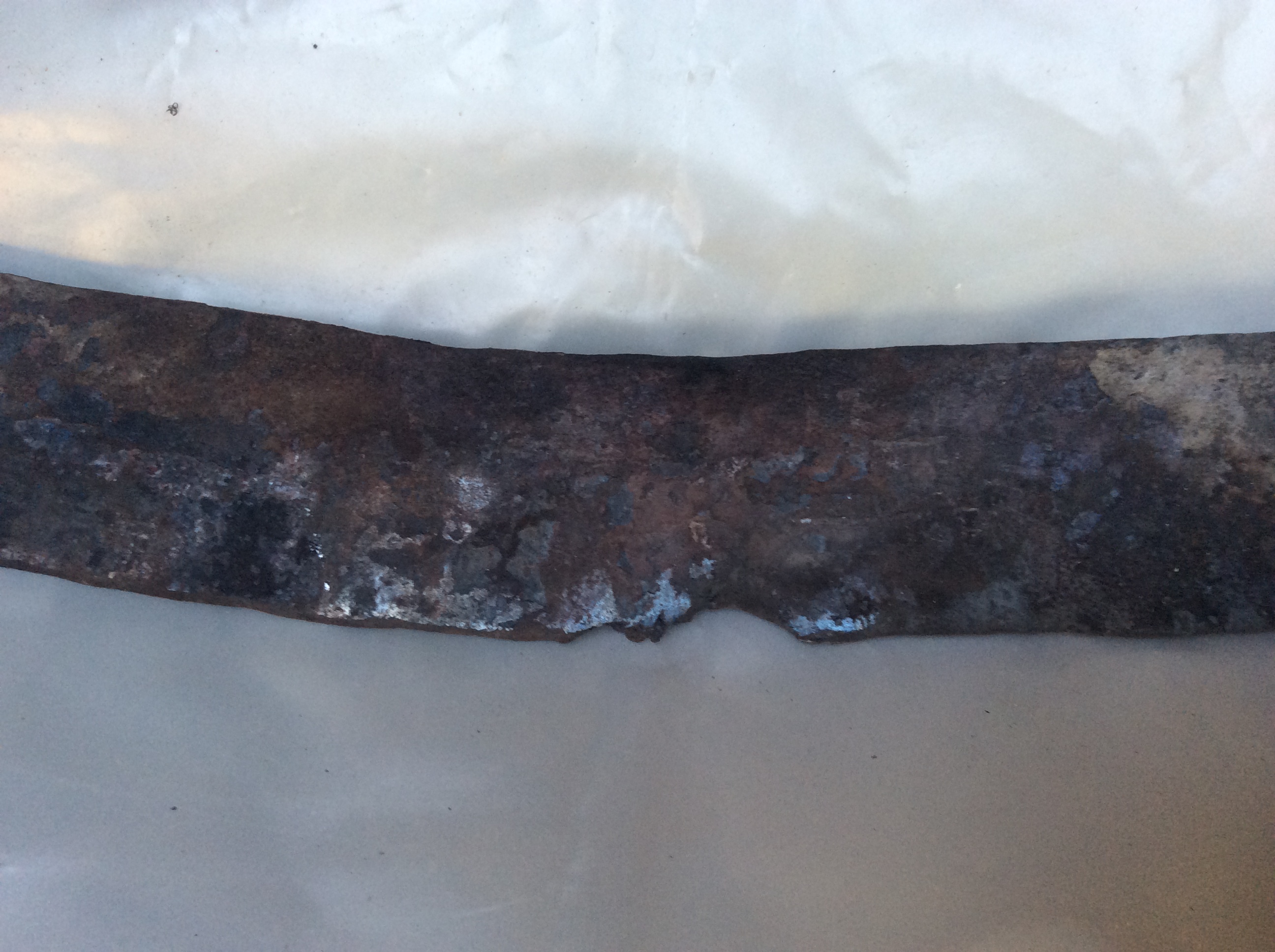

    Mezzaluna/pizza cutter-8fe5d307-72f2-4a2d-819f-0d16d1030246.jpegMezzaluna/pizza cutter-6936ed42-5f6e-410e-8393-98e2cd736311.jpeg

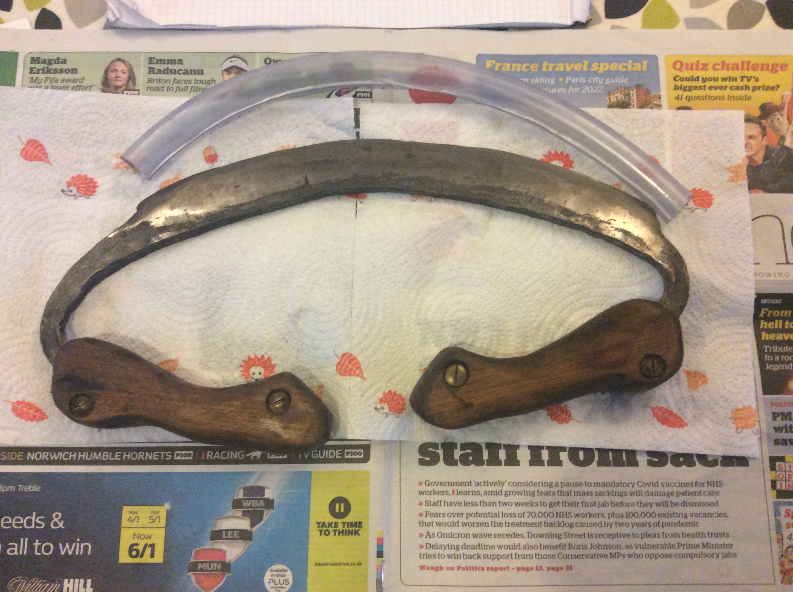

    I had a mishap. A moment’s inattention and there was a burnt bit in the middle.
    That was VERY annoying.
    Not willing to waste all that work ...... it was no good for a Woodworking tool, there would always be a soft spot and even if I heat treated it successfully, it might well crack in use.
    I turned the tangs around, peened out the blade again and ground it up.
    Mezzaluna/pizza cutter-acde960a-91eb-483b-89ca-87f5feb55a72.jpeg
    I think it will cut pizza. Maybe it will stay sharp to chop herbs. But it would look all right perhaps on a farmhouse kitchen wall.
    We haven’t got a farmhouse kitchen.
    Or it might cut fodder for rabbits. It looks like a garden tool, Mrs Davies observed.
    The handles are recycled walnut, laminated. The rivets are from old handsaws. I do not know whether you can buy new saw handle rivets any more, but about 20 years ago they were about £1 apiece, so it’s worth salvaging an old saw, even one that’s been left to rot outside. I found a Disston like that once, 5 rivets and almost nothing else.
    The blade guard is plastic hose.

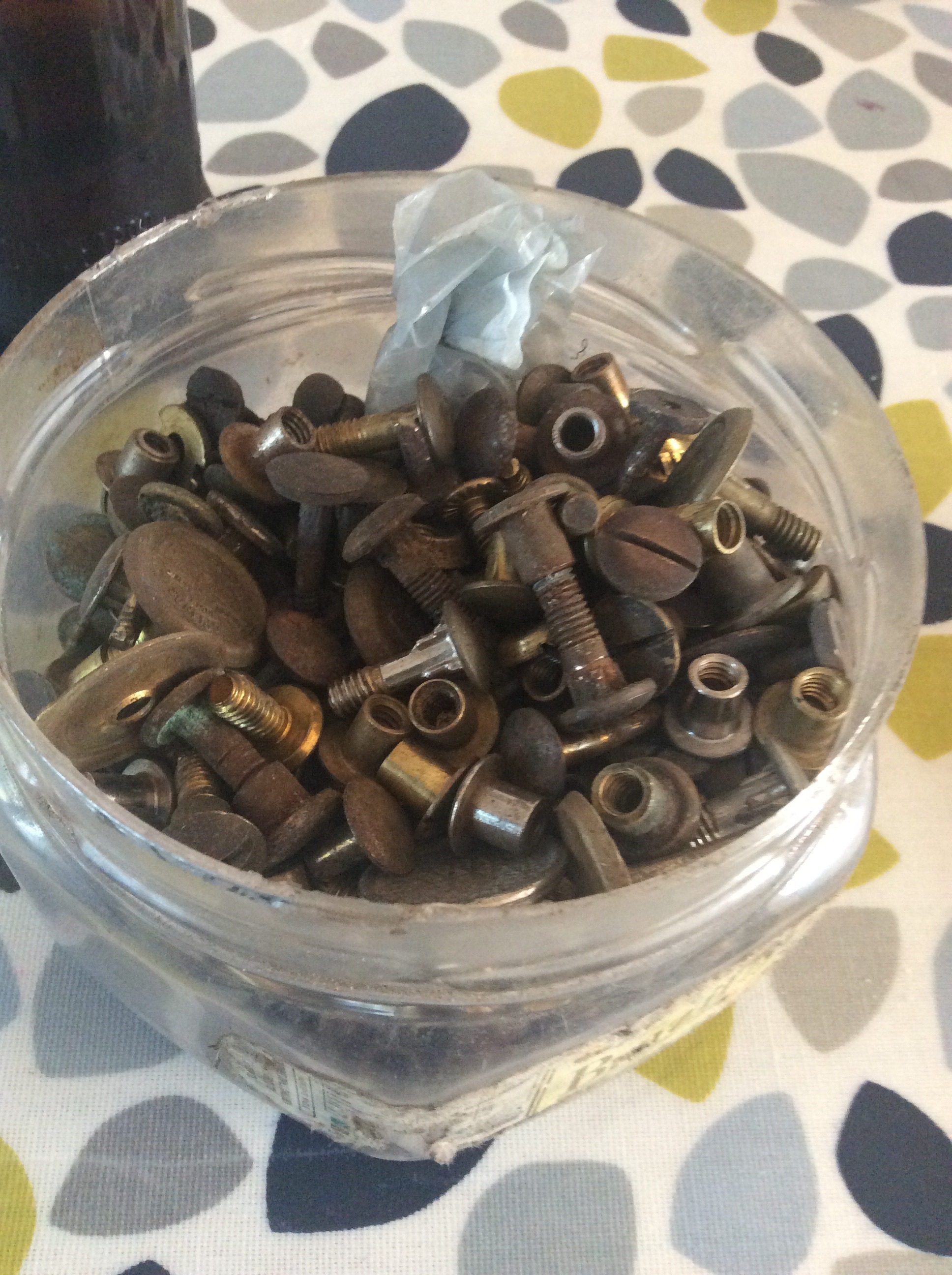

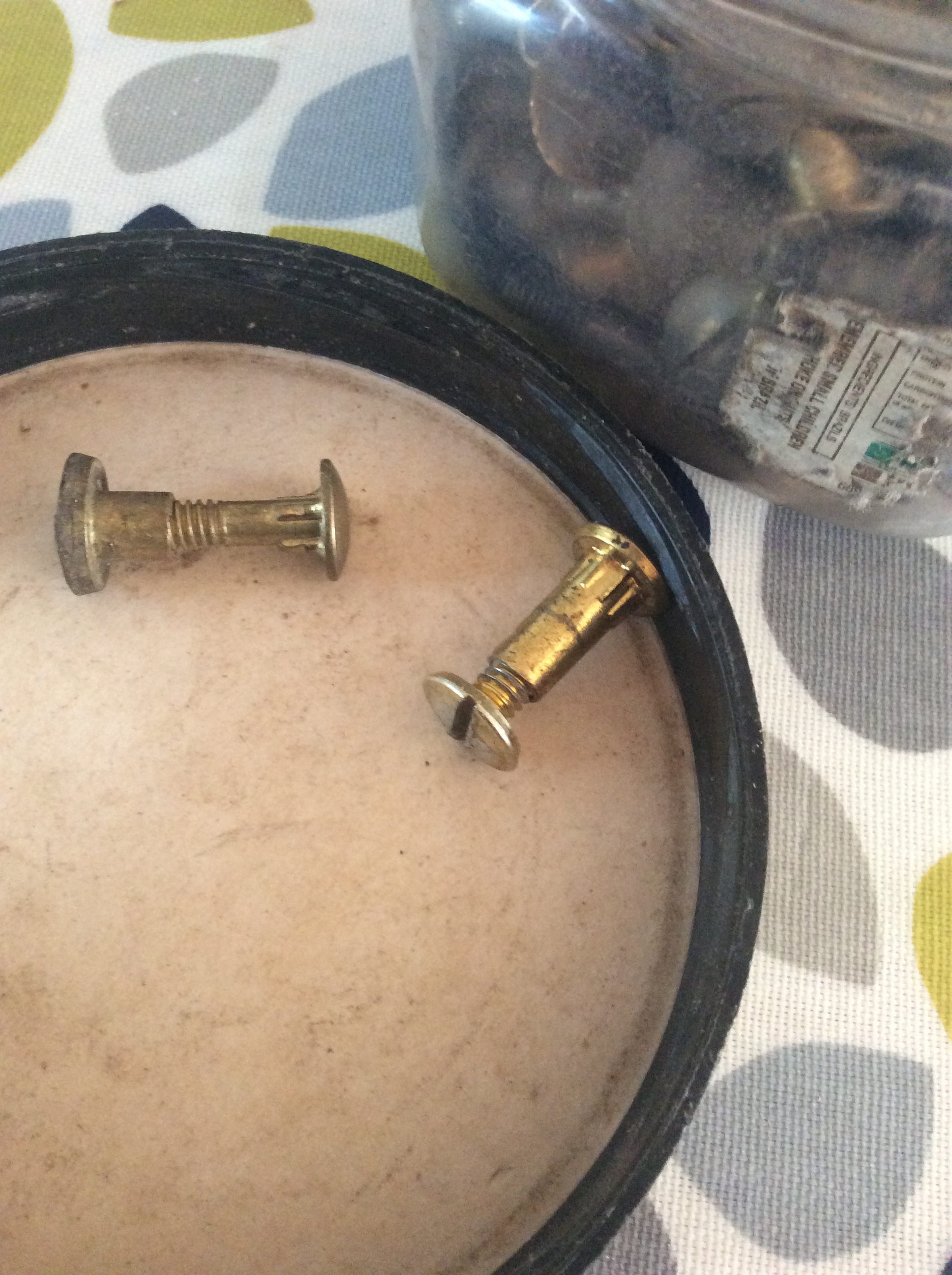

    Thank you kindly. But how many craftsmen want extra rivets for their handsaws? It appears that manufacturing them would require up to a dozen machining processes. The male half has a ribbed shank, the female is a slot screw.
    5,334
    7,044
    Knurling works on faces like diameters, and form tools......well, it's all about how many of that dozen operations are accomplished per chucking. As seen here at HMT.net an auxiliary milling spindle could slot screw heads, just need turned around.
    Mezzaluna/pizza cutter-7591c518-04e2-4f8f-8276-784c4244eebb.jpeg
    Just curious to know how long it would take to make one.Mezzaluna/pizza cutter-image.jpg

    They're called sex bolts and other names: https://www.fastenright.com/products...SAAEgKP6vD_BwE

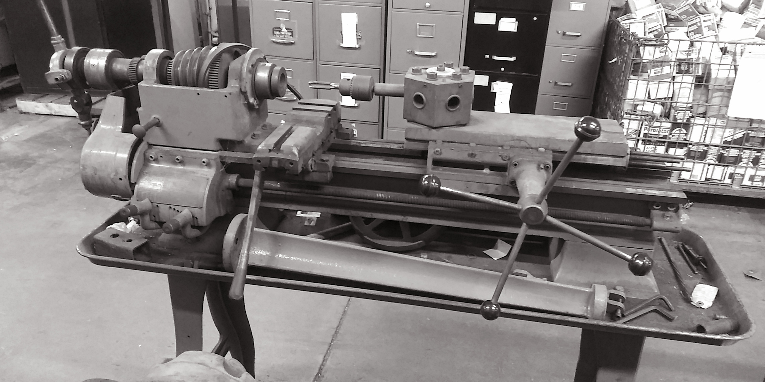

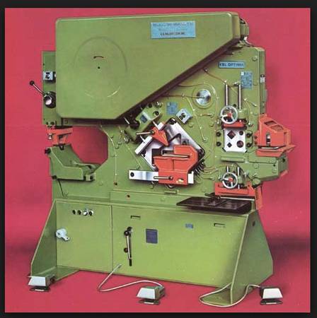

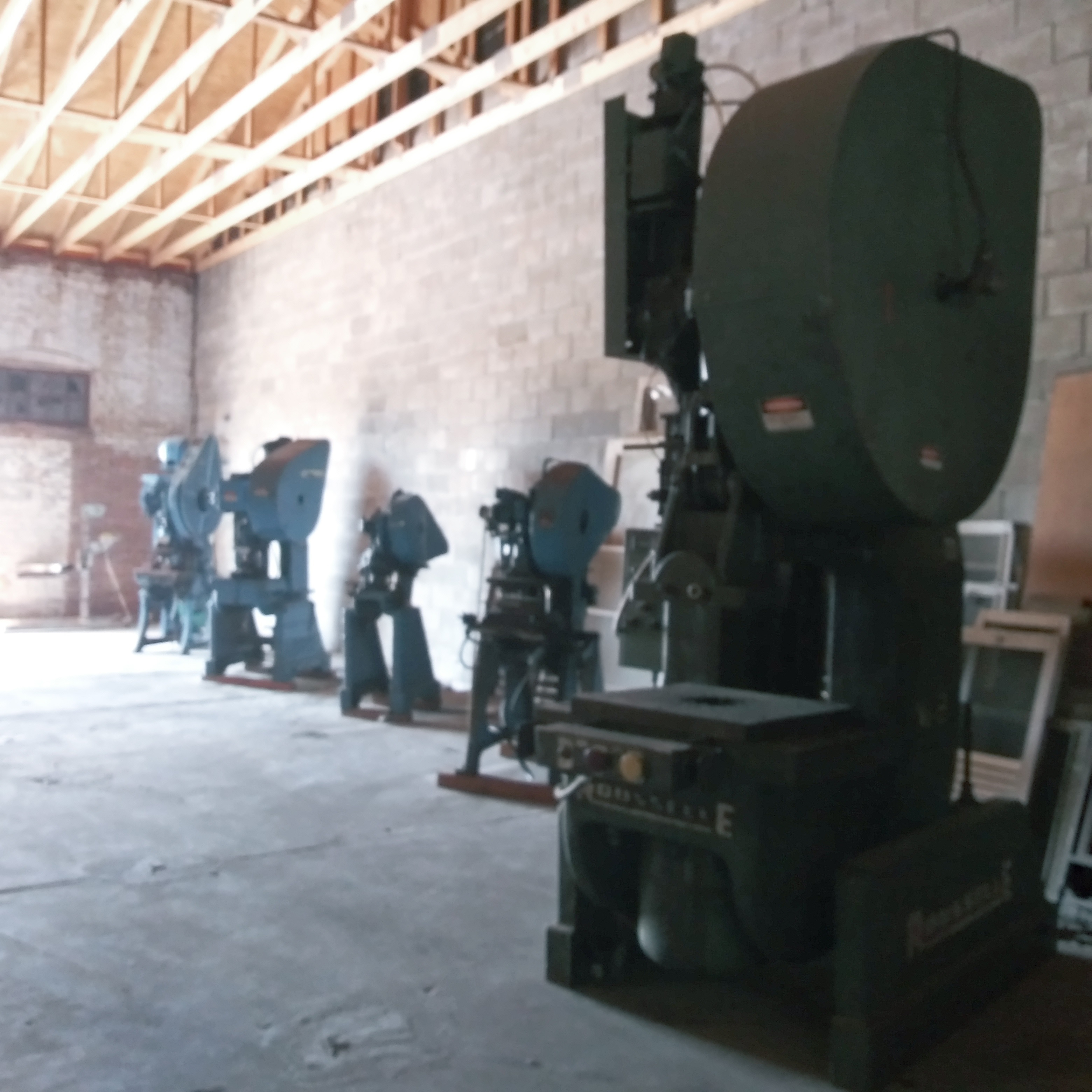

    The ribs too far apart for conventional knurl. They likely ran in four-slides, machine figuratively a 4-sided punch press, ribs and head via simple die hits and sheared from wire spool. Process generally known as "Upsetting". Nobody will have one in garage, Phillip......
    Instead a guy we all know & love has
    88 ton ironworker Mezzaluna/pizza cutter-shear_dieset.jpg,
    85 ton OBI punch press Mezzaluna/pizza cutter-in_place-jpeg.jpg,
    turret lathe Mezzaluna/pizza cutter-logan-collet-turret-leadscrew-thrd-spindle.jpg.
    1] Fed individually to head and rib (both 'coined', plastic deformation) the 'nut' 3-4 seconds each. Turret lathe, bushed in a collet for drill and tap, 10-12 seconds. 'Bolt' side same way, shank a bit oversize turn and thread acorn or geometric, maybe 15-20; no immediate solution to holding a formed part. That end could run as bar stock - turn/ face/ thread same way/ part off. Either process, slotting is singly or gang up, piece of cake.
    Overall ~ Equivalent time, but cost rises due chips and waste. Stamping a nice logo, PD comes to mind ��. <- ah hell; that should have been a funny emoji
    First few hundreds or so, solution is just turned parts, with straight very coarse knurl. Dieset for 'nut' would be next. Betting a bagful not much of an issue; but initials might change.......

    aka "Binding Screws", but most seem around 1/4" 6mm, and aluminum. Googled that, 'binding screws', with results in many diameters.
