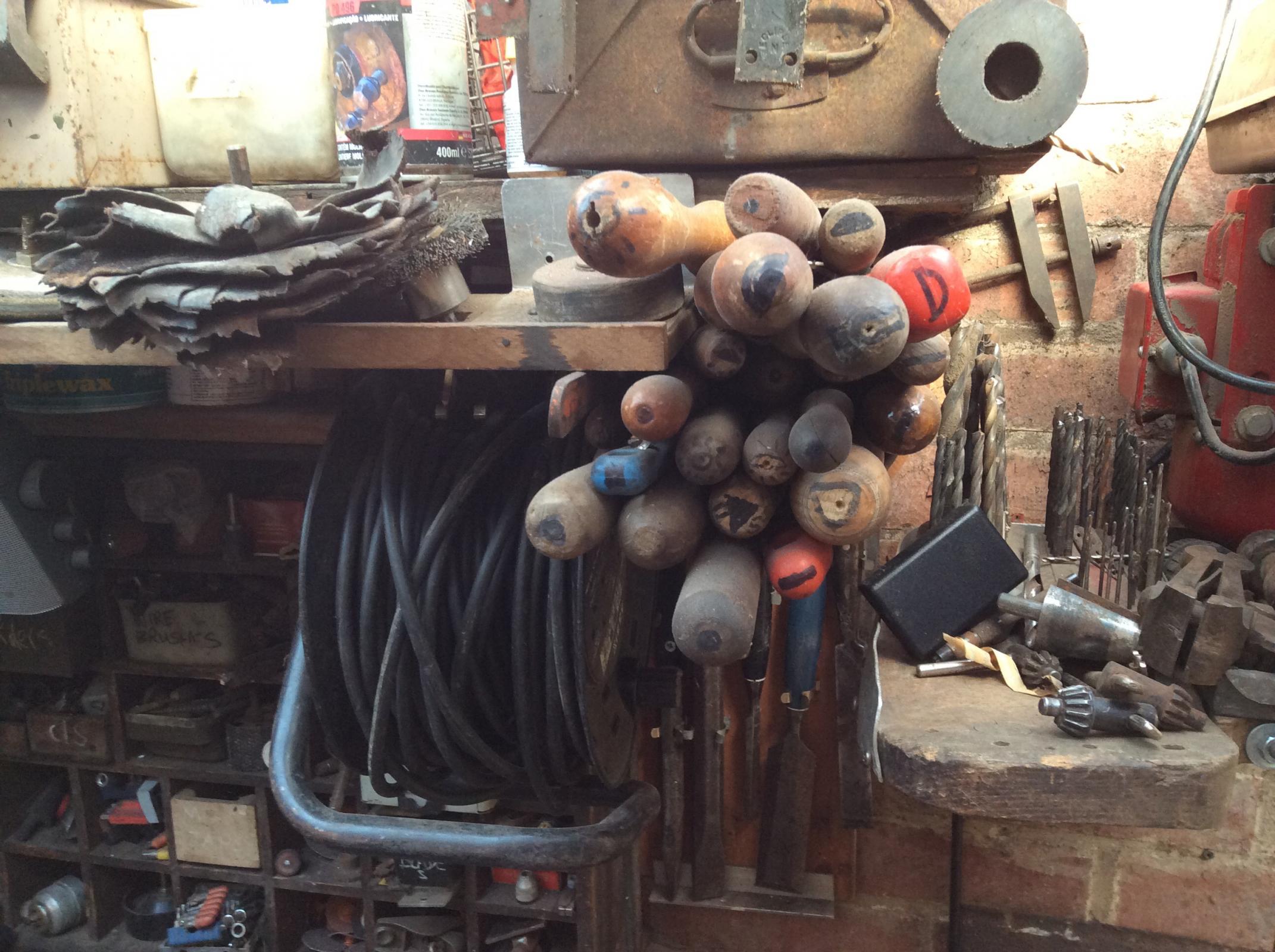

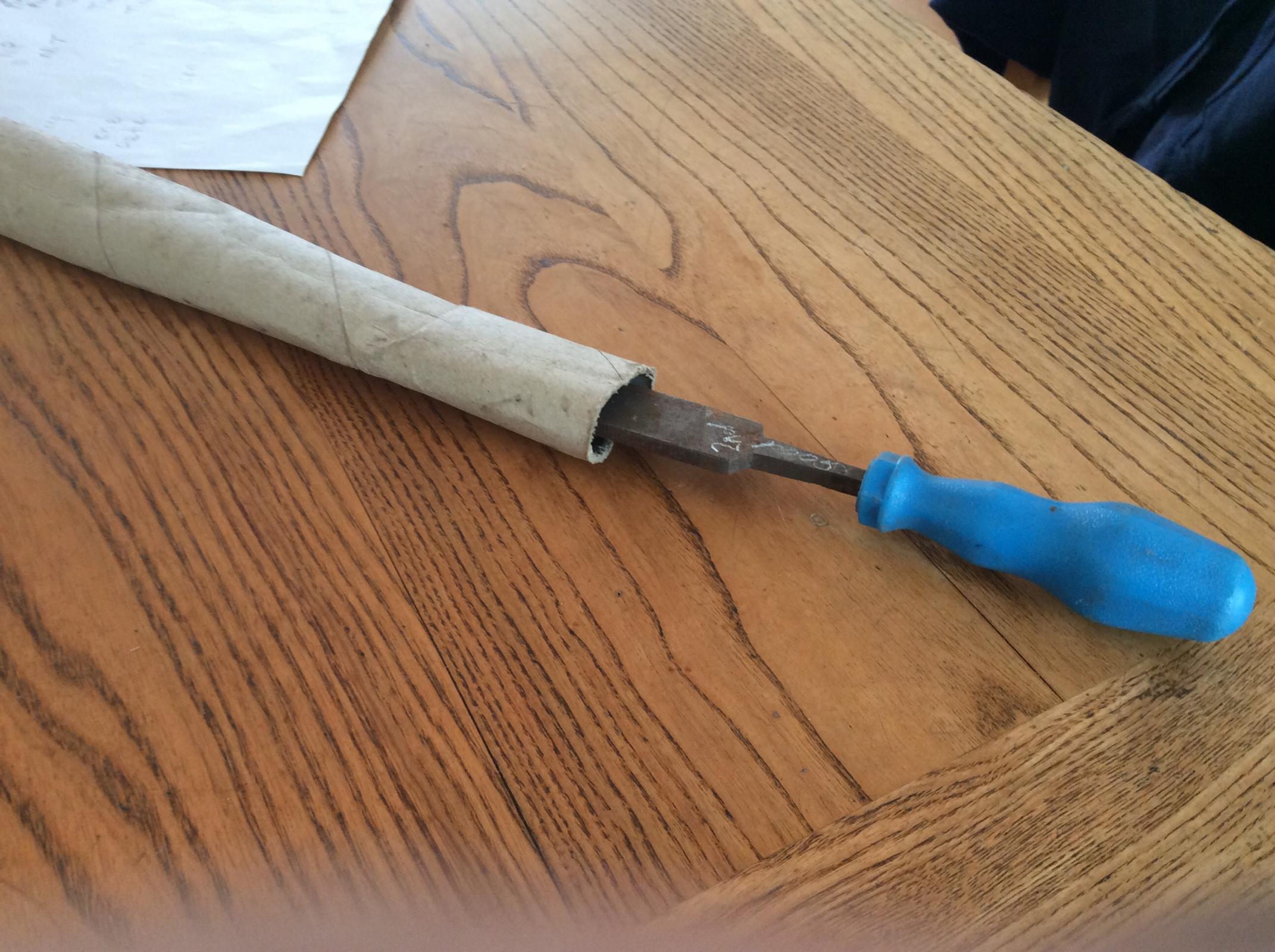

    I protect most of my files with cardboard tubes (or inner tubes)
    Inside a bigger plastic tube at eye height. Type is shown drawn on the end of the handle. (They do not project far enough to bang my head)

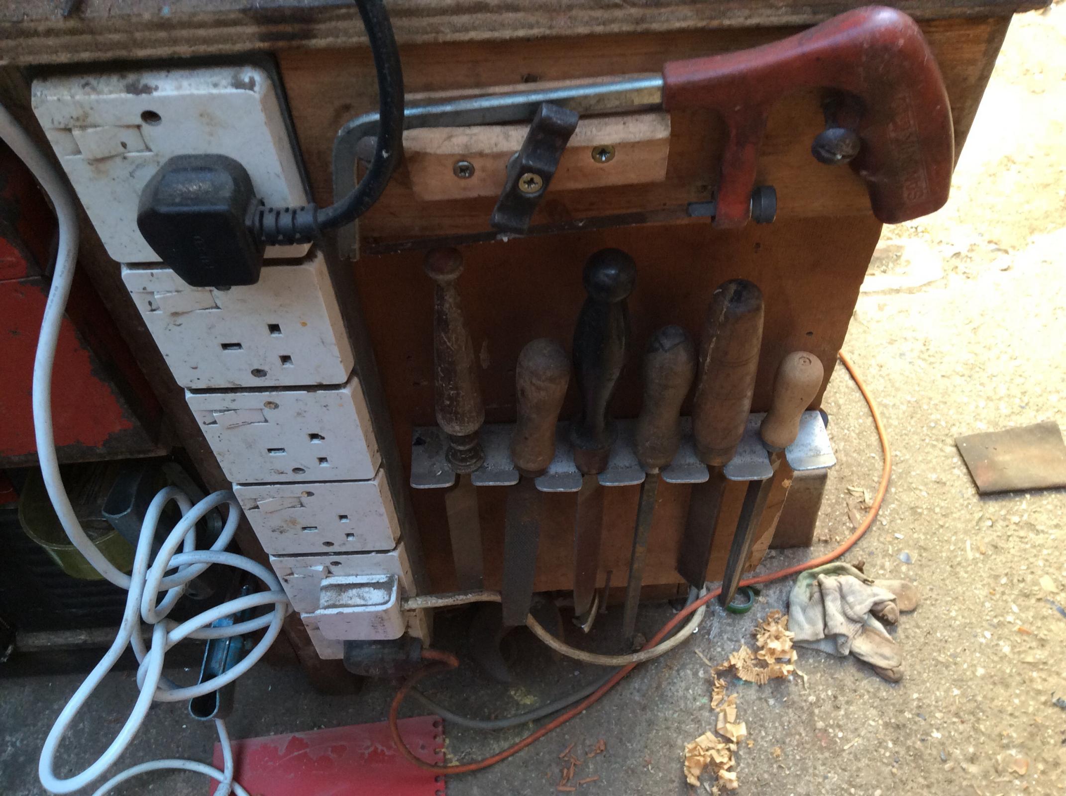

    Metalworking files storage/Tool protection 2 :cardboard tube-image.jpg
    In a rack for the most frequently used

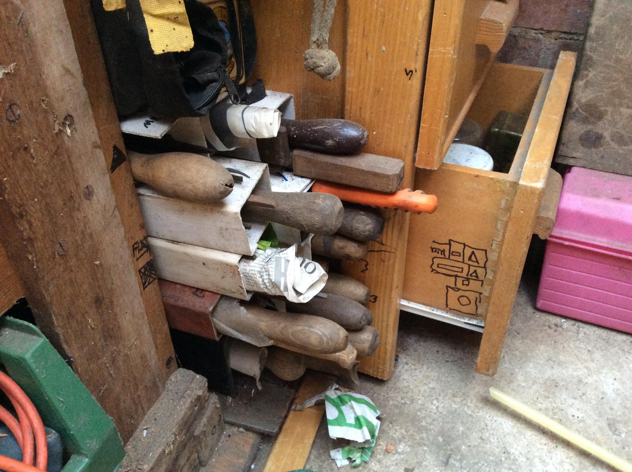

    Or in reserve, in box tubes
    You may notice the key I’ve drawn on the side of the drawer, to remind me which tube contains which type of file.
