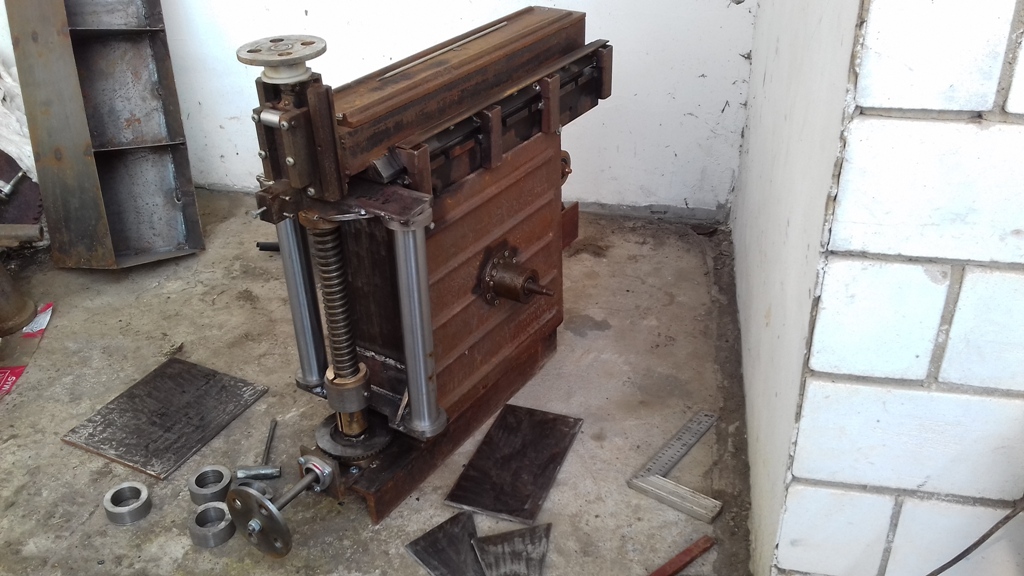

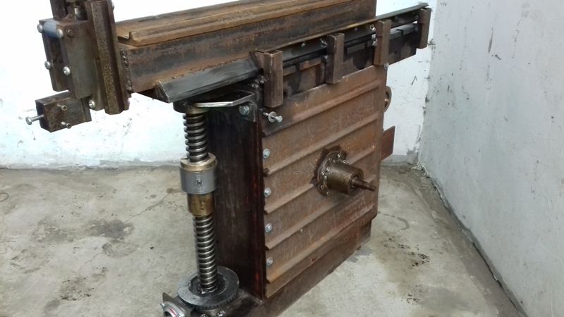

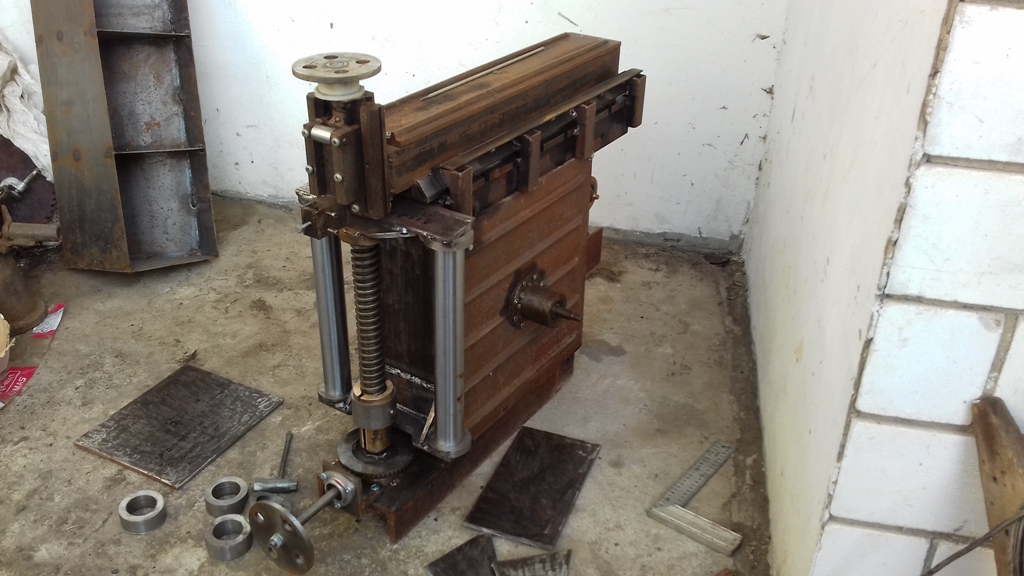

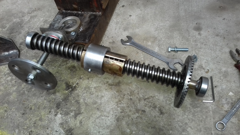

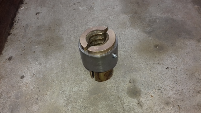

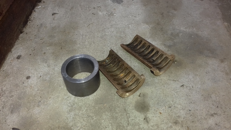

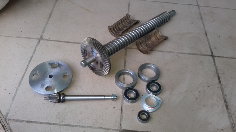

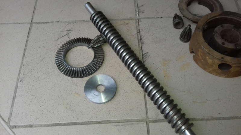

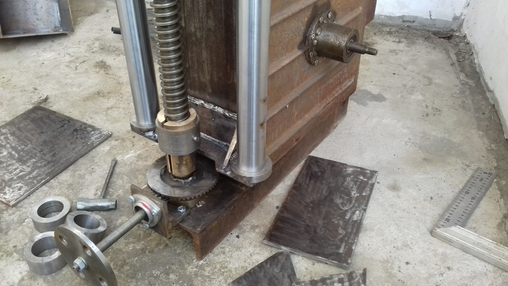

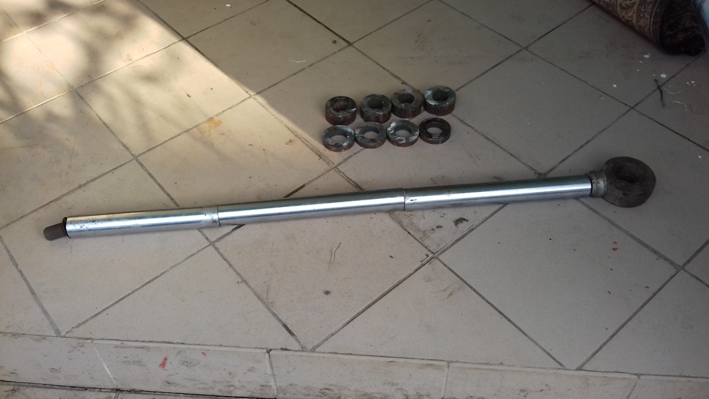

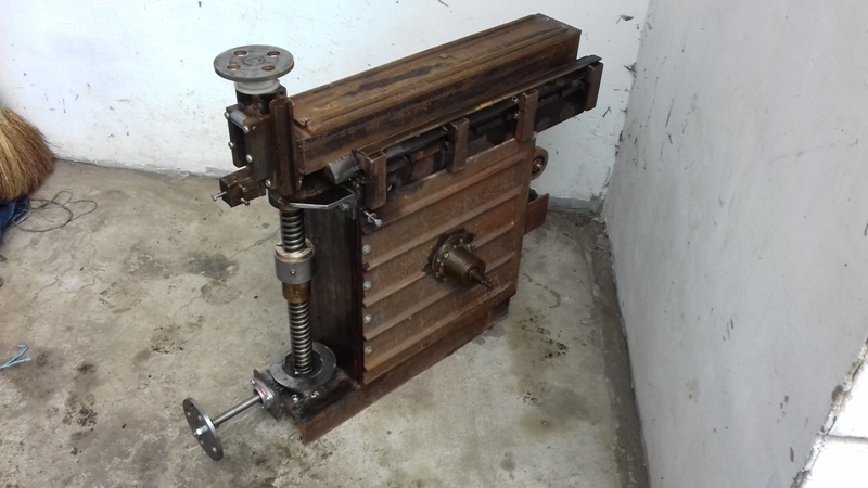

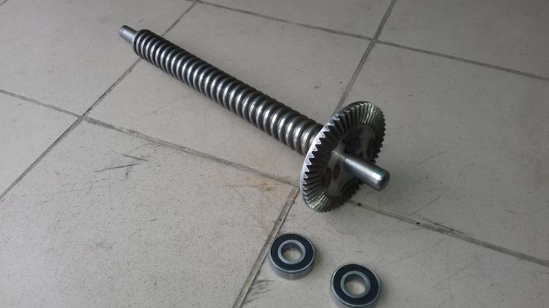

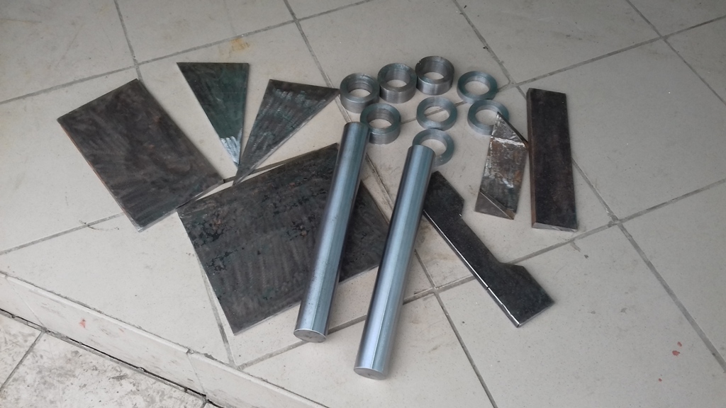

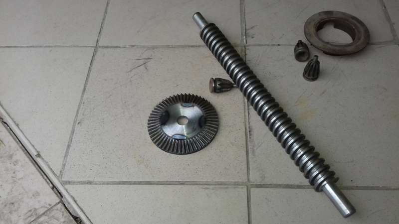

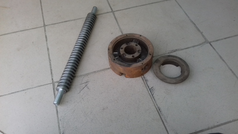

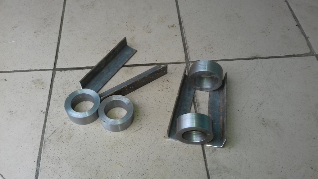

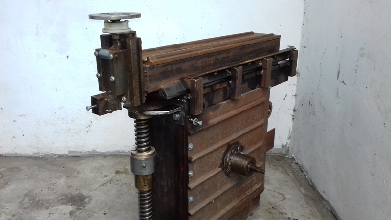

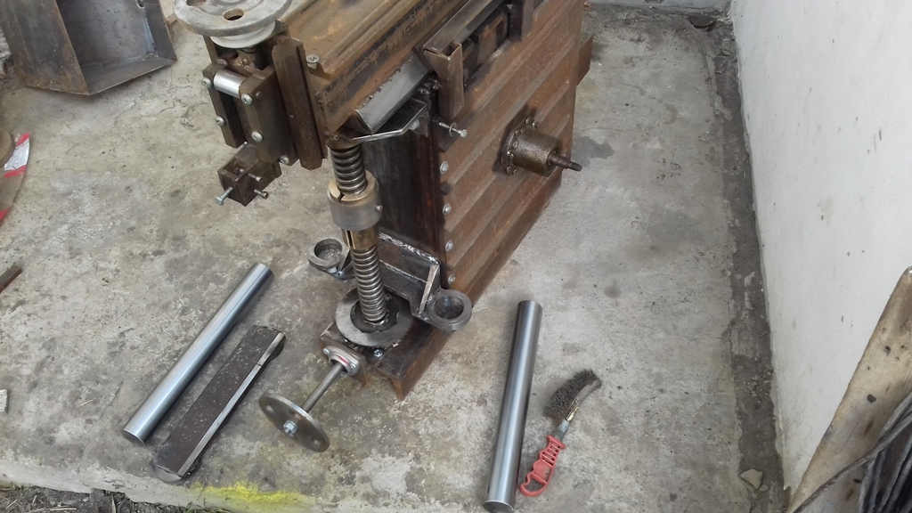

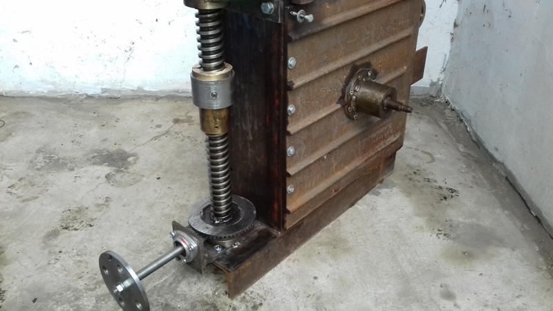

    Resumption of work on the project
    Metal shaper-20191202_113523.jpg Metal shaper-20191202_142924.jpg Metal shaper-20191202_144027.jpg Metal shaper-20191203_091415.jpg Metal shaper-20191206_150434.jpg Metal shaper-20191212_141017.jpg Metal shaper-20191212_141236.jpg

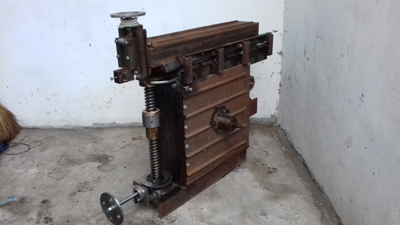

    The next stage is the production of the coordinate table.

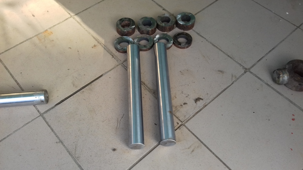

    Quote Originally Posted by Vyacheslav.Nevolya View Post
    Z axis is completed. Used a hydraulic rod with a diameter of 45mm excavator hydraulic cylinder, sheet metal 10 mm.
