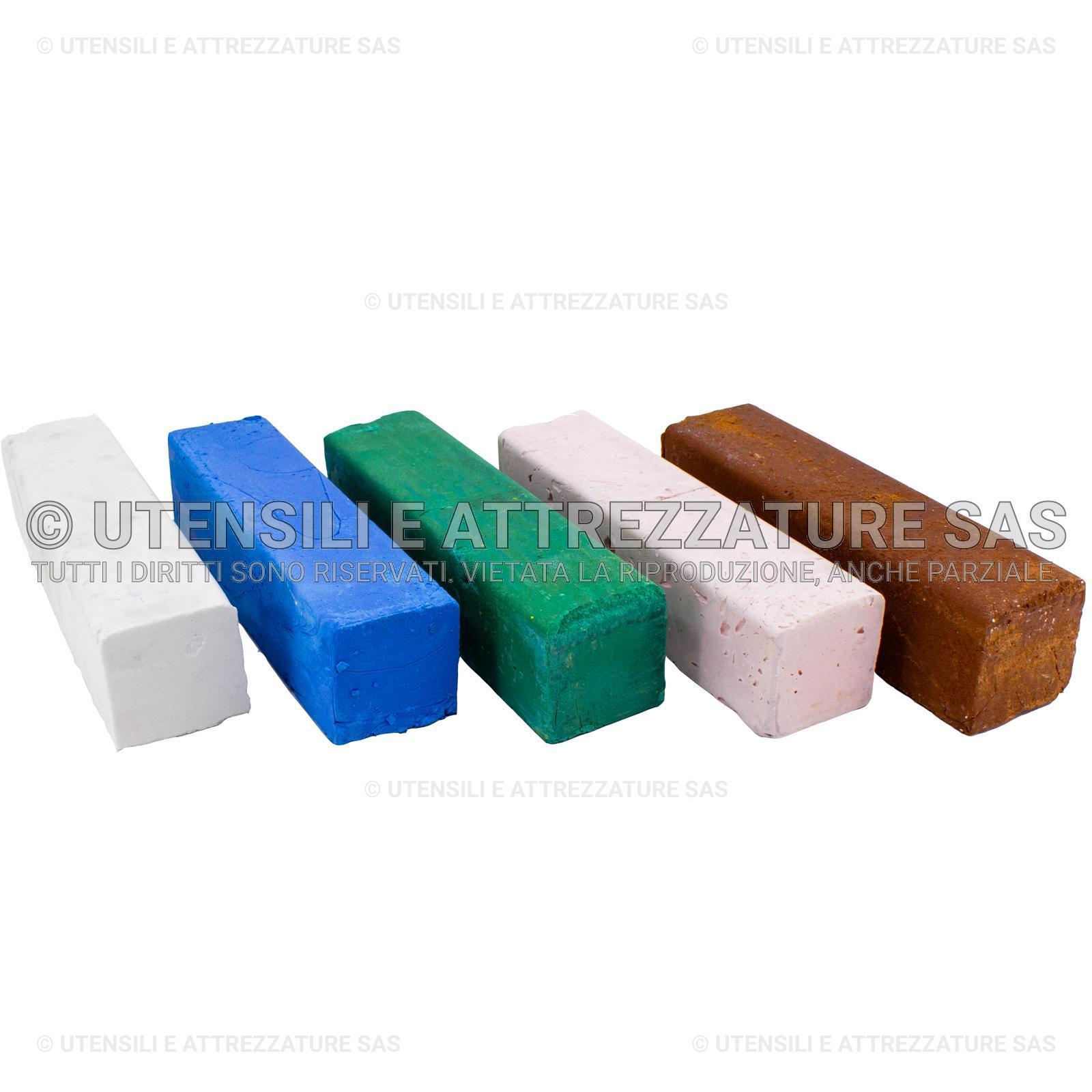

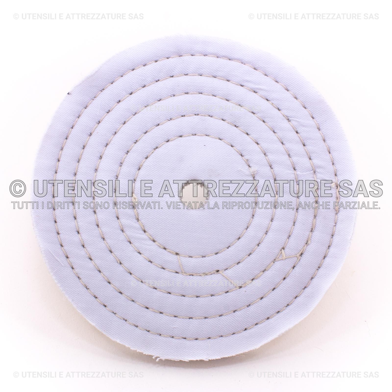

    I'm wondering what I have to buy, I need to make a very shiny and good surface on aluminum, brass and steel.
    I found:
    Disc:
    - cotton soft
    - cotton lined
    - cotton\sisal
    Paste:
    - White roughing ( i have already )
    - Blue buffing , 2nd passage
    - Pink polishing alu and brass
    - Green (only for stainless?)
    - Brown scratch removing gold silver
    My question is: which paste should I buy? I think all 4, maybe the green is not useful?
    Second big question, it's necessary one cotton disc for each paste or it's possible to mix the pastes on one disc?

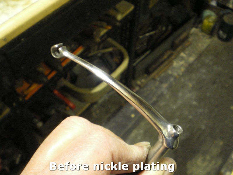

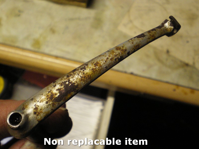

    Best advice is to download from Plating Kits Electroplating Kits Aluminum Anodizing Kits Gas Tank Sealer Metal Polishing And Buffing Supplies - Caswell Inc a free PDF guide to all metal finishing.
    If you are serious about it I would beware of cheap products as they have not worked well for me in the past.
    Golden rules are one wheel for one abrasive (never mix), and keep in bags when stored, I do a lot of restoration work and have learned the hard way. Good luck with it, a couple of examples of what can be done.Metal polishing advice-imgp0048.jpgMetal polishing advice-imgp0053.jpg

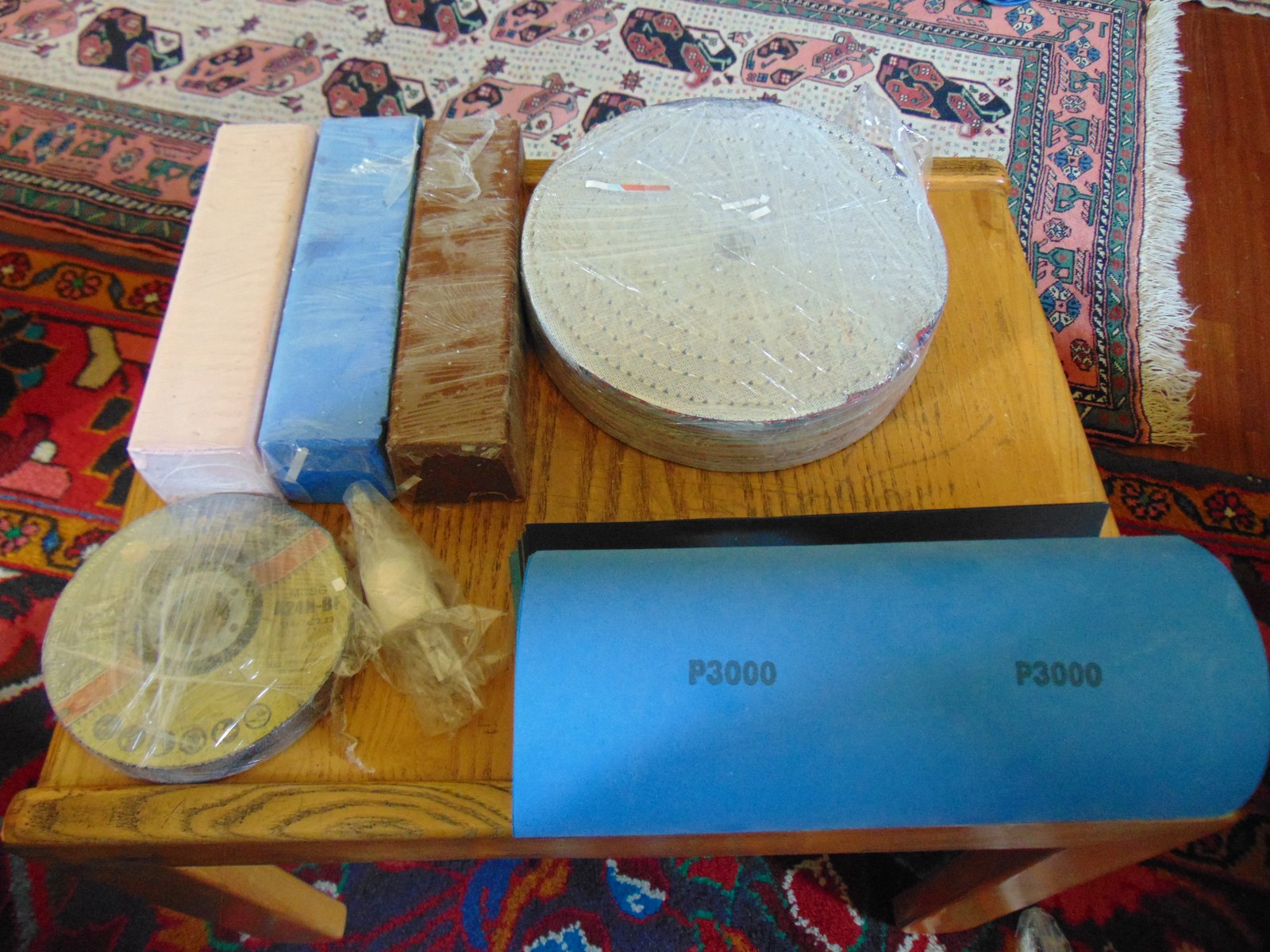

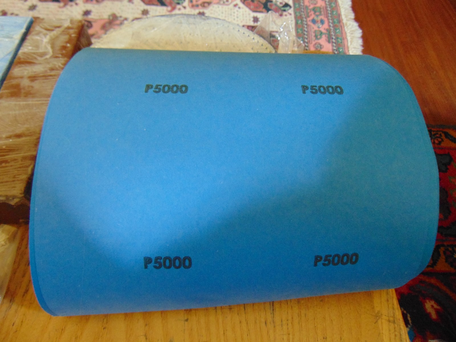

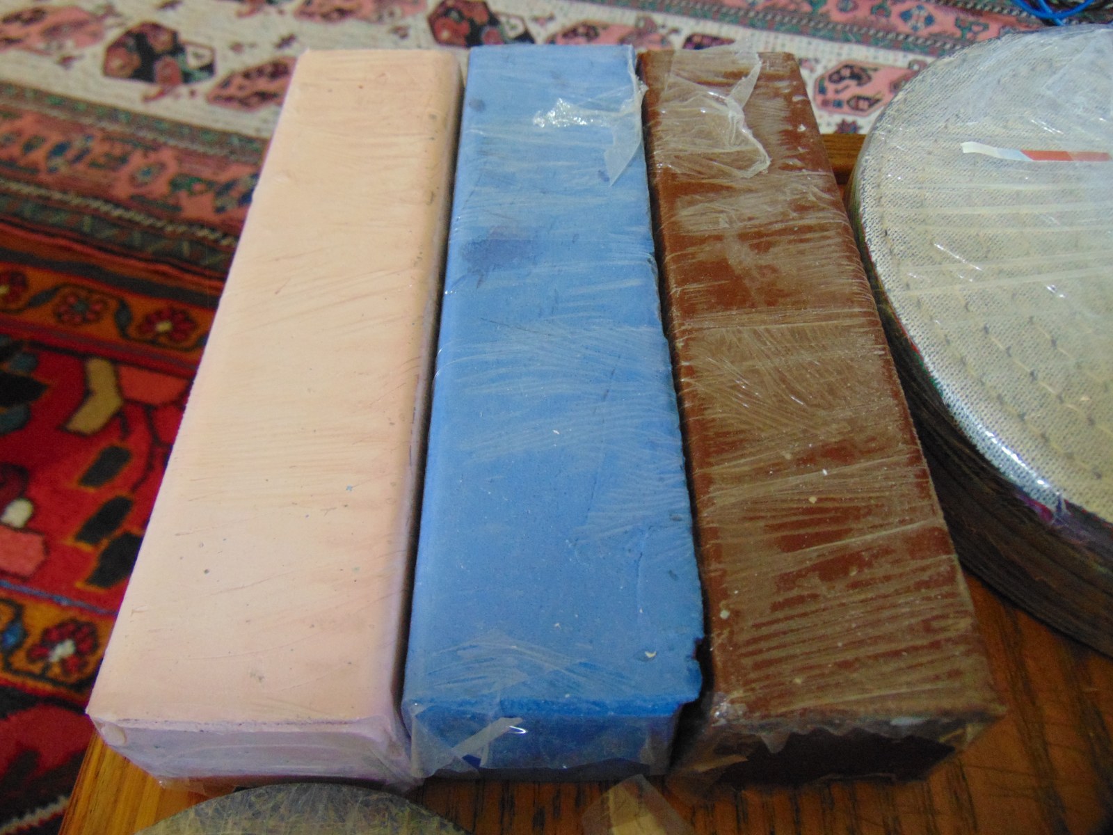

    Just arrived!
    Since I have the White (first passage) paste I bought the pastes for cutting and polishing, with 3 cotton wheel 200mm, complete set of sand paper from 40 to 5000 grit
    I hope I will test soon!
