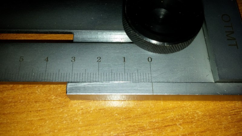

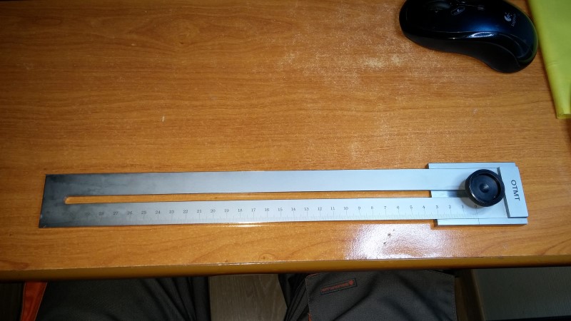

    I have just purchased a parallel marking gauge, the metal working style.
    It appears to be neatly done and should be quite sturdy but accurate.
    But Sadly there is no vernier on this model, so only a mm reading.

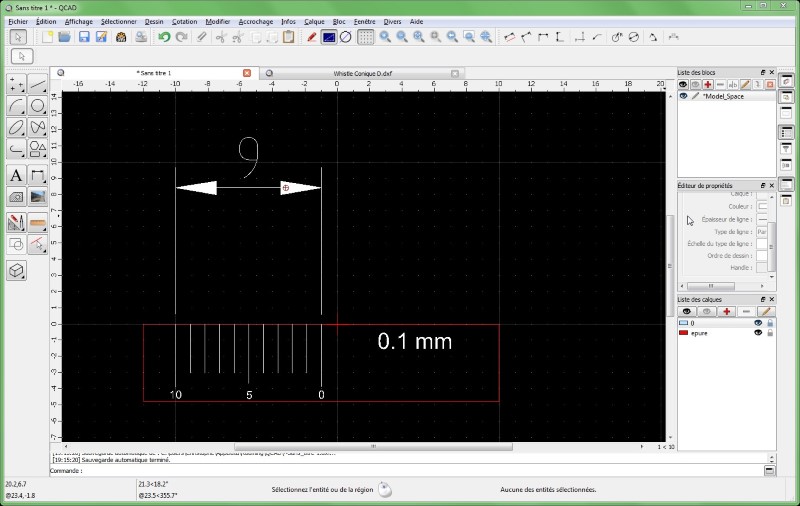

    So I decided to make this addition. quickly went to my CAD software :

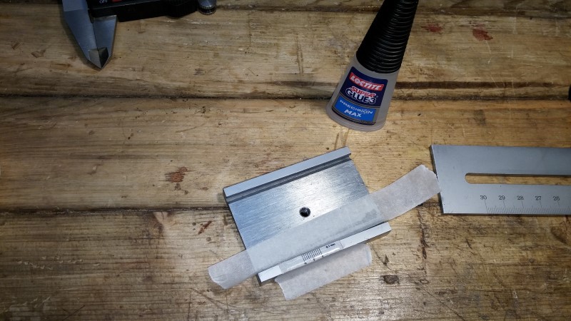

    Then printed out the little stamp and, after cleaning up the surface with alcohol, stuck it on the metal.
    I then protected the paper with a few drops of CA glue. (adds a little magnifying effect)

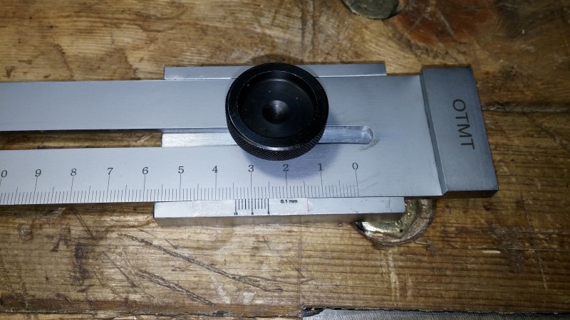

    And here we go !
    Here is a pdf of the vernier, if could be useful to someone.
    vernier_0.1mm.pdf

    I like your technique. I was thinking along the lines of etching the metal and yet your technique is more straight forward and looks very durable with the CA coating. Thanks for the directions.

    Thanks Christophe! Me too, love the idea of these stick on graduations for a lot of things (like your index plate). I use it sometimes for layout as well on bolt circles and more complex layouts, mainly for center punching. Are you using an inkjet printer or a laser? Years ago I used "Sticky Backs" (transparent slide presentation material) but found the laser printer heat would shrink the material non linearly and more in one direction. With the inkjets you can set your printer to 600-1200ppi or higher (uses more "Valuable" ink) and get very fine work from an inkjet based on your CAD line width settings. It is very linear because their isn't the heat and definitely close enough for home shop work.
    Really appreciate your project(s) and how you made it Much Better!! Thanks for sharing it! ~PJ
