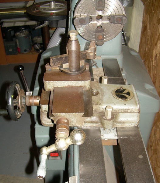

    Not strange at all Christophe, good idea and nicely built. My Delta lathe came with one, though it clamps directly to the bed, the Reeves drive gets slow enough to turn metal on it and it works great for more precise work on wood especially faceplate work.

    Thanks Carlos, I didn't know there was some commercial version of such a slide. Do you have a picture ?
    I found it easier and more versatile to fit it on the tool rest post, and installing it on the bed would be more difficult because of the difference of height.

    Yes back in the second half of the last century Rockwell/Delta had a lot of nice accessories for their machines I have the copy attachment too.and a three and four jaw chuck.I got the lathe at auction I had to rebuild the lathe but the compound is the way I got it just needs a good cleaning and some new handles. I used it a couple of years ago to do my tractor starter commutator, other wise it has just been sitting.Here's a couple of pictures.
