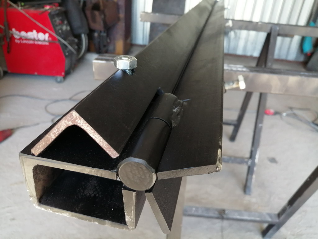

    Construction of benders, sheet metal benders. Working width 130 cm.
    The construction was used:
    metallurgical channel 100x45 mm
    2x metallurgical angle 50x50x5 mm
    2x turned hinges, diameter 25 mm
    5x M10 screw
    profile 30x30x2
    profile 25x25x2
    expansion spring
    socket 17 mm
    50mm x 5mm flat bar
    FREE PLANS
