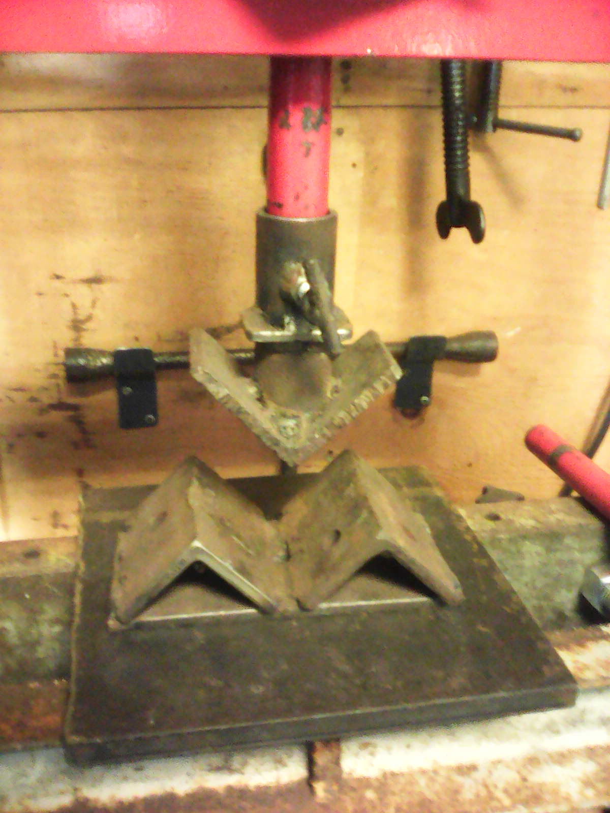

    Jig for bending flat or round stock using a hydraulic press, makes nice tight 90° bends. This one used 2" angle iron, I also have a smaller one made with 1" angle.
    Attached Thumbnails Attached Thumbnails Metal bender for use in a press-bending-jig.jpg
