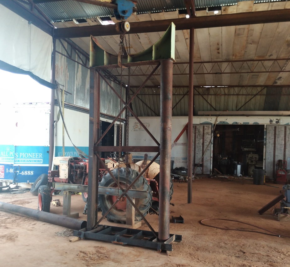

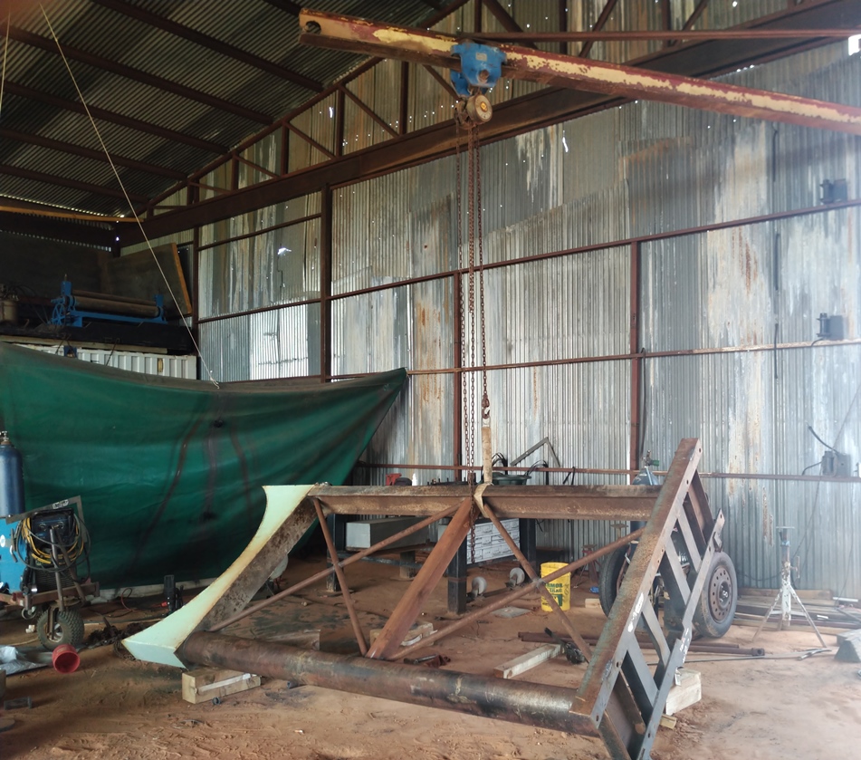

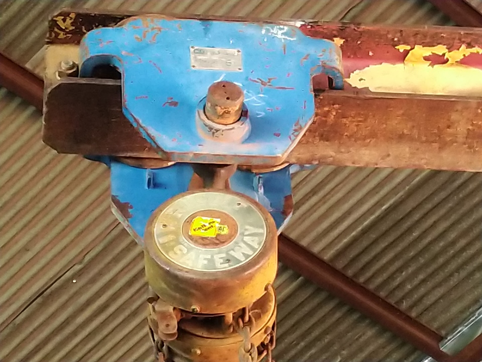

    the crane in use
    having this sure makes for a much easier and safer way to do things
    I could do with extending the boom another 19 feet for more reach and larger coverage area, which could happen in the future as when I designed the hero column I mounted it on I made it strong enough for a 5 ton crane 12 ft from center line on the inside and the outside of the shop with 3 ton capacity at 25 feet from center line as long as the opposing crane was used in conjunction with a counter weight of at least half the load weight when at full length of the beam since I only plan on ever having larger than the 1 1/2 ton hoist I can extend the beam without worries the experience of having built dozens of these in the past even much heavier duty free standing ones installed on US Military bases over seas plus designing and building the bridges for bridge cranes up to 60 ft long and 20 ton cap lets me feel more than qualified to build my own baby jib cranes by comparison

    I am constructing a tower to place my 3000 gallon water tank on which was a huge part of the timing of installing the jib crane
    More about the stand and the water tank at a latter date

    What Wizard69 says is correct. In planning for construction or mounting a JIb crane be it a freestanding or mounted to an existing structure the forces acting on the type of mounting increase exponentially with each foot out from the center of the pivot
    here is a link to a 3 ton free standing crane I built many years ago to meet the MIL spec requirements everything associated with the crane itself excepting for the actual hoist was required to be tested to a load of double the rated capacity take special note of the excavation for the base mount
    3 ton free standing jib crane
