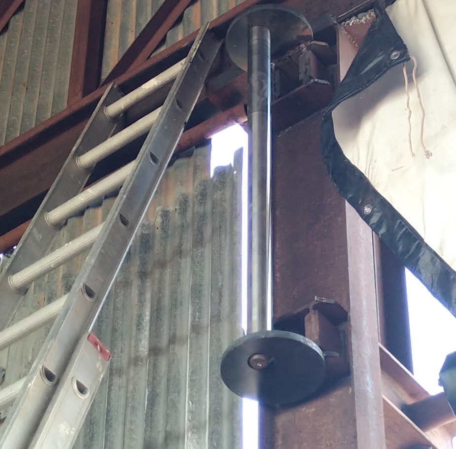

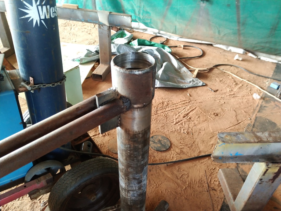

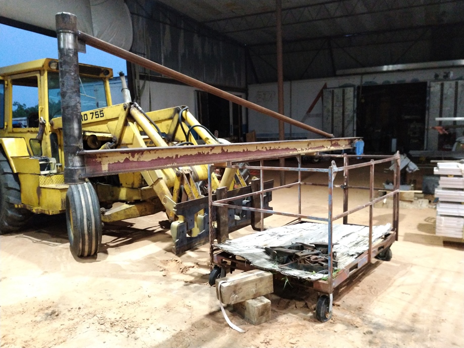

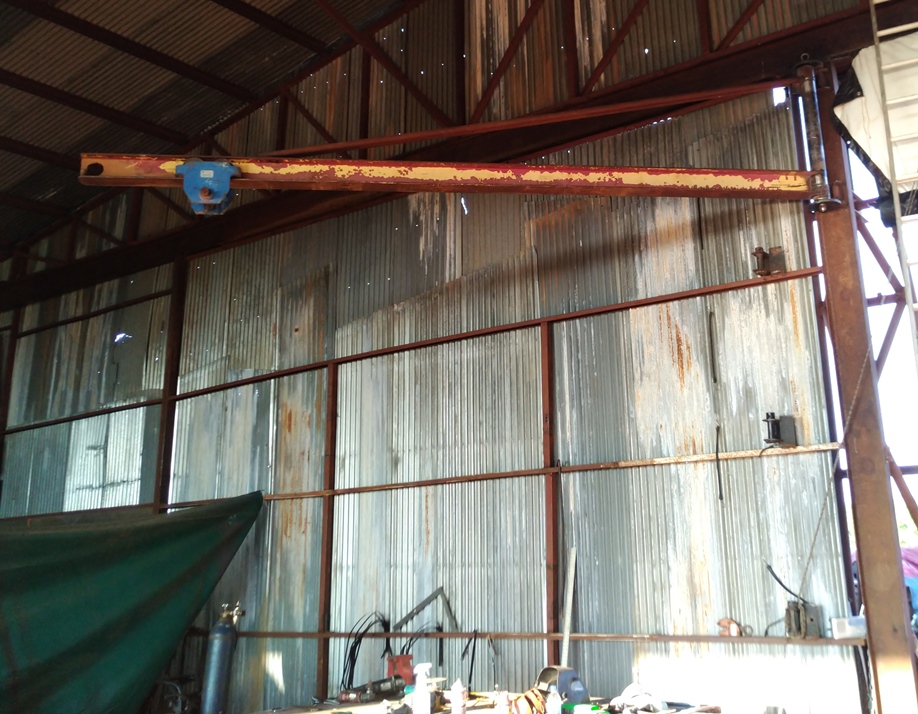

    Using a forklift or my backhoe to help lift heavy things while I assemble them has never been among the things I relish. While either machine will do the job and do it quite well the constant mounting and dismounting the machines get tiresome not to mention when on either it is difficult to place the object exactly where I want r need it.
    So I decided it was time to construct another jib crane for my shop over a work station
    This one is a medium duty jib crane made out of a WF6x6 x25 lb.ft beam 16 ft. long the stem is made of 4" XX pipe 1/2" wall thickness banded on both ends with 5" sch 40 pipe split and drawn tight tot eh stem then full welded then each end bored for 2 7212b (60x110x22mm) angular contact bearings fitted in each end
    the stabilizing tension bar is comprised 2 1 1/2" sch 80 pipes welded to either side of a pair of 1/2x 2 1/2" plates
    the hoist trolley is 5 ton rated but I will only be installing a 1 1/2 ton chain hoist
    I still have to weld some gussets to the mount on the hero column insure proper support for the 3/4" thick mounting plates I installed

    Tuomas, the height of the beam has little to do with the size of the base or column that supports it.
    it is the load center distance from the mounting or pivot point the farther the cantilevered distance is the stronger the pivot and base must be unless there is an equal counter weight opposite of the load
    For a free standing jib crane the anchorage to the ground becomes the most important consideration second is the slenderness ratio of the column for a given height.
    If you were to tell me the max weight you need to lift how high and how far from the column or base the load needs to be raised I can tell you what you would need to accomplish your task.
    another thought is if you only need something temporary you could possibly utilize a gin pole type crane with a counter weight.
    A lot of people who only need to lift say half a ton or less to a height of 2 or 3 meters have modified mechanics shop engine hoists by turning the beam around and adding weights to the hoist base this allows the lifting device to remain mobile while the base is out of the way of their work
