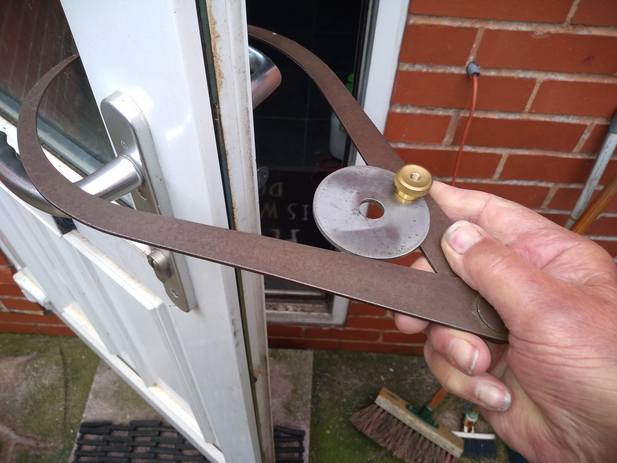

    Double glazed units have variable size thicknesses, to measure this without deglazing for replacement needs a special tool to measure around the frame profile.
    A commercial tool is available but for a one off its not worth it.
    Name:  Screen Shot 06-10-24 at 11.49 AM.jpg
    A simple mod to an outside caliper using an eccentric disc will do the same job.

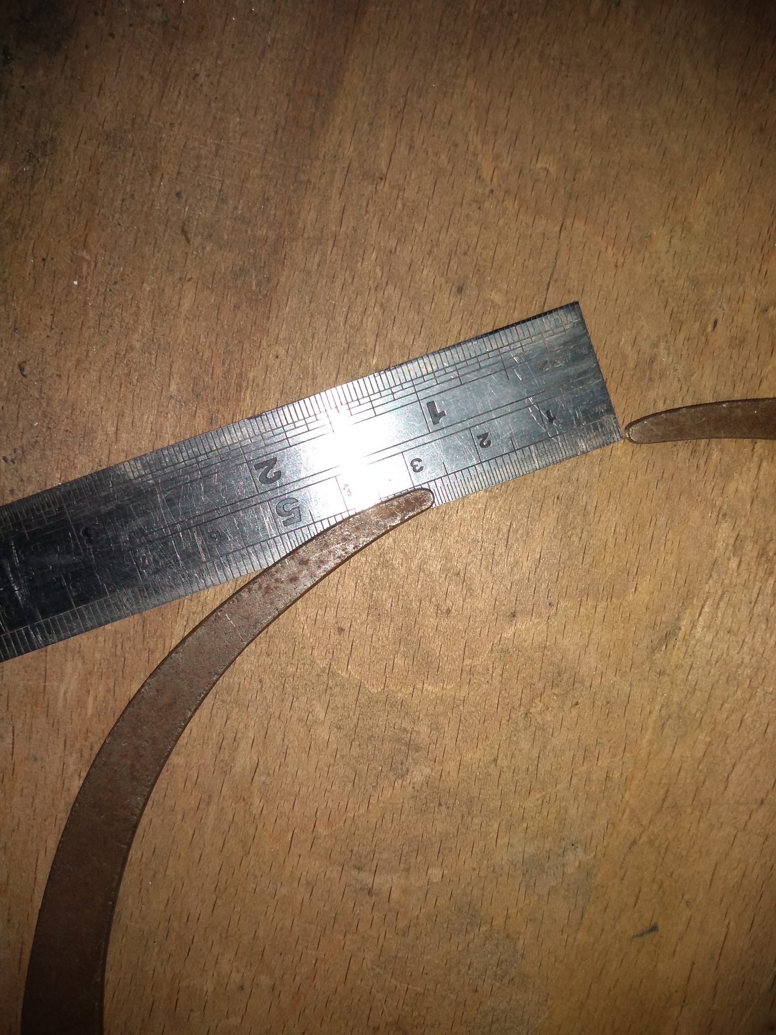

    Clamp the caliper on the glass, rotate the disc and lock it, after removal the caliper can be closed to the disc retaining its original position.
    Height and width are typically minus 10mm from the frame bead joint.

    Despite seldom having to make obstructed measurements like this, I like this idea of resettable calipers. I can think of a few other uses for this added feature. If one has calipers with a screw adjustment, adding a stop nut to the threaded rod provides this refinement.
    Other approaches to the problem...
    Measure across a block held to one side of the glass. The block must be large enough to force the calipers to be opened far enough to clear the obstruction. Subtract block width from caliper measurement.
    Simply open the calipers far enough to clear the obstruction and measure their opening. With one arm against the glass, measure the distance of the other arm from the (other side of) the glass. Subtract the latter measurement from the former.
