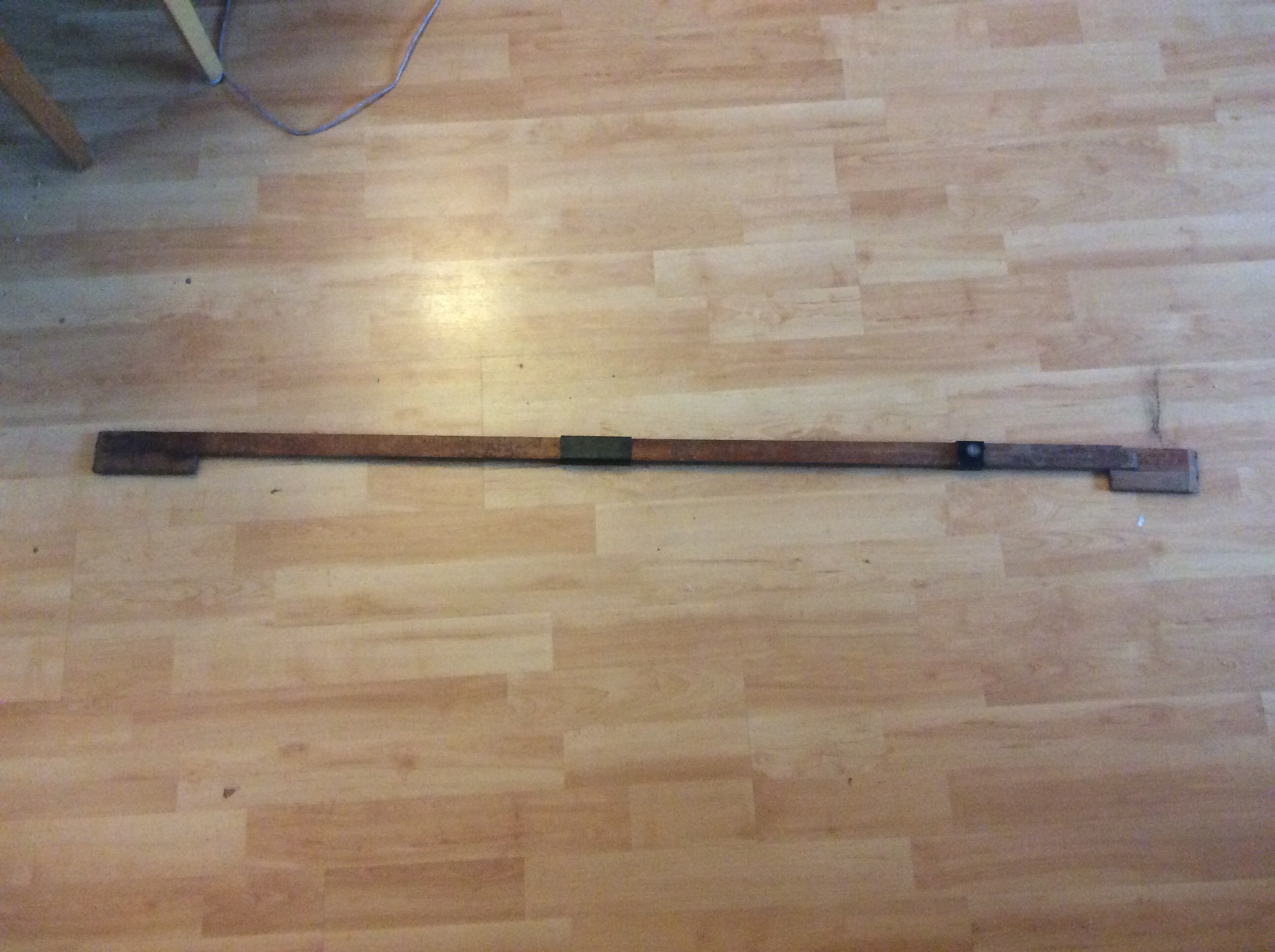

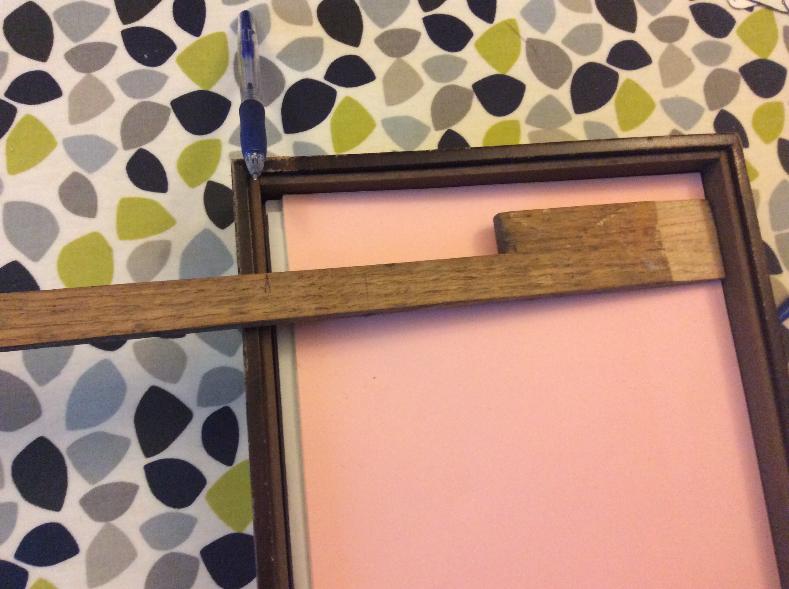

    I may have put this forward before. Working with learning disabled assistants, I tell them not to use a tape measure. Actually, I usually only use one to elicit approximate dimensions. The EZ Measuring Stick sounds like pinch rods. You can hardly go wrong with pinch rods and the method is easier if you devise a method of clamping.Measuring Inside Dimensions with a Tape Measure-image.jpgMeasuring Inside Dimensions with a Tape Measure-image.jpg .The first picture shows a pair for testing diagonals on doorways, etc. The second show a short rod or stick to measure the inside of a box.

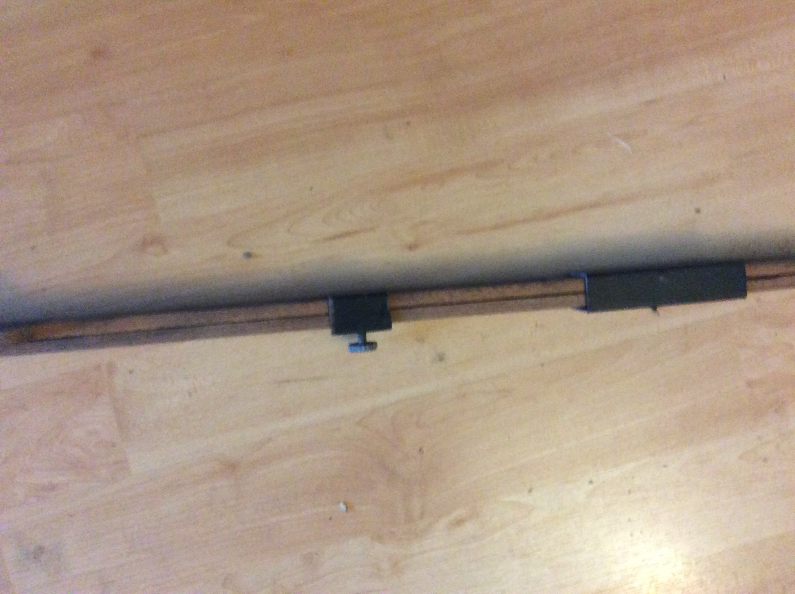

    Measuring Inside Dimensions with a Tape Measure-image.jpgThis is a close up of a clamp on the first picture.

    Yes, nearly every shop will contain a yard stick, a foot rule and a six inch scale (or the metric equivalents for these). Armed with those and a C-clamp (and a powerful scientific calculator capable of adding two digit numbers ) one can calculate the interior length of most anything.
