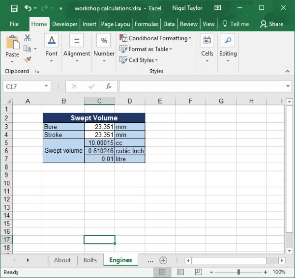

    I decided to share my spreadsheet calculators - I'm gradually getting these into one workbook and have listed an early version on my pages here:
    Workshop Calculator – glue-it.com
    If you want a specific calculator added then let me know and I'll see what I can do
