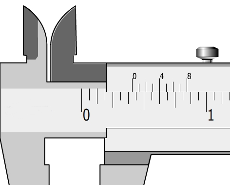

    Thanks for the comment mklotz! The vernier for the metric system is very simple to make, but the vernier for the English system is a little more laborious. When I have time, I will make the fractional inch markings too!

    As everyone knows, for the English fractional system, the following divisions can be used: a dash on the fixed scale = 1.5875 mm (1/16 ") and a dash on the vernier = 0.1984 mm (1/128") . In this case it is already more complicated to get exactly four decimal places on my machine. For now I prefer to work with the metric system ... As the markings are very close in the English system, the fixed scale and the vernier are not so readable. If you can make fine graduations you can improve the visualization a little ...

    Personally, I think a vernier on an inferial scale would be the height of idiocy. The average high school graduate can't add 1/2 and 5/8 mentally; how is he going to handle 7/16 + 9/128?
    If one insists on using inferial, get a metric vernier and a cheap calculator with which to convert the readings.
    Regards, Marv

    An example of designing an inferial vernier...
    Say each inch on the main scale is divided into eighths.
    You want each increment on the vernier to represent 1/32
    Since one division on the main scale represents 1/8 = 4/32, the vernier scale will need to have four divisions.
    Say you want the vernier scale to span 1 - 1/8 = 7/8 inch. Then each division on the vernier will need to be
    (7/8) / 4 = 7/32 inch
    and a typical measurement would go something like this...
    7 little spaces on the big scale (7/8) plus 3 on the vernier (3/32) = (28 + 3) /32 = 31/32.
    Can you imagine the average innumerate shop worker getting that right?
    Regards, Marv

    I perform the fractional inch readings using a formula, which would look something like this:
    (number of divisions before the zero of the vernier x 8) + division that coincided with the vernier. Then I assume a denominator equal to 128 and simplify the fraction found (when it is possible to simplify). Example (see photo):
    Answer:
    [(6 x 8) + 4] / 128 = 52/128 "= 13/32"
    This method is certainly known to everyone, but it is not instantaneous like reading in millimeters.
