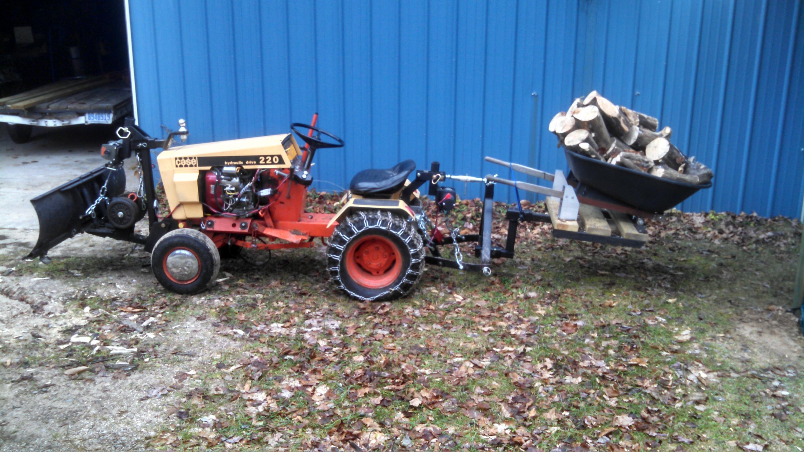

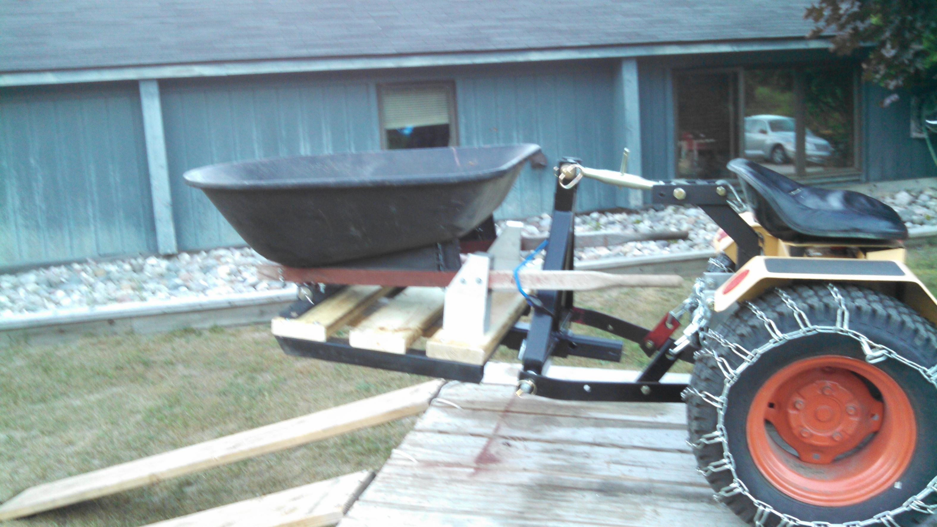

    tractor mounted Small loader
    I had a wheelbarrow with a flat tire that would never hold air. so I mounted the wheel barrow
    to the work platform on my garden tractor and use it for many different jobs. ( firewood shown )
    I mounted an axle shaft where the wheel barrow tire used to be, and I can still manually dump the wheel barrow.
    The wheel barrow attachment can be easily removed ( hairpin locking clips ) for a flat platform to carry chain saws & tools
    The work platform slides into a standard 2" trailer hitch sleeve so I can use on the rear 3 point hitch system,
    on the front of the tractor where I have another 2" trailer hitch receiver system, or above the tractor hood,
    ( three different mounting locations for the work platform ) so I can attach other equipment to the small
    tractor front/rear and still have my very handy work platform right in front of my steering wheel above the motor cover.
    manual front loader-case-wheelbarrow-01.jpg manual front loader-case-wheelbarrow-03.jpg
