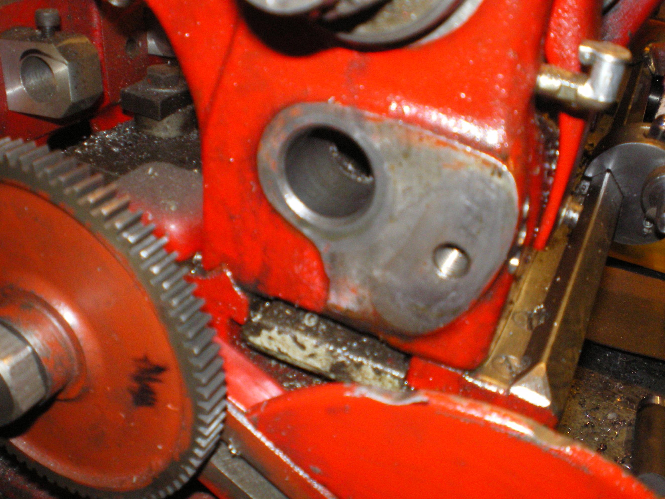

    For many years now I have had a set up for dividing the lathe headstock for drilling, milling etc, using a live tool post spindle.
    Unfortunately this has always involved a rather tedious and messy set up i.e. removing all the change gears, taking off the guards, reversing the banjo, etc.
    Myford Super 7 owners are lucky to have a 60 tooth bull wheel for use but not so for my SouthBend.
    The trouble has always been finding an alternative solid mounting point for my 60-1 dividing attachment mounted in the usual place at the end of the mandrel (I have ground the bore of which true for 4 inches as this is a drilled item and is rarely concentric). The alternative would be to locate the gear by the machined o/d of the mandrel end.
    While removing the tumbler reverse gear assembly one day for cleaning, the light bulb in my head came on as I was looking at the perfect place, a solid hole in the head stock begging to be used for this.

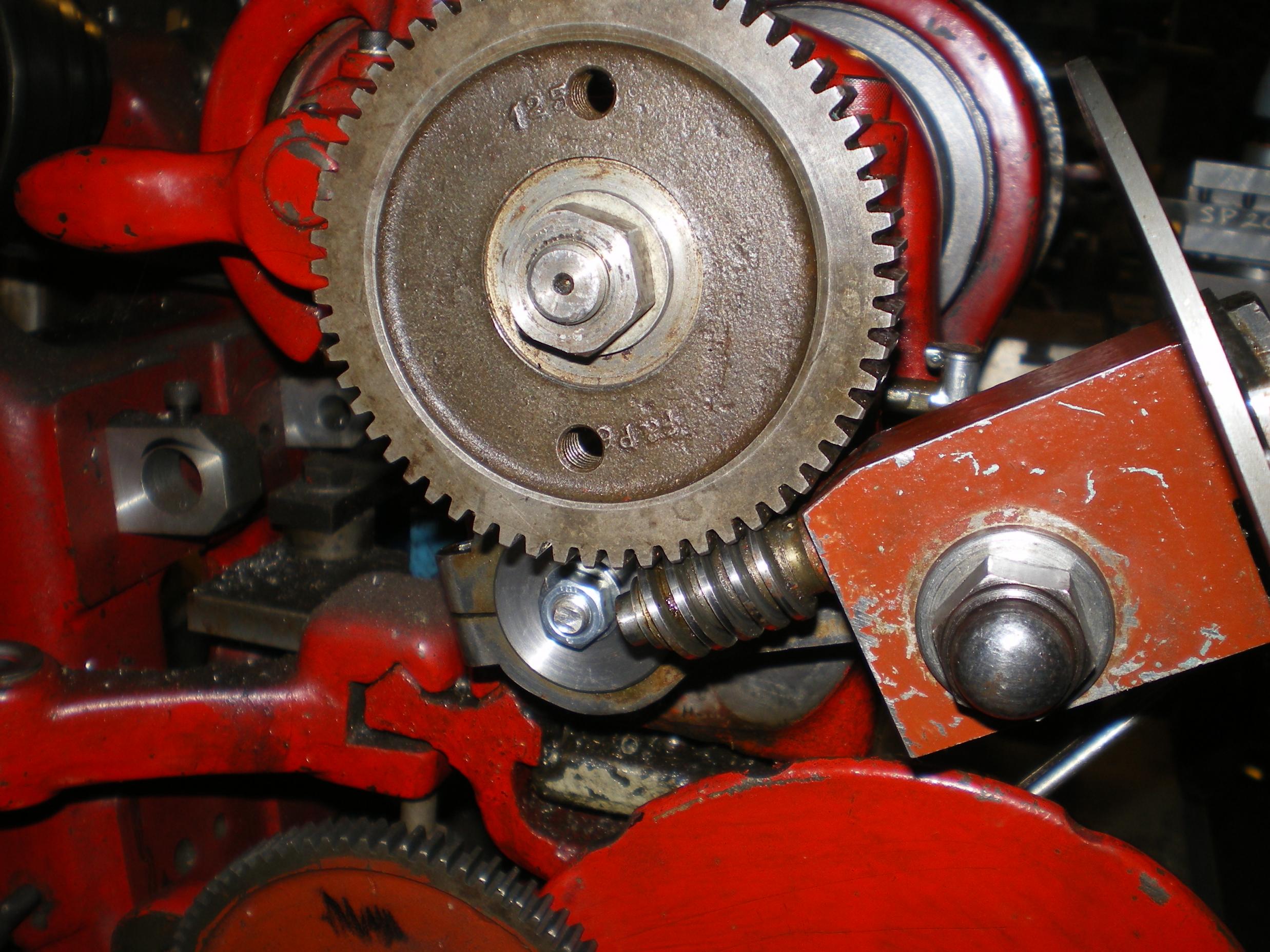

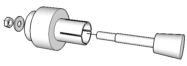

    A M/S expanding mandrel was soon made to fit said hole.

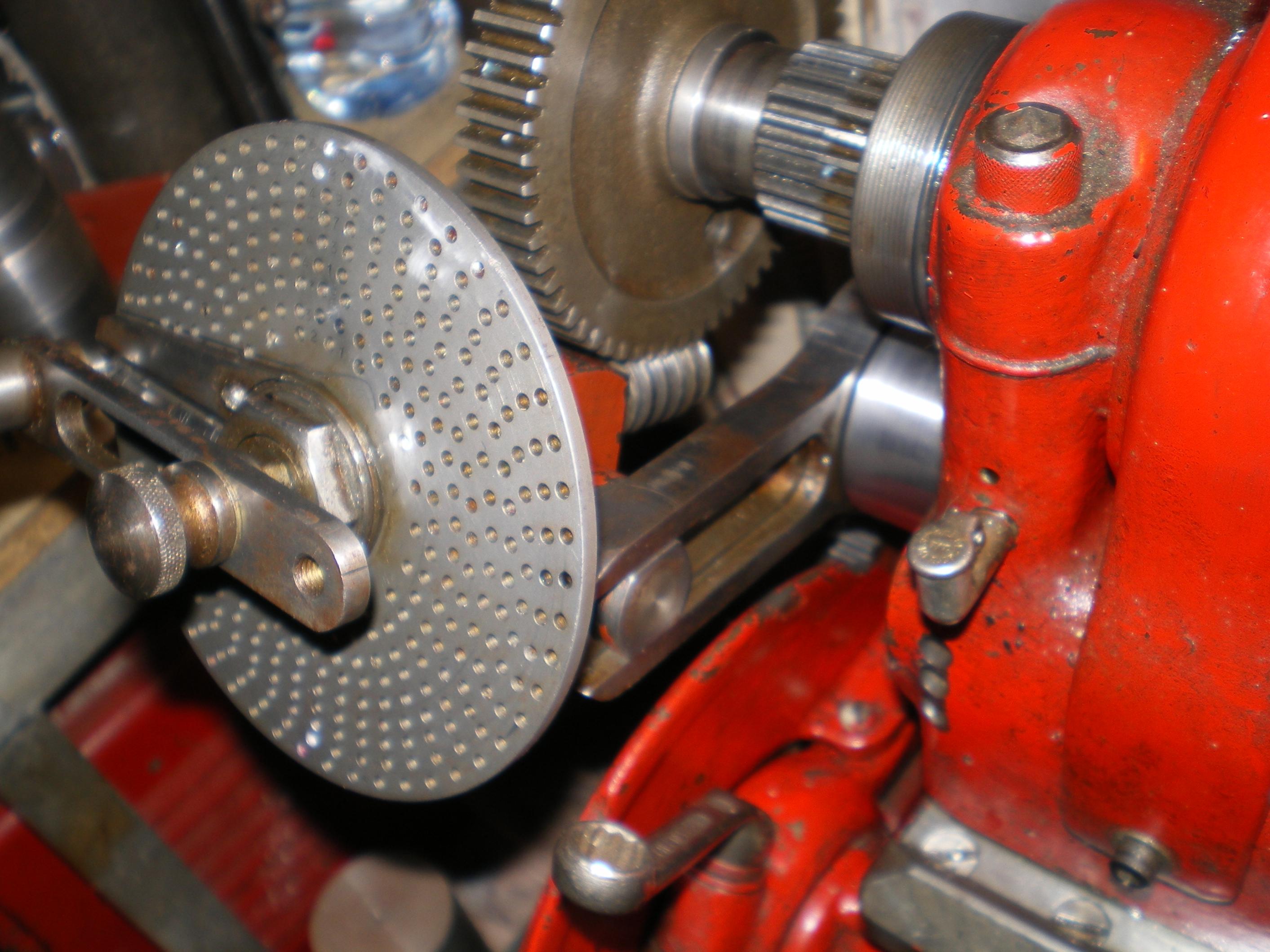

    Now after removing one bolt and slipping out the tumbler I can now leave all the change gears in place while I fit the dividing set up in a few minutes, I am now much more inclined to use it and as a bonus it is more rigid than the original set up. The whole assembly is a bit on the rugged side as it doubles with my table dividing head.

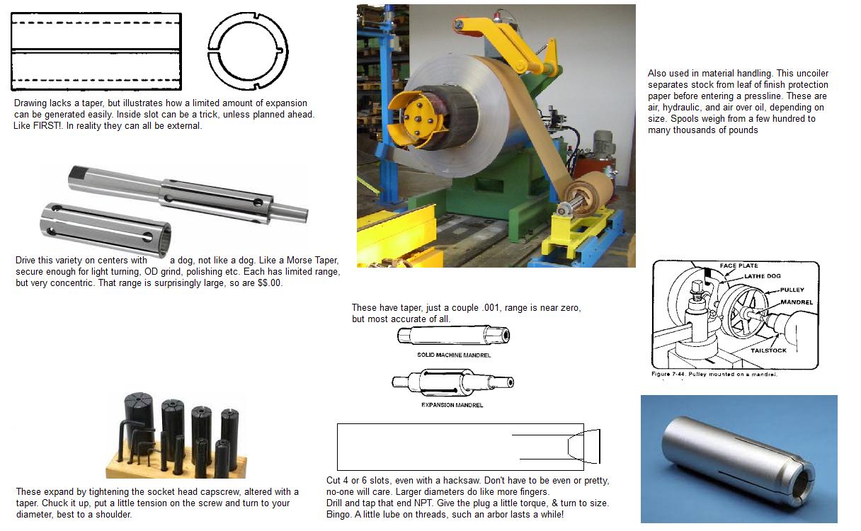

    7,048
    We don't always recall how useful expanding mandrels are, but common to part holding while machining. Olderdan and HMT.net prove again by example and justification of same. This is why we're here.
    It can be simple as a proper diameter 'forced' open with a pipe plug, quite effective. Most sophisticated are probably the long taper arbor with a split or alternately segmented sleeve, usually cylindrical, running on centers.
    Useful as all get-out, like you know who's shirt pocket!
    Click the pic, it'll open lickety-split, as in tick sans a tock.
