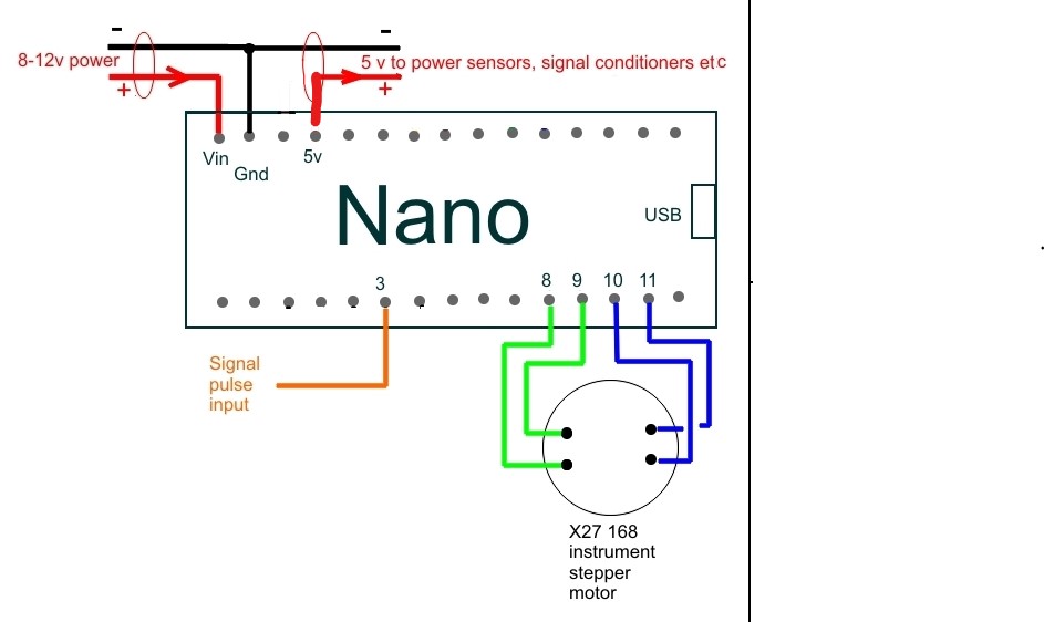

    Just a quick one - your Nano schematic shows +5V power coming out to sensors etc from pin 28 - which is actually a Reset and 5V out is from the adjacent pin 27 (as actually indicated on your diagram - but not 'connected').

    Quote Originally Posted by vasquito View Post
    You spotted my deliberate mistake. I'll fix it and repost. Thanks for the heads up.

    Here's a quick one:
