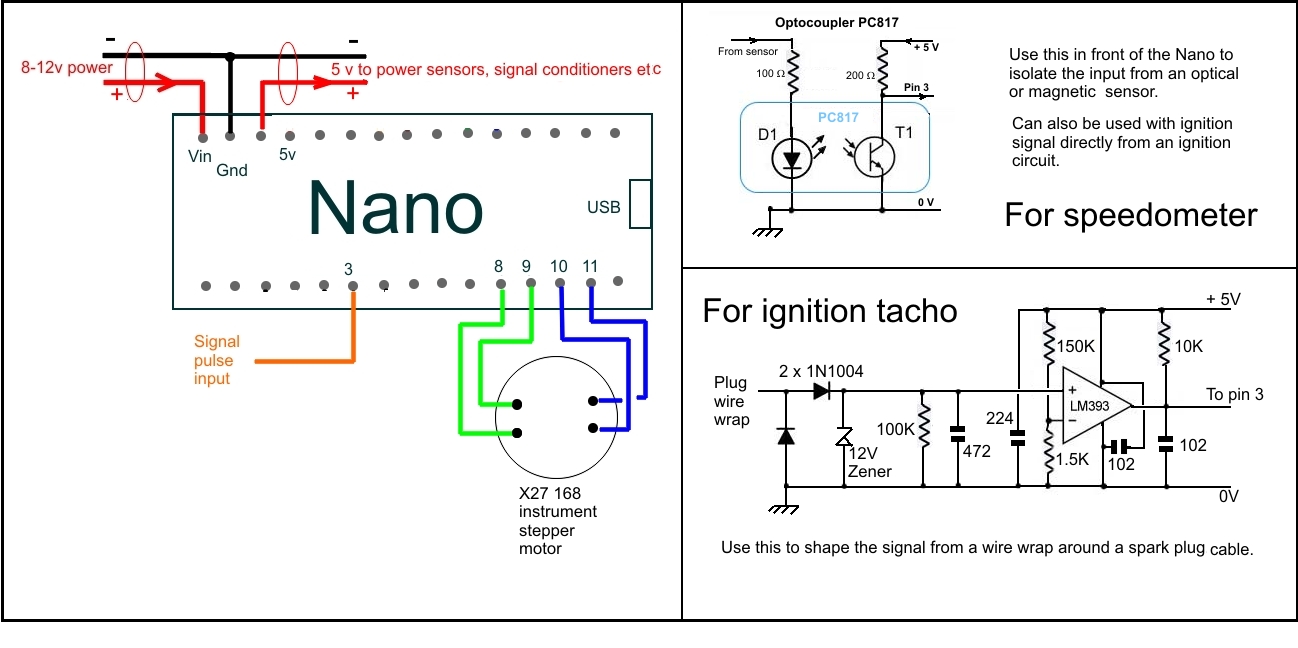

    I have finally got around to drawing the schematic and adding some comments to the Arduino code.
    This can be used as either a speedometer or ignition driven tachometer. The software is commented with what needs changing for the different applications.
    Lets start with the pretty pictures
    Making tachometers and speedometers-tachoschematic.jpg Click for full size
    A wheel sensor, probably Hall effect or other magnetic type could feed 0 to 5 V pulses directly to the Arduino Nano pin 3 but for isolation, level shifting and some noise reduction it is best to use an opto-isolator as shown top right. My original tacho application used a capacitive pickup from a spark plug lead and I used the signal conditioning circuit shown bottom right. I have not tried it yet but I think that might work well with the opto-isolator instead.
    Now for the code, if anyone wants to follow this but is not familiar with loading code into Arduinos then do not ask here. Much more comprehensive advice is available in tutorials and guides on the Arduino website and forums here arduino.cc

  7. The Following 5 Users Say Thank You to tonyfoale For This Useful Post:
    fizzloid (Jun 15, 2023), freddo4 (Jun 14, 2023), Little Rabbit (Jun 15, 2023), Sleykin (Jun 15, 2023), vasquito (Jun 15, 2023)
