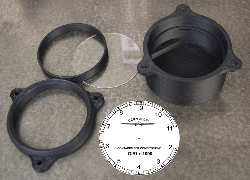

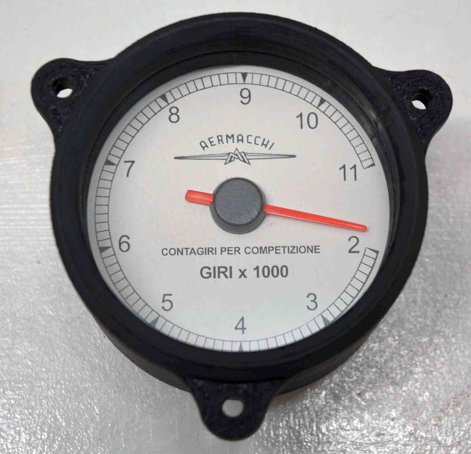

    If you have some basic electronic skills it is easy to make your own speedo and/or tacho. All modern cars and bikes with analog instruments use tiny stepper motors to drive the needle and these are much more robust than the meter movements found in many after market offerings.
    I have just made a tacho for my race bike and I wanted something that looked like 1960/70s Italian race tacho. I got my son to 3D print the housing but that could easily be turned out of aluminium bar. I designed the dial in photopaint and printed it onto sticky backed label paper which I stuck to a thin aluminium backing disc, then I sprayed it with clear lacquer.

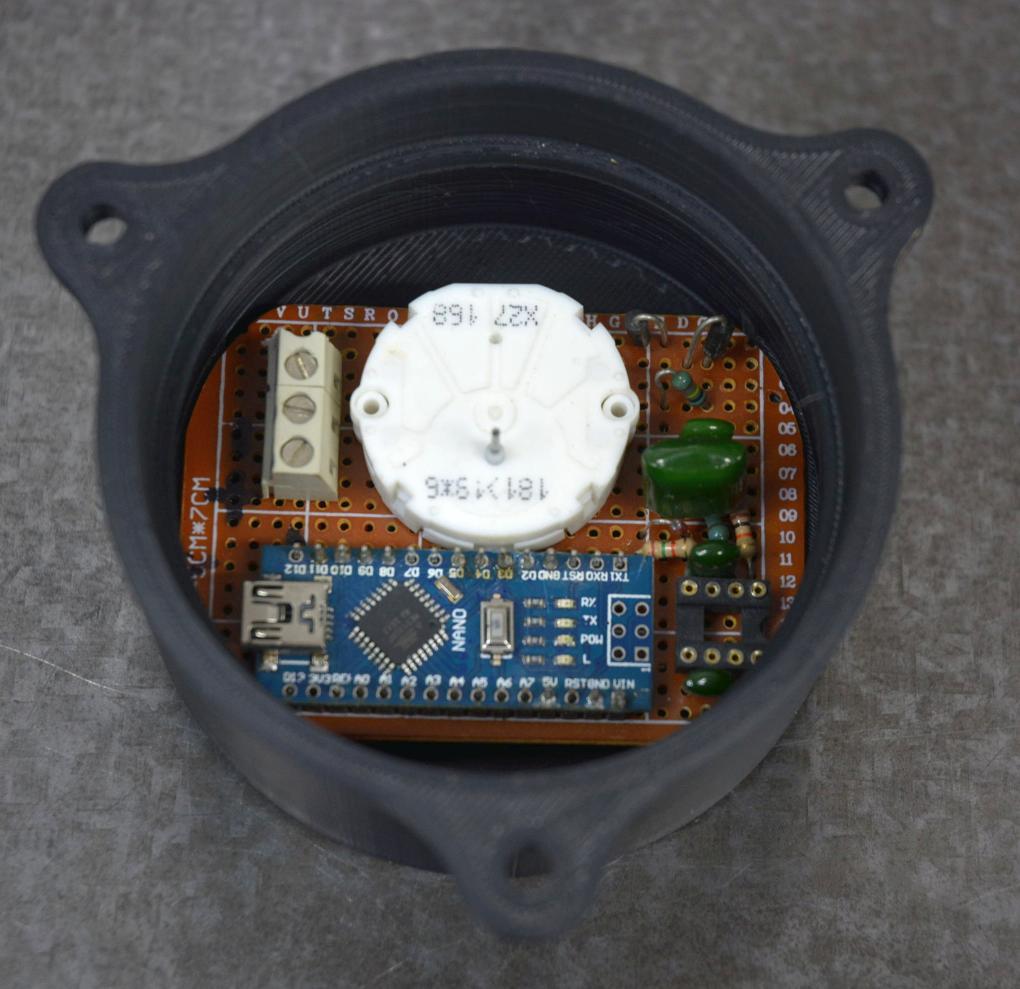

    To process the input pulses to drive the stepper motor I use an Arduino Nano, because of its small size. If you are interested I am quite happy to pass on full details and my software.
    Making tachometers and speedometers-dsc_5058.jpg Making tachometers and speedometers-tacho-bits.jpg

    I use a stepper motor "the white blob in the middle of the last photo" that is designed for the job and is used by several OEMs. They are readily available and they are surprisingly low cost. When I bought mine they came in a pack of three. I'll put together a PDF with full details and let you know. Fortunately it was only last week when I assembled the current one so it is reasonably fresh in my mind. I originally designed and built some about 10 years ago. The needles come with the motors and are an orange colour as in the first photo. This is from paint on the back side of the needle which can easily be scraped off and repainted with another colour so if you prefer black or white depending on your background colour it is easy to change. I just found a PDF file with data on the motor, with luck I have managed to attach it to this post. The motors have a movement range of 315 degrees but it is not necessary to use it all if it suits the look that you want with a smaller range on the dial. It is just a question of changing a number in my software.

    I have just checked the schematic for my tacho and a speedo will be much easier to wire up. Most of the components in the tacho are for conditioning the noisy signals from the ignition system and you will not need that circuitry. A magnetic or optical wheel sensor will feed directly into the Arduino which feeds directly into the stepper.
    Please post a link to the speedo that you bought so that I can check out that the sensor is suitable. Also how do you plan on triggering the sensor? You may be able to do that off the bolts that hold the disc, unless they are non-magnetic stainless. You will get a smoother display with multiple pulses per wheel revolution. It is only a setting in the software to accommodate any number of pulses and the maximum speed that you want to display.
