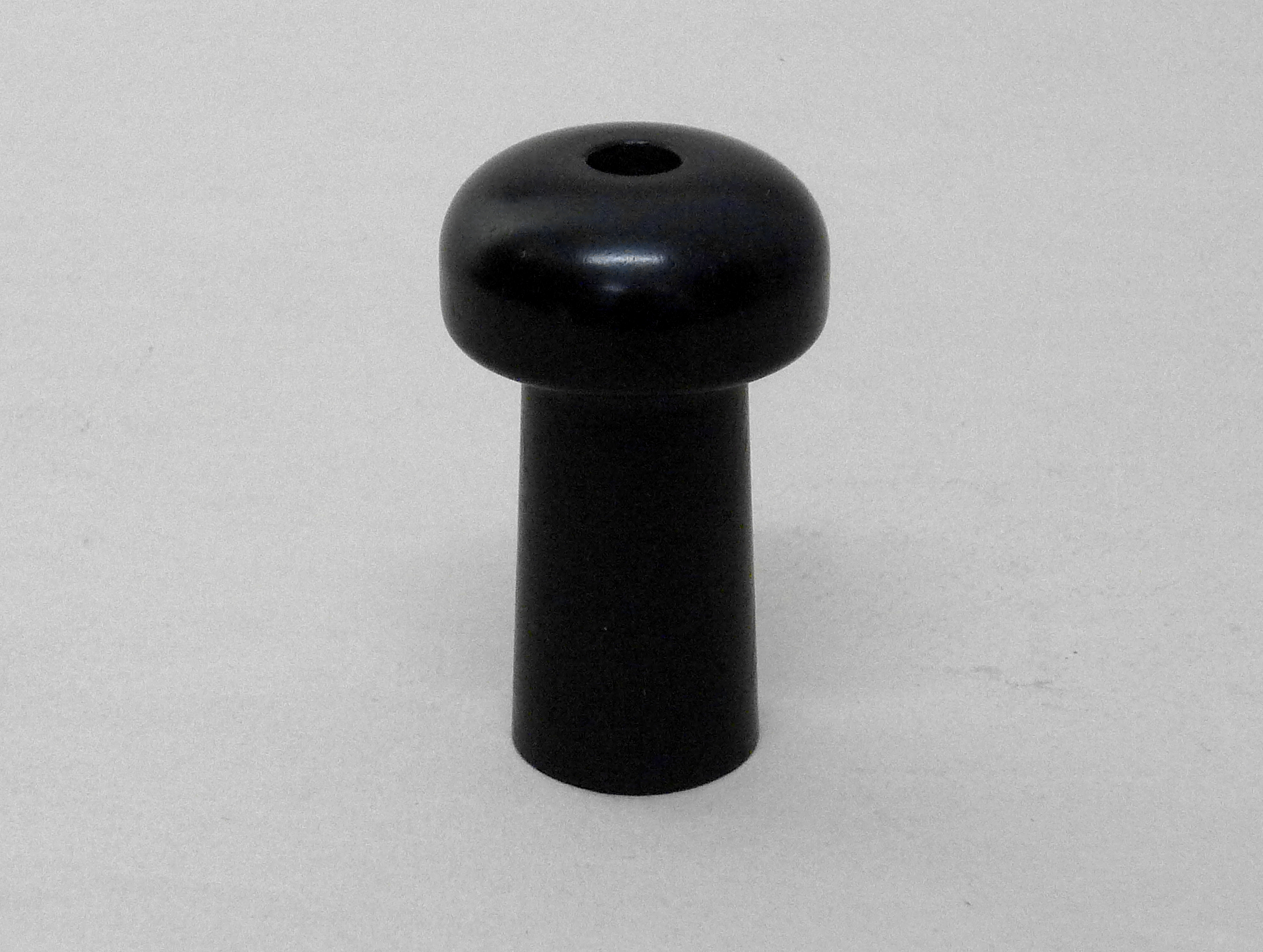

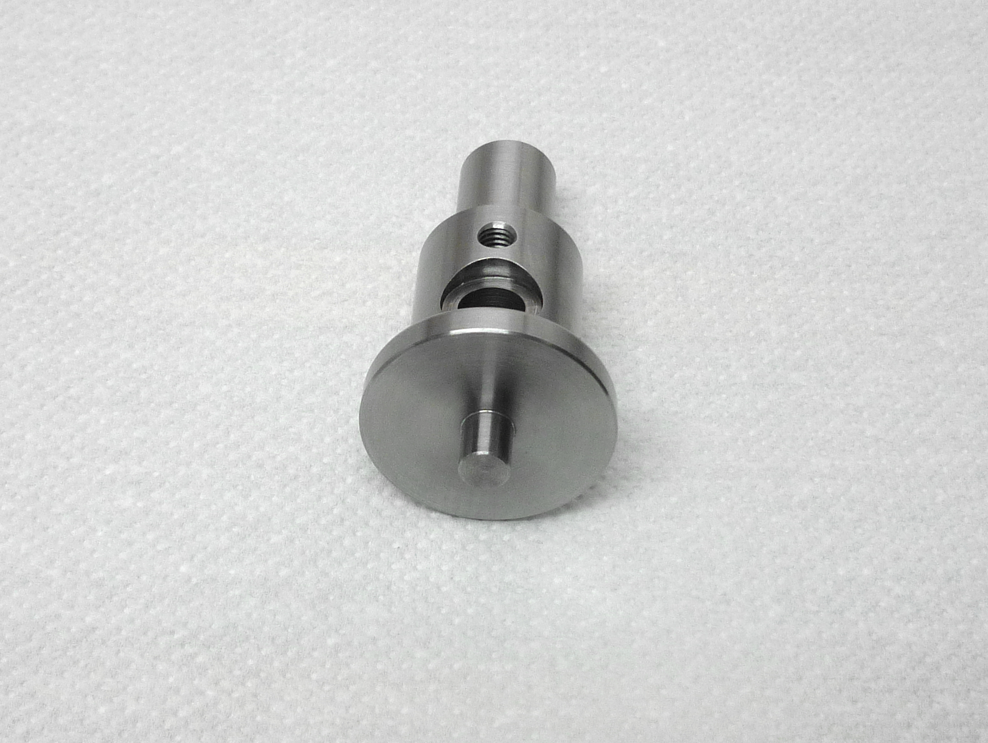

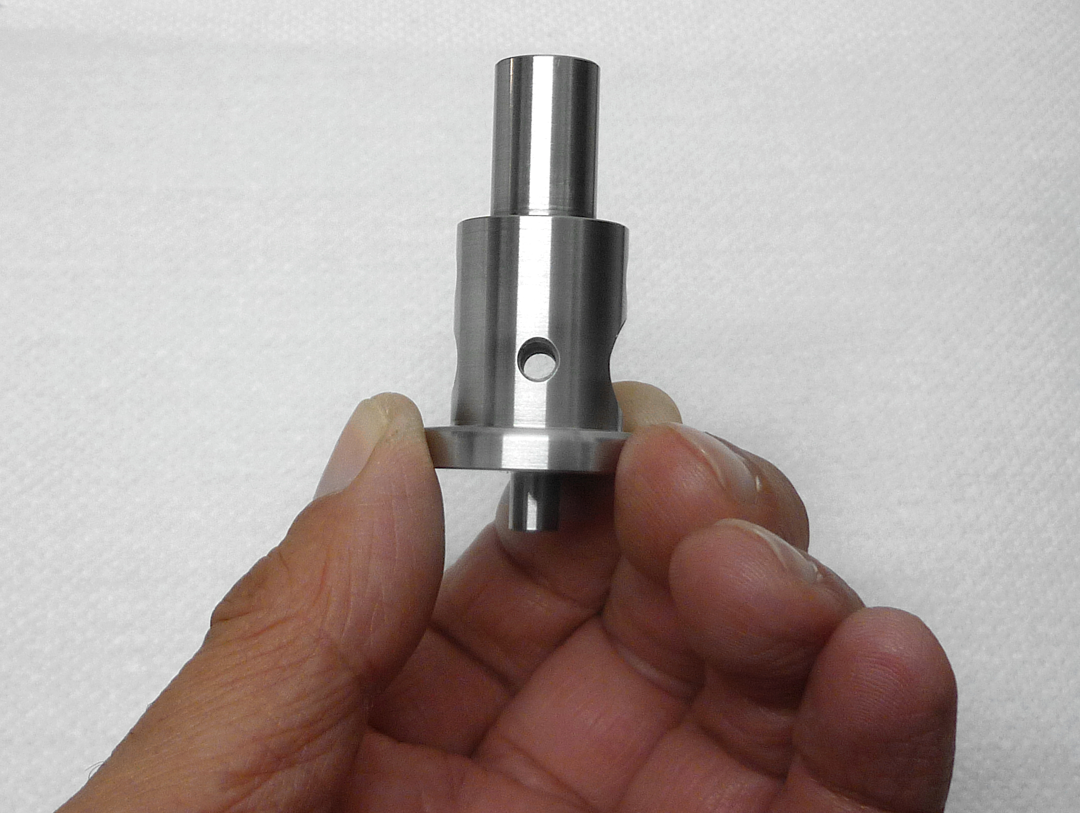

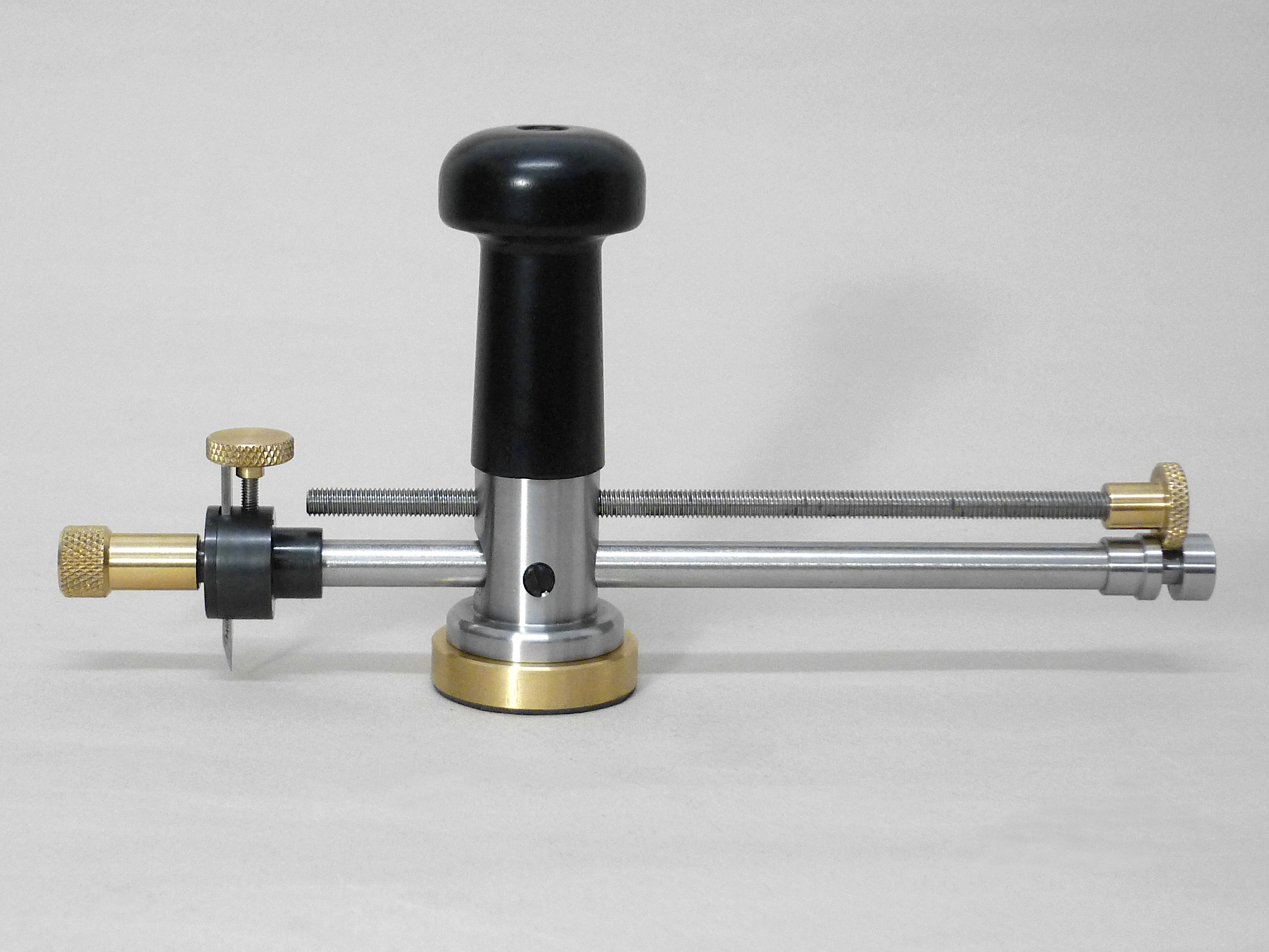

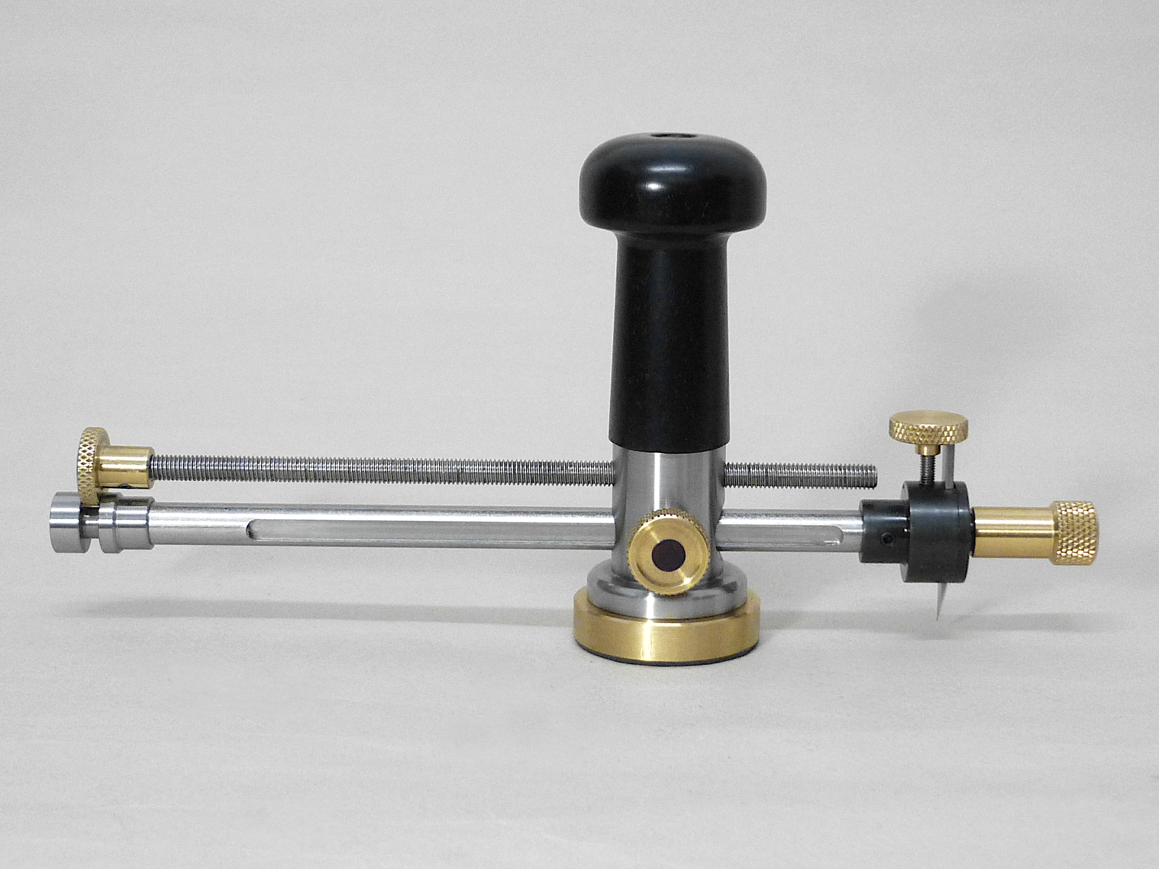

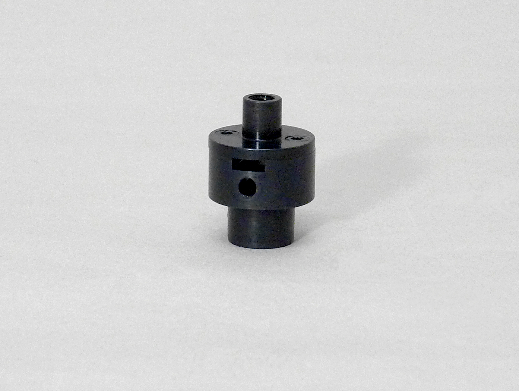

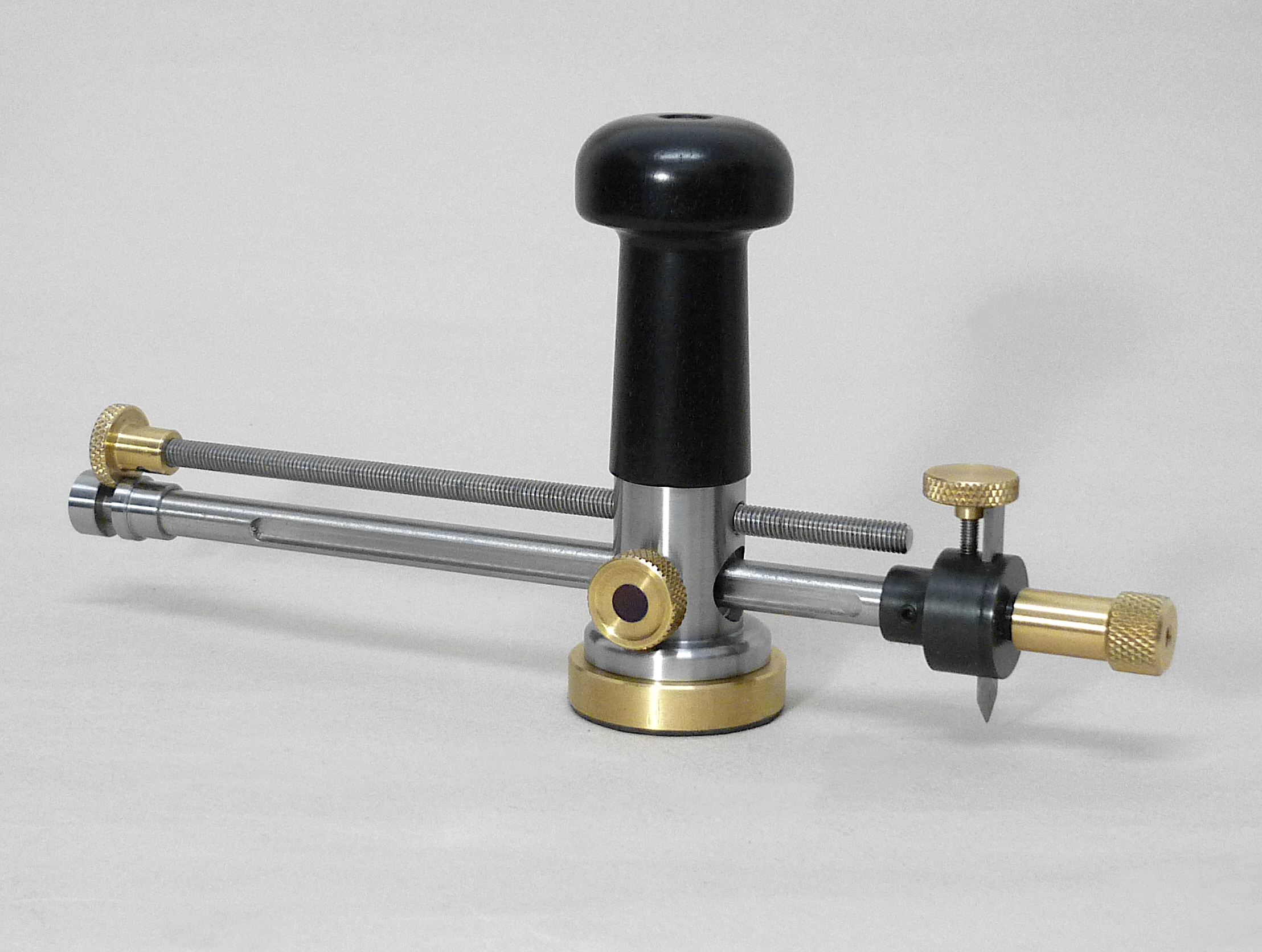

    Hello everyone,
    A few months ago I was commissioned by a luthier to make a circle cutter for the decorative rosette of acoustic guitars.
    I'm familiar with circle cutters - as I assume all of you are; but I didn't know that there was such a specific cutter.
    I found this project interesting and a bit challenging because till then I was making tools either for my own use or for friends. I accepted doing it but first I had to deal with one of the most important parts of this tool and that was the making of the blades, something I didn't know how to do. So I asked my friend, fellow YouTuber and also a member of this forum @anthonyget, Nick for his help on making the blades.
    Now I'll not tire you here more, there are pictures of all the parts I've needed to make as well as a video of making this tool. Having Nick's permission I've also posted his video of making and testing the blades.

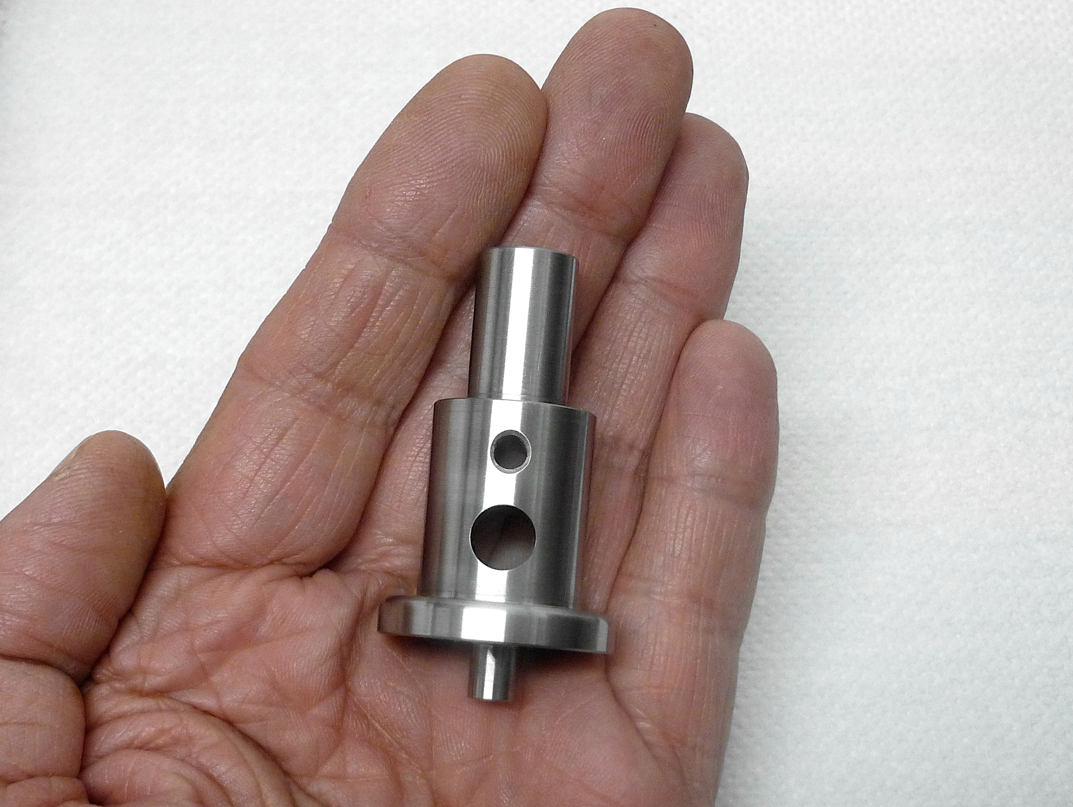

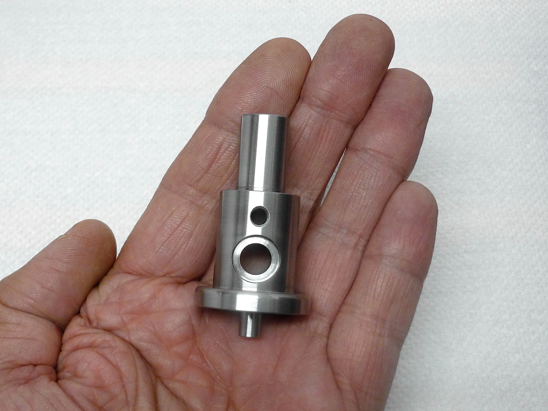

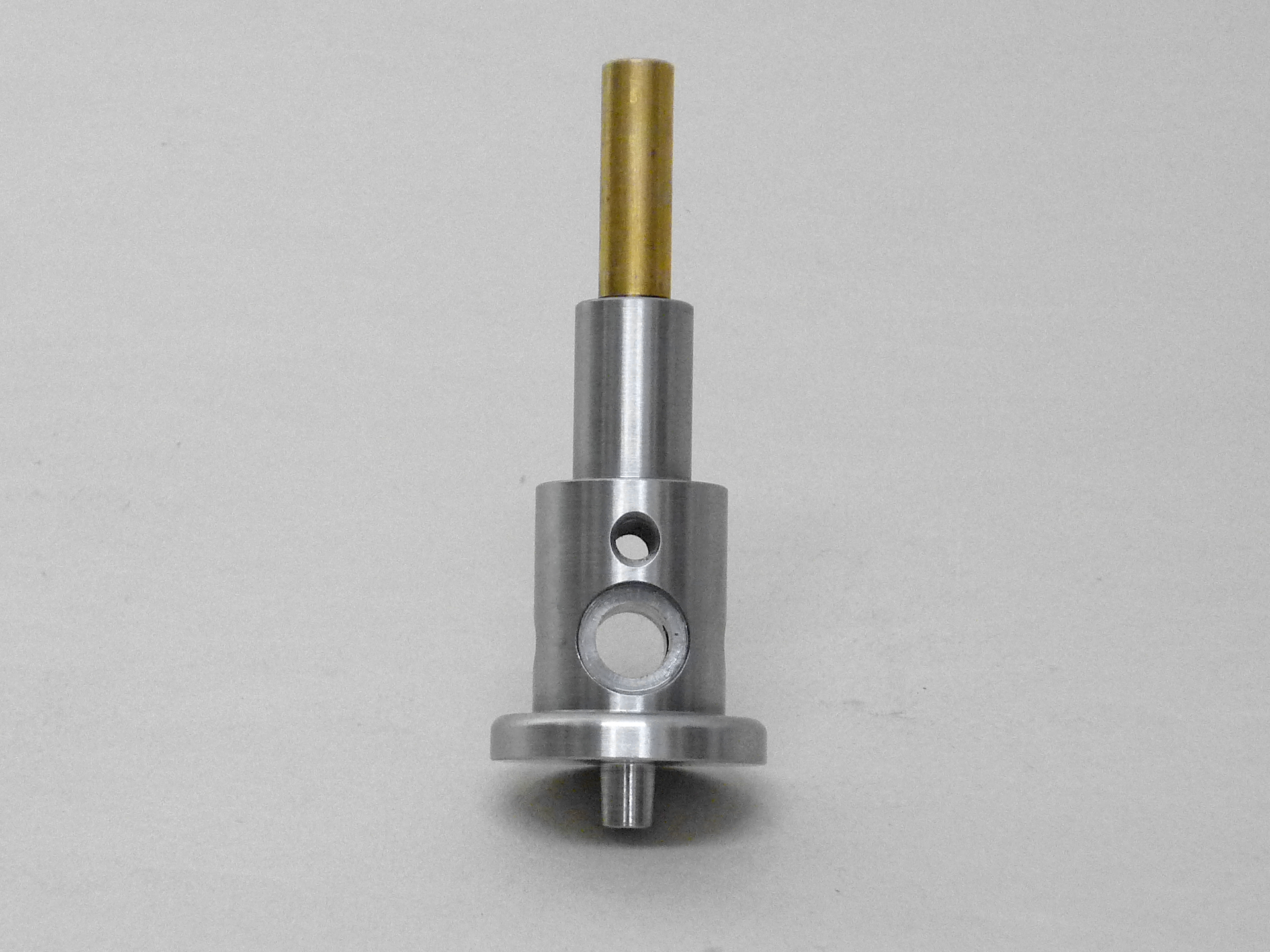

    The body and the handle of the tool
    Making a Rosette Circle Cutter-p1170197.jpg Making a Rosette Circle Cutter-p1170198.jpg Making a Rosette Circle Cutter-p1170199.jpg
    Making a Rosette Circle Cutter-p1170200.jpg Making a Rosette Circle Cutter-p1170201.jpg Making a Rosette Circle Cutter-p1170202.jpg

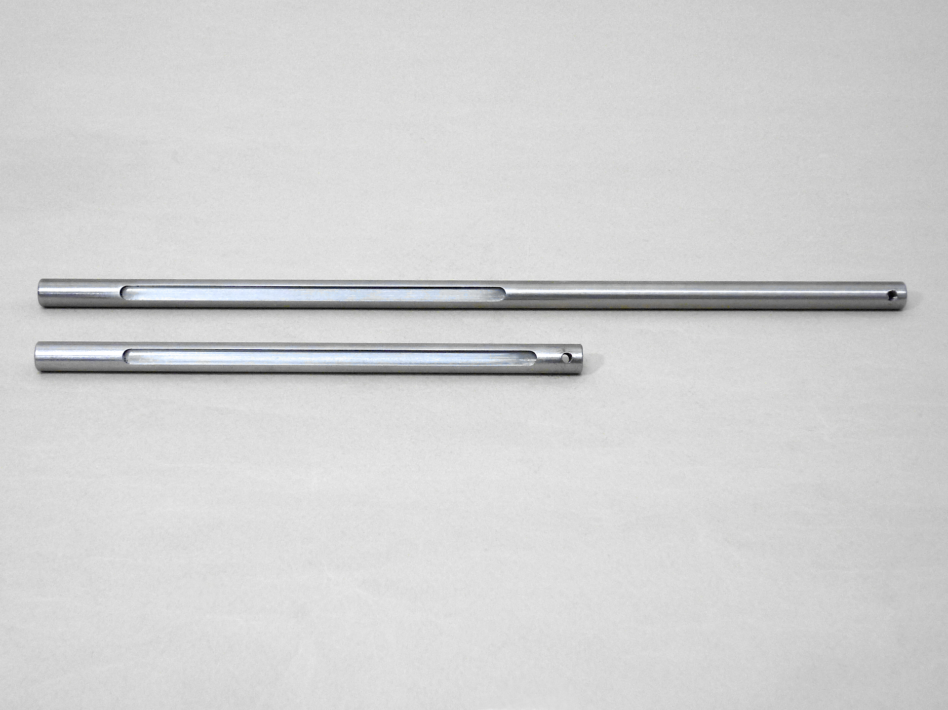

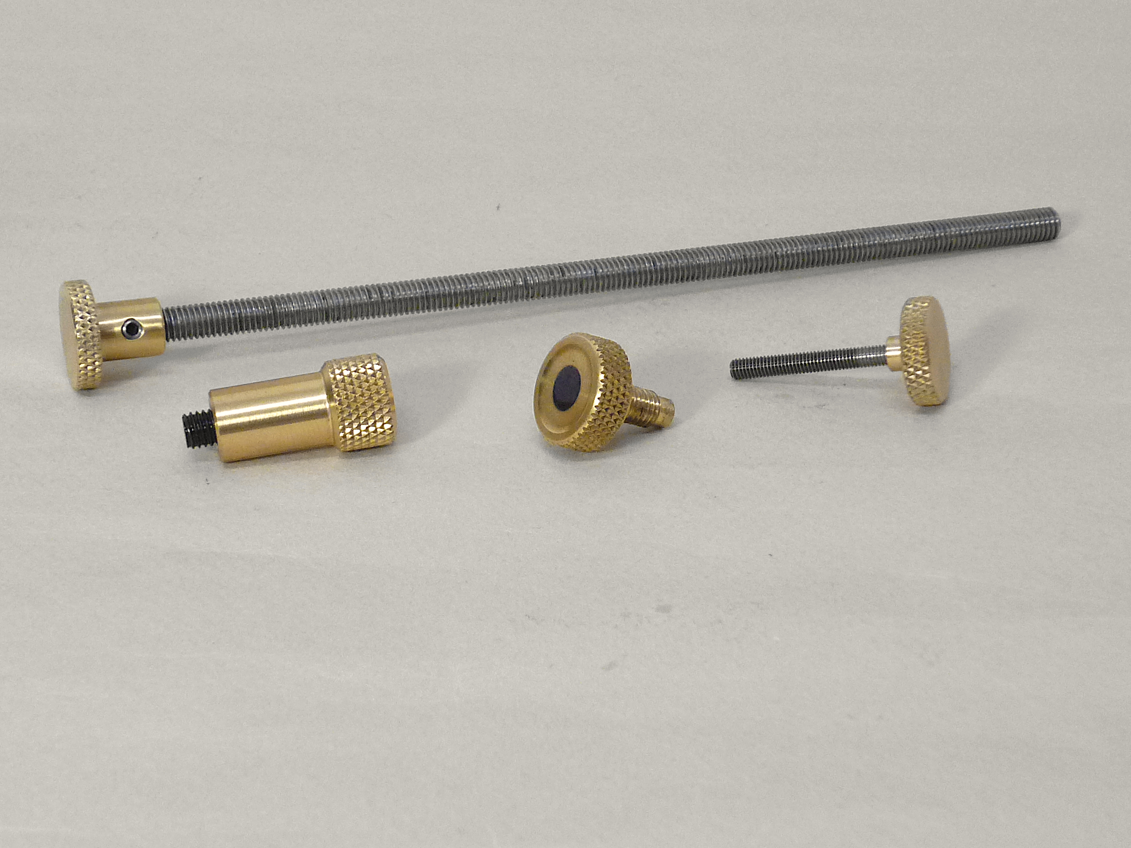

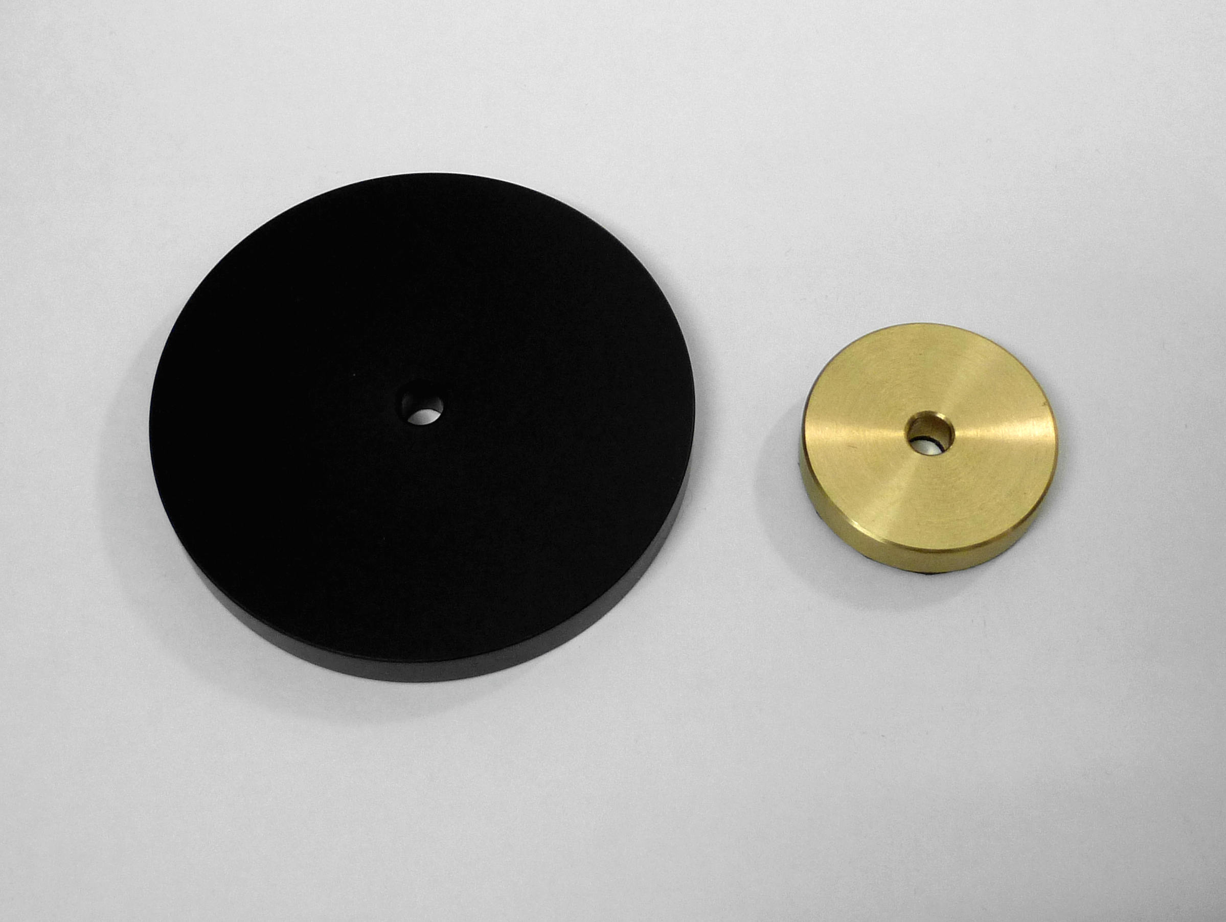

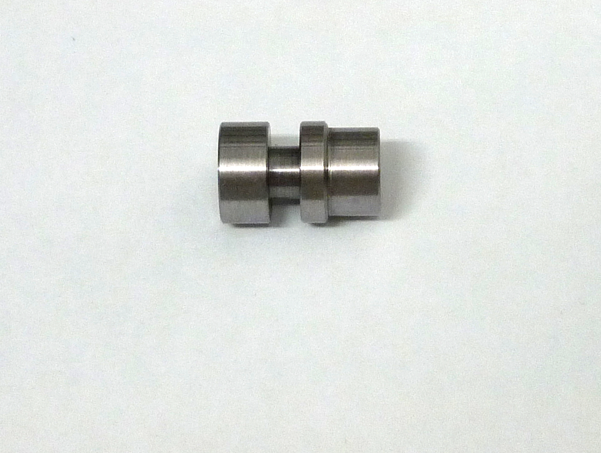

    Thumb screws, blade holder, arms, fine feed guide and plastic-brass pads
    Making a Rosette Circle Cutter-p1170205.jpg Making a Rosette Circle Cutter-p1170206.jpg Making a Rosette Circle Cutter-p1170207.jpg
    Making a Rosette Circle Cutter-p1170208.jpg Making a Rosette Circle Cutter-p1170209.jpg
    Making a Rosette Circle Cutter-p1170210.jpg Making a Rosette Circle Cutter-p1170211.jpg Making a Rosette Circle Cutter-p1170212.jpg
    Regards from Greece
    Dimitris P.

    Congratulations Dimitris Polychronis - your Rosette Circle Cutter is the Homemade Tool of the Week!
    This is a beautiful and well thought-out tool, especially with the custom blades.
