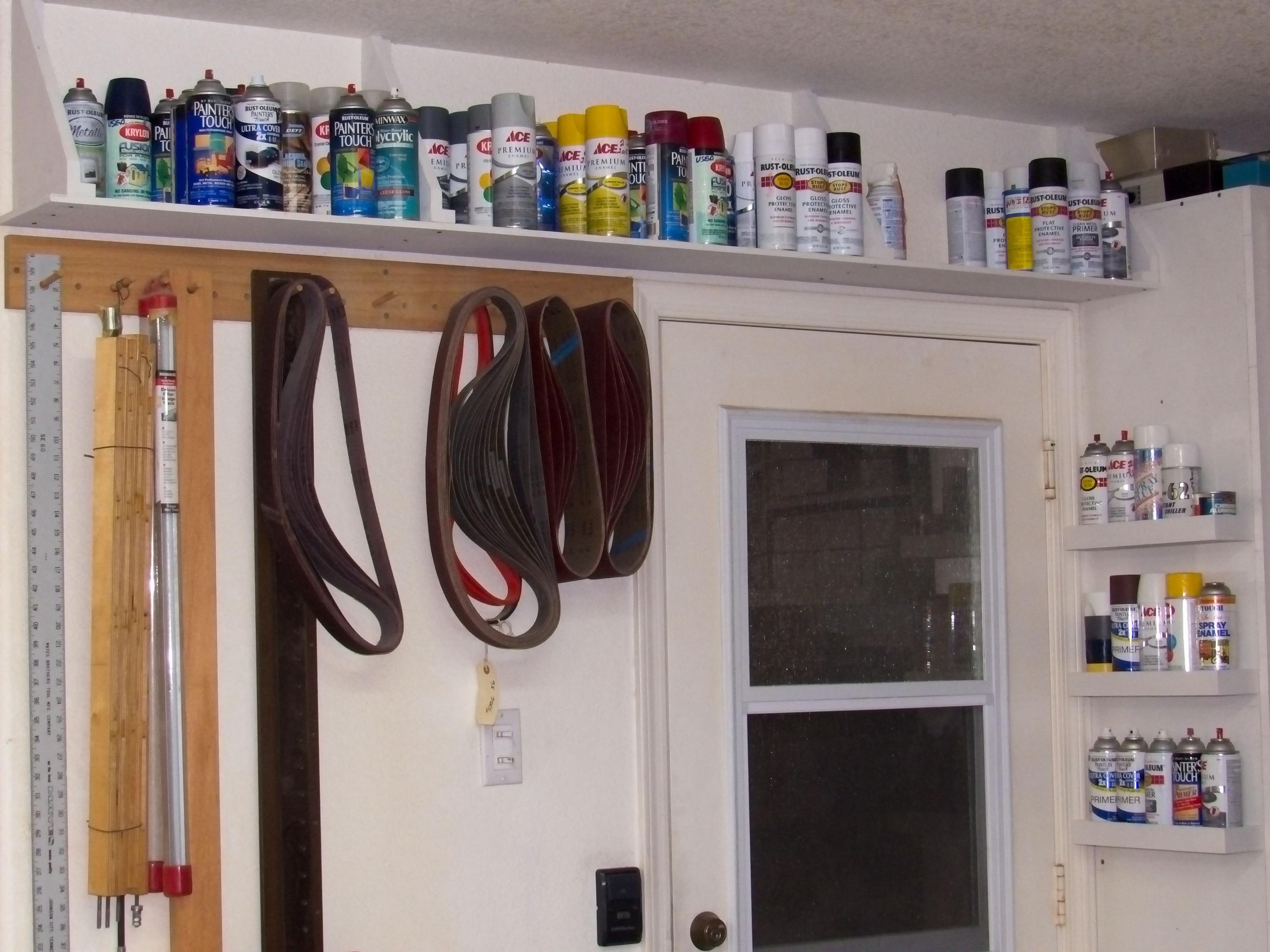

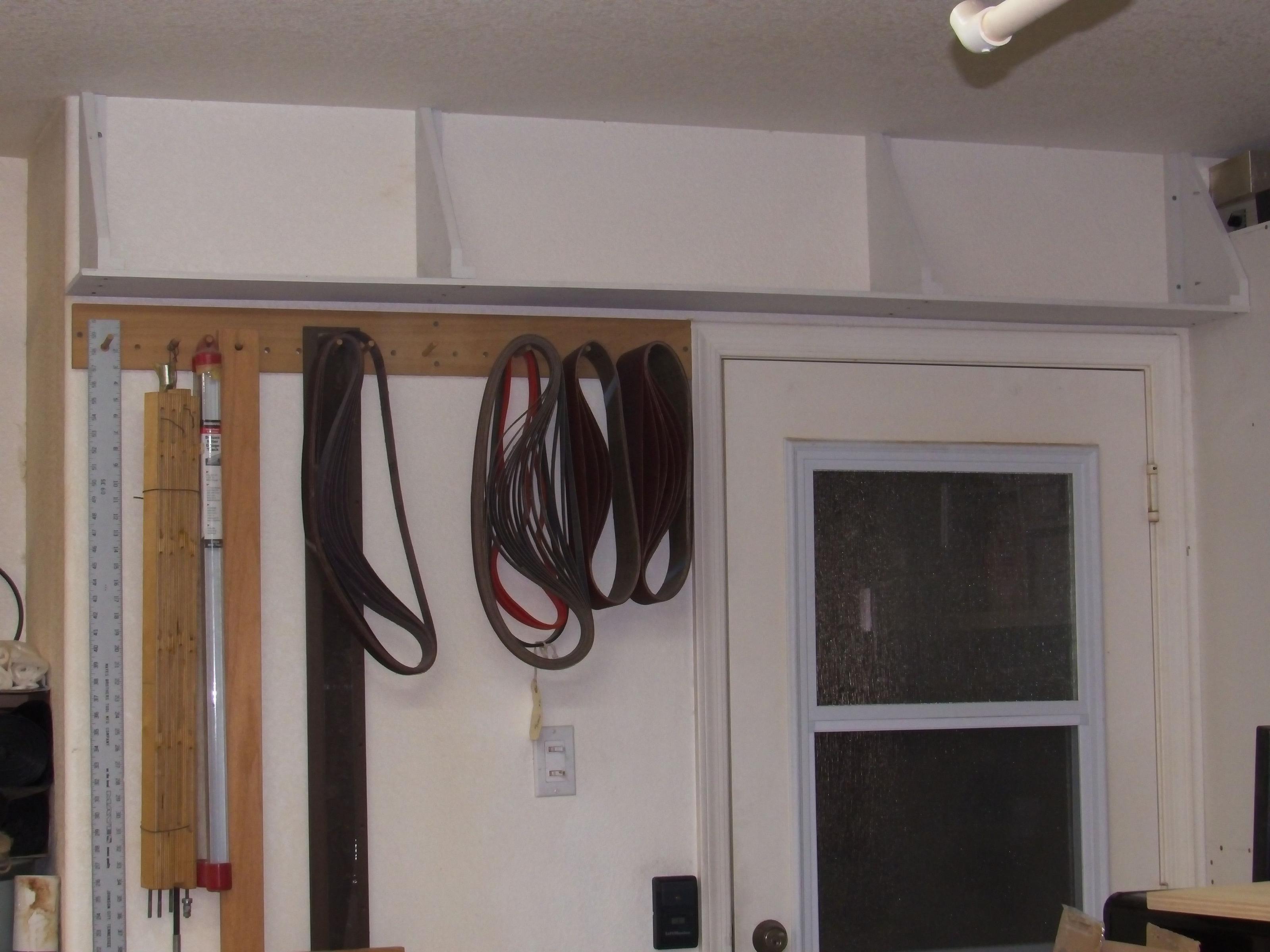

    I ran out of space in the shop about 10 years ago but I keep adding stuff.
    Had all these paint cans taking up a large part of two shelves in a very deep cabinet.
    It was hard to find the can I needed. So........
    I used up some scrap lumber. Made a piece of 1/2" plywood out several pieces of 1/4" plywood.
    Made up 4 inverted shelf brackets using some scrap 3/4" plywood.
    Threw on a couple coats of paint and walla. Note the shelf is suspended from the bottom of the brackets.
    This allows the shelf to be below the ceiling and still have a lot of useful head space.
    I consider it light duty but it will hold all the paint cans I can put up there.
    Now I can see my paint. Got rid of some scrap wood. Reclaimed some cabinet space.
    Best of all I reclaimed some space that was not being used on the wall.
    Still get one car in the two car garage. Several of my tools and tool boxes are on wheels.
    Just sayin.....
    Oops, now I see some more space below the paint shelf that could be reconfigured.
    Cheers, JR

    An upside-down shelf is an unusually accurate example of an Egg of Columbus:
    An egg of Columbus or Columbus' egg refers to a brilliant idea or discovery that seems simple or easy after the fact. The expression refers to an apocryphal story in which Christopher Columbus, having been told that discovering the Americas was inevitable and no great accomplishment, challenges his critics to make an egg stand on its tip. After his challengers give up, Columbus does it himself by tapping the egg on the table to flatten its tip.

    Indeed, Thanks Jon, I think Columbus was one of the few, early, think outside the box guys.
    Cheers, RJ

    These are really good. I had one 4m long by 300 mm by 19mm Meranti above our full wall length mirror in our main bath room.It was supported by nice looking upside down steel brackets. The better half, last year, said "that's gotta go" "Why?" "it holds too much stuff"-it carried boxes for nebuliser, first aid , insect sprays,spare toilet rolls, household gear, etc etc etc so I ripped it out: after 20 odd years of faithful service and now all that gear clutters my shed space & I have a chip in the long mirror to try to hide.The bathroom does look bigger with it gone but when it is 13 ft by 12 ft does it really need to look roomier? LOL.
    The ones in my shed work well too: i teered them down from a standard door width (820 mm) to (600 mm) or 2 ft to easy to reach 6 inch ones. Now I have a large NZ board to use for some future project:- had to store it on top of an antique extension ladder high above my head.The things we do!

    Good idea. I could use it too, but im just so short.

    Lost some good storage space there ranald. The way I see it storage space is like tools. Always better to have storage space you don't need than to need storage space you don't have.
