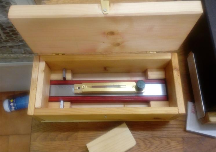

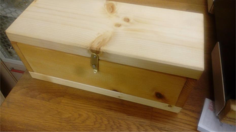

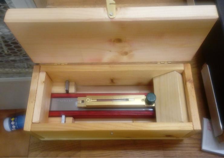

    I've made a box for the level. Here are the pictures.
    Making a machinist level with a perfume vial-box1.jpgMaking a machinist level with a perfume vial-box2.jpgMaking a machinist level with a perfume vial-box3.jpg
