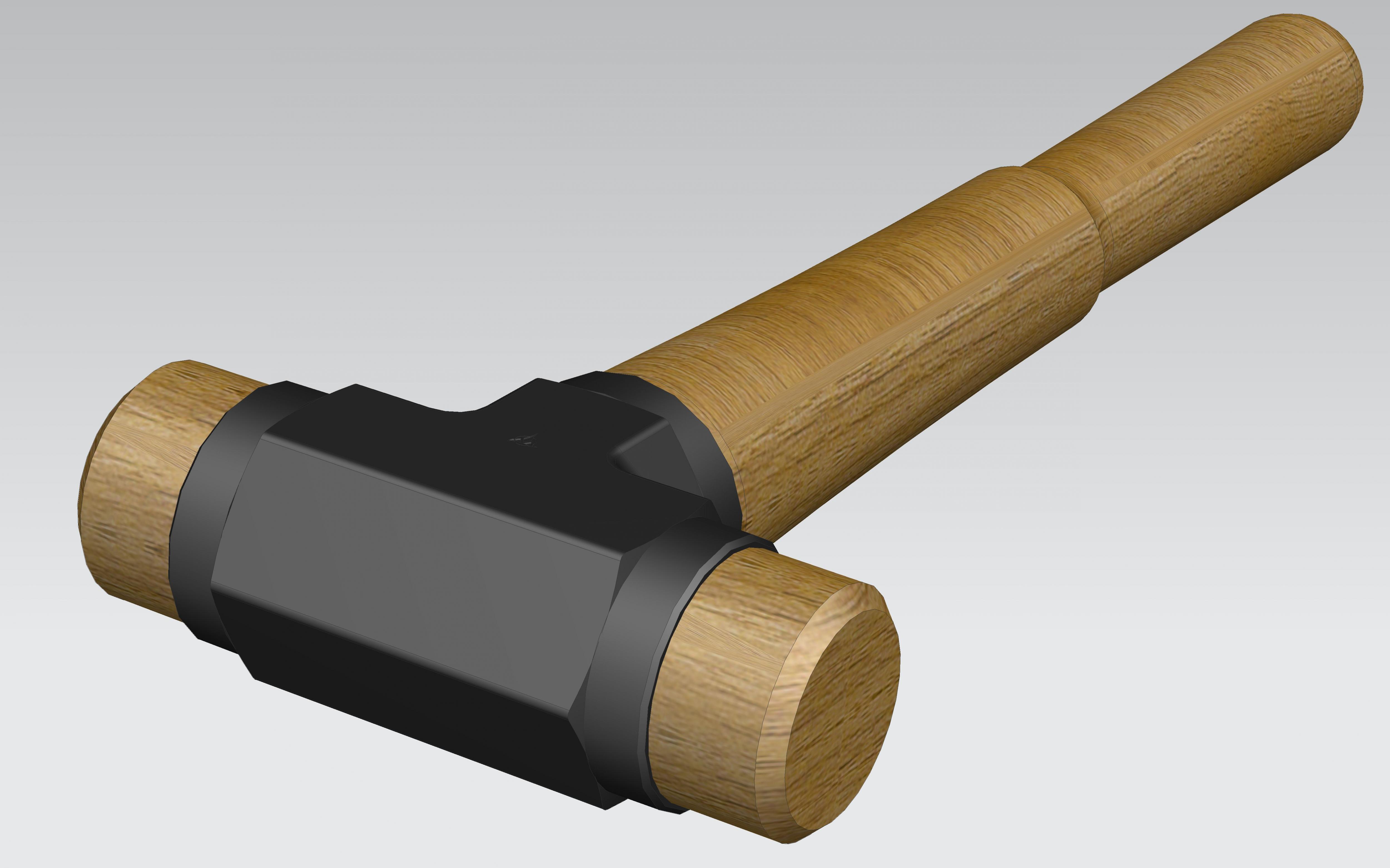

    Today, I created a 3D model and made a sketch with dimensions, which I am eager to share with you.
    Download 3D CAD model
    PDF with dimensions (direct link)

    That's appreciable effort, 3D model and drawing, though video related all needed information.
    Your design, especially the Tee fitting, and hard enough wood, works for any size dead blow wanted, from a tinkers lightweight to a full-on maul shipwrights use .
