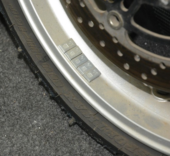

    With cast wheels such as I used on the bandsaw, it is usual to use adhesive backed weight strips to stick on to the inside edge of the rim. Up until lead became poisonous these strips were lead now they are a substitute material with lower density and so you need more for the same effect.
    I checked the balance of the bandsaw wheels and they were both close enough not to be a concern at the metal cutting speeds that I use. I would have balanced them if I was running at wood cutting speed.

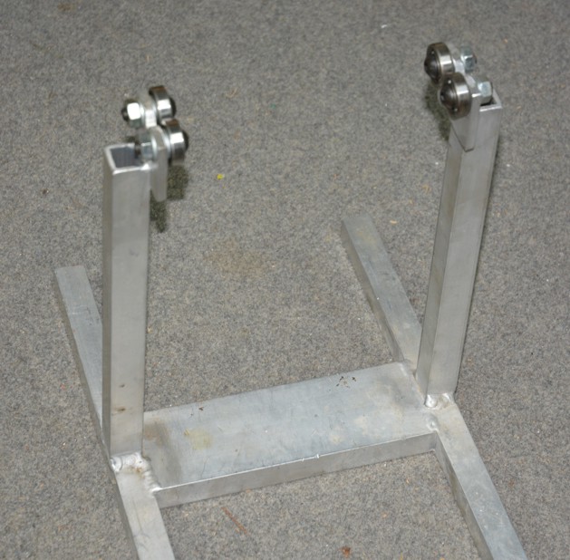

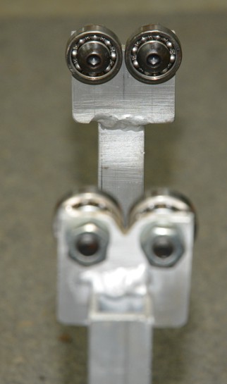

    Here are some pix of my wheel balancer. The wheel axle sits on the two bearings each side, The bearings need to spin very freely so that means that they must have no seals, be very clean and lubricated with nothing or very thin oil if any. Dry ceramic bearings are the best for low friction.
    Some balancers have larger diameter "wheels" on the bearings, usually knife edged. These increase sensitivity, but you ought to use hardened axles if you use knife edges. Plain bearings as illustrated here are amply sensitive for wheel balancing.
    This photo shows the weights on the wheel rim.

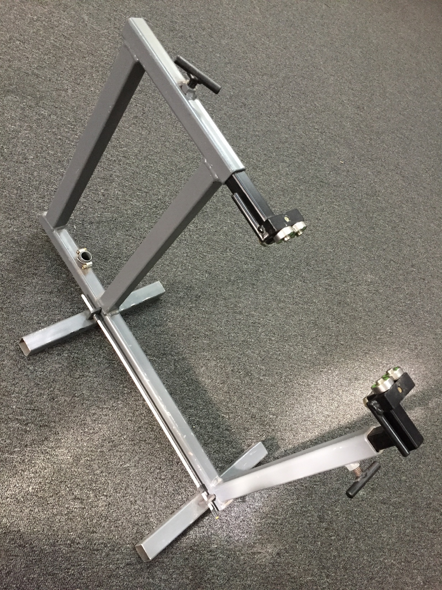

    I picked this up at the Long Beach Swap Meet a decade or two ago. The guy was selling them for $63.00 with good bearings ($3.00 cheaper with standard bearings)
    It came with a rod to true wheels & magnets to hold it. Also hose clamps to hold the rim for truing.
    And it is adjustable for different diameter axle ends.

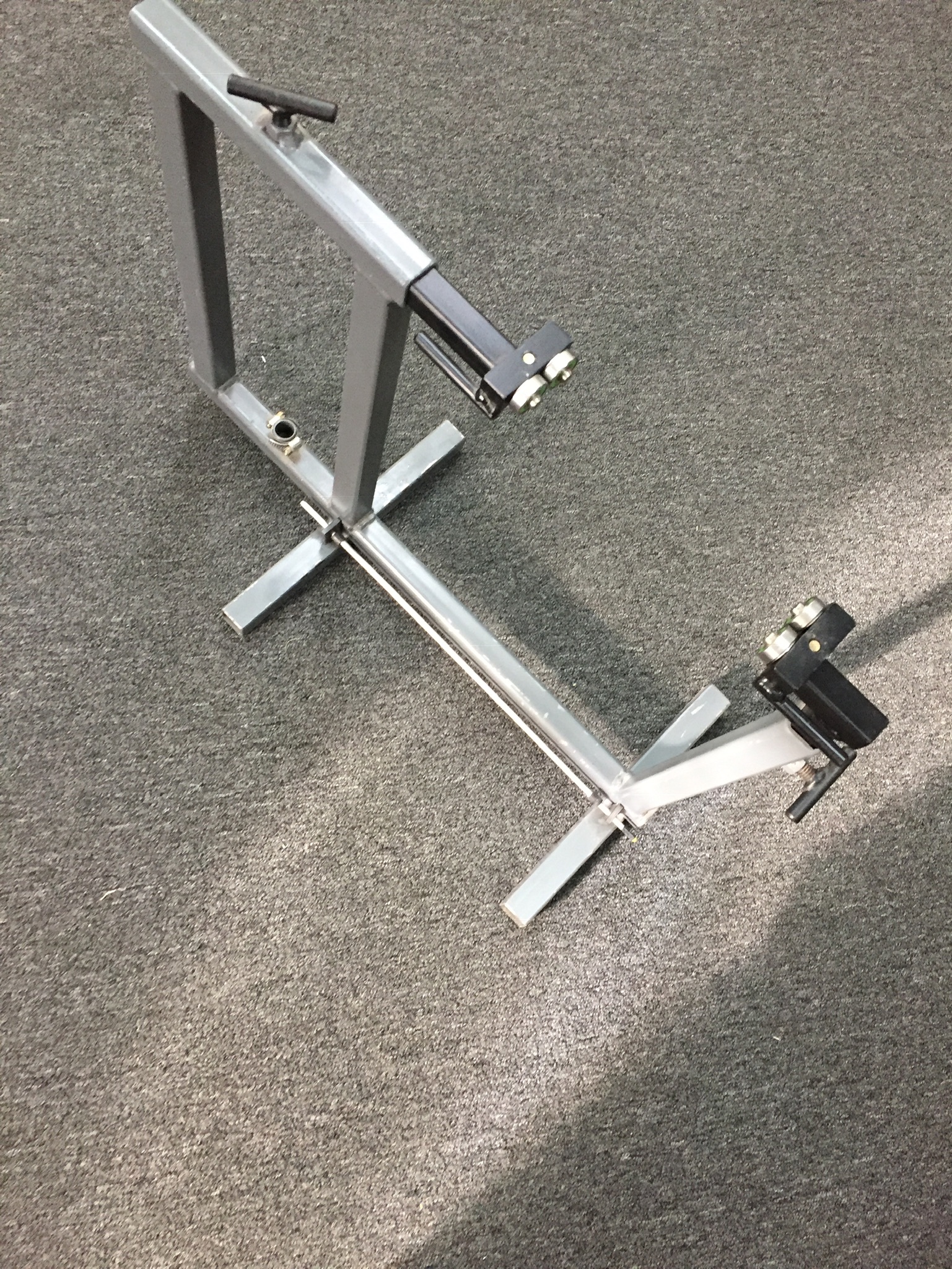

    Second picture

    Quote Originally Posted by Kwick Aronson View Post
    The adjustable width between bearings is nice. I didn't do that, I made it wide enough to handle the widest tyres that I'd use. I am only interested in 3 axle sizes (15, 17 and 20mm) and I have dedicated axles of those sizes, so a fixed width is OK for me. I wanted to keep it as small as I could because I often take it to races.
