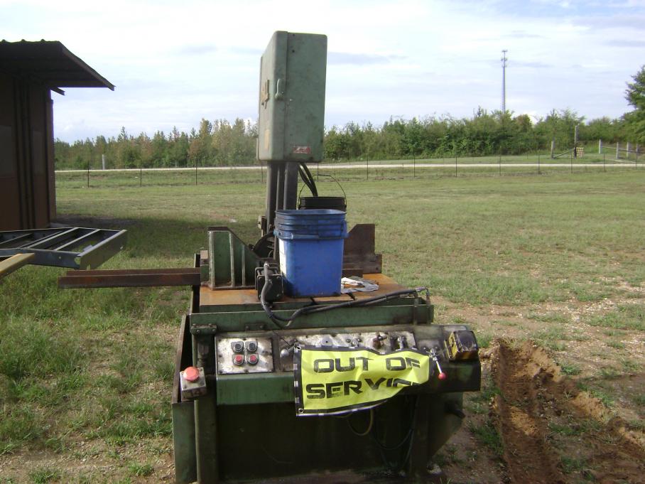

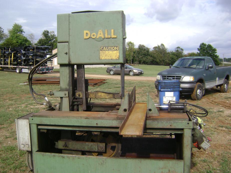

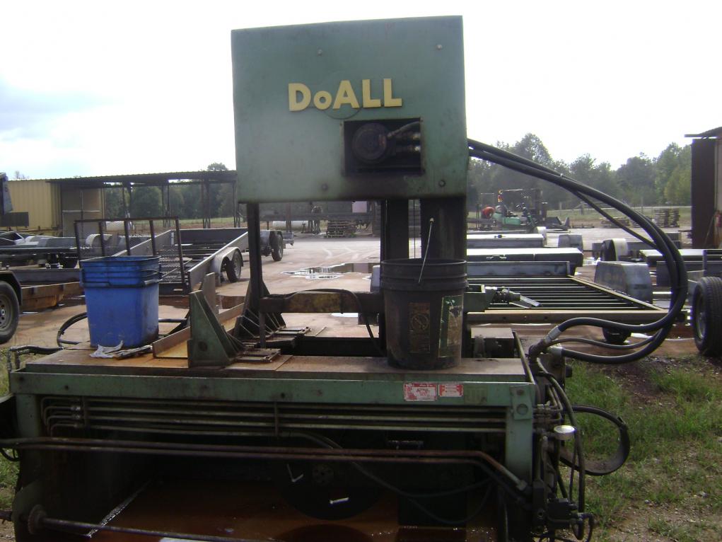

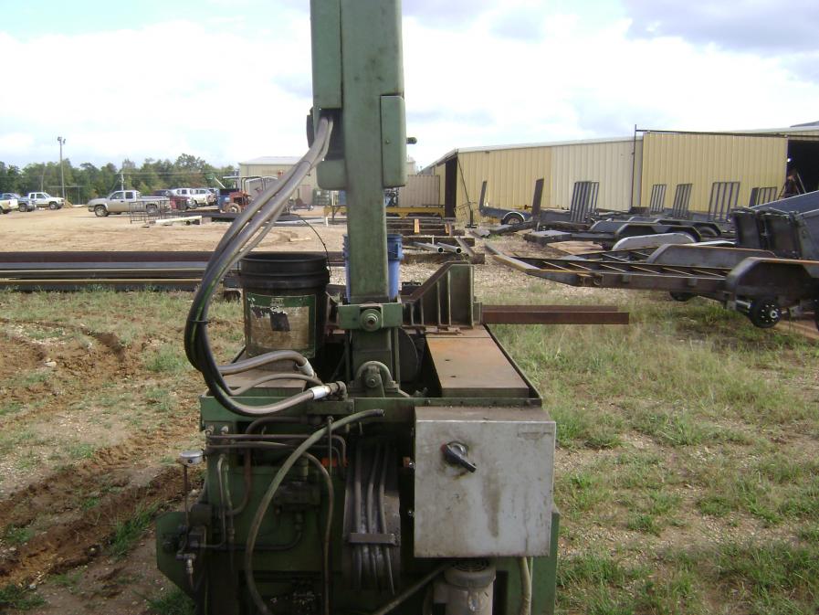

    "I am not sure what you mean by a roll in saw. Maybe I know it under a different name or maybe I just don't know it?" quite possibly.
    Here are some pictures of a saw like I had and judging by the back ground it may even be my old saw.
    The table is stationary the work piece remains fixed to the table while the saw rolls into the cut, the saw can be tilted right or left up to a 45° angle. the entire body of the saw rolls into the cut this can be done manually or by a powered feed

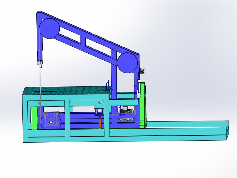

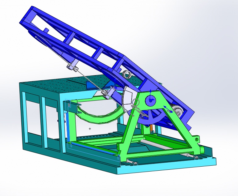

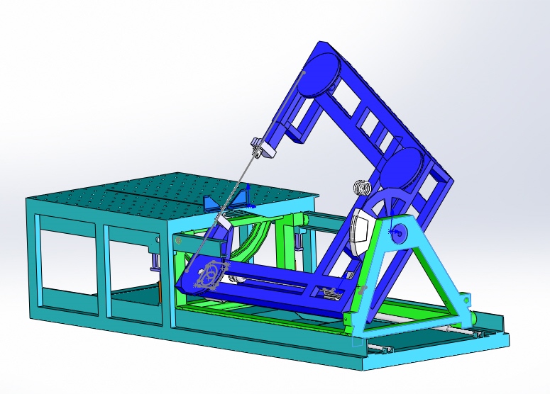

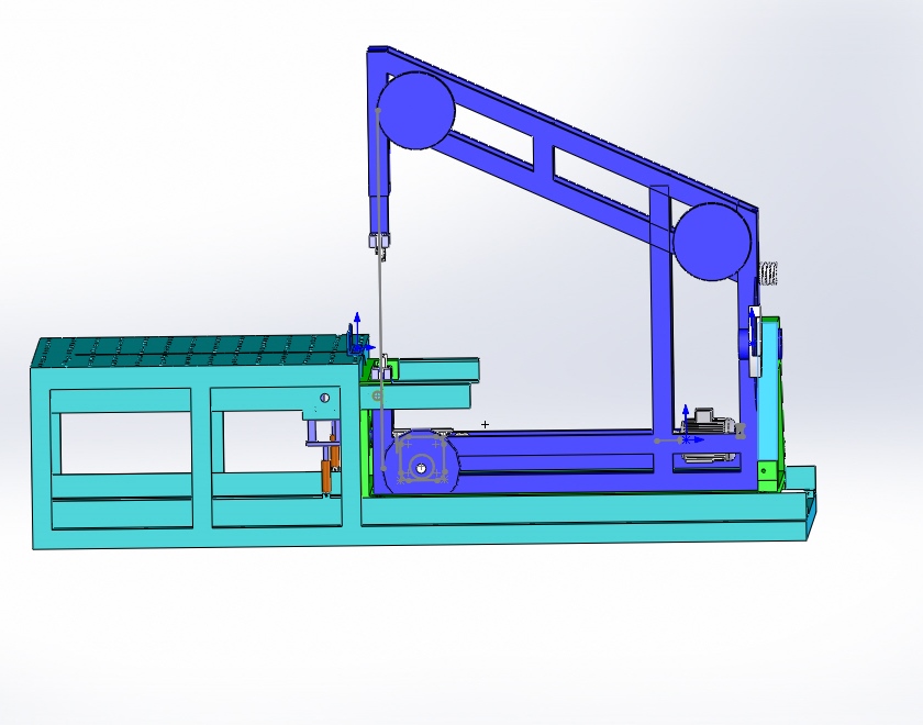

    Here are some Jpegs of my drawings of a large sandwich panel cutting saw I made while in the Middle east.Sadly unless I can get someone to help with data recovery I have lost almost my entire collection of 35 years worth of photos Pretty much every thing prior to 2013 is lost, But fortunately I kept my engineering and drawing files intact.
    This saw was made to cut steel clad foam filled sandwich panels or stacks of them up to 600 mm thick. it had a 1500 mm travel could be tilted 45° either direction. or the blade guides could be rotated 90° for linear cuts the saw could also be locked in position and raised to make bevel cuts linearly as well
    That is a serious bit of kit. I didn't realise that DoAll was the name.
    I like your panel cutting saw, especially the two axis tilting mechanism.
    Both of those saws make my new one look like a tiny toy. I found an hour today to get more work done on it, most of the fiddly stuff is done now so completion shouldn't be too far away.

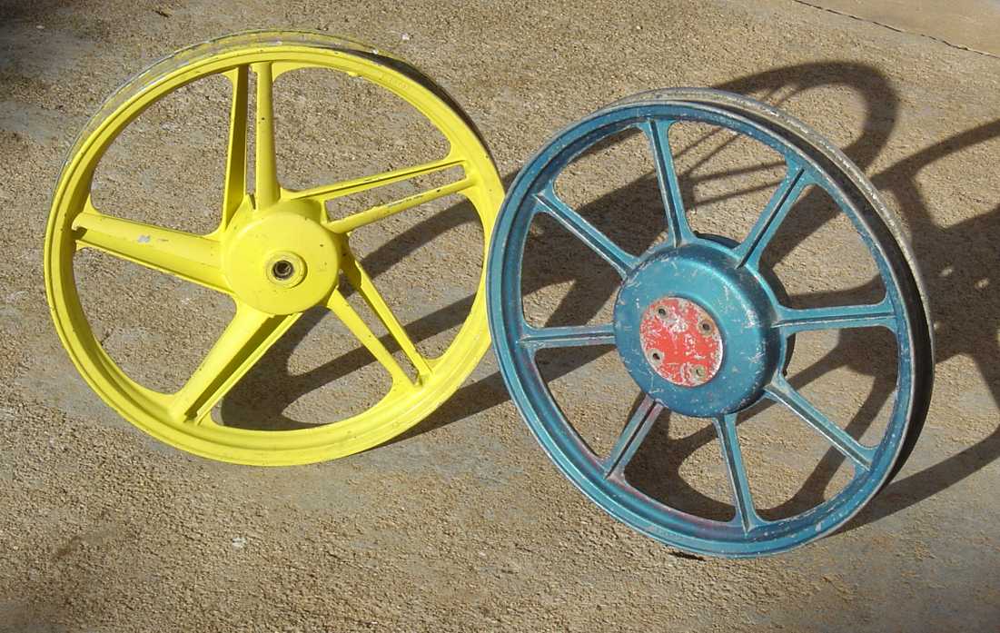

    Thanks Tony, gives me an idea to build a wood mill. Never thought about using motor bike rims till now.
