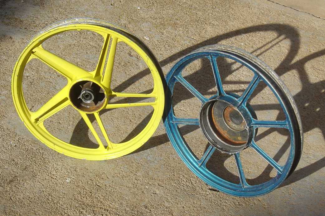

    There have been some recent posts here about bandsaws and bandsaw wheels. This is quite topical for me as I am making a bandsaw in spare moments. Accordingly I thought that it might be of interest to post how I made my wheels.
    I wanted a bandsaw with a throat of around 16" and I thought that wheels from a moped might be a good starting point and i found a couple at a local Saturday flea market. They were from different mopeds but one was a front wheel with bearings and brake. The other was a rear wheel without bearings for a single sided mounting.
    Making bandsaw wheels-wheels-01.jpg Making bandsaw wheels-wheels-02.jpg Click thumbnails for full size view.
    The yellow wheel was a front with bearings, the blue was a single sided rear without bearings.
    Firstly I was disappointed with the absence of bearings in the rear, thinking that I would have to make a bolt-in bearing housing. However as we'll see, it worked out really well.

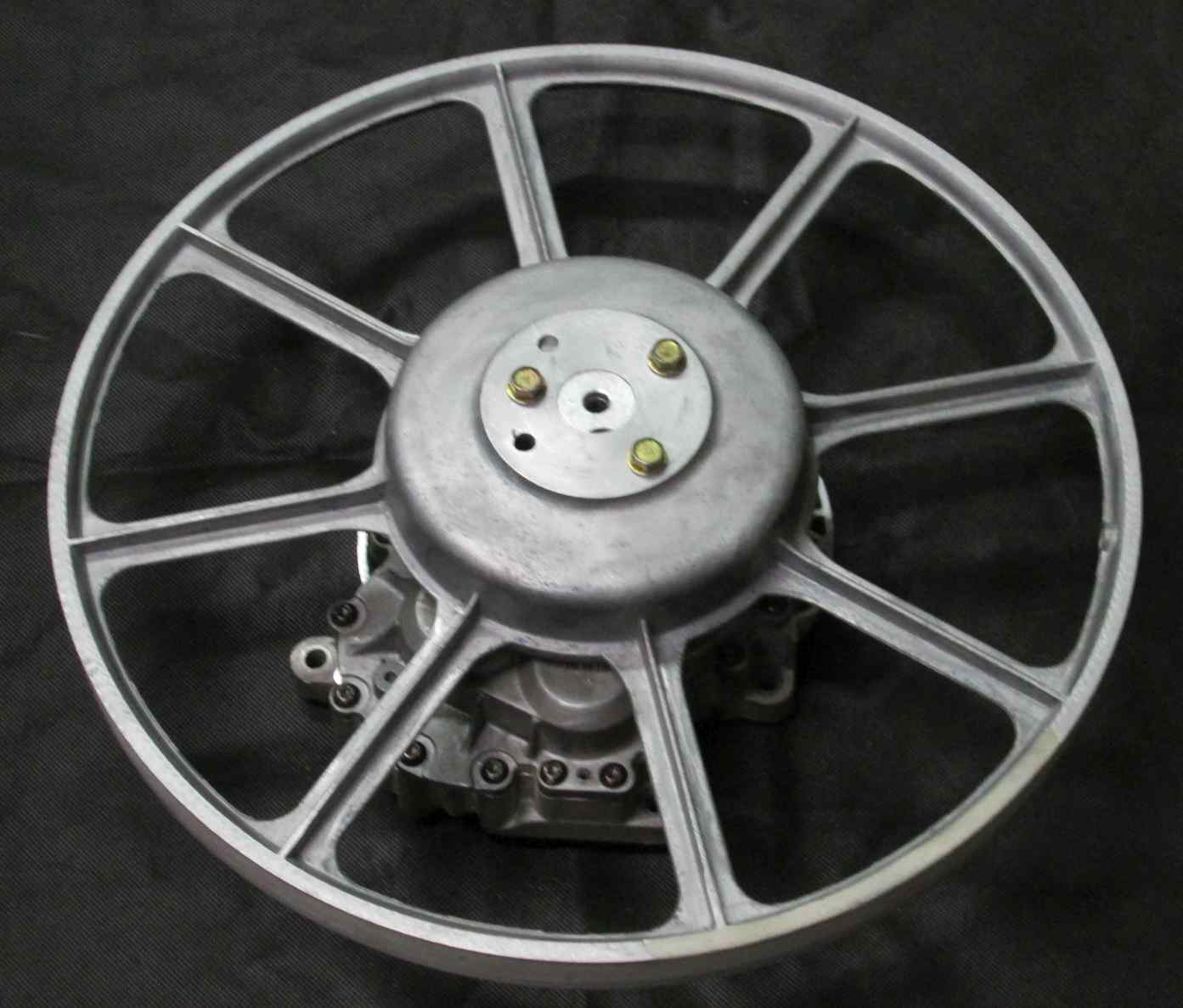

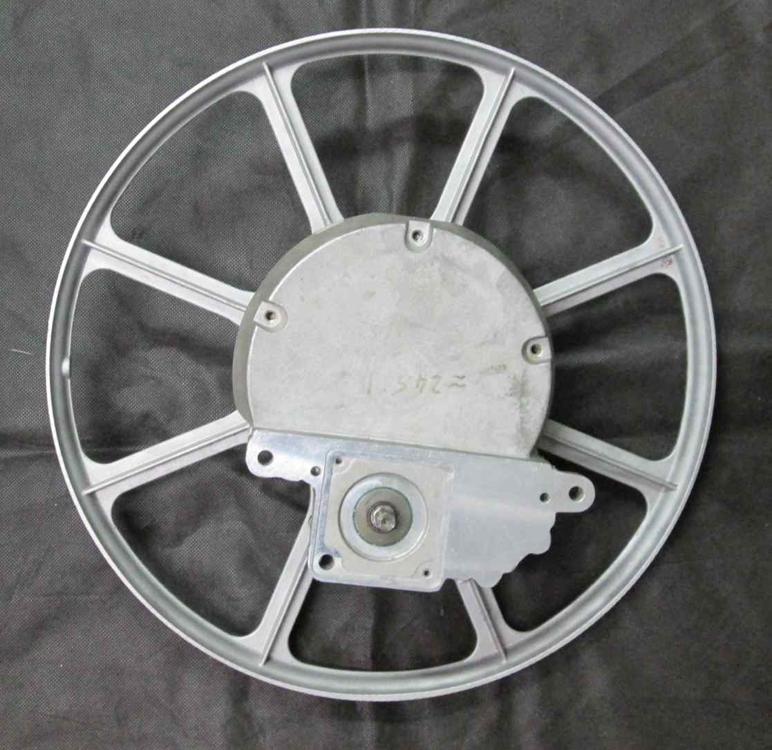

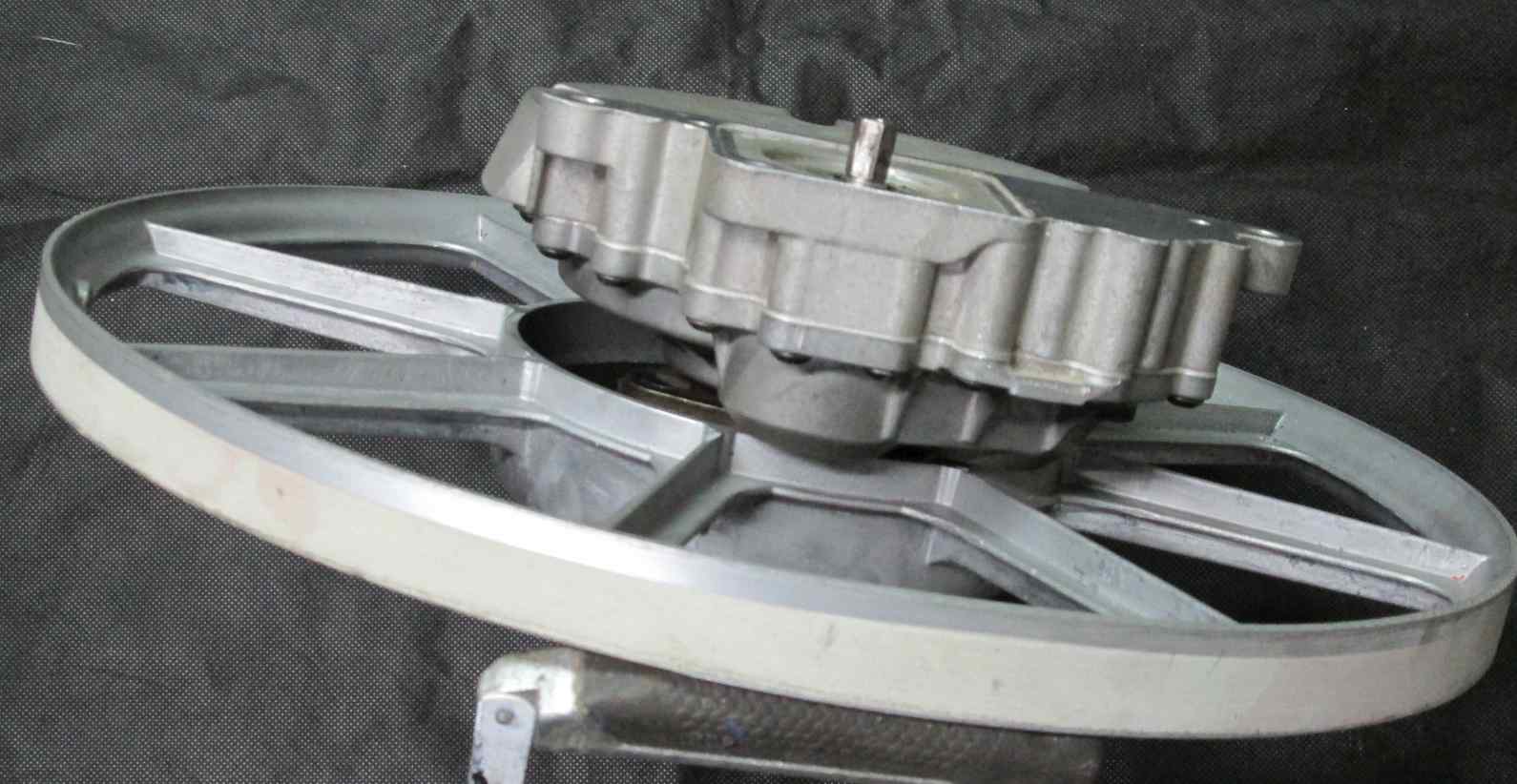

    In the original post I forgot to add pix of the wheel mounted on the gearbox, so here are the missing pix.

    Tony
    This is a very interesting build to follow, BTW what is the origin of the gearbox, it looks ideal.

    Alan, the gearbox is from a Segway. I had a pair of them which were in the scrap box because they each had damaged threads on the wheel mounting flange. They have a ratio of close to 25:1 which with a 1500 rpm motor and 16" wheels gives a blade speed about right for cutting metal. The other gearbox was used on my shock absorber dynamometer detailed in a previous post http://www.homemadetools.net/forum/s...amometer-56478
