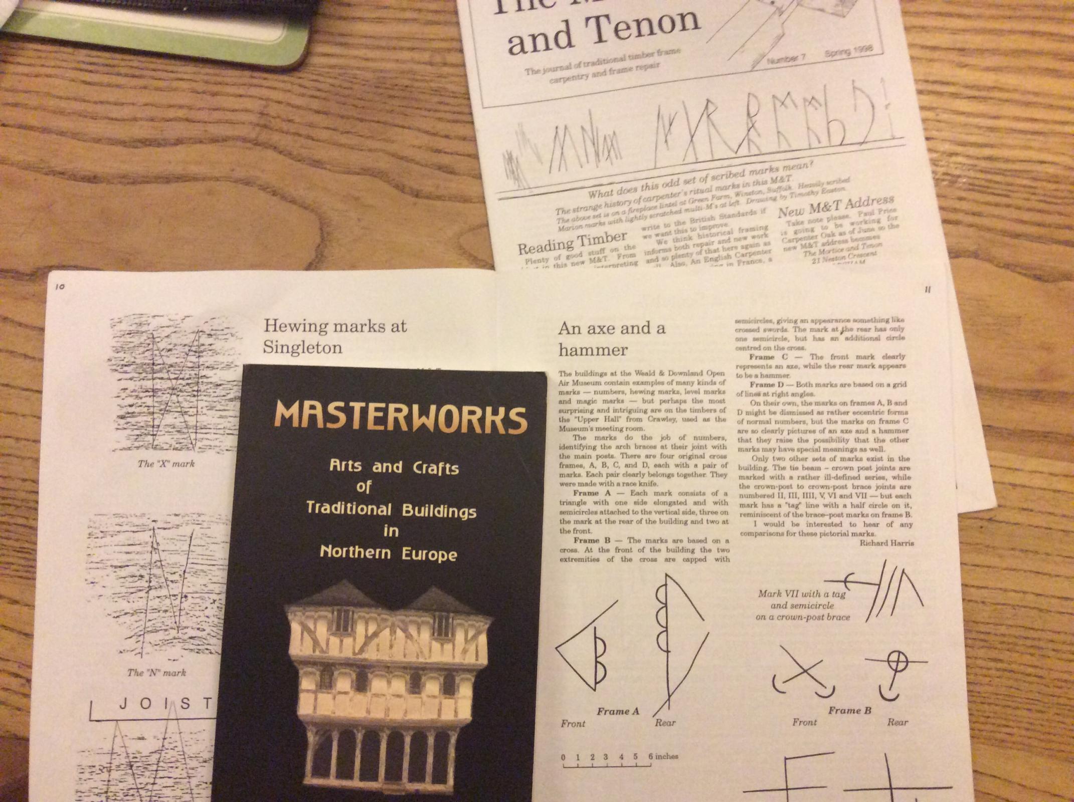

    I have been intrigued by the purpose of makers’ marks for over 30 years. Carpenters’ marks were discussed a lot in the early days of the Carpenters’ Fellowship. People would find curious incisions in medieval timber frames, say, on the lintel above a hearth. This would be described “apotropaic” ie protection against witchcraft, but to my mind they might equally have been the marks of the men who built it, as a kind of celebration, like topping-out. (One example above, reproduced in the Fellowship’s “Mortise & Tenon”
    I read somewhere that in some trades, masons especially, their mark had to be proven. Now what does this mean? Probably that the apprentice or journeyman has reached an acceptable standard to be received into the guild. But I have also read that their mark had to be geometrically proven, with compasses and straightedge, in the way that a theorem must be proven, so that the candidate’s mark also demonstrates competence in geometry, well, a mason would have to, wouldn’t he? This idea I seem to have derived from a novel by Alan Garner, “The Stone Book Quartet”.
    These traditions have largely died out, but if anybody knows anything about them, please let us know.

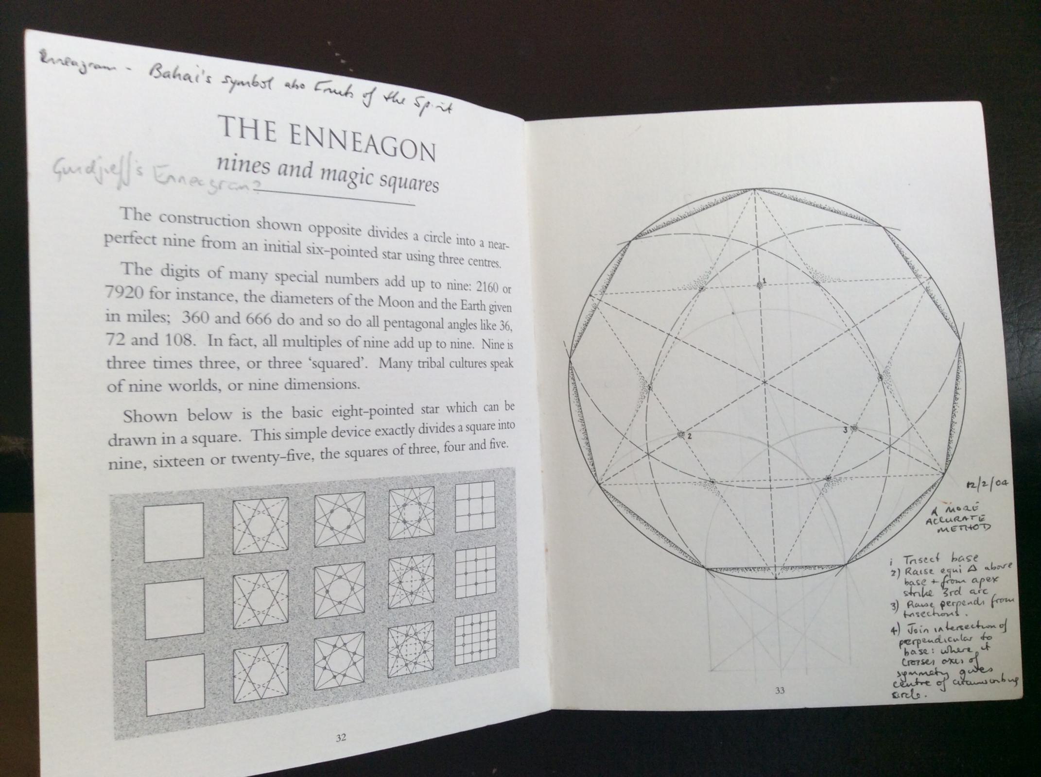

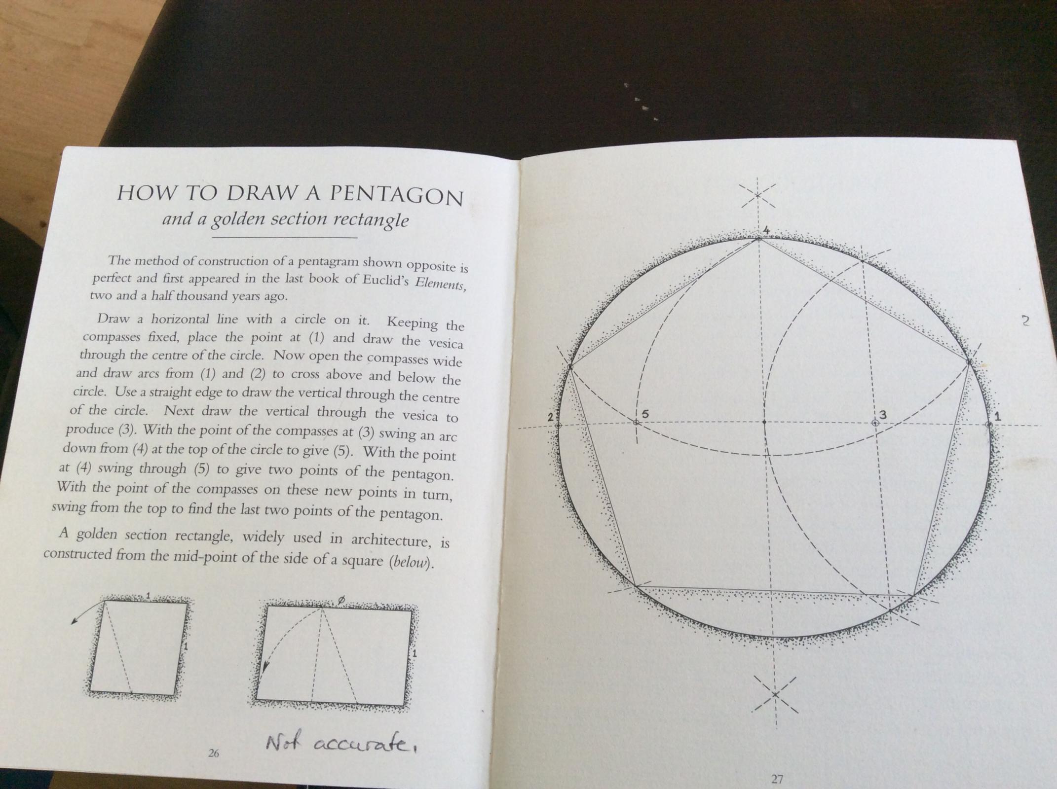

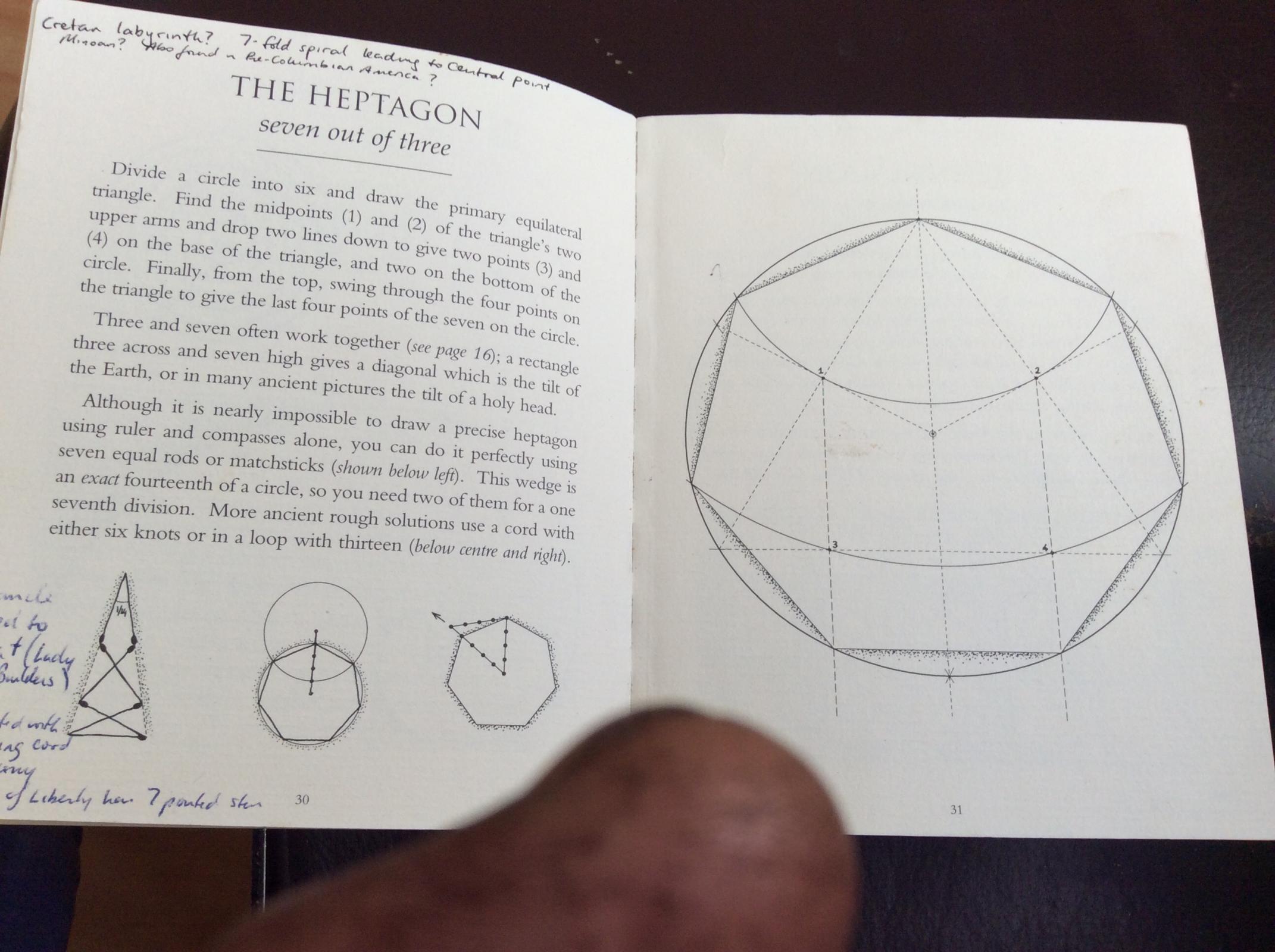

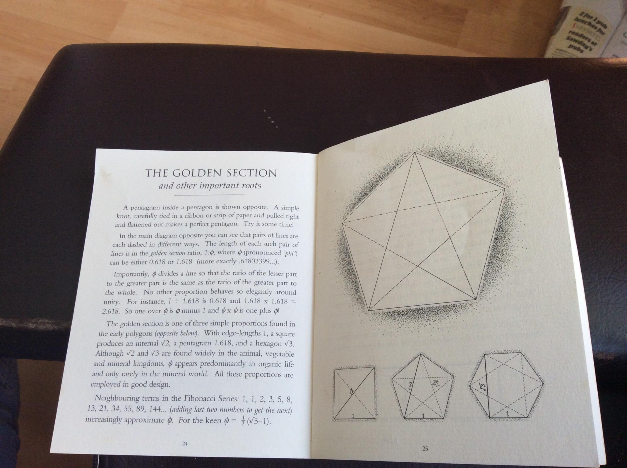

    Here’s one method, not fully accurate, of constructing a pentagon. There is another method, using only 2 instruments, which I can’t find at present. If interested, I’ll draw it for you.
    This method uses a square piece of paper.
    Here’s a way to construct a heptagon, using 7 equal length rods. The page shows a less accurate method of construction, using a cord.Makers’ marks-image.jpg
    Here’s an enneagon:
    These diagrams are from a book by Miranda Lundy, entitled “sacred geometry”. Your knowledge of maths, far exceeds mine, Marv

    Here's a simple way to construct an approximate heptagon...
    The true length of one side of a heptagon inscribed in a circle of radius R is given by:
    C = 2 * R * SIN (180/7)
    which for the unit circle (R = 1) evaluates to 0.86777
    In the video he constructs the line labeled QM and uses that for the pentagon side. The length of QM can be found by noting that QO = R and MO = R/2, so:
    QM = SQRT ( R^2 - R^2/4) = R * SQRT (3/4) = R * 0.5 * SQRT (3)
    which for R = 1 evaluates to 0.86603
    Close, but not perfect. Gauss' conclusions are not threatened.
