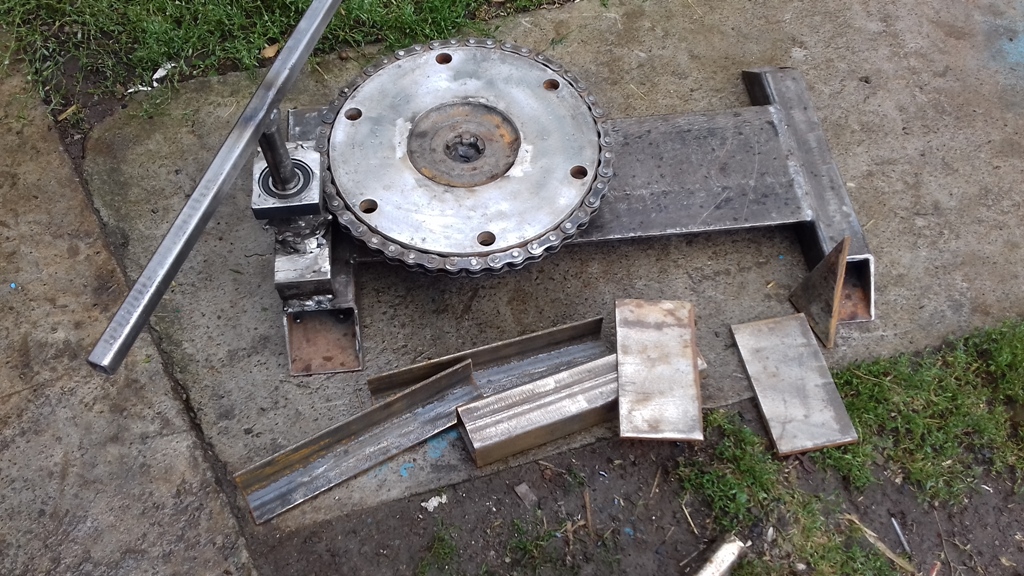

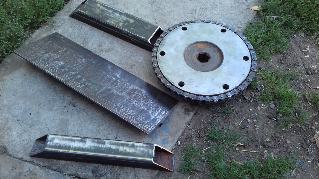

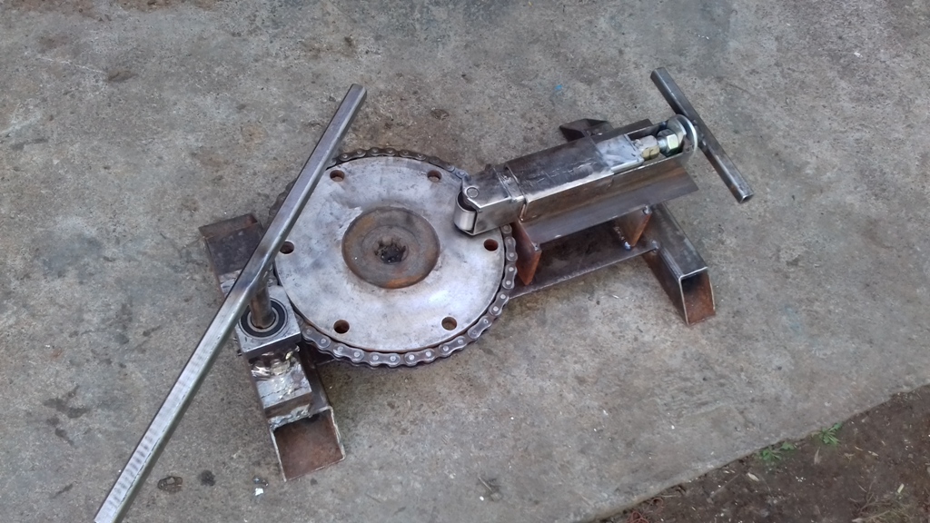

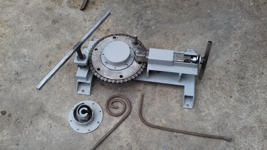

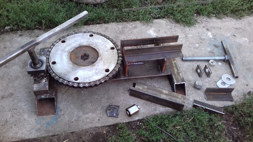

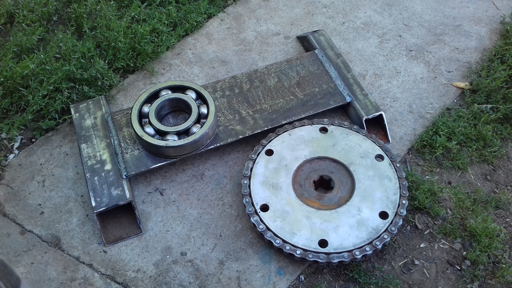

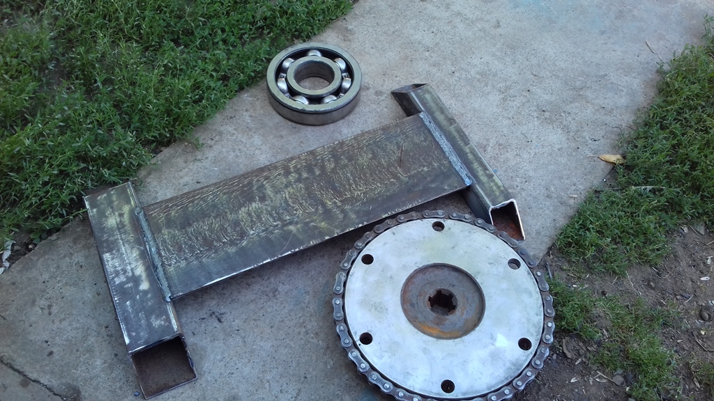

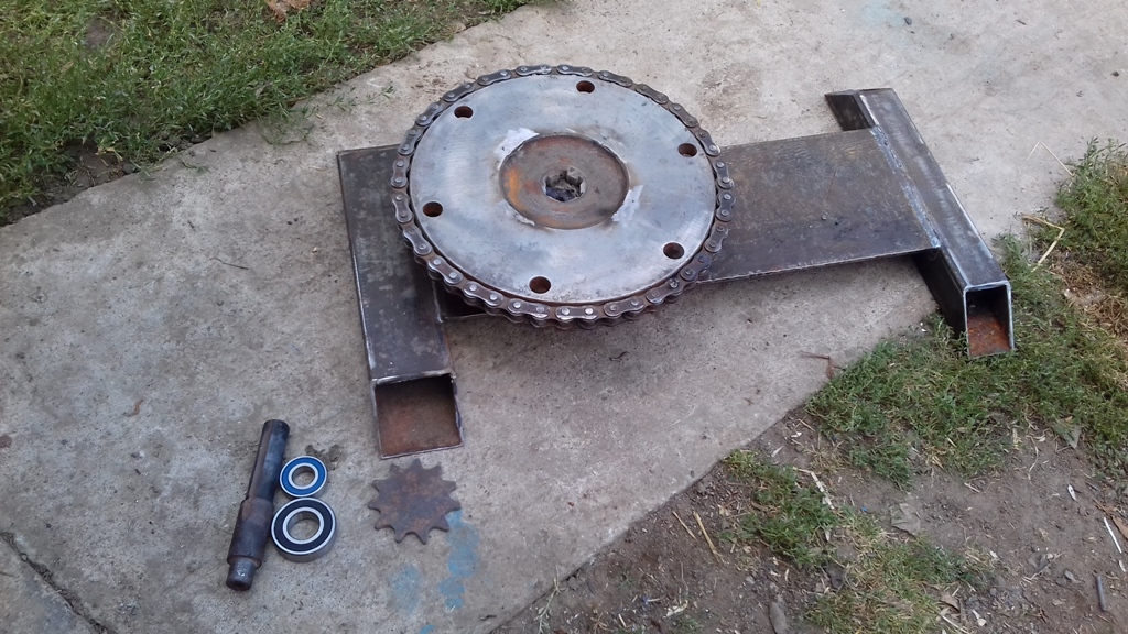

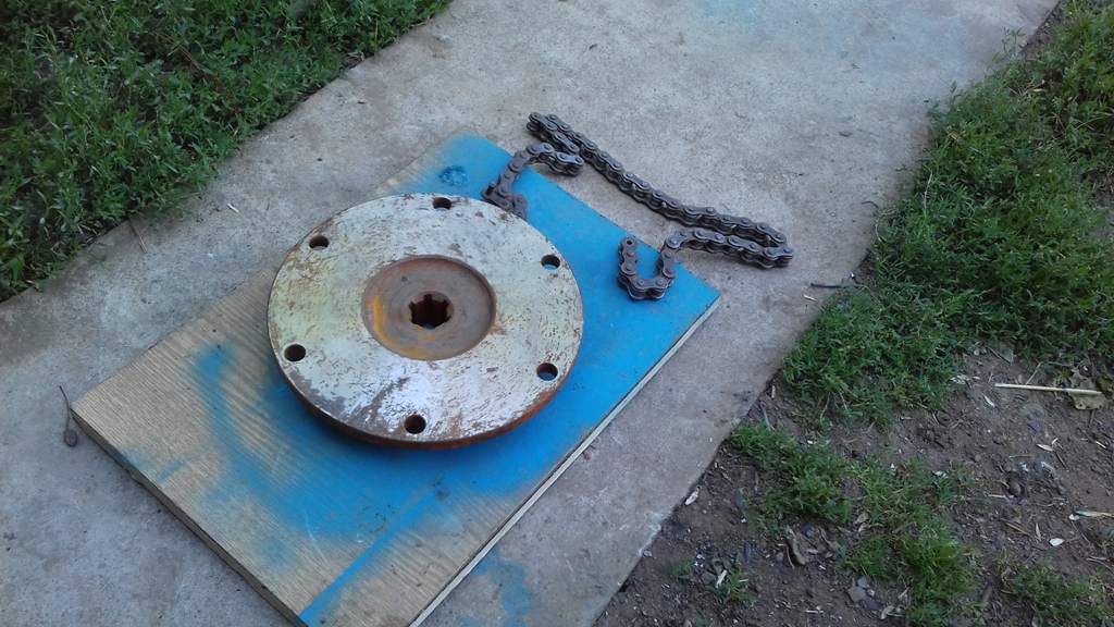

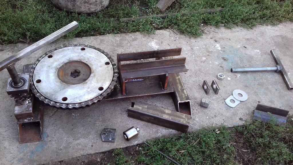

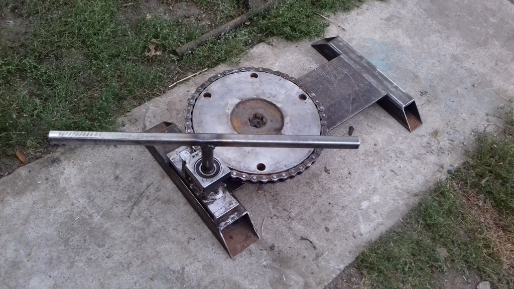

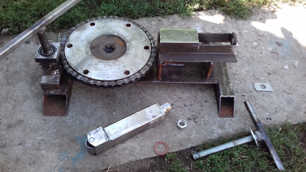

    Hi. Homemade Metal Bender for the manufacture of small decorative elements of cold forging.

    old kodger's Tools
    An interesting idea, but why would you not just use an engine flywheel with the starting ring gear still (already) on it?

    Quote Originally Posted by old kodger View Post
    Its " Use what you have ". Nice to see alternative solutions too.
    As I don't have a car flywheel, I make from what is available.

    how is the chain fastened to the plate?
  12. #9
    Oct 2012
    Lafayette, Indiana
    557
    873
    Thanked 430 Times in 225 Posts
    sossol's Tools
    Quote Originally Posted by Tooler2 View Post
    Tack welds on the underside are visible when he flips the plate over.
