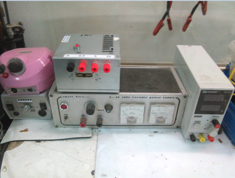

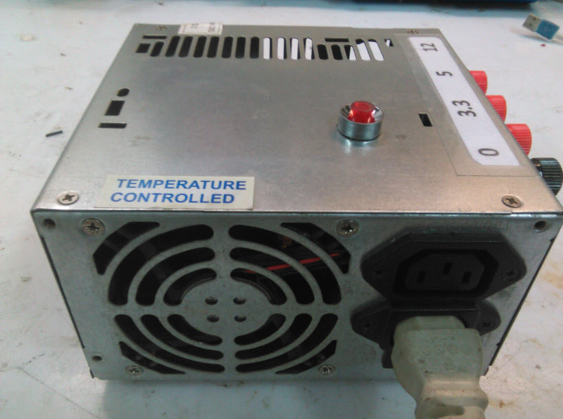

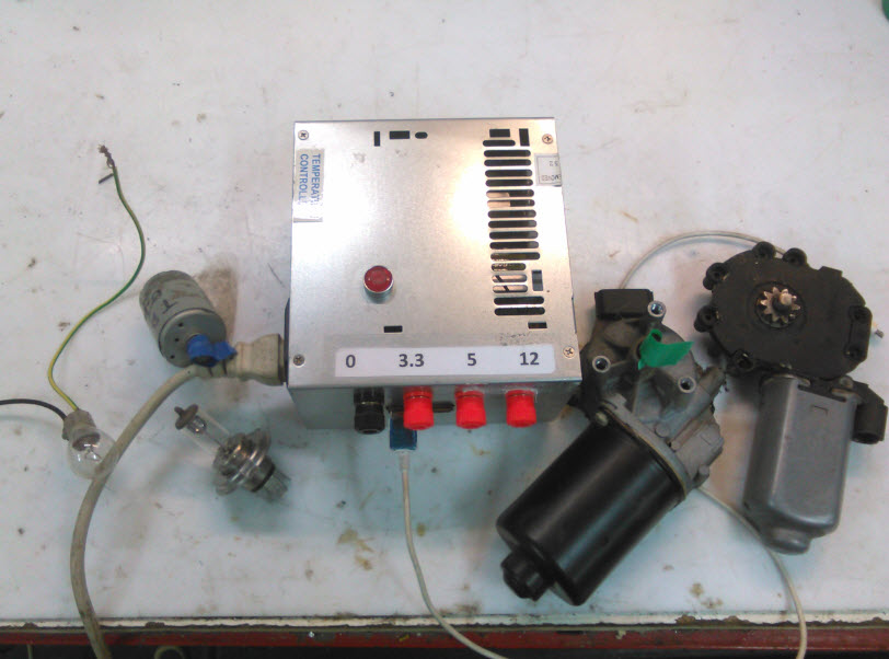

    MAKE A BENCH POWER SUPPLY FROM YOUR OLD PC
    In this video you can learn how to make a strong bench power supply from your old pc without special tools.
    You can watch how I've made it here:
    Attached Thumbnails Attached Thumbnails MAKE A  BENCH POWER SUPPLY FROM YOUR OLD PC-f1.jpg   MAKE A  BENCH POWER SUPPLY FROM YOUR OLD PC-f2.jpg   MAKE A  BENCH POWER SUPPLY FROM YOUR OLD PC-f3.jpg   MAKE A  BENCH POWER SUPPLY FROM YOUR OLD PC-f4.jpg   MAKE A  BENCH POWER SUPPLY FROM YOUR OLD PC-f5.jpg

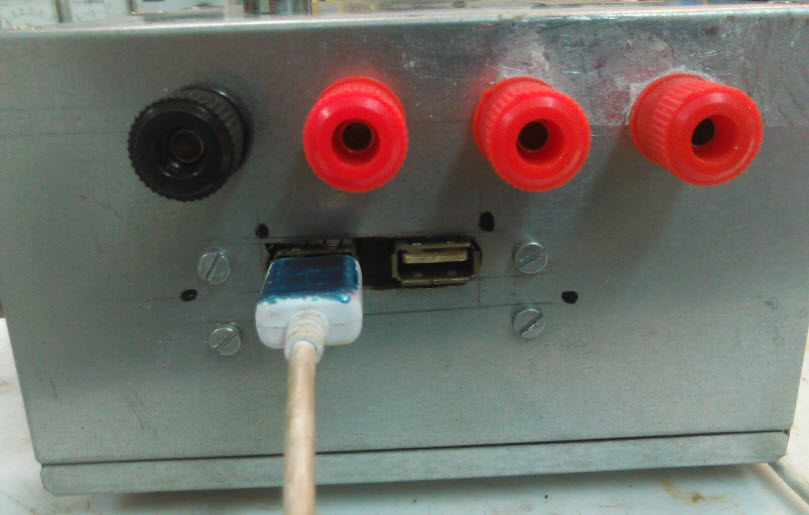

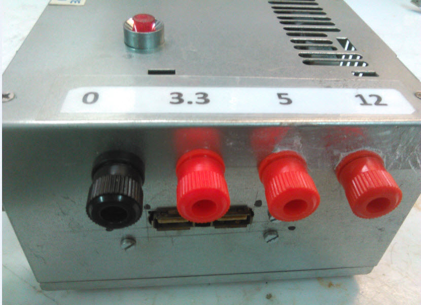

    Depending on the power rating of your particular ATX PSU,
    those seemingly safe 3.3, 5 and 12 volt rails can crank out some serious current.
    Guess the PSU sticker tells you the max power that each and all rails could deliver, and/ or check link below.
    Fuses aren't merely a powerful stimulant for the Upper Classes,
    thus a 1 amp fuse would be pertinent (at least) to your AUX USB.
    For instance: Hooking your aux USB power socket to a worn-out & shorted cell phone charger cable,
    would draw some +18 Amps (100W - more than your soldering iron) before the internal current-limiting even kicks in.

    Thank' s a lot. You are right. I 'l put a 1 A fuse to the usb cable immediately.
