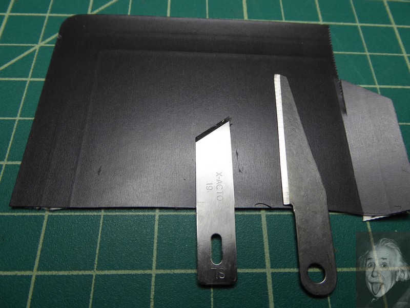

    Custom edge protectors for X-acto knife blades can be made very quickly.
    Arrange blades on disused refrigerator magnet...

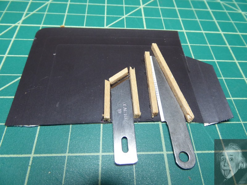

    glue thin strips of wood around blade edges...

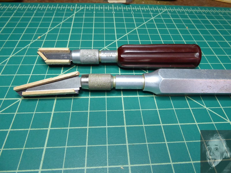

    scissor from magnet and stick on knife...
    A cardboard cover could be glued over the strips of wood but I don't bother.
