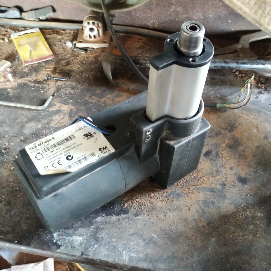

    At long last I finally got around to making the drive unit for my pantograph pattern torch
    Pantogragh style tracing torch project
    in the past I have used it a few times but always just clamped a bent bolt to the top bar in alignment with the torch and had a temporary pattern support clamped on as well. I could make duplicate parts manually but it was really more trouble than it was worth.
    I finally pulled one of those R-tu-its from the pile and started in making the drive unit for it
    Starting with a 12Vdc linear actuator motor, a worn out die grinder, a cylindrical NEO magnet this is what I came up with

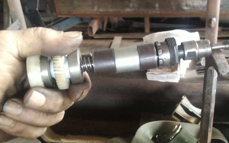

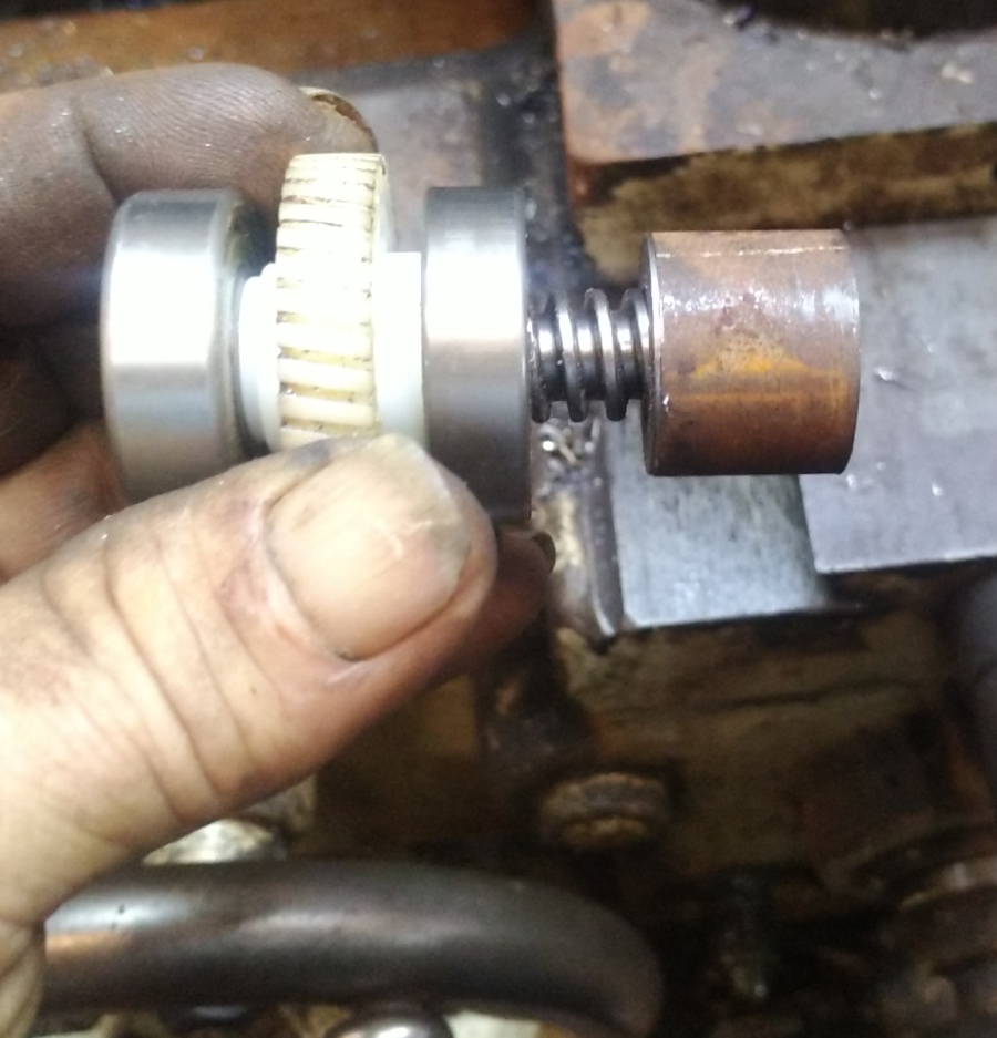

    I shortened the acme screw and pressed hub on the end of it to mate up with the magnet
    I did the same thing to the die grinder rotor then by magnetic connection only picked up a 20 inch heal bar with it while holding it horizontally, Seems plenty strong

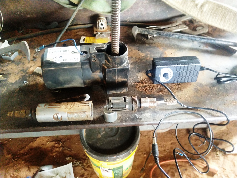

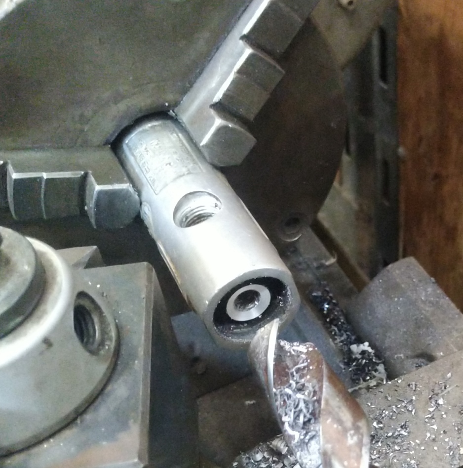

    I then drilled and bored out the die grinder housing so I could take advantage of the shaft bearing

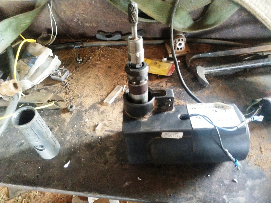

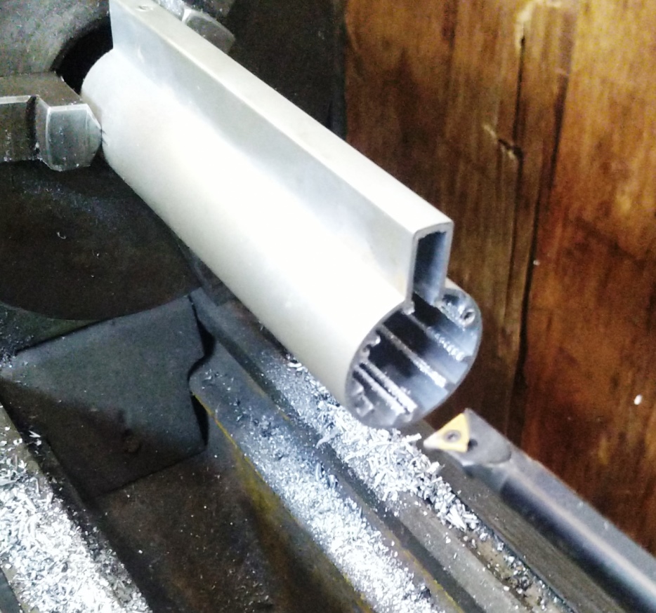

    then I bored out the actuator housing so the die grinder could fit inside
    After shortening everything and assembling this is what it looks like
