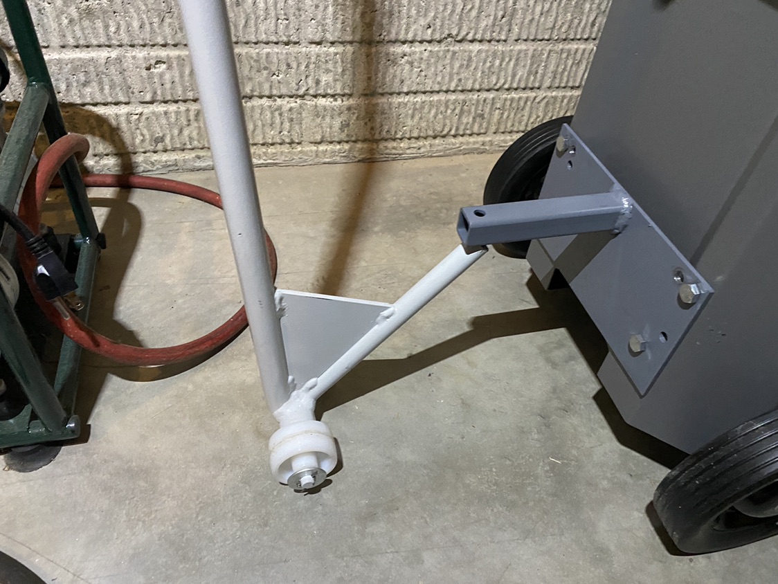

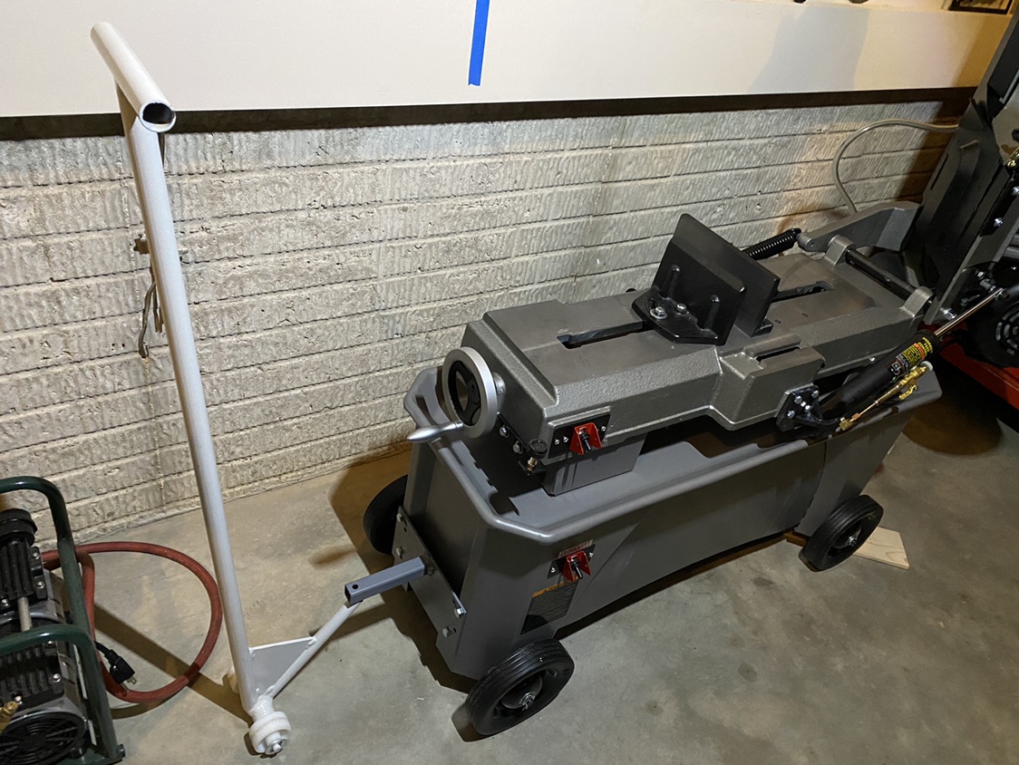

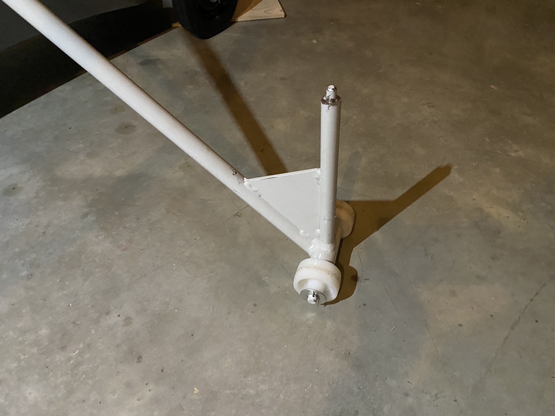

    My new Jet 7" x 12" horizontal bandsaw has non-pivoting wheels. That makes them useless, since I will need to turn it out from the wall to make room for the stock being cut.
    I made use of a lifting bar with rollers I already had on hand, and fabricated a plate that bolts on the end of my Jet saw. A 7/16" x 1" slot on the bottom of a piece of 1" square tubing engages a short stub on the lifting bar. Now I can easily move the Jet saw around without having to replace the saw wheels with casters.

    That's good adaptation of what is known as "semi-live skid". Once very common, but not seen lately, a flat bed cart with two independent wheels at one end, and feet on the other.
