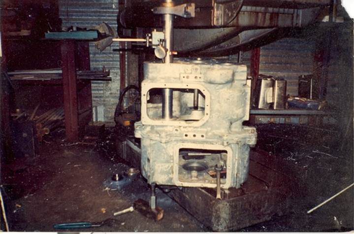

    Mack transmission repair set up
    On another thread quite a while back I don't remember who's thread it was. I described how I used to repair the bearing locations in Mack transmissions on my radial arm drill press.
    I found one of the pictures of this process on my computer screen background http://www.homemadetools.net/forum/f...ckground-67767
    the set up involves a 2" diameter 44" long boring bar with a #4 mt made specifically to fit the drill press and drilled for cutters to coincide with the bearing locations. pillow block bearings mounted to the side of the table and the base
